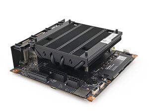

The Framework Desktop is a 4.5L small-form-factor desktop PC built around the standard mini ITX form factor, with a custom board using AMD's new Strix Halo Ryzen AI Max series APUs. Targeted squarely at the emerging local/offline LLM scene, the Framework Desktop was also advertised to perform well in gaming workloads, thanks to RDNA3 GPU firepower in the AI Max APUs.
The board features a soldered APU and soldered LPDDR5x. Built on the mini ITX motherboard size, it also features two PCIe 4.0 M.2 slots for storage, standard motherboard headers and fan headers, standard ATX power ports (24-pin board and 12-pin CPU power), and a single PCIe x4 expansion slot. The cooling solution was developed in partnership with Cooler Master and Noctua.

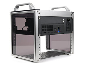

The case, at 4.5L, also includes a custom FSP flex ATX power supply, customizable front fascia, and Framework expansion cards as front ports.

APU (Processor):
  • AMD Ryzen AI Max 385 (8-core, 16-thread, 3.6–5.0 GHz, 32 MB L3 cache, 120–140W)
  • Configurable to AMD Ryzen AI Max+ 395 (16-core, 32-thread, 3.0–5.1 GHz, 64 MB L3 cache, 120–140W)
APU (Graphics):
  • With Ryzen AI Max 385: Integrated Radeon 8050S (RDNA3, 2.8 GHz, 32 CUs, 32 MB cache)
  • With Ryzen AI Max+ 395: Integrated Radeon 8060S (RDNA3, 2.9 GHz, 40 CUs, 32 MB cache)
Cooling:
  • Custom 6-heatpipe heatsink with 120mm Cooler Master Mobius 120
    • Configurable to 120mm Noctua NF-A12x25
    • Configurable to 120mm Cooler Master Mobius 120p ARGB

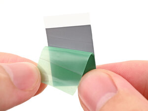

  • Honeywell PTM7958 TIM

Size:
  • Volume: 4.5 L
  • Case: 96.8 x 205.5 x 226.1 mm (3.81 x 8.09 x 8.90 inches)
  • Weight: 3.1 kg (6.83 lbs)
