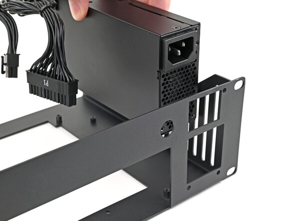

  1. How to Rack Mount your Framework Desktop, Place the power supply: crwdns2935265:01crwdnd2935265:01crwdnd2935265:03crwdne2935265:0 How to Rack Mount your Framework Desktop, Place the power supply: crwdns2935265:01crwdnd2935265:02crwdnd2935265:03crwdne2935265:0 How to Rack Mount your Framework Desktop, Place the power supply: crwdns2935265:01crwdnd2935265:03crwdnd2935265:03crwdne2935265:0
    • Place the power supply into its slot at the right edge of the Tray.
    • Push the plug on the power supply through its cutout on the Tray and align the three screw holes.

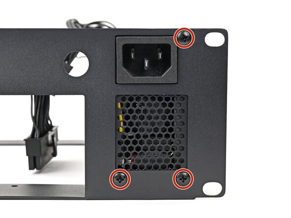

  2. How to Rack Mount your Framework Desktop, Install the power supply screws: crwdns2935265:02crwdnd2935265:01crwdnd2935265:02crwdne2935265:0 How to Rack Mount your Framework Desktop, Install the power supply screws: crwdns2935265:02crwdnd2935265:02crwdnd2935265:02crwdne2935265:0
    • Use your Framework Desktop Screwdriver to install the three 6.0 mm‑long Phillips screws securing the power supply.
