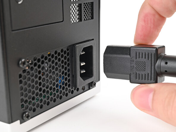

    • Before you begin repairs, shut down your Desktop from the operating system and unplug it.
    • Wait one minute before continuing to allow your Desktop to fully power down.

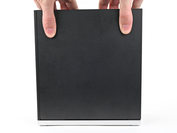

  6. Framework Desktop Secondary Storage Replacement, Remove the Top Panel: crwdns2935265:06crwdnd2935265:01crwdnd2935265:03crwdne2935265:0 Framework Desktop Secondary Storage Replacement, Remove the Top Panel: crwdns2935265:06crwdnd2935265:02crwdnd2935265:03crwdne2935265:0 Framework Desktop Secondary Storage Replacement, Remove the Top Panel: crwdns2935265:06crwdnd2935265:03crwdnd2935265:03crwdne2935265:0
    • Slide the Top Panel towards the rear of the computer to release the clips securing it to the chassis.
    • If you're having a hard time gripping the Top Panel, use the screw holes to get a better handhold.
    • Lift the Top Panel off the chassis and remove it.

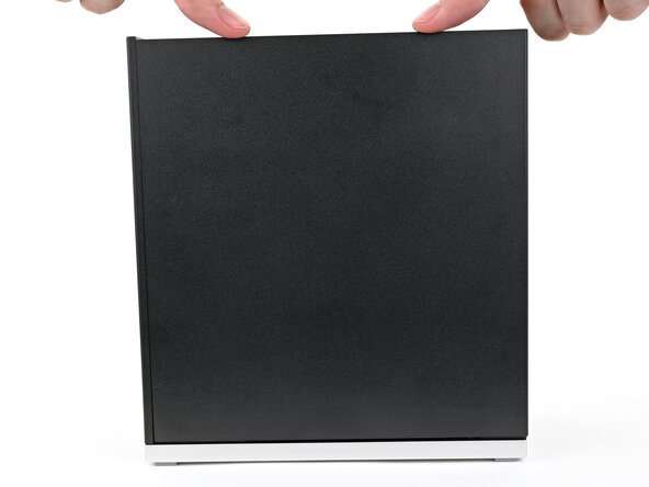

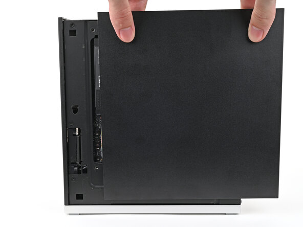

  7. Framework Desktop Secondary Storage Replacement, Remove the Right Panel: crwdns2935265:07crwdnd2935265:01crwdnd2935265:03crwdne2935265:0 Framework Desktop Secondary Storage Replacement, Remove the Right Panel: crwdns2935265:07crwdnd2935265:02crwdnd2935265:03crwdne2935265:0 Framework Desktop Secondary Storage Replacement, Remove the Right Panel: crwdns2935265:07crwdnd2935265:03crwdnd2935265:03crwdne2935265:0
    • Use your fingers to grip the top of the Right Panel and slide it upward to release its clips.
    • Remove the Right Panel.

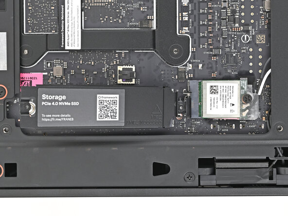

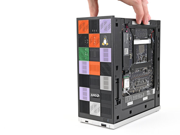

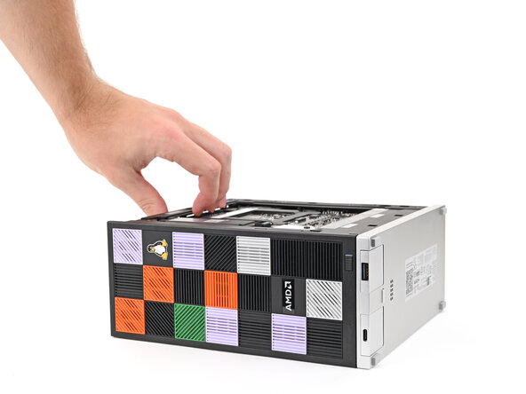

  8. Framework Desktop Secondary Storage Replacement, Reposition the Desktop: crwdns2935265:08crwdnd2935265:01crwdnd2935265:02crwdne2935265:0 Framework Desktop Secondary Storage Replacement, Reposition the Desktop: crwdns2935265:08crwdnd2935265:02crwdnd2935265:02crwdne2935265:0
    • Lay the left side of the Desktop on your work surface so the underside of the Mainboard is facing upward.

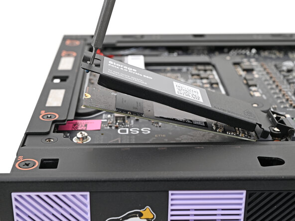

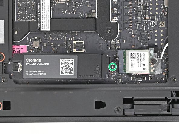

  9. Framework Desktop Secondary Storage Replacement, Loosen the SSD screw: crwdns2935265:09crwdnd2935265:01crwdnd2935265:02crwdne2935265:0 Framework Desktop Secondary Storage Replacement, Loosen the SSD screw: crwdns2935265:09crwdnd2935265:02crwdnd2935265:02crwdne2935265:0
    • Use your Framework Desktop Screwdriver to loosen the captive T5 Torx screw securing the SSD.
    • The SSD and its heat spreader will pop up to an angle when its screw is fully loosened.

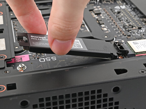

  10. Framework Desktop Secondary Storage Replacement, Remove the SSD: crwdns2935265:010crwdnd2935265:01crwdnd2935265:02crwdne2935265:0 Framework Desktop Secondary Storage Replacement, Remove the SSD: crwdns2935265:010crwdnd2935265:02crwdnd2935265:02crwdne2935265:0
    • While holding the heat spreader upright, grab the SSD by its edges and pull it out of its socket.
    • Remove the SSD.

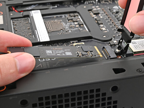

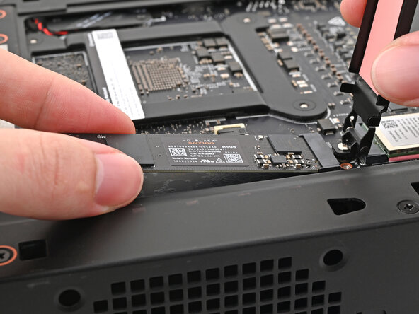

  14. Framework Desktop Secondary Storage Replacement, Install the SSD: crwdns2935265:014crwdnd2935265:01crwdnd2935265:03crwdne2935265:0 Framework Desktop Secondary Storage Replacement, Install the SSD: crwdns2935265:014crwdnd2935265:02crwdnd2935265:03crwdne2935265:0 Framework Desktop Secondary Storage Replacement, Install the SSD: crwdns2935265:014crwdnd2935265:03crwdnd2935265:03crwdne2935265:0
    • Hold the SSD by its edges. Don't touch the gold contacts with your fingers. If you do, wipe the contacts with a clean, lint-free cloth to remove any finger oils.
    • While holding the SSD heat spreader upright, align the SSD's gold contacts with its socket.
    • Insert the SSD into the socket at a shallow angle. The gold contacts should mostly be covered by the socket.
    • The SSD fits into the socket in one orientation. If it doesn't feel like it fits, try flipping the module.
    • Lay the heat spreader back onto the SSD.
  15. Framework Desktop Secondary Storage Replacement: crwdns2935265:015crwdnd2935265:01crwdnd2935265:01crwdne2935265:0
    • Use your Framework Desktop Screwdriver to tighten the captive T5 Torx screw securing the SSD.

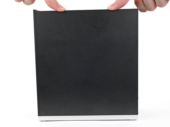

  17. Framework Desktop Secondary Storage Replacement, Install the Right Panel: crwdns2935265:017crwdnd2935265:01crwdnd2935265:03crwdne2935265:0 Framework Desktop Secondary Storage Replacement, Install the Right Panel: crwdns2935265:017crwdnd2935265:02crwdnd2935265:03crwdne2935265:0 Framework Desktop Secondary Storage Replacement, Install the Right Panel: crwdns2935265:017crwdnd2935265:03crwdnd2935265:03crwdne2935265:0
    • Slide the Right Panel onto the right edge of the chassis, from top to bottom, and press it flat to ensure its clips are slotted into place.
    • There should be a small gap between the bottom of the Right Panel and the silver base.
    • Push the Right Panel towards the base of the computer to engage the clips.
  18. Framework Desktop Secondary Storage Replacement, Install the Top Panel: crwdns2935265:018crwdnd2935265:01crwdnd2935265:03crwdne2935265:0 Framework Desktop Secondary Storage Replacement, Install the Top Panel: crwdns2935265:018crwdnd2935265:02crwdnd2935265:03crwdne2935265:0 Framework Desktop Secondary Storage Replacement, Install the Top Panel: crwdns2935265:018crwdnd2935265:03crwdnd2935265:03crwdne2935265:0
    • Orient the Top Panel so its arrow is pointing towards the rear of the computer.
    • While holding the Top Panel at a slight downward angle, slide it across the top of the chassis (from rear to front) until you feel its clips catch.
    • There should be a small gap between the Top Panel and the front of the Desktop.
    • Lay the Top Panel flat on the chassis to align the remaining clips.
  19. Framework Desktop Secondary Storage Replacement: crwdns2935265:019crwdnd2935265:01crwdnd2935265:02crwdne2935265:0 Framework Desktop Secondary Storage Replacement: crwdns2935265:019crwdnd2935265:02crwdnd2935265:02crwdne2935265:0
    • While securing the computer with one hand, use the other hand to slide the Top Panel towards the front of the computer to close the gap and engage the clips.
