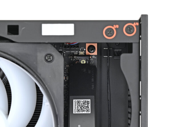

  3. Framework Desktop Primary Storage Replacement, Remove the Top Panel screws: crwdns2935265:03crwdnd2935265:01crwdnd2935265:03crwdne2935265:0 Framework Desktop Primary Storage Replacement, Remove the Top Panel screws: crwdns2935265:03crwdnd2935265:02crwdnd2935265:03crwdne2935265:0 Framework Desktop Primary Storage Replacement, Remove the Top Panel screws: crwdns2935265:03crwdnd2935265:03crwdnd2935265:03crwdne2935265:0
    • Use your finger to lift up the two D-rings on the Top Panel screws.
  4. Framework Desktop Primary Storage Replacement: crwdns2935265:04crwdnd2935265:01crwdnd2935265:03crwdne2935265:0 Framework Desktop Primary Storage Replacement: crwdns2935265:04crwdnd2935265:02crwdnd2935265:03crwdne2935265:0 Framework Desktop Primary Storage Replacement: crwdns2935265:04crwdnd2935265:03crwdnd2935265:03crwdne2935265:0
    • Use your fingers to twist the screw counter-clockwise and loosen it.
    • Remove the Top Panel screw.

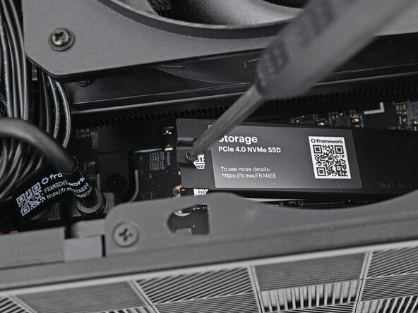

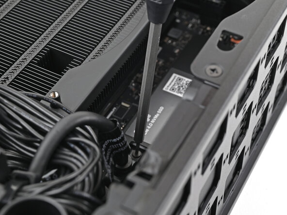

  8. Framework Desktop Primary Storage Replacement, Loosen the SSD screw: crwdns2935265:08crwdnd2935265:01crwdnd2935265:02crwdne2935265:0 Framework Desktop Primary Storage Replacement, Loosen the SSD screw: crwdns2935265:08crwdnd2935265:02crwdnd2935265:02crwdne2935265:0
    • Use your Framework Desktop Screwdriver to loosen the captive T5 Torx screw securing the SSD.
    • The SSD and its heat spreader will pop up to an angle when its screw is fully loosened.

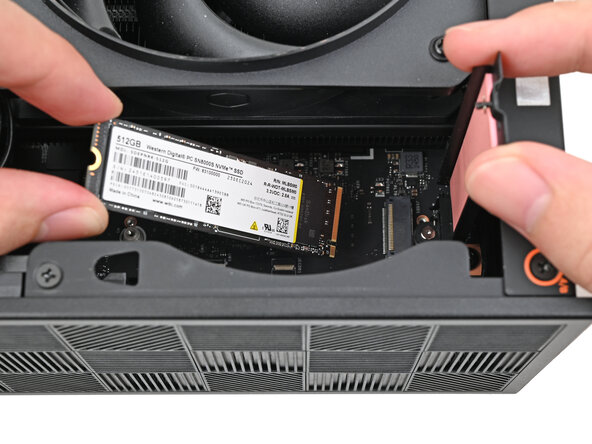

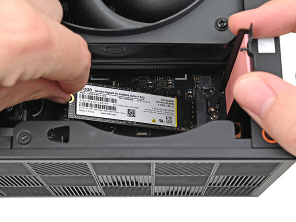

  9. Framework Desktop Primary Storage Replacement, Remove the SSD: crwdns2935265:09crwdnd2935265:01crwdnd2935265:03crwdne2935265:0 Framework Desktop Primary Storage Replacement, Remove the SSD: crwdns2935265:09crwdnd2935265:02crwdnd2935265:03crwdne2935265:0 Framework Desktop Primary Storage Replacement, Remove the SSD: crwdns2935265:09crwdnd2935265:03crwdnd2935265:03crwdne2935265:0
    • While holding the heat spreader upright, grab the SSD by its edges and pull it out of its socket.
    • Remove the SSD.

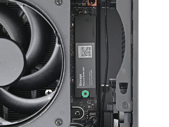

  10. Framework Desktop Primary Storage Replacement, Remove the primary storage heat spreader screw: crwdns2935265:010crwdnd2935265:01crwdnd2935265:03crwdne2935265:0 Framework Desktop Primary Storage Replacement, Remove the primary storage heat spreader screw: crwdns2935265:010crwdnd2935265:02crwdnd2935265:03crwdne2935265:0 Framework Desktop Primary Storage Replacement, Remove the primary storage heat spreader screw: crwdns2935265:010crwdnd2935265:03crwdnd2935265:03crwdne2935265:0
    • If your replacement SSD comes with a pre-installed heat spreader, follow the next two steps. Otherwise skip here.
    • While securing the primary storage heat spreader with one hand, use your Framework Desktop Screwdriver to remove the 4.5 mm‑long T5 Torx screw securing it.

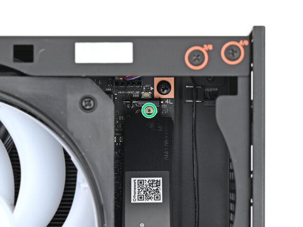

  13. Framework Desktop Primary Storage Replacement, Loosen the heat spreader screw: crwdns2935265:013crwdnd2935265:01crwdnd2935265:01crwdne2935265:0
  14. Framework Desktop Primary Storage Replacement, Install the SSD: crwdns2935265:014crwdnd2935265:01crwdnd2935265:02crwdne2935265:0 Framework Desktop Primary Storage Replacement, Install the SSD: crwdns2935265:014crwdnd2935265:02crwdnd2935265:02crwdne2935265:0
    • Hold the SSD by its edges. Don't touch the gold contacts with your fingers. If you do, wipe the contacts with a clean, lint-free cloth to remove any finger oils.
    • While holding the heat spreader upright, align the SSD's gold contacts with its socket.
    • Insert the SSD into the socket at a shallow angle. The gold contacts should mostly be covered by the socket.
    • The SSD fits into the socket in one orientation. If it doesn't feel like it fits, try flipping the module.

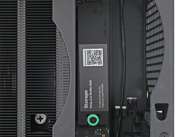

  15. Framework Desktop Primary Storage Replacement, Install the SSD screw: crwdns2935265:015crwdnd2935265:01crwdnd2935265:03crwdne2935265:0 Framework Desktop Primary Storage Replacement, Install the SSD screw: crwdns2935265:015crwdnd2935265:02crwdnd2935265:03crwdne2935265:0 Framework Desktop Primary Storage Replacement, Install the SSD screw: crwdns2935265:015crwdnd2935265:03crwdnd2935265:03crwdne2935265:0
    • Insert your Framework Desktop Screwdriver into the captive screw on the primary storage heat spreader and press it flat to the Mainboard.
    • Tighten the screw securing the SSD.
