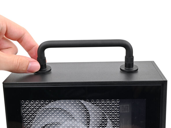

  2. Framework Desktop Expansion Card Cables Replacement, Remove the Handle: crwdns2935265:02crwdnd2935265:01crwdnd2935265:03crwdne2935265:0 Framework Desktop Expansion Card Cables Replacement, Remove the Handle: crwdns2935265:02crwdnd2935265:02crwdnd2935265:03crwdne2935265:0 Framework Desktop Expansion Card Cables Replacement, Remove the Handle: crwdns2935265:02crwdnd2935265:03crwdnd2935265:03crwdne2935265:0
    • If you installed the Handle on your Desktop, follow this step. Otherwise, skip it.
    • Rotate the Handle's screw threads counterclockwise on both sides until it comes free.
    • Remove the Handle.

  70. Framework Desktop Expansion Card Cables Replacement, Install the Handle: crwdns2935265:070crwdnd2935265:01crwdnd2935265:02crwdne2935265:0 Framework Desktop Expansion Card Cables Replacement, Install the Handle: crwdns2935265:070crwdnd2935265:02crwdnd2935265:02crwdne2935265:0
    • If you're installing the Handle on your Desktop, follow this step. Otherwise, skip it.
    • Place the Handle over the Top Panel screw holes.
    • While holding the Handle in place, twist the screw threads on both sides clockwise until they're snug on the Top Panel.
