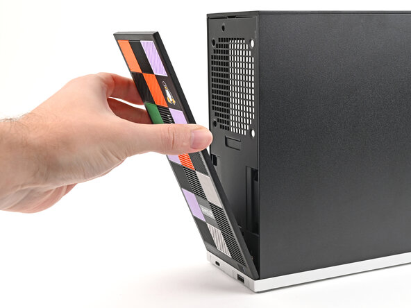

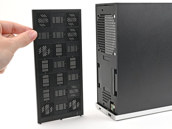

  1. How to Install and Remove Tiles, Remove the Front Panel: crwdns2935265:01crwdnd2935265:01crwdnd2935265:03crwdne2935265:0 How to Install and Remove Tiles, Remove the Front Panel: crwdns2935265:01crwdnd2935265:02crwdnd2935265:03crwdne2935265:0 How to Install and Remove Tiles, Remove the Front Panel: crwdns2935265:01crwdnd2935265:03crwdnd2935265:03crwdne2935265:0

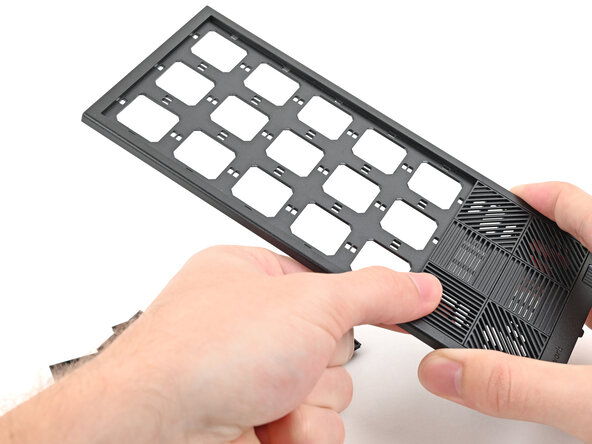

    • Use your fingers to pull the Front Panel off the magnets securing it to the chassis.

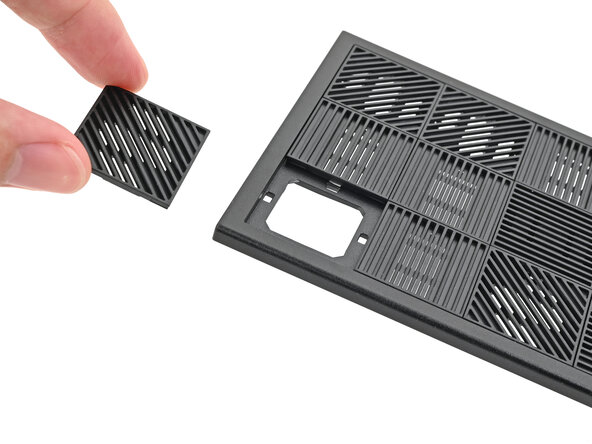

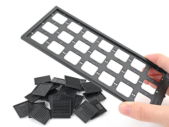

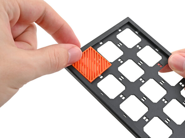

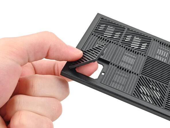

  2. How to Install and Remove Tiles, Remove the Tiles: crwdns2935265:02crwdnd2935265:01crwdnd2935265:03crwdne2935265:0 How to Install and Remove Tiles, Remove the Tiles: crwdns2935265:02crwdnd2935265:02crwdnd2935265:03crwdne2935265:0 How to Install and Remove Tiles, Remove the Tiles: crwdns2935265:02crwdnd2935265:03crwdnd2935265:03crwdne2935265:0
    • Use your fingers to push the bottom of the Tile up and off the front panel and release its clips.
    • Remove the Tile.
  3. How to Install and Remove Tiles: crwdns2935265:03crwdnd2935265:01crwdnd2935265:03crwdne2935265:0 How to Install and Remove Tiles: crwdns2935265:03crwdnd2935265:02crwdnd2935265:03crwdne2935265:0 How to Install and Remove Tiles: crwdns2935265:03crwdnd2935265:03crwdnd2935265:03crwdne2935265:0
    • Repeat this procedure for the remaining tiles.

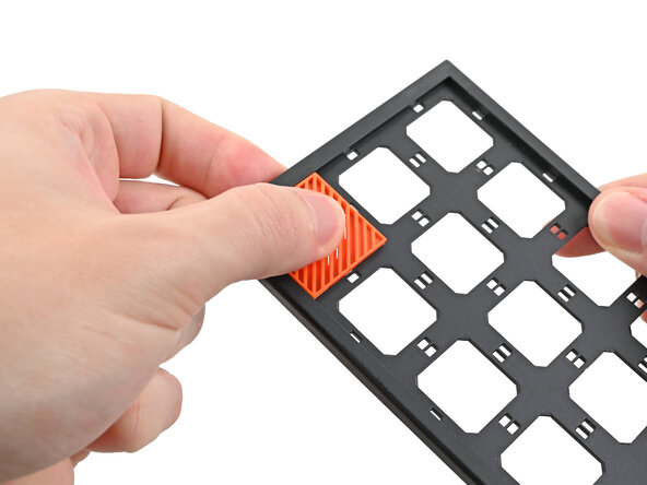

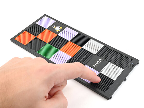

  4. How to Install and Remove Tiles, Install the Tiles: crwdns2935265:04crwdnd2935265:01crwdnd2935265:03crwdne2935265:0 How to Install and Remove Tiles, Install the Tiles: crwdns2935265:04crwdnd2935265:02crwdnd2935265:03crwdne2935265:0 How to Install and Remove Tiles, Install the Tiles: crwdns2935265:04crwdnd2935265:03crwdnd2935265:03crwdne2935265:0
    • Tiles can be installed in any orientation, even the ones with graphics.
    • Lay a Tile over an open slot on your Front Panel.
    • Use your fingers to press the tile into the slot and engage the clips.
    • You'll hear and feel an audible "click" when the clips engage.

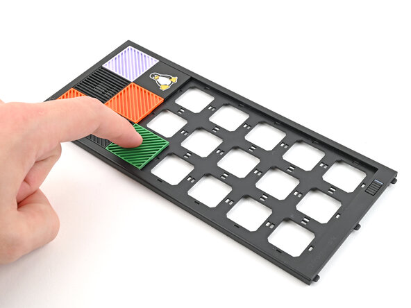

  5. How to Install and Remove Tiles: crwdns2935265:05crwdnd2935265:01crwdnd2935265:03crwdne2935265:0 How to Install and Remove Tiles: crwdns2935265:05crwdnd2935265:02crwdnd2935265:03crwdne2935265:0 How to Install and Remove Tiles: crwdns2935265:05crwdnd2935265:03crwdnd2935265:03crwdne2935265:0
    • Install the remaining Tiles.

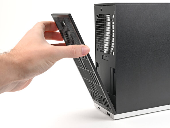

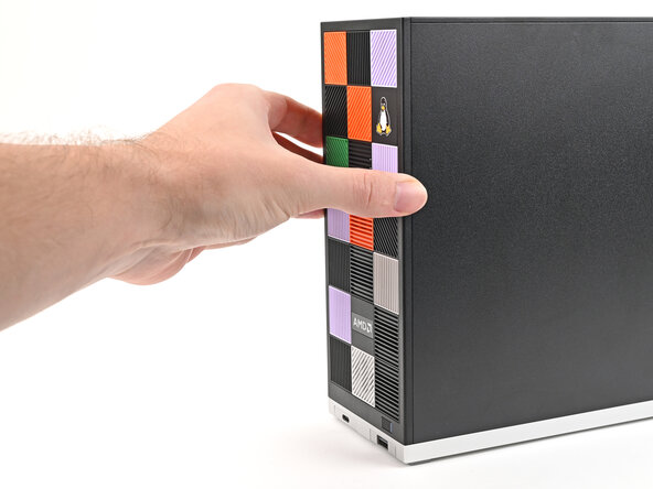

  6. How to Install and Remove Tiles: crwdns2935265:06crwdnd2935265:01crwdnd2935265:03crwdne2935265:0 How to Install and Remove Tiles: crwdns2935265:06crwdnd2935265:02crwdnd2935265:03crwdne2935265:0 How to Install and Remove Tiles: crwdns2935265:06crwdnd2935265:03crwdnd2935265:03crwdne2935265:0
    • Lay the bottom of the Front Panel on the small, protruding lip in the silver base to align its tabs.
    • Press the Front Panel flat to the chassis and let it align to the magnets.
