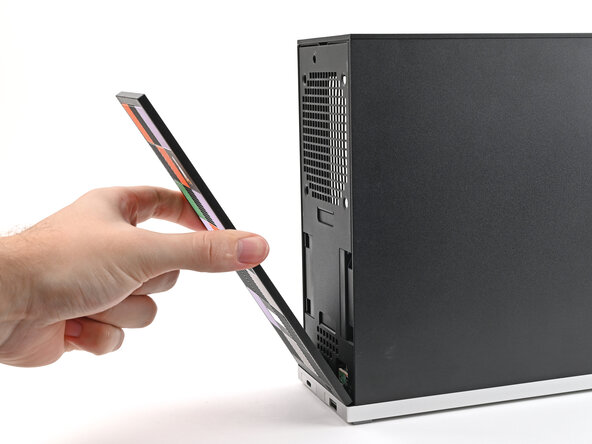

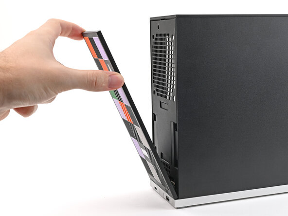

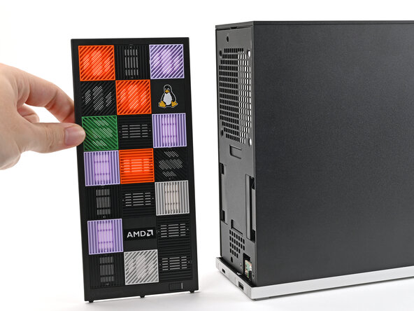

    1. Framework Desktop Front Panel Replacement, Remove the Front Panel: crwdns2935265:01crwdnd2935265:01crwdnd2935265:03crwdne2935265:0 Framework Desktop Front Panel Replacement, Remove the Front Panel: crwdns2935265:01crwdnd2935265:02crwdnd2935265:03crwdne2935265:0 Framework Desktop Front Panel Replacement, Remove the Front Panel: crwdns2935265:01crwdnd2935265:03crwdnd2935265:03crwdne2935265:0
      • Use your fingers to pull the Front Panel off the magnets securing it to the chassis.

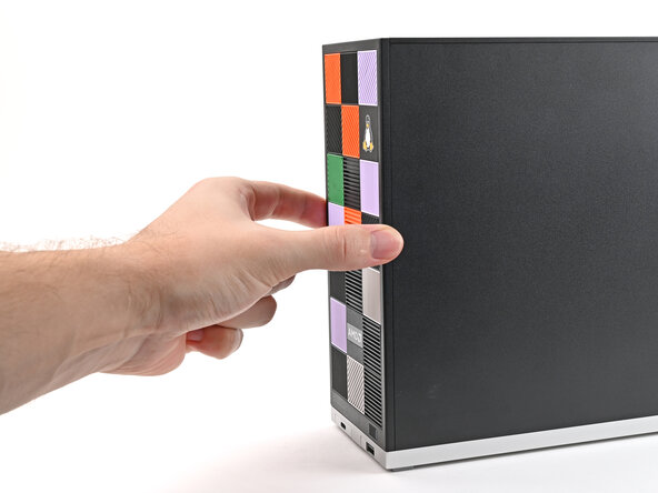

    1. Framework Desktop Front Panel Replacement, Install the Front Panel: crwdns2935265:02crwdnd2935265:01crwdnd2935265:03crwdne2935265:0 Framework Desktop Front Panel Replacement, Install the Front Panel: crwdns2935265:02crwdnd2935265:02crwdnd2935265:03crwdne2935265:0 Framework Desktop Front Panel Replacement, Install the Front Panel: crwdns2935265:02crwdnd2935265:03crwdnd2935265:03crwdne2935265:0
      • Lay the bottom of the Front Panel on the small, protruding lip in the silver base to align its tabs.
      • Press the Front Panel flat to the chassis and let it align to the magnets.
