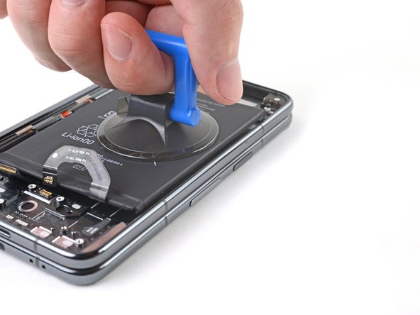

  5. Google Pixel Fold Inner Screen Assembly Replacement: crwdns2935265:05crwdnd2935265:01crwdnd2935265:03crwdne2935265:0 Google Pixel Fold Inner Screen Assembly Replacement: crwdns2935265:05crwdnd2935265:02crwdnd2935265:03crwdne2935265:0 Google Pixel Fold Inner Screen Assembly Replacement: crwdns2935265:05crwdnd2935265:03crwdnd2935265:03crwdne2935265:0
    • Place an object under your phone, like a box or a stack of books, so it rests level while between the Anti-Clamp's arms.
    • Pull the blue handle forward to lock the arms.
    • Turn the handle clockwise 360 degrees or until the cups start to stretch.
    • Make sure the suction cups remain aligned with each other. If they begin to slip out of alignment, detach the suction cups and realign the arms.

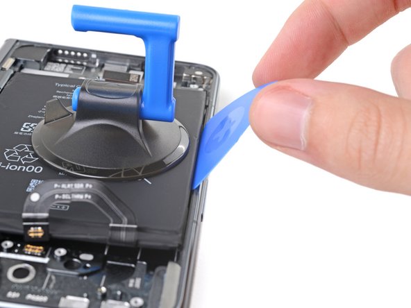

  6. Google Pixel Fold Inner Screen Assembly Replacement: crwdns2935265:06crwdnd2935265:01crwdnd2935265:01crwdne2935265:0
    • Insert an opening pick into the gap under the back glass.
    • If the Anti-Clamp doesn't create a sufficient gap, apply more heat to the area and rotate the handle a quarter turn.
    • Don't crank more than a quarter turn at a time, and wait one minute between turns. Let the Anti-Clamp and time do the work for you.
    • Skip the next step.

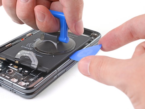

  7. Google Pixel Fold Inner Screen Assembly Replacement, Insert an opening pick: crwdns2935265:07crwdnd2935265:01crwdnd2935265:03crwdne2935265:0 Google Pixel Fold Inner Screen Assembly Replacement, Insert an opening pick: crwdns2935265:07crwdnd2935265:02crwdnd2935265:03crwdne2935265:0 Google Pixel Fold Inner Screen Assembly Replacement, Insert an opening pick: crwdns2935265:07crwdnd2935265:03crwdnd2935265:03crwdne2935265:0
    • Apply a suction cup to the back glass, as close to the center of the bottom edge as possible.
    • Pull up on the suction cup with strong, steady force to create a gap between the back glass and the frame.
    • Insert an opening pick into the gap.
    • Depending on the age of your phone, this may be difficult. If you're having trouble, apply more heat to the edge and try again.
    • If your back glass is badly cracked, covering it with a layer of clear packing tape may allow the suction cup to adhere. Alternatively, very strong tape may be used instead of the suction cup. If all else fails, you can superglue the suction cup to the broken back glass.

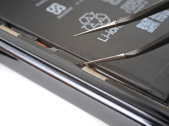

  19. Google Pixel Fold Inner Screen Assembly Replacement, Reposition the back glass: crwdns2935265:019crwdnd2935265:01crwdnd2935265:03crwdne2935265:0 Google Pixel Fold Inner Screen Assembly Replacement, Reposition the back glass: crwdns2935265:019crwdnd2935265:02crwdnd2935265:03crwdne2935265:0 Google Pixel Fold Inner Screen Assembly Replacement, Reposition the back glass: crwdns2935265:019crwdnd2935265:03crwdnd2935265:03crwdne2935265:0
    • Don't fully remove the back glass yet, as it's still connected to the phone by a cable.
    • At this point, the back glass should be separated from the frame. If there's still resistance around the edges, use an opening pick to separate any remaining adhesive.
    • Swing the left edge of the back glass up and over the right edge of the phone.
    • Lay the back glass to the right side of the phone before continuing.

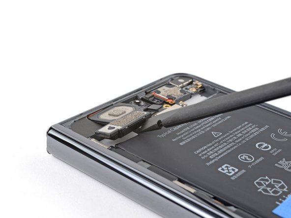

  20. Google Pixel Fold Inner Screen Assembly Replacement, Unfasten the middle bracket: crwdns2935265:020crwdnd2935265:01crwdnd2935265:01crwdne2935265:0
    FixMat
    $36.95
    • While the Pixel Fold uses Torx Plus screws, standard Torx bits also work. Use the same size or one size larger (T3 or T4 Torx bits with 3IP Torx Plus screws) and apply constant, downward force to prevent stripping.
    • Use a Torx Plus 3IP driver to remove the two 2.8 mm‑long screws securing the middle bracket.
  21. Google Pixel Fold Inner Screen Assembly Replacement, Remove the middle bracket: crwdns2935265:021crwdnd2935265:01crwdnd2935265:03crwdne2935265:0 Google Pixel Fold Inner Screen Assembly Replacement, Remove the middle bracket: crwdns2935265:021crwdnd2935265:02crwdnd2935265:03crwdne2935265:0 Google Pixel Fold Inner Screen Assembly Replacement, Remove the middle bracket: crwdns2935265:021crwdnd2935265:03crwdnd2935265:03crwdne2935265:0
    • Use tweezers, or your fingers, to pull the middle bracket toward the left edge of the phone and release its clip.
    • Remove the middle bracket.
    • During reassembly, reinsert the middle bracket clip under its slot in the frame before aligning the screw holes.

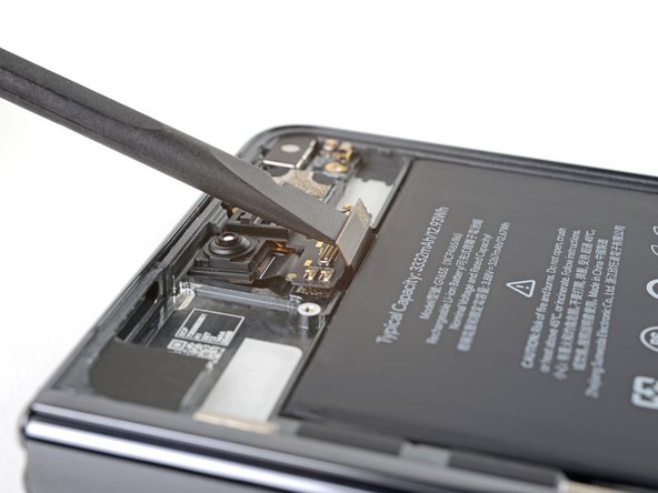

  22. Google Pixel Fold Inner Screen Assembly Replacement, Disconnect the back glass cable: crwdns2935265:022crwdnd2935265:01crwdnd2935265:02crwdne2935265:0 Google Pixel Fold Inner Screen Assembly Replacement, Disconnect the back glass cable: crwdns2935265:022crwdnd2935265:02crwdnd2935265:02crwdne2935265:0
    • Use the point of a spudger to pry up and disconnect the back glass cable from the motherboard.
    • To re-attach press connectors like this one, carefully align and press down on one side until it clicks into place, then repeat on the other side. Don't press down in the middle. If the connector is misaligned, the pins can bend and cause permanent damage.

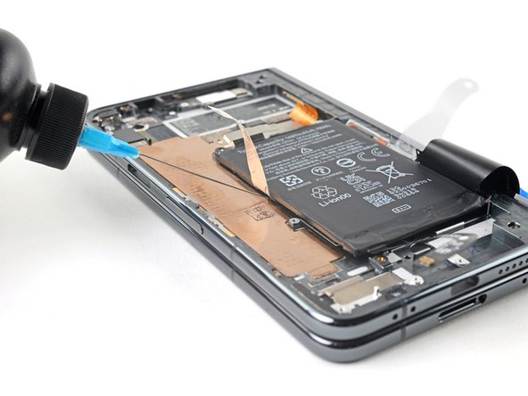

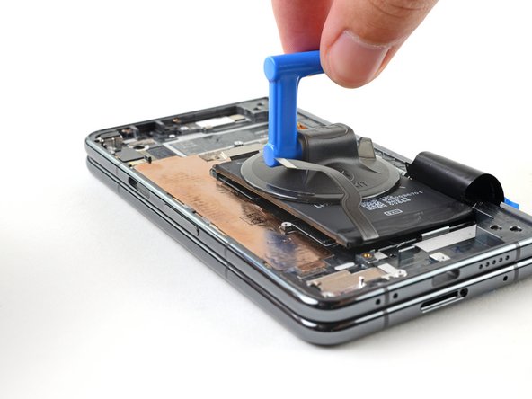

  29. Google Pixel Fold Inner Screen Assembly Replacement, Disconnect the base battery: crwdns2935265:029crwdnd2935265:01crwdnd2935265:02crwdne2935265:0 Google Pixel Fold Inner Screen Assembly Replacement, Disconnect the base battery: crwdns2935265:029crwdnd2935265:02crwdnd2935265:02crwdne2935265:0
    • There are two batteries you need to disconnect, one for each half of the phone.
    • Use the point of a spudger to pry up and disconnect the base battery cable press connector.

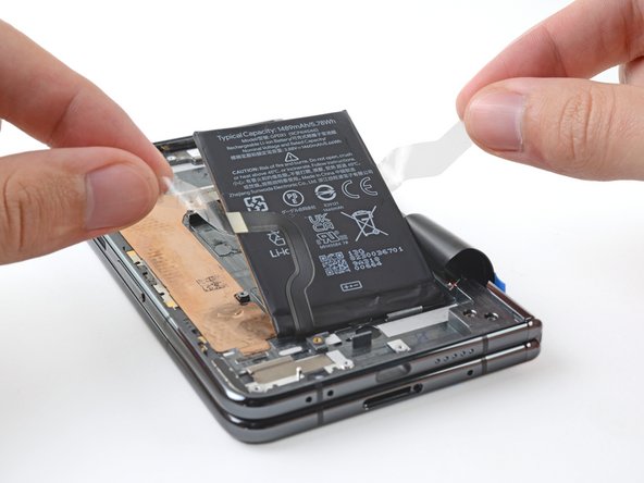

  30. Google Pixel Fold Inner Screen Assembly Replacement, Remove the tape: crwdns2935265:030crwdnd2935265:01crwdnd2935265:02crwdne2935265:0 Google Pixel Fold Inner Screen Assembly Replacement, Remove the tape: crwdns2935265:030crwdnd2935265:02crwdnd2935265:02crwdne2935265:0
    • Peel the grey conductive tape off the bottom interconnect cable.
  31. Google Pixel Fold Inner Screen Assembly Replacement, Disconnect the flip battery: crwdns2935265:031crwdnd2935265:01crwdnd2935265:03crwdne2935265:0 Google Pixel Fold Inner Screen Assembly Replacement, Disconnect the flip battery: crwdns2935265:031crwdnd2935265:02crwdnd2935265:03crwdne2935265:0 Google Pixel Fold Inner Screen Assembly Replacement, Disconnect the flip battery: crwdns2935265:031crwdnd2935265:03crwdnd2935265:03crwdne2935265:0
    • Use a point of a spudger to pry up and disconnect the flip battery and bottom interconnect press connectors.
    • You have to disconnect both cables to keep the battery connector from accidentally touching the logic board.

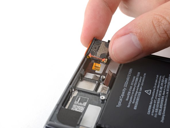

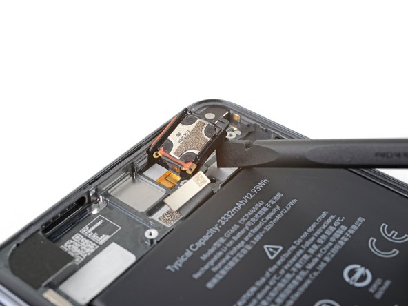

  34. Google Pixel Fold Inner Screen Assembly Replacement, Disconnect the ultra wideband antenna: crwdns2935265:034crwdnd2935265:01crwdnd2935265:02crwdne2935265:0 Google Pixel Fold Inner Screen Assembly Replacement, Disconnect the ultra wideband antenna: crwdns2935265:034crwdnd2935265:02crwdnd2935265:02crwdne2935265:0
    • If your graphite sheet is taped out of the way, remove the tape now.
    • Use the point of a spudger to pry up and disconnect the ultra wideband antenna press connector.

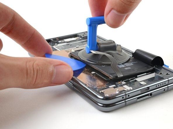

  35. Google Pixel Fold Inner Screen Assembly Replacement, Separate the adhesive: crwdns2935265:035crwdnd2935265:01crwdnd2935265:02crwdne2935265:0 Google Pixel Fold Inner Screen Assembly Replacement, Separate the adhesive: crwdns2935265:035crwdnd2935265:02crwdnd2935265:02crwdne2935265:0
    • The ultra wideband antenna is lightly adhered to the graphite sheet.
    • Slide an opening pick under the antenna to separate its adhesive.

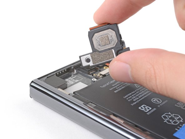

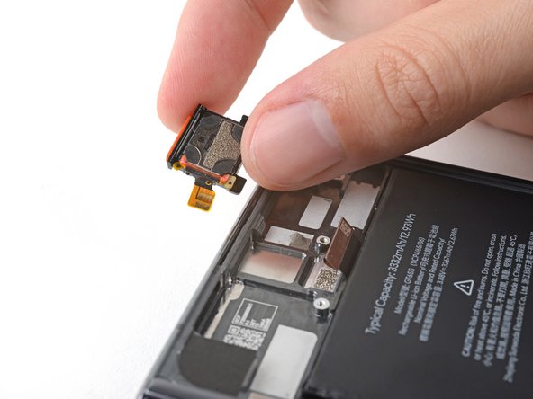

  40. Google Pixel Fold Inner Screen Assembly Replacement, Remove the bottom speaker: crwdns2935265:040crwdnd2935265:01crwdnd2935265:03crwdne2935265:0 Google Pixel Fold Inner Screen Assembly Replacement, Remove the bottom speaker: crwdns2935265:040crwdnd2935265:02crwdnd2935265:03crwdne2935265:0 Google Pixel Fold Inner Screen Assembly Replacement, Remove the bottom speaker: crwdns2935265:040crwdnd2935265:03crwdnd2935265:03crwdne2935265:0
    Tesa 61395 Tape
    $5.99
    • Don't pry against the battery with the spudger, as you risk damaging it.
    • Insert the flat end of a spudger between the battery and the bottom speaker.
    • Twist the spudger to separate the adhesive securing the bottom speaker.
    • Remove the bottom speaker.
    • During reassembly, if your adhesive is still intact and sticky, you can reuse it. Otherwise, follow this guide to replace the adhesive.
    • If you don't have custom cut adhesive strips, use double-sided tape, like Tesa Tape, to secure the speaker to the frame.

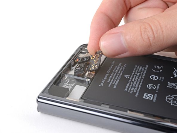

  50. Google Pixel Fold Inner Screen Assembly Replacement, Disconnect the front camera: crwdns2935265:050crwdnd2935265:01crwdnd2935265:02crwdne2935265:0 Google Pixel Fold Inner Screen Assembly Replacement, Disconnect the front camera: crwdns2935265:050crwdnd2935265:02crwdnd2935265:02crwdne2935265:0
    • Insert the point of a spudger under the bottom right corner of the front camera press connector.
    • Don't insert the spudger anywhere else, as you risk breaking surface-mounted components on the logic board.
    • Pry up and disconnect the front camera press connector.

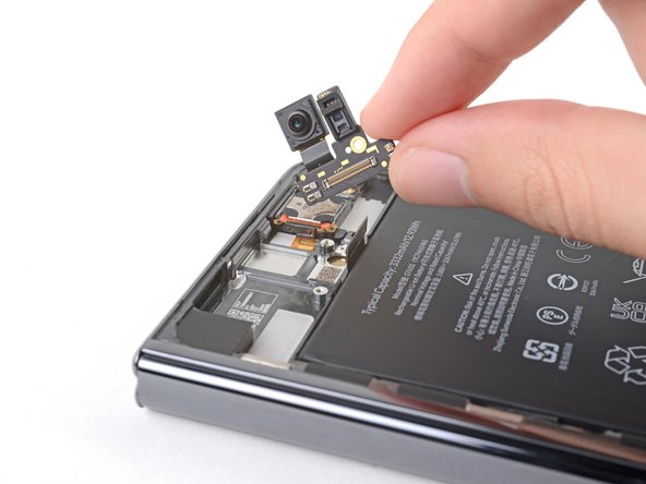

  52. Google Pixel Fold Inner Screen Assembly Replacement, Remove the front camera: crwdns2935265:052crwdnd2935265:01crwdnd2935265:03crwdne2935265:0 Google Pixel Fold Inner Screen Assembly Replacement, Remove the front camera: crwdns2935265:052crwdnd2935265:02crwdnd2935265:03crwdne2935265:0 Google Pixel Fold Inner Screen Assembly Replacement, Remove the front camera: crwdns2935265:052crwdnd2935265:03crwdnd2935265:03crwdne2935265:0
    Tesa 61395 Tape
    $5.99
    • Use tweezers to grab the front camera by its connector, as close to the camera body as possible.
    • Don't pinch the press connector's pins, as you may bend them.
    • Pull straight up to separate the adhesive and remove the front camera.
    • If you don't have custom cut adhesive strips, use double-sided tape, like Tesa Tape, to secure the front camera to the frame.

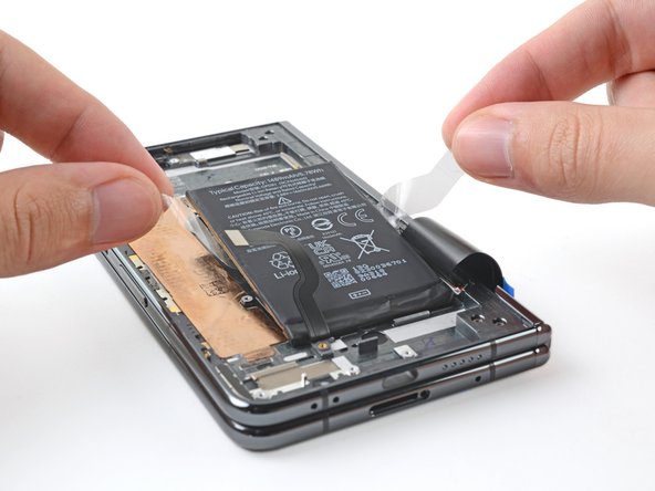

  66. Google Pixel Fold Inner Screen Assembly Replacement, Separate the battery pull tabs: crwdns2935265:066crwdnd2935265:01crwdnd2935265:03crwdne2935265:0 Google Pixel Fold Inner Screen Assembly Replacement, Separate the battery pull tabs: crwdns2935265:066crwdnd2935265:02crwdnd2935265:03crwdne2935265:0 Google Pixel Fold Inner Screen Assembly Replacement, Separate the battery pull tabs: crwdns2935265:066crwdnd2935265:03crwdnd2935265:03crwdne2935265:0
    • Take care not to puncture or bend the battery with sharp tools—it can leak dangerous chemicals and/or catch fire.
    • Use a pair of blunt nose tweezers, or your fingers, to peel the clear plastic pull tabs away from the battery.
  67. Google Pixel Fold Inner Screen Assembly Replacement, Heat the battery adhesive: crwdns2935265:067crwdnd2935265:01crwdnd2935265:01crwdne2935265:0
    • Unfold the phone and flip it over.
    • Heat an iOpener and apply it the section of the inner screen above the base battery for two minutes.
    • You can also use a hair dryer, heat gun, or hot plate—but extreme heat can damage the displays and/or internal batteries, so proceed with care.
  68. Google Pixel Fold Inner Screen Assembly Replacement, Separate the adhesive: crwdns2935265:068crwdnd2935265:01crwdnd2935265:03crwdne2935265:0 Google Pixel Fold Inner Screen Assembly Replacement, Separate the adhesive: crwdns2935265:068crwdnd2935265:02crwdnd2935265:03crwdne2935265:0 Google Pixel Fold Inner Screen Assembly Replacement, Separate the adhesive: crwdns2935265:068crwdnd2935265:03crwdnd2935265:03crwdne2935265:0
    • The battery adhesive is extremely strong. Be careful when pulling on the battery and reapply heat if necessary to avoid bending the battery.
    • Close your phone.
    • Grip the ends of the plastic pull tabs with your fingers.
    • Pull straight up with constant, steady force to separate the adhesive under the battery. Work slowly and let time do the work for you until the adhesive separates.
    • If you're having trouble separating the adhesive, apply more heat and try again.
    • If you're having a lot of trouble separating the adhesive, or if you feel like you might damage the battery, follow the next five steps for an alternate method. If you were successful, jump to this step.

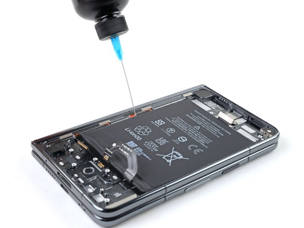

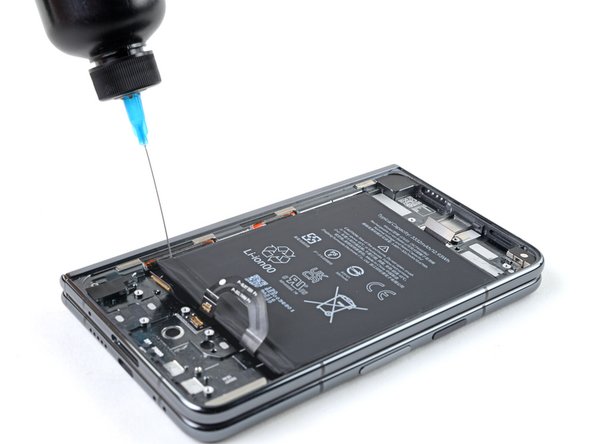

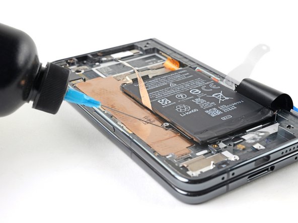

  69. Google Pixel Fold Inner Screen Assembly Replacement, Apply isopropyl alcohol: crwdns2935265:069crwdnd2935265:01crwdnd2935265:03crwdne2935265:0 Google Pixel Fold Inner Screen Assembly Replacement, Apply isopropyl alcohol: crwdns2935265:069crwdnd2935265:02crwdnd2935265:03crwdne2935265:0 Google Pixel Fold Inner Screen Assembly Replacement, Apply isopropyl alcohol: crwdns2935265:069crwdnd2935265:03crwdnd2935265:03crwdne2935265:0
    • Take care not to puncture or bend the battery with your tool—a punctured or bent battery may leak dangerous chemicals or cause a fire.
    • Apply a few drops of high concentration (>90%) isopropyl alcohol in the gap between the frame and the left edge of the battery.
  70. Google Pixel Fold Inner Screen Assembly Replacement, Tilt the phone: crwdns2935265:070crwdnd2935265:01crwdnd2935265:02crwdne2935265:0 Google Pixel Fold Inner Screen Assembly Replacement, Tilt the phone: crwdns2935265:070crwdnd2935265:02crwdnd2935265:02crwdne2935265:0
    • Tilt the left side of the phone up to let the isopropyl alcohol flow under the battery.
    • Wait one minute for the alcohol to soften the adhesive.

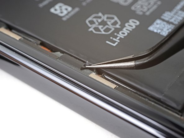

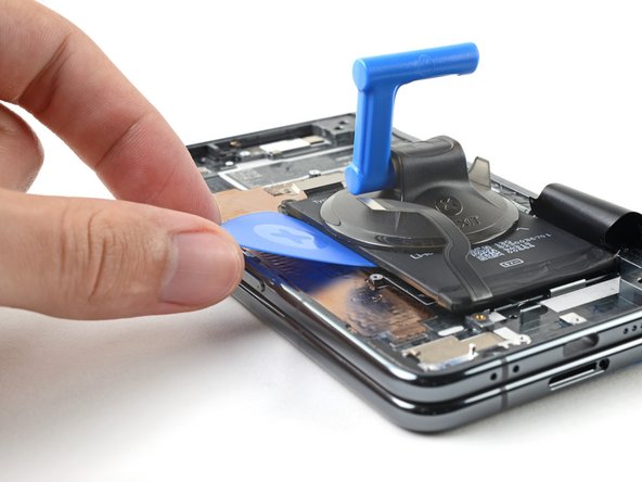

  71. Google Pixel Fold Inner Screen Assembly Replacement, Insert an opening pick: crwdns2935265:071crwdnd2935265:01crwdnd2935265:03crwdne2935265:0 Google Pixel Fold Inner Screen Assembly Replacement, Insert an opening pick: crwdns2935265:071crwdnd2935265:02crwdnd2935265:03crwdne2935265:0 Google Pixel Fold Inner Screen Assembly Replacement, Insert an opening pick: crwdns2935265:071crwdnd2935265:03crwdnd2935265:03crwdne2935265:0
    • Take care not to puncture or bend the battery—it can leak dangerous chemicals and/or catch fire.
    • Apply a suction cup to the battery, as close to the center of the left edge as possible.
    • Pull up on the suction cup with strong, steady force to create a gap between the battery and the frame.
  72. Google Pixel Fold Inner Screen Assembly Replacement, Rotate the pick: crwdns2935265:072crwdnd2935265:01crwdnd2935265:02crwdne2935265:0 Google Pixel Fold Inner Screen Assembly Replacement, Rotate the pick: crwdns2935265:072crwdnd2935265:02crwdnd2935265:02crwdne2935265:0
    • Rotate the opening pick so its long edge sits in the gap.

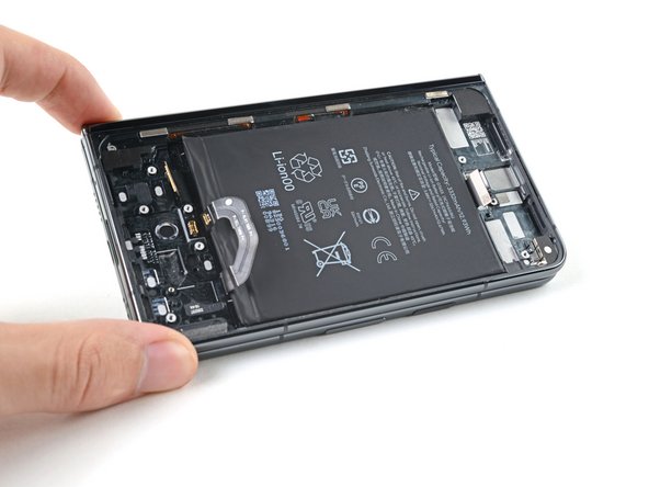

  73. Google Pixel Fold Inner Screen Assembly Replacement, Pry up the battery: crwdns2935265:073crwdnd2935265:01crwdnd2935265:02crwdne2935265:0 Google Pixel Fold Inner Screen Assembly Replacement, Pry up the battery: crwdns2935265:073crwdnd2935265:02crwdnd2935265:02crwdne2935265:0
    • Pull up on the suction cup with strong, steady force while also prying up with the opening pick to separate the battery from the frame.
    • If you're feeling a lot of resistance, apply a few more drops of isopropyl alcohol and try again.
    • Depending on the condition of your adhesive, you might need to repeat the alcohol and prying cycle a few times before the battery adhesive yields.
  74. Google Pixel Fold Inner Screen Assembly Replacement, Remove the battery: crwdns2935265:074crwdnd2935265:01crwdnd2935265:01crwdne2935265:0
    Tesa 61395 Tape
    $5.99
    • Lift the battery out of its recess and remove it.
    • During reassembly, if your adhesive is still intact and sticky, then you can reuse it. Otherwise, follow this guide to replace the adhesive with custom cut strips.
    • If you don't have custom cut adhesive strips, use double-sided tape, like Tesa Tape, to secure the battery to the frame.

  107. Google Pixel Fold Inner Screen Assembly Replacement, Remove the top speaker: crwdns2935265:0107crwdnd2935265:01crwdnd2935265:03crwdne2935265:0 Google Pixel Fold Inner Screen Assembly Replacement, Remove the top speaker: crwdns2935265:0107crwdnd2935265:02crwdnd2935265:03crwdne2935265:0 Google Pixel Fold Inner Screen Assembly Replacement, Remove the top speaker: crwdns2935265:0107crwdnd2935265:03crwdnd2935265:03crwdne2935265:0
    Tesa 61395 Tape
    $5.99
    • The top speaker is lightly adhered to the frame.
    • Insert the flat end of a spudger between the battery and the bottom edge of the top speaker.
    • Remove the top speaker.
  108. Google Pixel Fold Inner Screen Assembly Replacement, Disconnect the top interconnect cable: crwdns2935265:0108crwdnd2935265:01crwdnd2935265:02crwdne2935265:0 Google Pixel Fold Inner Screen Assembly Replacement, Disconnect the top interconnect cable: crwdns2935265:0108crwdnd2935265:02crwdnd2935265:02crwdne2935265:0
    • Use the flat end of spudger to pry up and disconnect the top interconnect cable press connector.
  109. Google Pixel Fold Inner Screen Assembly Replacement, Remove the upper board: crwdns2935265:0109crwdnd2935265:01crwdnd2935265:03crwdne2935265:0 Google Pixel Fold Inner Screen Assembly Replacement, Remove the upper board: crwdns2935265:0109crwdnd2935265:02crwdnd2935265:03crwdne2935265:0 Google Pixel Fold Inner Screen Assembly Replacement, Remove the upper board: crwdns2935265:0109crwdnd2935265:03crwdnd2935265:03crwdne2935265:0
    • Pull the upper board toward the bottom of the phone to separate it from its recess in the frame
    • Remove the upper board.
    • During reassembly, make sure the upper board sits in its alignment peg before securing anything to it.

  112. Google Pixel Fold Inner Screen Assembly Replacement, Heat the earpiece speaker: crwdns2935265:0112crwdnd2935265:01crwdnd2935265:01crwdne2935265:0
    • Heat an iOpener and apply it to the earpiece speaker for two minutes.
  113. Google Pixel Fold Inner Screen Assembly Replacement, Separate the adhesive: crwdns2935265:0113crwdnd2935265:01crwdnd2935265:02crwdne2935265:0 Google Pixel Fold Inner Screen Assembly Replacement, Separate the adhesive: crwdns2935265:0113crwdnd2935265:02crwdnd2935265:02crwdne2935265:0
    • Insert the flat end of a spudger between the frame and the bottom of the earpiece speaker.
    • Twist the spudger to separate the adhesive under the body of the earpiece speaker.
    • If you're having trouble separating the adhesive, you can also use an opening pick to slide under the speaker.
  114. Google Pixel Fold Inner Screen Assembly Replacement, Remove the earpiece speaker: crwdns2935265:0114crwdnd2935265:01crwdnd2935265:03crwdne2935265:0 Google Pixel Fold Inner Screen Assembly Replacement, Remove the earpiece speaker: crwdns2935265:0114crwdnd2935265:02crwdnd2935265:03crwdne2935265:0 Google Pixel Fold Inner Screen Assembly Replacement, Remove the earpiece speaker: crwdns2935265:0114crwdnd2935265:03crwdnd2935265:03crwdne2935265:0
    Tesa 61395 Tape
    $5.99
    • The earpiece speaker connector is mildly adhered to the frame.
    • Grab the right edge of the earpiece speaker and pull it away from the frame to separate the connector adhesive.
    • If you're feeling a lot of resistance, apply heat and try again.
    • Remove the earpiece speaker.
    • During reassembly, if your adhesive is still intact and sticky, you can reuse it. Otherwise, follow this guide to replace the adhesive with custom cut strips.

  117. Google Pixel Fold Inner Screen Assembly Replacement, Adhesive information: crwdns2935265:0117crwdnd2935265:01crwdnd2935265:02crwdne2935265:0 Google Pixel Fold Inner Screen Assembly Replacement, Adhesive information: crwdns2935265:0117crwdnd2935265:02crwdnd2935265:02crwdne2935265:0
    • Six stretch release adhesive strips secure the battery to the frame:
    • The three along the left edge are very difficult to remove. Work slowly and avoid pulling the strips at steep angles.
    • The three along the bottom are moderately difficult to remove.
  118. Google Pixel Fold Inner Screen Assembly Replacement, Peel up the tabs: crwdns2935265:0118crwdnd2935265:01crwdnd2935265:03crwdne2935265:0 Google Pixel Fold Inner Screen Assembly Replacement, Peel up the tabs: crwdns2935265:0118crwdnd2935265:02crwdnd2935265:03crwdne2935265:0 Google Pixel Fold Inner Screen Assembly Replacement, Peel up the tabs: crwdns2935265:0118crwdnd2935265:03crwdnd2935265:03crwdne2935265:0
    • Use tweezers to peel the black pull tabs from off the frame so you can grip them with your fingers.
    • Some of the black tabs aren't adhered and don't require peeling.
  119. Google Pixel Fold Inner Screen Assembly Replacement, Remove the stretch release adhesive: crwdns2935265:0119crwdnd2935265:01crwdnd2935265:03crwdne2935265:0 Google Pixel Fold Inner Screen Assembly Replacement, Remove the stretch release adhesive: crwdns2935265:0119crwdnd2935265:02crwdnd2935265:03crwdne2935265:0 Google Pixel Fold Inner Screen Assembly Replacement, Remove the stretch release adhesive: crwdns2935265:0119crwdnd2935265:03crwdnd2935265:03crwdne2935265:0
    • Pull each strip out slowly and steadily at a low angle. Give them plenty of time to stretch and un-stick from under the battery.
    • You can also wrap an adhesive strip around a spudger and "roll" it for a more consistent pull.
    • If any adhesive strips break off, try to retrieve them using your fingers or tweezers, and continue pulling—but don’t pry under the battery.
    • If you can't retrieve a strip, don't worry! Remove as much adhesive as possible and move to the next step for an alternate method.
    • Repeat for all six stretch release adhesive strips.
  120. Google Pixel Fold Inner Screen Assembly Replacement, Apply isopropyl alcohol: crwdns2935265:0120crwdnd2935265:01crwdnd2935265:03crwdne2935265:0 Google Pixel Fold Inner Screen Assembly Replacement, Apply isopropyl alcohol: crwdns2935265:0120crwdnd2935265:02crwdnd2935265:03crwdne2935265:0 Google Pixel Fold Inner Screen Assembly Replacement, Apply isopropyl alcohol: crwdns2935265:0120crwdnd2935265:03crwdnd2935265:03crwdne2935265:0
    • If all six of the stretch release adhesive strips separated cleanly, skip the next five steps. Otherwise, follow these steps for an alternate method.
  121. Google Pixel Fold Inner Screen Assembly Replacement, Tilt the phone: crwdns2935265:0121crwdnd2935265:01crwdnd2935265:02crwdne2935265:0 Google Pixel Fold Inner Screen Assembly Replacement, Tilt the phone: crwdns2935265:0121crwdnd2935265:02crwdnd2935265:02crwdne2935265:0
  122. Google Pixel Fold Inner Screen Assembly Replacement, Insert an opening pick: crwdns2935265:0122crwdnd2935265:01crwdnd2935265:03crwdne2935265:0 Google Pixel Fold Inner Screen Assembly Replacement, Insert an opening pick: crwdns2935265:0122crwdnd2935265:02crwdnd2935265:03crwdne2935265:0 Google Pixel Fold Inner Screen Assembly Replacement, Insert an opening pick: crwdns2935265:0122crwdnd2935265:03crwdnd2935265:03crwdne2935265:0
    • Apply a suction cup to the battery, as close to the center of the right edge as possible.
  123. Google Pixel Fold Inner Screen Assembly Replacement, Rotate the pick: crwdns2935265:0123crwdnd2935265:01crwdnd2935265:02crwdne2935265:0 Google Pixel Fold Inner Screen Assembly Replacement, Rotate the pick: crwdns2935265:0123crwdnd2935265:02crwdnd2935265:02crwdne2935265:0
  124. Google Pixel Fold Inner Screen Assembly Replacement, Pry up the battery: crwdns2935265:0124crwdnd2935265:01crwdnd2935265:03crwdne2935265:0 Google Pixel Fold Inner Screen Assembly Replacement, Pry up the battery: crwdns2935265:0124crwdnd2935265:02crwdnd2935265:03crwdne2935265:0 Google Pixel Fold Inner Screen Assembly Replacement, Pry up the battery: crwdns2935265:0124crwdnd2935265:03crwdnd2935265:03crwdne2935265:0
  125. Google Pixel Fold Inner Screen Assembly Replacement, Remove the battery: crwdns2935265:0125crwdnd2935265:01crwdnd2935265:01crwdne2935265:0
    Tesa 61395 Tape
    $5.99
    • If your bottom interconnect cable is still taped down, remove the tape now.
    • Lift the battery out its recess and remove it.
