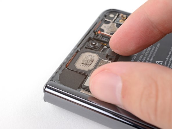

  1. How to Apply New Top Speaker Adhesive in Your Google Pixel Fold, Remove the old adhesive: crwdns2935265:01crwdnd2935265:01crwdnd2935265:02crwdne2935265:0 How to Apply New Top Speaker Adhesive in Your Google Pixel Fold, Remove the old adhesive: crwdns2935265:01crwdnd2935265:02crwdnd2935265:02crwdne2935265:0
    • Use tweezers, or your fingers, to peel off the adhesive strip from the top speaker.
    • Peel off the new adhesive strip from its liner.
  2. How to Apply New Top Speaker Adhesive in Your Google Pixel Fold, Apply the adhesive: crwdns2935265:02crwdnd2935265:01crwdnd2935265:03crwdne2935265:0 How to Apply New Top Speaker Adhesive in Your Google Pixel Fold, Apply the adhesive: crwdns2935265:02crwdnd2935265:02crwdnd2935265:03crwdne2935265:0 How to Apply New Top Speaker Adhesive in Your Google Pixel Fold, Apply the adhesive: crwdns2935265:02crwdnd2935265:03crwdnd2935265:03crwdne2935265:0
    • Place the new adhesive on the top speaker.
    • Use a spudger, or your fingers, to press down the adhesive and adhere it to the speaker.
    • Use tweezers, or your fingers, to pull on the tab and expose the top layer of adhesive.

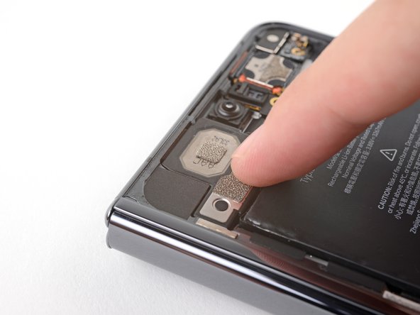

  3. How to Apply New Top Speaker Adhesive in Your Google Pixel Fold, Secure the top speaker: crwdns2935265:03crwdnd2935265:01crwdnd2935265:03crwdne2935265:0 How to Apply New Top Speaker Adhesive in Your Google Pixel Fold, Secure the top speaker: crwdns2935265:03crwdnd2935265:02crwdnd2935265:03crwdne2935265:0 How to Apply New Top Speaker Adhesive in Your Google Pixel Fold, Secure the top speaker: crwdns2935265:03crwdnd2935265:03crwdnd2935265:03crwdne2935265:0
    • Insert the top speaker at a shallow angle into its recess in the frame.
    • Push the speaker towards the top edge of the phone until it sits flat in the frame.
    • Push down on the speaker to adhere it to the frame.
