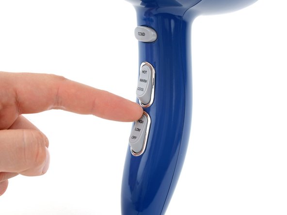

  3. How to Use a Hair Dryer to Soften Adhesive, Turn on your hair dryer: crwdns2935265:03crwdnd2935265:01crwdnd2935265:03crwdne2935265:0 How to Use a Hair Dryer to Soften Adhesive, Turn on your hair dryer: crwdns2935265:03crwdnd2935265:02crwdnd2935265:03crwdne2935265:0 How to Use a Hair Dryer to Soften Adhesive, Turn on your hair dryer: crwdns2935265:03crwdnd2935265:03crwdnd2935265:03crwdne2935265:0
    • Set the temperature of your hair dryer to its "hot" setting.
    • Set the fan setting to "Low" for small parts, such as cables or tape.
    • Set the fan setting to "High" for large surfaces, such as screens or back covers.

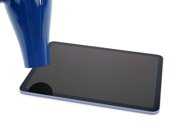

  4. How to Use a Hair Dryer to Soften Adhesive, Soften the adhesive: crwdns2935265:04crwdnd2935265:01crwdnd2935265:03crwdne2935265:0 How to Use a Hair Dryer to Soften Adhesive, Soften the adhesive: crwdns2935265:04crwdnd2935265:02crwdnd2935265:03crwdne2935265:0 How to Use a Hair Dryer to Soften Adhesive, Soften the adhesive: crwdns2935265:04crwdnd2935265:03crwdnd2935265:03crwdne2935265:0
    • Position the nozzle of your hair dryer 2–3 inches above the device.
    • Move the hair dryer along the surface of your device.
    • Never leave your hair dryer in one spot for an extended period of time.
    • Heat the surface until it's hot to the touch, or as directed by the repair guide.
    • If you’re heating an OLED screen, don’t heat it over 176 °F (80 °C) or you may damage the OLED screen.
    • If you’re heating the adhesive underneath the battery, make sure the battery doesn’t go over 150 °F (66 °C) or you may damage the battery.
    • Make sure to turn off your hair dryer before setting it down to continue the repair.

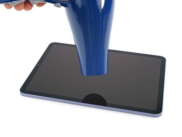

  5. How to Use a Hair Dryer to Soften Adhesive: crwdns2935265:05crwdnd2935265:01crwdnd2935265:03crwdne2935265:0 How to Use a Hair Dryer to Soften Adhesive: crwdns2935265:05crwdnd2935265:02crwdnd2935265:03crwdne2935265:0 How to Use a Hair Dryer to Soften Adhesive: crwdns2935265:05crwdnd2935265:03crwdnd2935265:03crwdne2935265:0
    • Keep your hair dryer in motion while heating smaller surfaces by moving it in circles above the device.
    • Some components, such as large screens, require multiple cycles of heating and slicing. Take your time and apply more heat if the component feels stuck.

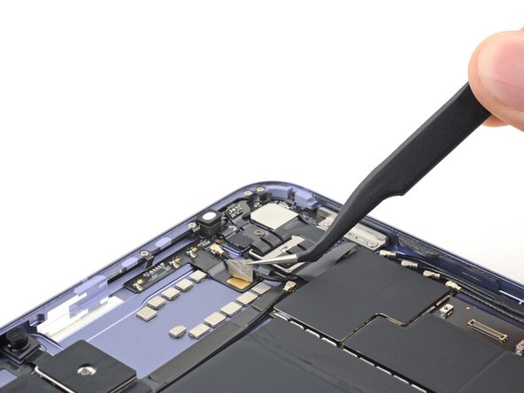

  6. How to Use a Hair Dryer to Soften Adhesive, Soften protective tape or film: crwdns2935265:06crwdnd2935265:01crwdnd2935265:02crwdne2935265:0 How to Use a Hair Dryer to Soften Adhesive, Soften protective tape or film: crwdns2935265:06crwdnd2935265:02crwdnd2935265:02crwdne2935265:0
    • This step shows how to use your hair dryer to loosen protective tape and stickers.
    • Position the nozzle of your hair dryer 2–3 inches above the device and set the fan setting to "Low".
    • Apply heat in small circles over the tape or sticker for 30 seconds.
    • Peel the tape from the device.

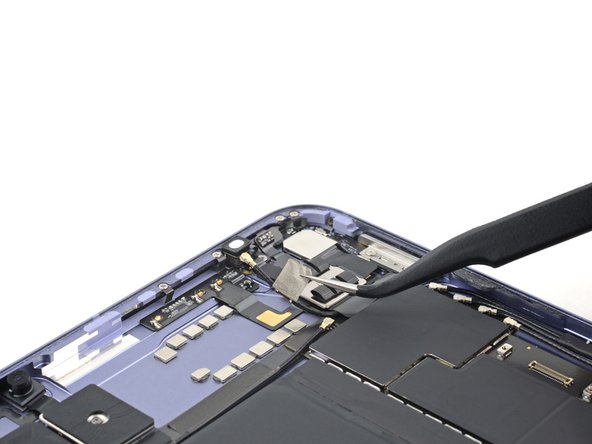

  7. How to Use a Hair Dryer to Soften Adhesive, Soften cable adhesive: crwdns2935265:07crwdnd2935265:01crwdnd2935265:03crwdne2935265:0 How to Use a Hair Dryer to Soften Adhesive, Soften cable adhesive: crwdns2935265:07crwdnd2935265:02crwdnd2935265:03crwdne2935265:0 How to Use a Hair Dryer to Soften Adhesive, Soften cable adhesive: crwdns2935265:07crwdnd2935265:03crwdnd2935265:03crwdne2935265:0
    • This step shows how to use your hair dryer to loosen cables adhered to your device.
    • Apply heat in small circles over the cable for 30 seconds.
    • Peel the cable from the device.
