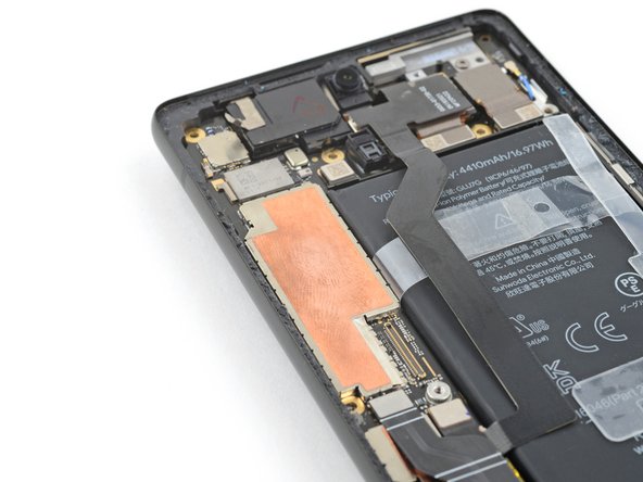

      • Look for existing thermal paste above or below the motherboard.
      • Thermal paste is often gray, but can be any color. It's opaque and thick, with a wet texture. Older thermal paste is drier.

      • Apply a small bead of thermal paste to the motherboard in the same location as the old thermal paste.
      • Unlike full-size processors found in computers with heatsinks, phones need very little thermal paste.
