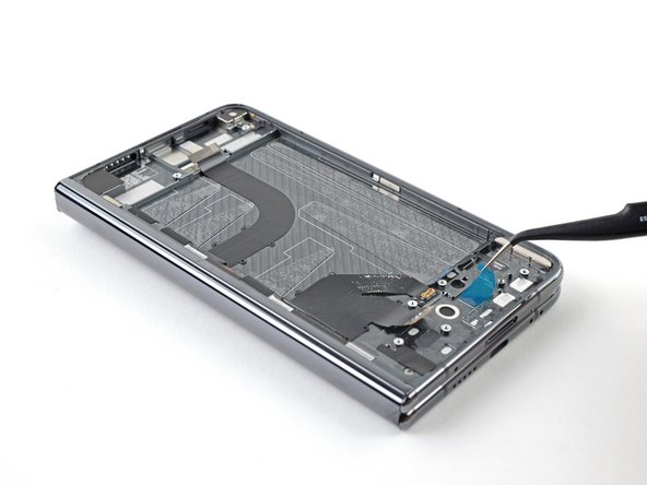

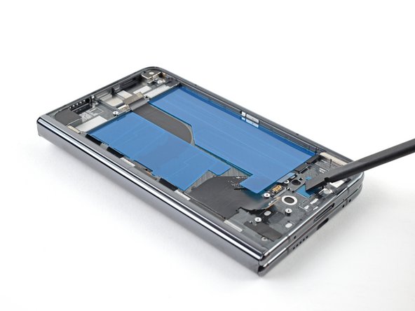

    • Apply a few drops of highly-concentrated isopropyl alcohol (over 90%) to the frame.
    • Use the flat end of a spudger and tweezers to remove the remaining adhesive residue from the frame.
    • Wipe off any remaining isopropyl alcohol with a lint-free or microfiber cloth.

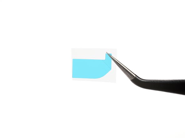

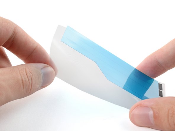

    • Place the new adhesive strips over the frame to check the proper orientation.
    • The clear liners should face the frame.
    • Use the white lines on the frame to align the adhesive strip corners.

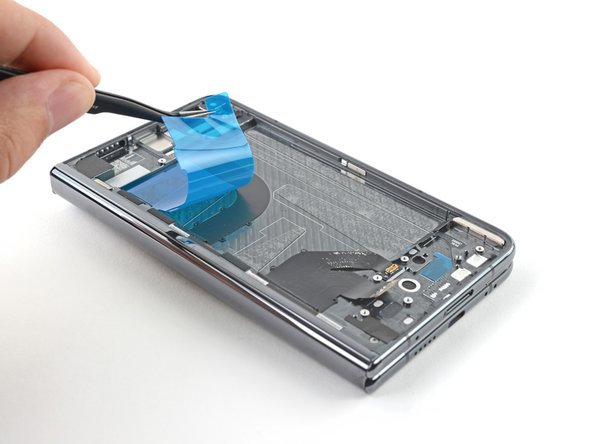

  3. How to Apply New Flip Battery Adhesive in Your Google Pixel Fold, Expose the adhesive: crwdns2935265:03crwdnd2935265:01crwdnd2935265:03crwdne2935265:0 How to Apply New Flip Battery Adhesive in Your Google Pixel Fold, Expose the adhesive: crwdns2935265:03crwdnd2935265:02crwdnd2935265:03crwdne2935265:0 How to Apply New Flip Battery Adhesive in Your Google Pixel Fold, Expose the adhesive: crwdns2935265:03crwdnd2935265:03crwdnd2935265:03crwdne2935265:0
    • Peel off the new adhesive strips from their clear liners.

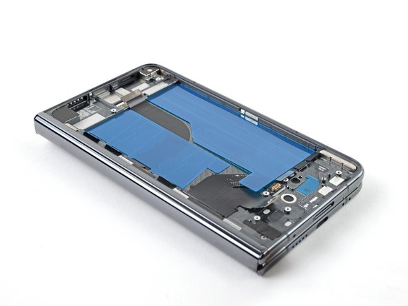

    • Apply the adhesive strips to their respective spots on the frame.
    • Make sure the black tabs on the left-most adhesive strip don't overlap where the screen adhesive sits.

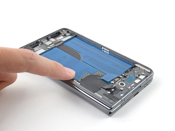

  5. How to Apply New Flip Battery Adhesive in Your Google Pixel Fold: crwdns2935265:05crwdnd2935265:01crwdnd2935265:03crwdne2935265:0 How to Apply New Flip Battery Adhesive in Your Google Pixel Fold: crwdns2935265:05crwdnd2935265:02crwdnd2935265:03crwdne2935265:0 How to Apply New Flip Battery Adhesive in Your Google Pixel Fold: crwdns2935265:05crwdnd2935265:03crwdnd2935265:03crwdne2935265:0
    • Use a spudger, or your fingers, to press down the three adhesive strips to adhere them.
    • Fold over the black tabs on the left-most adhesive strip onto the frame.

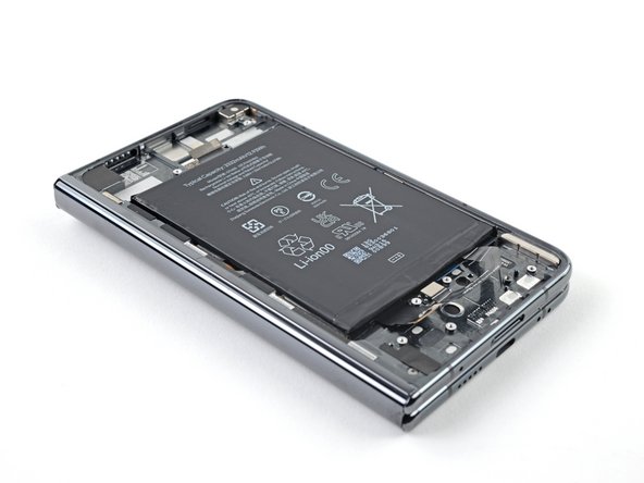

  7. How to Apply New Flip Battery Adhesive in Your Google Pixel Fold, Secure the battery: crwdns2935265:07crwdnd2935265:01crwdnd2935265:03crwdne2935265:0 How to Apply New Flip Battery Adhesive in Your Google Pixel Fold, Secure the battery: crwdns2935265:07crwdnd2935265:02crwdnd2935265:03crwdne2935265:0 How to Apply New Flip Battery Adhesive in Your Google Pixel Fold, Secure the battery: crwdns2935265:07crwdnd2935265:03crwdnd2935265:03crwdne2935265:0

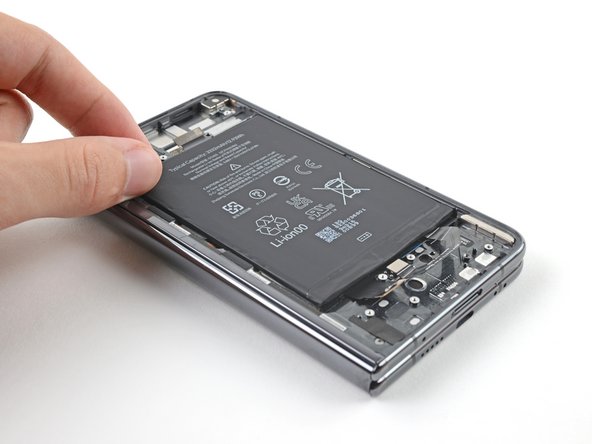

    • Reconnect the battery cable temporarily to make sure the battery is aligned properly.
    • Place the battery in its recess, making sure to align it as close to the top edge of the recess lip as possible.
    • Press down on the battery to adhere it to the frame.
    • Make sure the battery is disconnected before continuing your repair.

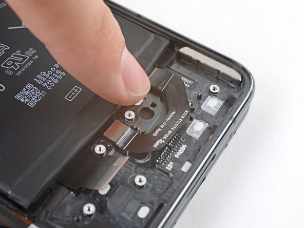

  8. How to Apply New Flip Battery Adhesive in Your Google Pixel Fold, Secure the cable: crwdns2935265:08crwdnd2935265:01crwdnd2935265:03crwdne2935265:0 How to Apply New Flip Battery Adhesive in Your Google Pixel Fold, Secure the cable: crwdns2935265:08crwdnd2935265:02crwdnd2935265:03crwdne2935265:0 How to Apply New Flip Battery Adhesive in Your Google Pixel Fold, Secure the cable: crwdns2935265:08crwdnd2935265:03crwdnd2935265:03crwdne2935265:0

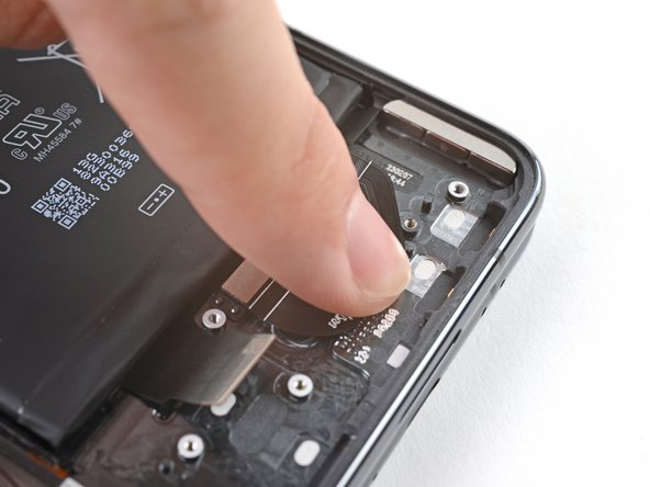

    • Peel off the blue liner on the middle black tab near the battery connector.
    • Fold the black tab onto the bottom edge of the battery.
    • Press down on the battery cable to adhere it to the frame.
    • You may have to fold the cable slightly to get it to fit in its recess.
