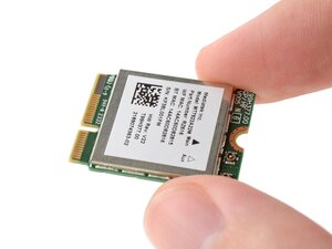

- New Wireless Module: Wi-Fi 7 supported AMD RZ717 wireless card

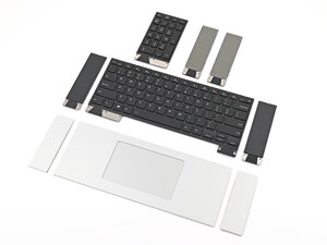

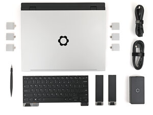

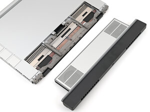

Unlike the standard 13" Framework laptop, the 16" Framework laptop features six module bays, along with an expansion bay system designated for graphics cards. The keyboard and trackpad are also modular, and can even be offset.
Beyond the hardware itself, Framework's developer program allows you to get started with designing Input Modules and Expansion Bay Modules with open source design documentation available on Framework's official GitHub Page.
Since the laptop is highly customizable, the price can fluctuate based on what specifications and operating system you want. The baseline version of the DIY model (Ryzen™ AI 7 350) starts at $1,499 USD.

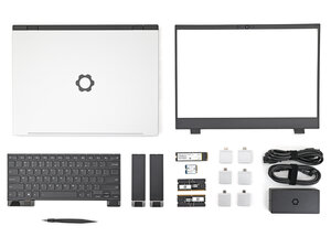

- The case is a silver, with a distinct gear-shaped logo on the top cover.

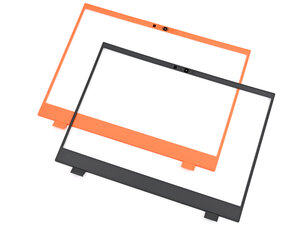

- The bezel around the screen is magnetic and can be switched out easily with different color options (currently black, orange, and lavender).

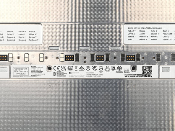

- You will find the serial and model number either on your laptop's original box or on the metal midframe under the trackpad:

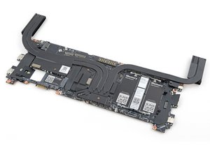

Processor Options:
- "Performance:" Ryzen™ AI 7 350 (Up to 5.0GHz, 8-core 16-thread)
- "Performance Pro:" same as above
- "Overkill:" Ryzen™ AI 9 HX 370 (Up to 5.1GHz, 12-core 24-thread)

Thermals:
- Mainboard = Honeywell PTM7958 phase change thermal interface for processor / two 6.0mm and one 8.0mm heatpipes
- Expansion Bay Shell = 75.0 × 75.0 × 8.5mm dual fans
- Graphics Module = Honeywell PTM7958 phase change thermal interface / four 10mm heatpipes / 75.0 × 75.0 × 11.5mm dual fans

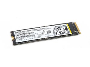

Primary Storage:
- Pre-built:
- "Performance:" 512GB M.2 2280 SSD
- "Performance Pro:" 1TB M.2 2280 SSD
- "Overkill:" 2TB M.2 2280 SSD
- DIY Edition supports any M.2 2280 SSD (Framework recommends Western Digital)

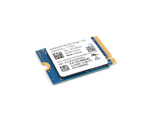

Secondary Storage:
- Neither the Pre-built or DIY Edition come with secondary storage
- Supports any x2 PCIe 4.0 M.2 2230 SSDs, with x4 PCIe running at a slower speed (Framework recommends Western Digital)

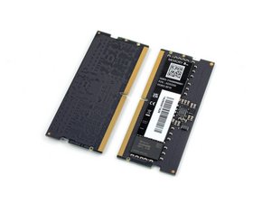

Memory:
- Pre-built:
- "Performance:" 16GB (2 x 8GB) DDR5-5600
- "Performance Pro:" 32GB (2 x 16GB) DDR5-5600
- "Overkill:" 64GB (2 x 32GB) DDR5-5600
- DIY Edition supports up to 96 GB DDR5-5600 (Framework sells their own branded RAM)

- Wi-Fi: AMD RZ717 Wi-Fi 7 module supporting Wi-Fi 7
- Bluetooth: 5.2

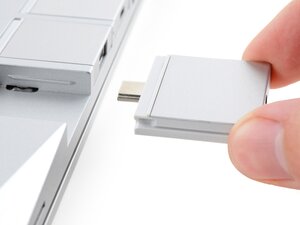

- You can choose six "Expansion Cards" that act as interchangeable ports:
- USB-C
- USB-A
- HDMI
- Display Port
- Ethernet
- MicroSD
- Audio (3.5 mm headphone jack)
- Storage Expansion (250 GB and 1 TB)
- With Slot 1–3 being the top left to bottom left and 4–6 being top right to bottom right, here are the compatible Expansion Cards for each slot:
- Slot 1 and 4 = USB 4 / Display Output (DP 2.1 UHBR10) / Up to 240W charging / USB-A (Higher power consumption)
- Slot 2 = USB 3.2 / Display Output (DP 2.1 UHBR10) / Up to 240W charging / USB-A
- Slot 3 and 6 = USB 3.2 / USB-A
- Slot 5 = USB 3.2 / Display Output (DP 1.4 HBR3) / Up to 240W charging / USB-A

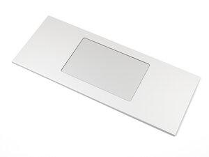

Touchpad:
- 122.6mm x 76.6mm Windows Precision Touchpad with matte glass surface

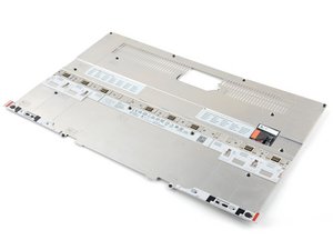

Mechanical:
- Top Cover: CNC Aluminum
- Bottom Cover: Magnesium Alloy Thixomolded
