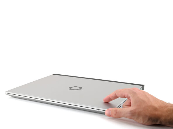

  1. Framework Laptop 16 Bezel Replacement, Open the laptop: crwdns2935265:01crwdnd2935265:01crwdnd2935265:02crwdne2935265:0 Framework Laptop 16 Bezel Replacement, Open the laptop: crwdns2935265:01crwdnd2935265:02crwdnd2935265:02crwdne2935265:0
    • Open the laptop.

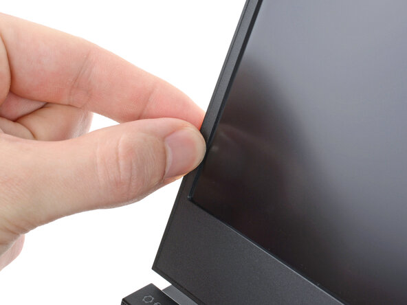

  2. Framework Laptop 16 Bezel Replacement, Create a gap: crwdns2935265:02crwdnd2935265:01crwdnd2935265:03crwdne2935265:0 Framework Laptop 16 Bezel Replacement, Create a gap: crwdns2935265:02crwdnd2935265:02crwdnd2935265:03crwdne2935265:0 Framework Laptop 16 Bezel Replacement, Create a gap: crwdns2935265:02crwdnd2935265:03crwdnd2935265:03crwdne2935265:0
    • The bezel is secured with magnets.
    • Slide your fingernail under the inside edge of either bottom corner of the bezel.
    • Pull the bezel away from the screen to release the first few magnets.
  3. Framework Laptop 16 Bezel Replacement, Remove the bezel: crwdns2935265:03crwdnd2935265:01crwdnd2935265:03crwdne2935265:0 Framework Laptop 16 Bezel Replacement, Remove the bezel: crwdns2935265:03crwdnd2935265:02crwdnd2935265:03crwdne2935265:0 Framework Laptop 16 Bezel Replacement, Remove the bezel: crwdns2935265:03crwdnd2935265:03crwdnd2935265:03crwdne2935265:0
    • Lift the bezel around the perimeter of the screen until all of its magnets are released.
    • Remove the bezel.
