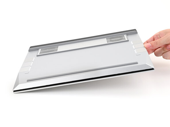

    • Unplug all cables and fully shut down your laptop.
  2. Framework Laptop 16 Mainboard Replacement, Reposition the laptop: crwdns2935265:02crwdnd2935265:01crwdnd2935265:02crwdne2935265:0 Framework Laptop 16 Mainboard Replacement, Reposition the laptop: crwdns2935265:02crwdnd2935265:02crwdnd2935265:02crwdne2935265:0
    • Close the laptop and flip it over.
