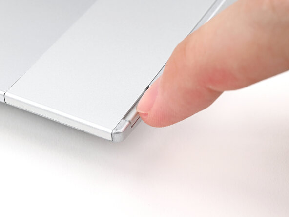

  2. Framework Laptop 16 Mid Plate Replacement, Unlock the Input Modules: crwdns2935265:02crwdnd2935265:01crwdnd2935265:03crwdne2935265:0 Framework Laptop 16 Mid Plate Replacement, Unlock the Input Modules: crwdns2935265:02crwdnd2935265:02crwdnd2935265:03crwdne2935265:0 Framework Laptop 16 Mid Plate Replacement, Unlock the Input Modules: crwdns2935265:02crwdnd2935265:03crwdnd2935265:03crwdne2935265:0
    • Use your fingernail to pull out the two Input Module latches and unlock them.
    • The latch will show red if it's unlocked.
