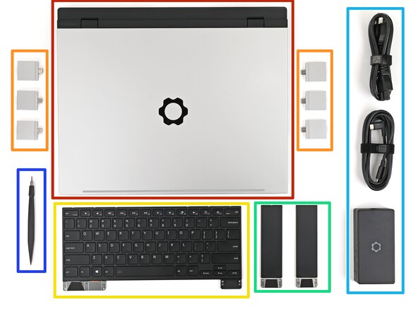

    • Unbox your Framework Laptop and make sure you've received the following items:
    • Framework Laptop chassis with pre-installed Mid Plate, Bezel, Memory, Storage, Touchpad Module, and Touch Spacers.
    • Expansion Cards
    • Keyboard
    • Input Modules
    • Power Adapter
    • Framework Screwdriver

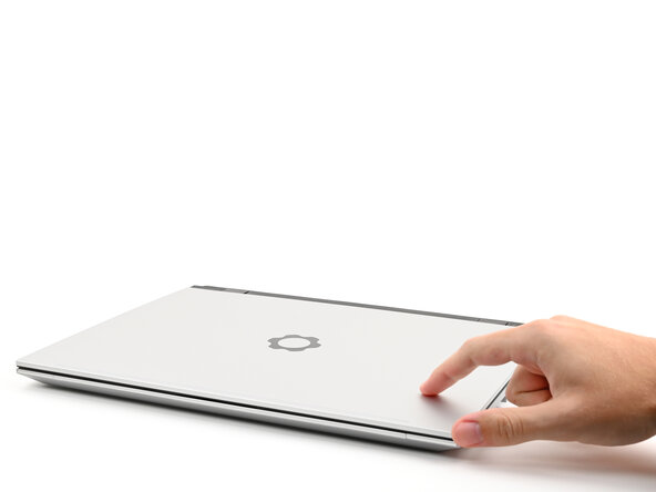

    • Open the laptop.
