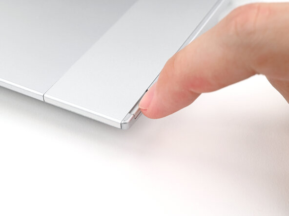

  1. Framework Laptop 16 Touchpad Module Replacement, Unlock the Input Modules: crwdns2935265:01crwdnd2935265:01crwdnd2935265:03crwdne2935265:0 Framework Laptop 16 Touchpad Module Replacement, Unlock the Input Modules: crwdns2935265:01crwdnd2935265:02crwdnd2935265:03crwdne2935265:0 Framework Laptop 16 Touchpad Module Replacement, Unlock the Input Modules: crwdns2935265:01crwdnd2935265:03crwdnd2935265:03crwdne2935265:0
    • Use your fingernail to pull out the two Input Module latches and unlock them.
    • The latch will show red if it's unlocked.

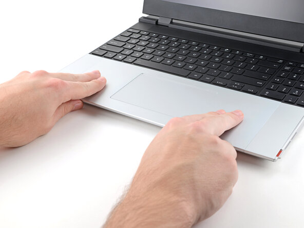

  2. Framework Laptop 16 Touchpad Module Replacement, Remove the Touchpad Module: crwdns2935265:02crwdnd2935265:01crwdnd2935265:03crwdne2935265:0 Framework Laptop 16 Touchpad Module Replacement, Remove the Touchpad Module: crwdns2935265:02crwdnd2935265:02crwdnd2935265:03crwdne2935265:0 Framework Laptop 16 Touchpad Module Replacement, Remove the Touchpad Module: crwdns2935265:02crwdnd2935265:03crwdnd2935265:03crwdne2935265:0
    • Use your fingers to slide the Touchpad Module toward the bottom edge of the laptop and disconnect it.
    • If you're having trouble, check if the Input Module latches are properly unlocked.
    • Lift the Touchpad Module and remove it.
