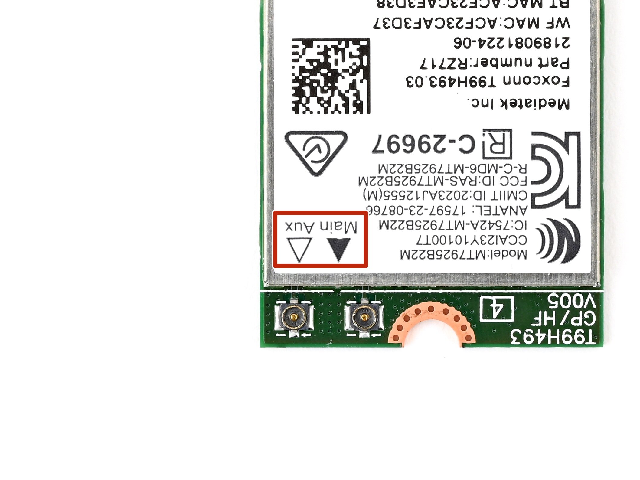

  16. Framework Laptop 16 Wi-Fi Module Replacement, Install the Wi-Fi module: crwdns2935265:016crwdnd2935265:01crwdnd2935265:02crwdne2935265:0 Framework Laptop 16 Wi-Fi Module Replacement, Install the Wi-Fi module: crwdns2935265:016crwdnd2935265:02crwdnd2935265:02crwdne2935265:0
    • Hold the Wi-Fi module by its edges. Don't touch the gold contacts with your fingers. If you do, wipe the contacts with a clean, lint-free cloth to remove any finger oils.
    • Align the Wi-Fi module's gold contacts and notch with the socket on the Mainboard.
    • Insert the Wi-Fi module into the socket at a shallow angle. The gold contacts should mostly be covered by the socket.
    • The Wi-Fi module fits into the socket in one orientation. If it doesn't fit, try flipping the module.
  17. Framework Laptop 16 Wi-Fi Module Replacement: crwdns2935265:017crwdnd2935265:01crwdnd2935265:03crwdne2935265:0 Framework Laptop 16 Wi-Fi Module Replacement: crwdns2935265:017crwdnd2935265:02crwdnd2935265:03crwdne2935265:0 Framework Laptop 16 Wi-Fi Module Replacement: crwdns2935265:017crwdnd2935265:03crwdnd2935265:03crwdne2935265:0
    • Hold the Wi-Fi module down with your finger.
    • Position the white antenna cable connector over the left Wi-Fi module's coaxial socket.
    • If you're unsure which cable goes where, refer to the arrows on the Wi-Fi module for which color cable matches with its connector.
    • Tweezers can help position the connector.
    • Use your finger to press the connector into place. You should feel a faint click, and the cable will stay attached to the socket by itself.
    • These connectors are very delicate! If the connector doesn't feel like it's clicking in place, reposition the connector and try again.
    • Repeat the procedure with the black antenna cable.
