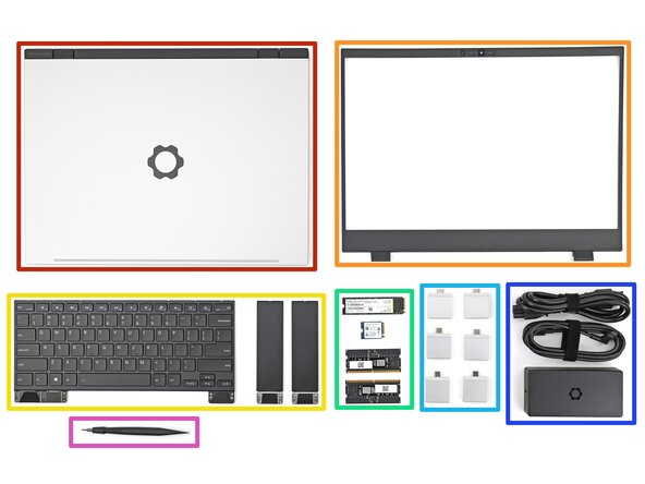

    • Unbox your Framework Laptop and make sure you've received the following items:
    • Framework Laptop chassis with pre-installed Mid Plate, Touchpad Module, and Touch Spacers.
    • Bezel
    • Keyboard and Input Modules
    • Memory and Storage
    • Expansion Cards
    • Power Adapter
    • Framework Screwdriver

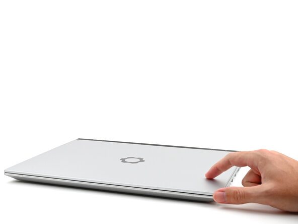

  2. Framework Laptop 16 DIY Edition Quick Start Guide, Open the laptop: crwdns2935265:02crwdnd2935265:01crwdnd2935265:02crwdne2935265:0 Framework Laptop 16 DIY Edition Quick Start Guide, Open the laptop: crwdns2935265:02crwdnd2935265:02crwdnd2935265:02crwdne2935265:0
    • Open the laptop.
