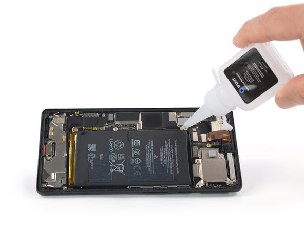

  23. Google Pixel 6 Battery Replacement, Apply high concentration isopropyl alcohol: crwdns2935265:023crwdnd2935265:01crwdnd2935265:02crwdne2935265:0 Google Pixel 6 Battery Replacement, Apply high concentration isopropyl alcohol: crwdns2935265:023crwdnd2935265:02crwdnd2935265:02crwdne2935265:0
    • Adhesive is only present underneath the top and bottom areas of the battery and not underneath the center. The see-through plastic strip around the center of the battery is not especially useful during the removal procedure. Feel free to remove it for easier handling by opening its adhesive seal and pulling it out from underneath the battery.
    • Lift your phone assembly to a ~45° angle.
    • This helps to spread the isopropyl alcohol evenly in the following step. You can hold the phone in one hand and apply the alcohol with the other, or secure your suction handle to the rear glass and use its handle as a stand for your phone.
    • Apply a few drops of high concentration (over 90%) isopropyl alcohol into the gap between the motherboard and the top-left and bottom-left corner of the battery.

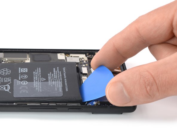

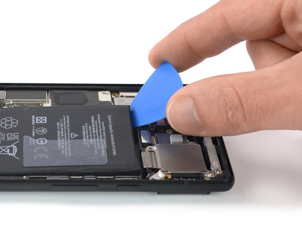

  24. Google Pixel 6 Battery Replacement, Insert an opening pick: crwdns2935265:024crwdnd2935265:01crwdnd2935265:03crwdne2935265:0 Google Pixel 6 Battery Replacement, Insert an opening pick: crwdns2935265:024crwdnd2935265:02crwdnd2935265:03crwdne2935265:0 Google Pixel 6 Battery Replacement, Insert an opening pick: crwdns2935265:024crwdnd2935265:03crwdnd2935265:03crwdne2935265:0
    • Insert an opening pick into the gap between the top edge of the battery and the motherboard.
    • Use your opening pick to pry up the battery by tilting your pick downwards and widening the gap between the battery and the motherboard to create enough space to insert a plastic card.

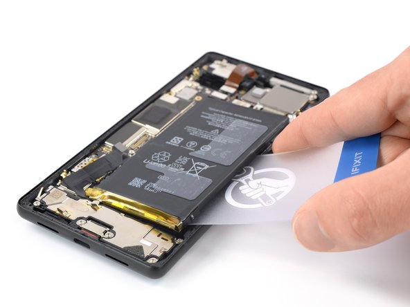

  25. Google Pixel 6 Battery Replacement, Insert a plastic card: crwdns2935265:025crwdnd2935265:01crwdnd2935265:03crwdne2935265:0 Google Pixel 6 Battery Replacement, Insert a plastic card: crwdns2935265:025crwdnd2935265:02crwdnd2935265:03crwdne2935265:0 Google Pixel 6 Battery Replacement, Insert a plastic card: crwdns2935265:025crwdnd2935265:03crwdnd2935265:03crwdne2935265:0
    Plastic Cards
    $2.99
    • If you can't manage to remove the battery by only using high concentration isopropyl alcohol, you can try a combination with heat. In this case, prepare an iOpener and apply it to the rear glass for at least two minutes to loosen the adhesive underneath the battery.
    • Insert a plastic card underneath the top right corner of the battery.
    • Slide the plastic card underneath the top edge of the battery to slice its adhesive and pry it up.
  26. Google Pixel 6 Battery Replacement: crwdns2935265:026crwdnd2935265:01crwdnd2935265:03crwdne2935265:0 Google Pixel 6 Battery Replacement: crwdns2935265:026crwdnd2935265:02crwdnd2935265:03crwdne2935265:0 Google Pixel 6 Battery Replacement: crwdns2935265:026crwdnd2935265:03crwdnd2935265:03crwdne2935265:0
    • Slide the plastic card along the right edge to the bottom edge of the battery to separate it from the midframe and slice the adhesive.
    • Use your plastic card to pry up the battery.

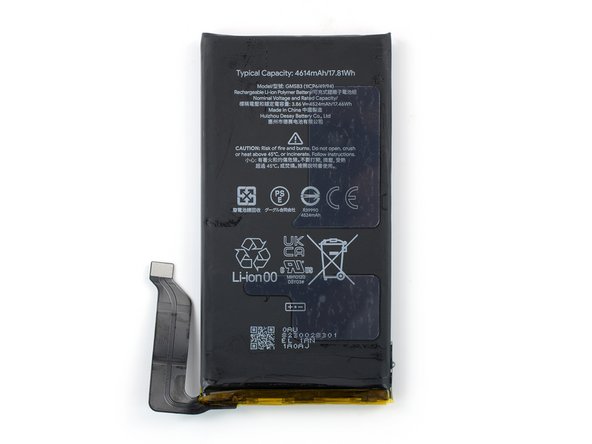

  27. Google Pixel 6 Battery Replacement, Remove the battery: crwdns2935265:027crwdnd2935265:01crwdnd2935265:03crwdne2935265:0 Google Pixel 6 Battery Replacement, Remove the battery: crwdns2935265:027crwdnd2935265:02crwdnd2935265:03crwdne2935265:0 Google Pixel 6 Battery Replacement, Remove the battery: crwdns2935265:027crwdnd2935265:03crwdnd2935265:03crwdne2935265:0
    • Peel the battery off the remaining adhesive.
    • Remove the battery.
    • Do not reinstall a damaged or deformed battery, as doing so is a potential safety hazard.
    • Secure the new battery with pre-cut adhesive or double-sided adhesive tape. In order to position it correctly, apply the new adhesive into the device at the places where the old adhesive was located, not directly onto the battery. Press the new battery firmly into place.
    • During reassembly, temporarily reconnect the battery to the motherboard to help align it correctly. Disconnect the battery after it is seated.
