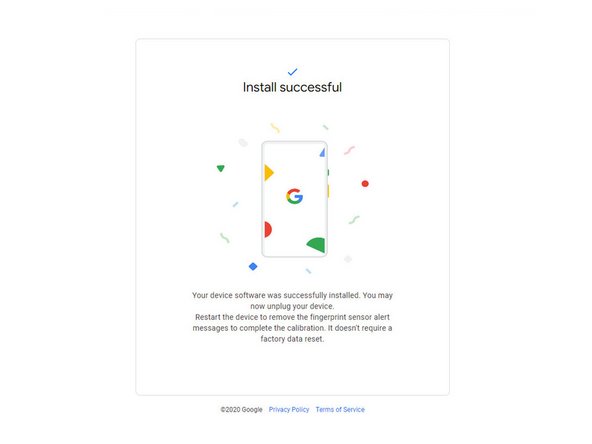

    • Once your device connects, select the "Install software" button.
  3. How to Calibrate the Fingerprint Sensor in your Google Pixel Phone: crwdns2935265:03crwdnd2935265:01crwdnd2935265:03crwdne2935265:0 How to Calibrate the Fingerprint Sensor in your Google Pixel Phone: crwdns2935265:03crwdnd2935265:02crwdnd2935265:03crwdne2935265:0 How to Calibrate the Fingerprint Sensor in your Google Pixel Phone: crwdns2935265:03crwdnd2935265:03crwdnd2935265:03crwdne2935265:0
    • Wait for the calibration software to download and install.
    • The program will run automatically and restart your phone.
    • After you receive the "Install successful" prompt, unplug your phone and manually restart it again to complete the calibration.
    • If you don't manually restart your phone, your fingerprint sensor will not work properly.
Your fingerprint sensor is calibrated and ready for use.
If the calibration fails for any reason, repeat the calibration procedure.
