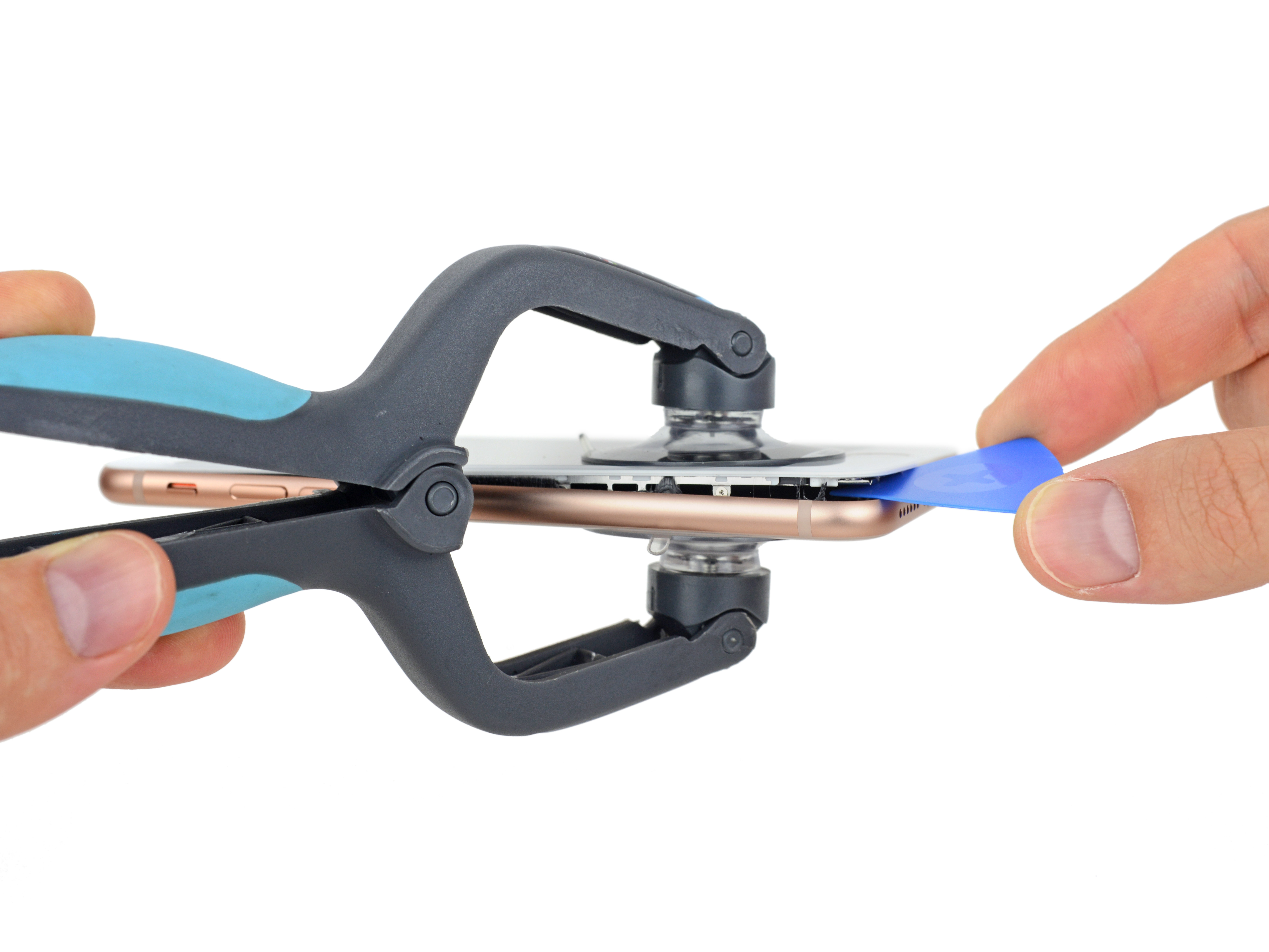

  2. iPhone 6s Battery Replacement, Anti-Clamp instructions: crwdns2935265:02crwdnd2935265:01crwdnd2935265:03crwdne2935265:0 iPhone 6s Battery Replacement, Anti-Clamp instructions: crwdns2935265:02crwdnd2935265:02crwdnd2935265:03crwdne2935265:0 iPhone 6s Battery Replacement, Anti-Clamp instructions: crwdns2935265:02crwdnd2935265:03crwdnd2935265:03crwdne2935265:0
    Clampy - Anti-Clamp
    $24.95
    • The next two steps demonstrate the Anti-Clamp, a tool we designed to make the opening procedure easier. If you aren't using the Anti-Clamp, skip down three steps for an alternate method.
    • For complete instructions on how to use the Anti-Clamp, check out this guide.
    • Pull the blue handle backwards to unlock the Anti-Clamp's arms.
    • Slide the arms over either the left or right edge of your iPhone.
    • Position the suction cups near the bottom edge of the iPhone just above the home button—one on the front, and one on the back.
    • Squeeze the cups together to apply suction to the desired area.
    • If you find that the surface of your iPhone is too slippery for the Anti-Clamp to hold onto, you can use tape to create a grippier surface.
    I found that the single suction cup from the kit worked very well. It didn’t take that much force to separate the front panel from the phone. I think any suction cup that you are able to get a firm grip on will probably work as well. There isn’t any adhesive holding the front panel in. It just snaps in and out. If you have a cracked screen and no screen protector, it may be hard to get a good suction seal. If that’s the case, someone else here suggested applying clear tape to the front glass to get a good surface for applying the suction cup. In my case, I already had a screen protector that was still intact so the suction cup sealed easily.
    fiftysomething - crwdns2934203:0crwdne2934203:0
    WORKED PERFECTLY… easy, no harm at all…. thanks a lot
    carlos restrepo -
  3. iPhone 6s Battery Replacement: crwdns2935265:03crwdnd2935265:01crwdnd2935265:03crwdne2935265:0 iPhone 6s Battery Replacement: crwdns2935265:03crwdnd2935265:02crwdnd2935265:03crwdne2935265:0 iPhone 6s Battery Replacement: crwdns2935265:03crwdnd2935265:03crwdnd2935265:03crwdne2935265:0
    • Pull the blue handle forwards to lock the arms.
    • Turn the handle clockwise 360 degrees or until the cups start to stretch.
    • Make sure the suction cups remain aligned with each other. If they begin to slip out of alignment, loosen the suction cups slightly and realign the arms.
    • Insert an opening pick under the screen when the Anti-Clamp creates a large enough gap.
    • If the Anti-Clamp doesn't create a sufficient gap, rotate the handle a quarter turn.
    • Don't crank more than a quarter turn at a time, and wait a few seconds between turns. Let the Anti-Clamp and time do the work for you.

    Can you use the iSclack opener to open the iPhone 6s?
    Joe Koffee - crwdns2934203:0crwdne2934203:0
    The iSclack is helpful, although you have to use it a bit differently than you would on, say, a 5s or 6. The iSclack alone isn’t strong enough to pop the display open, because of all the adhesive around the perimeter of the 6s display. But you can use it to lift the display just enough to get a tool in there and start cutting the adhesive. Basically, the iSclack does the same job as the suction cup shown here, with maybe a bit less fuss.
    Jeff Suovanen -
    My screen was SUPER shattered… the hair dryer did the trick. Patience it definitely the key… I tried putting tape over the glass but the suction cup wouldn’t stick to it at all but it stuck to the broken glass for a few seconds. I taped it up when I was finally able to move onto the next steps to keep the glass from getting everywhere then peeled it off for Step 10.

Instructions is good and detailed. Have the battery successfully exchangeable. But take care! The detachment of the display is very sensitive. The upper right-hand corner of the display has jumped during detachment from the display. Too bad, I was very annoyed about it. I was probably a bit too rough. But just happened. Maybe I will change the display later.
It may be worth using the iSclack. The iSclack I had not. He should work really well and would have prevented what happened to me.

Bought the battery replacement kit for my wife’s 6S. Could not get past step one. Heated it as directed. Still no go. Heated it until could barely touch phone, still no go. Suction cup kept coming free. Absolutley no movement in the screen. No need to go through replacing a battery like this. Just designed so Apple can get more money for a way overpriced phone. Problem is other makes now doing the same. My Pixel 2 is same. My old Galaxy 5 was easy peasy. USB dock crapped out. Not worth the work to fix it.
Darthdaddy July 15, 2018
jkaknes - crwdns2934203:0crwdne2934203:0
Step one is the pentalobe screws—make sure those are out, or it’s never going to budge. If the suction cup is popping off, make sure your screen is spotless—clean it thoroughly with a microfiber cloth, and use a little liquid screen cleaner or distilled water if needed. The suction handle sticks very well when conditions are right. Also, I’d start off with an opening pick rather than a spudger—the pick is thinner and easier to get under the edge of the display. Hope this helps!

In order to get separation on the screen, I used the blue Spudger to hold down the edge of the phone as I pulled up on the screen with the suction cup. I tried using the black spudger. It didn’t do the trick..

Excellent guide and complete kit. I completely removed the screen adhesive leftovers and replaced it, as commented others
Screen removal was rather easy as I also used a iSesame to cut through the screen adhesive in tandem with the prying with the plastic spudger and the pull action from the suction cup.
Perhaps the most attention need to go to carefully reseating the connectors and not mixing up the screws.
The battery adhesive tabs broke on me and after removing the Taptic Engine it was no problem to fish out both ends and the rest of the strips came out smoothly.
I did use a hot been back to soften the adhesive all around the screen.

Get the kit!! USE A HAIRDRYER OR HEAT GUN FORSURE. I definitely skipped some steps (especially 18-20) because I compromised the shape of the screw from using the wrong screwdriver. I was still able to prop the phone up 90 degrees and follow the rest of the steps safely. Slow and steady with every step though, especially pulling the adhesive. And be very careful to realign the connecter back because once you stick on the battery there’s no turning back. Very nerve racking, but WORTH IT. My phone hasn’t blown up or had any problems and it’s been about 2 weeks.

Biggest difficulty was the replacement of the adhesive seal from the display…I guess mine will not be 100% water proof anymore, but I don’t care.
Complete repair took me roughly 1 hour. dismantling the display from the phone is highly recommended if you will use new adhesive strips for your battery. If you don’t, than you don’t have to dismantle the display and you’ll fix the repair within 30 minutes. I didn’t miss a single step in this tutorial. Works perfect.

If you don't remove the screen, there's a high chance of breaking it while replacing the battery. If you break one of the two adhesive strip then it's really hard to remove the battery with the screen still attached

Great set of instructions! I was able to get the screen off without additional heat, just pulled up on the suction cup with slow and steady pressure.

Danke für die ausführliche Anleitung. Die Klebestreifen sind eine Herausforderung. Anwärmen ist hier immer hilfreich.

Just did this, the strips on my 7 years old iPhone 6S were impossible to take out. I know that's absolutely a bad idea but being the battery completely discharged i got rid of it with brute force and installed the new one with no problems.
On the other hand, I replaced my iPhone 12 Pro's one and while the strip worked perfectly I have to deal with a warning I can't remove.
Don't attempt this withou changing the display's adhesive!
