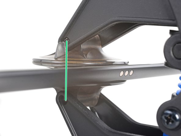

      • Pull the blue handle backwards to unlock the Anti-Clamp's arms.
      • Place an object under your iPad so it rests level between the suction cups.
      • Position the suction cups near the middle of the left edge—one on the top, and one on the bottom.
      • Hold the bottom of the Anti-Clamp steady and firmly press down on the top cup to apply suction.
      • If you find that the surface of your iPad is too slippery for the Anti-Clamp to hold onto, use tape to create a grippier surface.

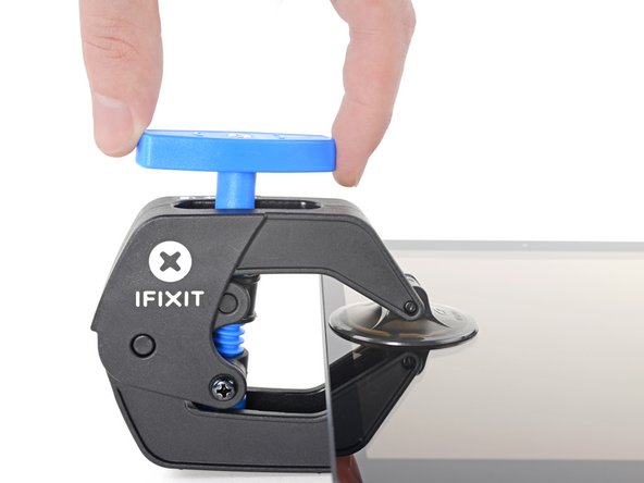

    5. iPad Pro 12.9" Screen Replacement: crwdns2935265:05crwdnd2935265:01crwdnd2935265:03crwdne2935265:0 iPad Pro 12.9" Screen Replacement: crwdns2935265:05crwdnd2935265:02crwdnd2935265:03crwdne2935265:0 iPad Pro 12.9" Screen Replacement: crwdns2935265:05crwdnd2935265:03crwdnd2935265:03crwdne2935265:0
      • Pull the blue handle forward to lock the arms.
      • Turn the handle clockwise 360 degrees or until the cups start to stretch.
      • Make sure the suction cups remain aligned with each other. If they begin to slip out of alignment, loosen the suction cups slightly and realign the arms.

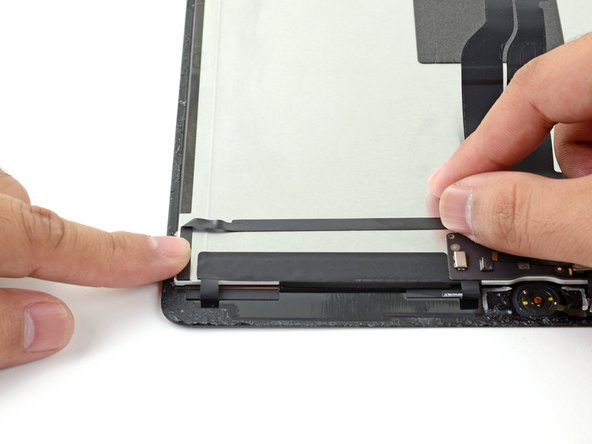

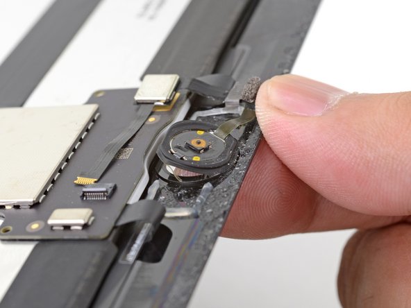

      • Slide the tip of an opening pick or a halberd spudger to cut the adhesive below the home button.
    21. iPad Pro 12.9" Screen Replacement: crwdns2935265:021crwdnd2935265:01crwdnd2935265:02crwdne2935265:0 iPad Pro 12.9" Screen Replacement: crwdns2935265:021crwdnd2935265:02crwdnd2935265:02crwdne2935265:0
      • After you slice below the home button, reinsert the tip of an opening pick or a halberd spudger blade 1/4" into the lower edge.
      • Slice along the lower edge until you reach the opening pick.
    22. iPad Pro 12.9" Screen Replacement: crwdns2935265:022crwdnd2935265:01crwdnd2935265:01crwdne2935265:0
      • At this point, you've sliced through most of the screen adhesive. Use an opening pick to carefully slice any remaining adhesive along the edges until the screen is freed. If some parts are stubborn, heat the area with an iOpener to loosen the adhesive.

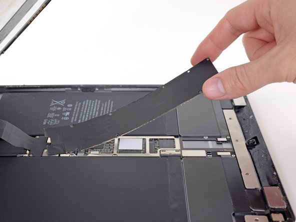

    26. iPad Pro 12.9" Screen Replacement: crwdns2935265:026crwdnd2935265:01crwdnd2935265:03crwdne2935265:0 iPad Pro 12.9" Screen Replacement: crwdns2935265:026crwdnd2935265:02crwdnd2935265:03crwdne2935265:0 iPad Pro 12.9" Screen Replacement: crwdns2935265:026crwdnd2935265:03crwdnd2935265:03crwdne2935265:0
      • Lift the logic board EMI shield from the edge nearest the top of the iPad.
      • Peel up and remove the EMI shield from the logic board.
      • This takes a bit of force due to the many tiny clips securing the shield, and the shield may deform slightly. That's okay—try to keep the deformation to a minimum, and it will lay flat when you reinstall it and screw it down.
      • Remove the logic board EMI shield.

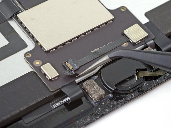

    30. iPad Pro 12.9" Screen Replacement, Disconnect the screen: crwdns2935265:030crwdnd2935265:01crwdnd2935265:02crwdne2935265:0 iPad Pro 12.9" Screen Replacement, Disconnect the screen: crwdns2935265:030crwdnd2935265:02crwdnd2935265:02crwdne2935265:0
      • Use a Phillips screwdriver to remove the three screws securing the display cable bracket:
      • Two 2.4 mm screws
      • One 1.2 mm screw
      • Remove the display cable bracket.

      • Use tweezers to remove the tape covering the ZIF connector above the home button.
    2. iPad Pro 12.9" Screen Replacement: crwdns2935265:034crwdnd2935265:01crwdnd2935265:02crwdne2935265:0 iPad Pro 12.9" Screen Replacement: crwdns2935265:034crwdnd2935265:02crwdnd2935265:02crwdne2935265:0
      • Use the point of a spudger to lift the flap on the ZIF connector that secures the cable.
    3. iPad Pro 12.9" Screen Replacement: crwdns2935265:035crwdnd2935265:01crwdnd2935265:02crwdne2935265:0 iPad Pro 12.9" Screen Replacement: crwdns2935265:035crwdnd2935265:02crwdnd2935265:02crwdne2935265:0
      • Use tweezers to slide the cable out of the ZIF connector.
    4. iPad Pro 12.9" Screen Replacement, Loosen the home button: crwdns2935265:036crwdnd2935265:01crwdnd2935265:02crwdne2935265:0 iPad Pro 12.9" Screen Replacement, Loosen the home button: crwdns2935265:036crwdnd2935265:02crwdnd2935265:02crwdne2935265:0
      • The home button's ribbon cable is very fragile. If it gets damaged, Touch ID will no longer function.
      • Use an iOpener, heat gun, or hair dryer to soften the adhesive under the cable before you pry it up.
      • Alternatively, apply a few drops of isopropyl alcohol to the cable and wait for a minute to let the adhesive soften.
    5. iPad Pro 12.9" Screen Replacement: crwdns2935265:037crwdnd2935265:01crwdnd2935265:03crwdne2935265:0 iPad Pro 12.9" Screen Replacement: crwdns2935265:037crwdnd2935265:02crwdnd2935265:03crwdne2935265:0 iPad Pro 12.9" Screen Replacement: crwdns2935265:037crwdnd2935265:03crwdnd2935265:03crwdne2935265:0
      • Starting from the ZIF connector, use an opening pick to separate the home button cable from the adhesive holding it in place. Stop when you reach the home button.

    9. iPad Pro 12.9" Screen Replacement, Remove the home button: crwdns2935265:041crwdnd2935265:01crwdnd2935265:02crwdne2935265:0 iPad Pro 12.9" Screen Replacement, Remove the home button: crwdns2935265:041crwdnd2935265:02crwdnd2935265:02crwdne2935265:0
      • Gently push the home button from the front of the display inward using the tip of a finger.
    10. iPad Pro 12.9" Screen Replacement: crwdns2935265:042crwdnd2935265:01crwdnd2935265:01crwdne2935265:0
      • Remove the home button.
      • The home button attaches to the screen with an adhesive gasket. When you transfer the home button to a new display, use some liquid adhesive to glue the button perimeter to the screen.
