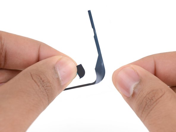

      • Each adhesive strip is encased in four layers of plastic—three on top and one on the bottom.
      • Peel and remove the topmost plastic cling layer from the left adhesive strip.
      • Peel and remove the bottom plastic liner from the strip.
      • The top of the adhesive strip should still be covered by a colored plastic layer as well as a clear plastic stiffening layer.
      • The bottom of the adhesive strip should now be exposed and sticky.
    4. iPad Display Assembly 3 Pc. Adhesive Application: crwdns2935265:04crwdnd2935265:01crwdnd2935265:02crwdne2935265:0 iPad Display Assembly 3 Pc. Adhesive Application: crwdns2935265:04crwdnd2935265:02crwdnd2935265:02crwdne2935265:0
      • If there are extra bits of adhesive on the strip that are not required for your particular model of iPad, remove them now.

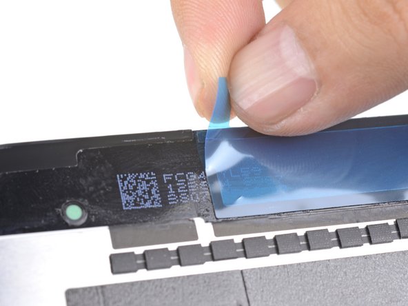

      • Align the left adhesive strip to the left edge of the display assembly.
      • Beginning from one corner, lay the adhesive strip onto the display assembly and press the strip into place.

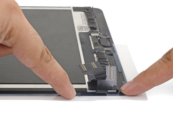

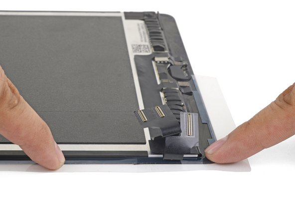

      • Repeat the process with the right adhesive strip.
      • Peel and remove the topmost cling layer from the strip.
      • Peel and remove the bottom liner layer from the strip.
      • Align the adhesive strip to the right edge of the display assembly.
      • Starting from one corner, lay the adhesive strip onto the display assembly and press in place.

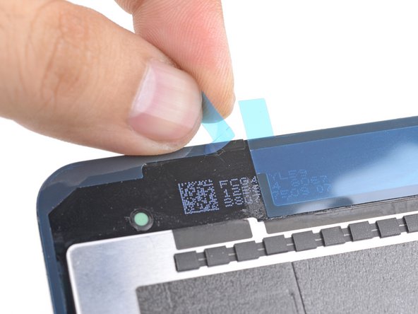

      • Repeat the process for the top adhesive strip.
      • Peel and remove the bottom liner from the strip.
      • Align the strip to the top of the display assembly such that the straight adhesive line bridges the gap between the left and right strips.
      • Press the strip in place.
