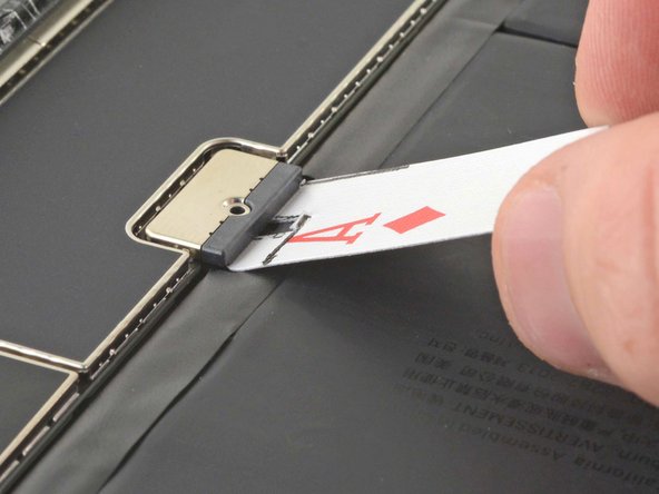

    • Line up the left edge of a playing card with the left edge of the battery connector.
    • Use a pen to mark both sides of the screw hole and the end of the battery connector as shown.
  2. How to Disconnect an iPad Battery with a Playing Card, Mark the depth of the screw slot: crwdns2935265:02crwdnd2935265:01crwdnd2935265:02crwdne2935265:0 How to Disconnect an iPad Battery with a Playing Card, Mark the depth of the screw slot: crwdns2935265:02crwdnd2935265:02crwdnd2935265:02crwdne2935265:0
    • Line up the top edge of the card with the top edge of the screw hole.
    • Use a pen to mark the bottom edge of the battery connector.
    • These markings will aid in cutting a slot in the card to clear the screw hole.
  3. How to Disconnect an iPad Battery with a Playing Card, Cut the playing card to size: crwdns2935265:03crwdnd2935265:01crwdnd2935265:02crwdne2935265:0 How to Disconnect an iPad Battery with a Playing Card, Cut the playing card to size: crwdns2935265:03crwdnd2935265:02crwdnd2935265:02crwdne2935265:0
    • The length of the battery blocker is not important, but we recommend it to be about an inch, or the length from the tip of your thumb to its knuckle.
    • Use a pair of scissors to cut out the playing card battery blocker as shown.
  4. How to Disconnect an iPad Battery with a Playing Card, Disconnect the battery: crwdns2935265:04crwdnd2935265:01crwdnd2935265:03crwdne2935265:0 How to Disconnect an iPad Battery with a Playing Card, Disconnect the battery: crwdns2935265:04crwdnd2935265:02crwdnd2935265:03crwdne2935265:0 How to Disconnect an iPad Battery with a Playing Card, Disconnect the battery: crwdns2935265:04crwdnd2935265:03crwdnd2935265:03crwdne2935265:0
    • Be extremely slow and careful when you isolate the battery using a battery blocker. The battery contacts are easily bent or broken, resulting in irreversible damage.
    • Insert the battery blocker at a 35 degree angle to disconnect the battery.
    • The playing card ideally should slide under the logic board without encountering any blockages. After insertion, it should rest at a 15 degree angle.
    • Leave the battery blocker in place as you work.

Hello Robert,
thank you for this useful tip.
Let me ask you this question:
I need to rectify a bent 9th gen iPad but after dismantling both the digitizer and the screen, I don't want to go further. The bent is located exactly aside the logic board screen connector.
All I want to do is try to fix the bent, therefore I need the iPad be free of movements. Since this article says the card needs to be kept in place, my question is is really mandatory that the card stays at 15 degrees or may I tape the card to the battery to avoid the card being accidentally removed?
I hope you can reply to my question.
Thank you
