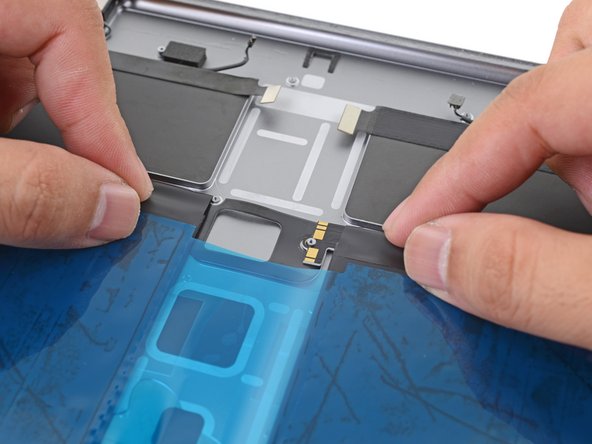

  22. iPad Pro 12.9" Battery Replacement: crwdns2935265:022crwdnd2935265:01crwdnd2935265:01crwdne2935265:0
    • At this point, you've sliced through most of the screen adhesive. Use an opening pick to carefully slice any remaining adhesive along the edges until the screen is freed. If some parts are stubborn, heat the area with an iOpener to loosen the adhesive.
  23. iPad Pro 12.9" Battery Replacement: crwdns2935265:023crwdnd2935265:01crwdnd2935265:03crwdne2935265:0 iPad Pro 12.9" Battery Replacement: crwdns2935265:023crwdnd2935265:02crwdnd2935265:03crwdne2935265:0 iPad Pro 12.9" Battery Replacement: crwdns2935265:023crwdnd2935265:03crwdnd2935265:03crwdne2935265:0
    • The display cables in this iPad are very short. Read the next two steps before you proceed.
    • Do not tilt the screen about the lower edge. The display cables don't have enough slack to allow for this.
    • Lift up the upper edge of the screen and slide the entire screen towards the front-facing camera to access the iPad's internal components.
    • The display cables will tear if you raise the screen more than 80 degrees.
    • Use masking tape to tape the lower edge of the screen to the frame to prevent the screen from slipping.
  24. iPad Pro 12.9" Battery Replacement, Prop up the screen: crwdns2935265:024crwdnd2935265:01crwdnd2935265:03crwdne2935265:0 iPad Pro 12.9" Battery Replacement, Prop up the screen: crwdns2935265:024crwdnd2935265:02crwdnd2935265:03crwdne2935265:0 iPad Pro 12.9" Battery Replacement, Prop up the screen: crwdns2935265:024crwdnd2935265:03crwdnd2935265:03crwdne2935265:0
    • This step shows one way to support the screen using masking tape. You can also turn the iPad sideways. Make sure not to strain the display cables with whatever method you choose.
    • Attach a long strip of masking tape to the top edge of the screen. Fold the tape over the edge and make sure that the tape is attached securely.
    • Attach the other end of the strip to the bottom edge of the iPad frame to hold the screen at an angle. Make sure the tape attaches securely to the frame.

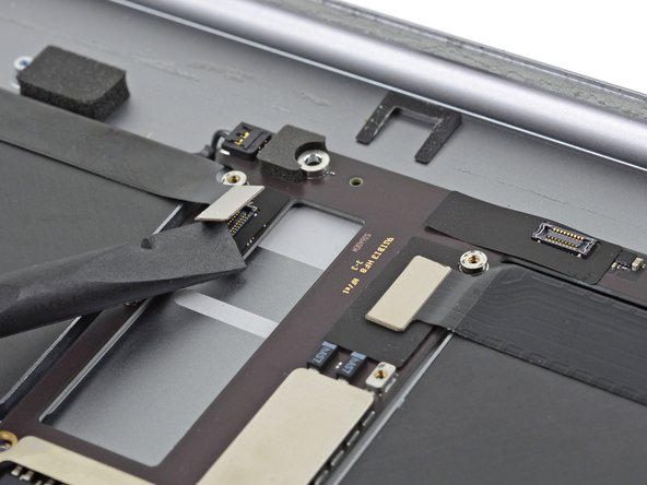

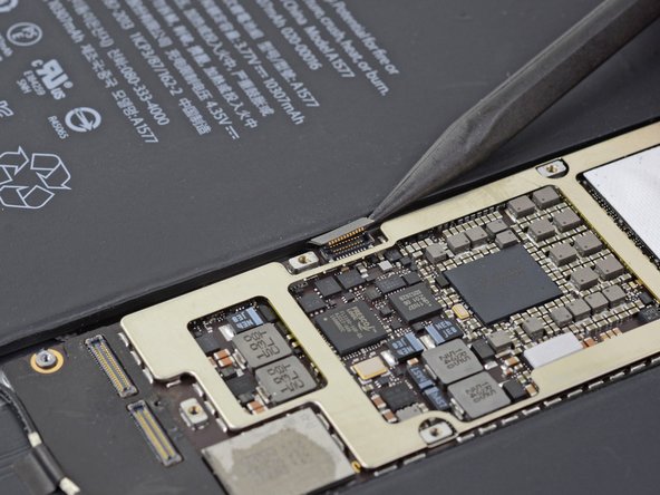

  25. iPad Pro 12.9" Battery Replacement, Disconnect the battery: crwdns2935265:025crwdnd2935265:01crwdnd2935265:01crwdne2935265:0
    • It's important to disconnect the battery before you proceed further. Detaching or connecting the display cables with the battery plugged in can cause a short that will destroy touchscreen functionality.
    • Use a Phillips screwdriver to remove the nine screws securing the logic board EMI shield:
    • Eight 1.2 mm screws
    • One 2.4 mm screw
  26. iPad Pro 12.9" Battery Replacement: crwdns2935265:026crwdnd2935265:01crwdnd2935265:03crwdne2935265:0 iPad Pro 12.9" Battery Replacement: crwdns2935265:026crwdnd2935265:02crwdnd2935265:03crwdne2935265:0 iPad Pro 12.9" Battery Replacement: crwdns2935265:026crwdnd2935265:03crwdnd2935265:03crwdne2935265:0
    • Lift the logic board EMI shield from the edge nearest the top of the iPad.
    • Peel up and remove the EMI shield from the logic board.
    • This takes a bit of force due to the many tiny clips securing the shield, and the shield may deform slightly. That's okay—try to keep the deformation to a minimum, and it will lay flat when you reinstall it and screw it down.
    • Remove the logic board EMI shield.
  27. iPad Pro 12.9" Battery Replacement: crwdns2935265:027crwdnd2935265:01crwdnd2935265:01crwdne2935265:0
    • Use a Phillips screwdriver to remove the 1.8 mm screw securing the battery connector.
  28. iPad Pro 12.9" Battery Replacement, Battery connector information: crwdns2935265:028crwdnd2935265:01crwdnd2935265:03crwdne2935265:0 iPad Pro 12.9" Battery Replacement, Battery connector information: crwdns2935265:028crwdnd2935265:02crwdnd2935265:03crwdne2935265:0 iPad Pro 12.9" Battery Replacement, Battery connector information: crwdns2935265:028crwdnd2935265:03crwdnd2935265:03crwdne2935265:0
    • These photos show what the battery connector looks like underneath the logic board. Use these photos as a reference while you safely disconnect the battery.
    • Notice that the battery connector has springs on the logic board that press down against the battery contact pads. You'll need to slide something thin and flexible between the contact points to disconnect the battery.

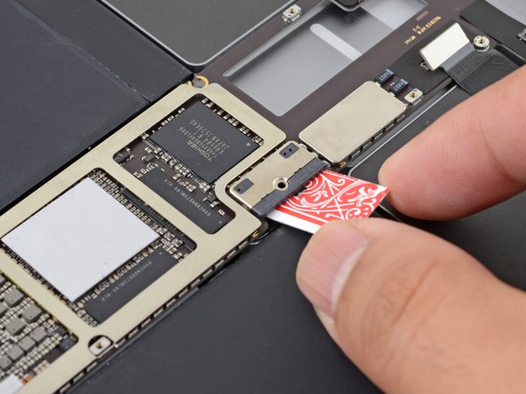

  29. iPad Pro 12.9" Battery Replacement: crwdns2935265:029crwdnd2935265:01crwdnd2935265:02crwdne2935265:0 iPad Pro 12.9" Battery Replacement: crwdns2935265:029crwdnd2935265:02crwdnd2935265:02crwdne2935265:0
    • Make a battery blocker using a playing card and slide it underneath the logic board connector to disconnect the battery.
    • You can also use an iFixit battery blocker. Be very careful and don't push the battery blocker underneath the connector with excessive force.
    • Leave the blocker there to prevent the battery connector leads from making contact until you have completed your repairs.

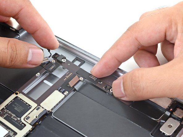

  30. iPad Pro 12.9" Battery Replacement, Disconnect the screen: crwdns2935265:030crwdnd2935265:01crwdnd2935265:02crwdne2935265:0 iPad Pro 12.9" Battery Replacement, Disconnect the screen: crwdns2935265:030crwdnd2935265:02crwdnd2935265:02crwdne2935265:0
    • Use a Phillips screwdriver to remove the three screws securing the display cable bracket:
    • Two 2.4 mm screws
    • One 1.2 mm screw
    • Remove the display cable bracket.

    • Use the flat end of a spudger to pry up and disconnect the display and digitizer cables from their logic board sockets.
    • To re-attach press connectors like this one, carefully align and press down on one side until it clicks into place, then repeat on the other side. Do not press down on the middle. If the connector is misaligned, the pins can bend, causing permanent damage.
    • These cables are very delicate, and the connectors can damage easily if they're misaligned. When you reattach the cables to the logic board, try to have as much slack on the cables and gently press the connectors onto their sockets.

  37. iPad Pro 12.9" Battery Replacement, Disconnect the logic board connectors: crwdns2935265:037crwdnd2935265:01crwdnd2935265:03crwdne2935265:0 iPad Pro 12.9" Battery Replacement, Disconnect the logic board connectors: crwdns2935265:037crwdnd2935265:02crwdnd2935265:03crwdne2935265:0 iPad Pro 12.9" Battery Replacement, Disconnect the logic board connectors: crwdns2935265:037crwdnd2935265:03crwdnd2935265:03crwdne2935265:0
    • Use a spudger to pry up and disconnect the two press connectors near the top of the logic board.

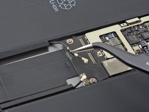

  41. iPad Pro 12.9" Battery Replacement, Disconnect the antenna cables: crwdns2935265:041crwdnd2935265:01crwdnd2935265:03crwdne2935265:0 iPad Pro 12.9" Battery Replacement, Disconnect the antenna cables: crwdns2935265:041crwdnd2935265:02crwdnd2935265:03crwdne2935265:0 iPad Pro 12.9" Battery Replacement, Disconnect the antenna cables: crwdns2935265:041crwdnd2935265:03crwdnd2935265:03crwdne2935265:0
    • Use the point of a spudger to pry up and disconnect the two antenna cables from the bottom right corner of the logic board.
    • To disconnect antenna cables like these, slide the point of a spudger underneath the cable as close to the connector as possible, then pry up gently to disconnect the cable.

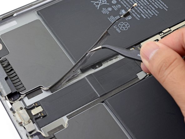

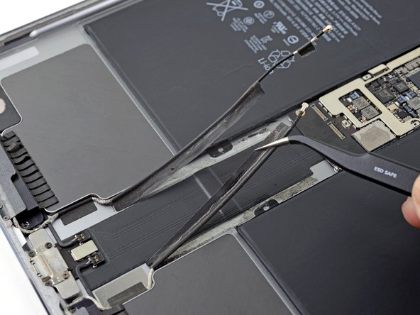

  43. iPad Pro 12.9" Battery Replacement: crwdns2935265:043crwdnd2935265:01crwdnd2935265:02crwdne2935265:0 iPad Pro 12.9" Battery Replacement: crwdns2935265:043crwdnd2935265:02crwdnd2935265:02crwdne2935265:0
    • Use tweezers to gently lift the left antenna cable connector away from the frame.
    • Take care not to puncture the battery—a punctured battery may leak dangerous chemicals or cause a thermal event.
  44. iPad Pro 12.9" Battery Replacement: crwdns2935265:044crwdnd2935265:01crwdnd2935265:02crwdne2935265:0 iPad Pro 12.9" Battery Replacement: crwdns2935265:044crwdnd2935265:02crwdnd2935265:02crwdne2935265:0
    • Use tweezers to lift and remove the two lightly adhered antenna channels from the edges of the battery.
    • Take care not to puncture the battery.

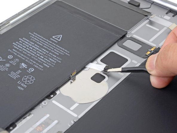

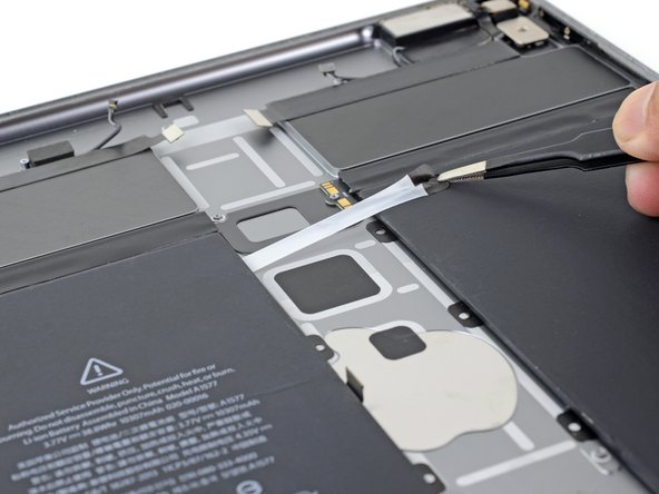

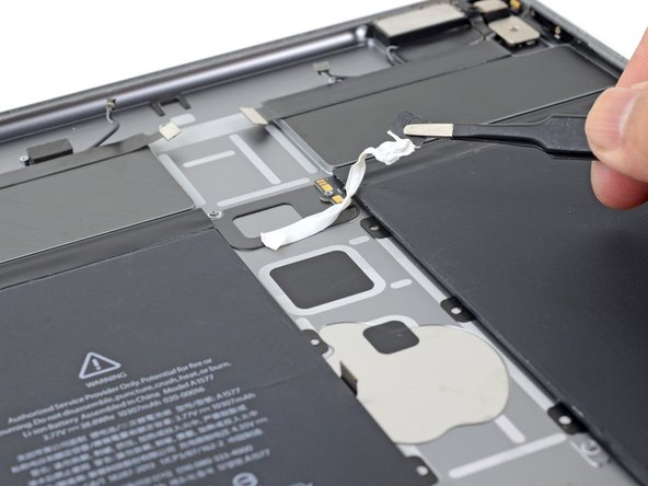

  45. iPad Pro 12.9" Battery Replacement: crwdns2935265:045crwdnd2935265:01crwdnd2935265:03crwdne2935265:0 iPad Pro 12.9" Battery Replacement: crwdns2935265:045crwdnd2935265:02crwdnd2935265:03crwdne2935265:0 iPad Pro 12.9" Battery Replacement: crwdns2935265:045crwdnd2935265:03crwdnd2935265:03crwdne2935265:0
    • Use your fingers or tweezers to lift and peel up the the two antenna cables from the iPad frame.
    • Don't pull the cables forcefully. If the cables feel stuck, apply a heated iOpener or some isopropyl alcohol to help loosen the adhesive.
    • Bend the antenna cables toward the bottom edge of the iPad.

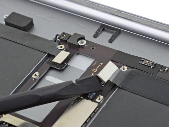

  47. iPad Pro 12.9" Battery Replacement, Loosen the logic board: crwdns2935265:047crwdnd2935265:01crwdnd2935265:02crwdne2935265:0 iPad Pro 12.9" Battery Replacement, Loosen the logic board: crwdns2935265:047crwdnd2935265:02crwdnd2935265:02crwdne2935265:0
    • The next four steps show how to move the logic board out of the way for battery removal. Read the steps first before you attempt it.
    • Lift the top edge of the logic board slightly to free it from the top connectors.
    • Don't try to completely remove the logic board. It's attached to a flex cable that is glued to the iPad frame.
    • Remove the loose battery blocker and save it for reassembly.
