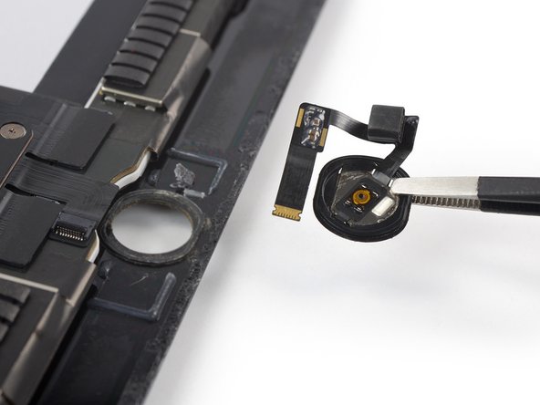

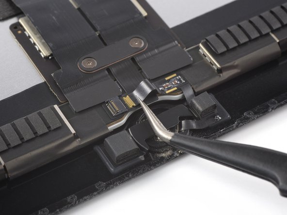

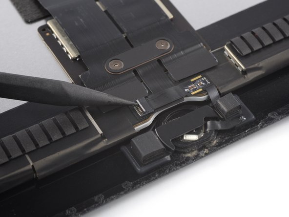

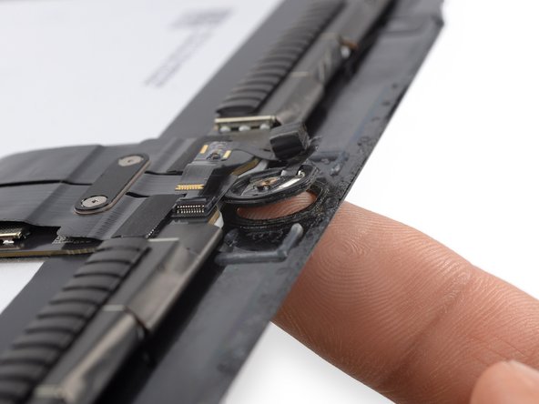

Note that the home button installed in your original screen is paired to the iPad's logic board, and will need to be removed and transferred to the new screen to retain Touch ID functionality.

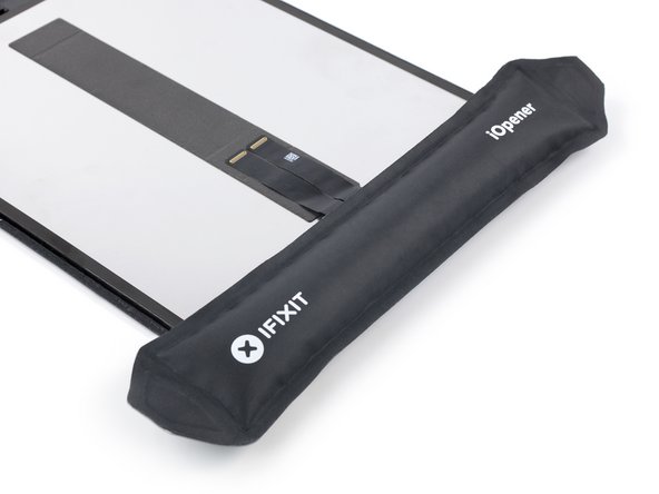

    3. iPad Pro 12.9" 2nd Gen Screen Replacement, Heat the left edge: crwdns2935265:04crwdnd2935265:01crwdnd2935265:02crwdne2935265:0 iPad Pro 12.9" 2nd Gen Screen Replacement, Heat the left edge: crwdns2935265:04crwdnd2935265:02crwdnd2935265:02crwdne2935265:0
      • Apply a heated iOpener to the left edge of the screen to loosen the adhesive underneath. Apply the iOpener for at least 5 minutes.
      • A hair dryer, heat gun, or hot plate may also be used, but be careful not to overheat the device.
      • The display adhesive of the iPad is strong and the glass breaks easily. You need to reheat and reapply the iOpener in each section several times during the display removal.

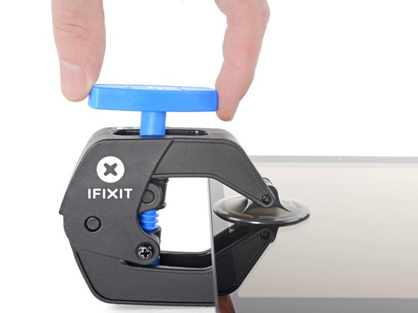

    4. iPad Pro 12.9" 2nd Gen Screen Replacement, Anti-Clamp instructions: crwdns2935265:05crwdnd2935265:01crwdnd2935265:03crwdne2935265:0 iPad Pro 12.9" 2nd Gen Screen Replacement, Anti-Clamp instructions: crwdns2935265:05crwdnd2935265:02crwdnd2935265:03crwdne2935265:0 iPad Pro 12.9" 2nd Gen Screen Replacement, Anti-Clamp instructions: crwdns2935265:05crwdnd2935265:03crwdnd2935265:03crwdne2935265:0
      Clampy - Anti-Clamp
      $24.95
      • The next three steps demonstrate the Anti-Clamp, a tool we designed to make the opening procedure easier. If you aren't using the Anti-Clamp, skip down three steps for an alternate method.
      • For complete instructions on how to use the Anti-Clamp, check out this guide.
      • Pull the blue handle backwards to unlock the Anti-Clamp's arms.
      • Place an object under your iPad so it rests level between the suction cups.
      • Position the suction cups near the middle of the left edge—one on the top, and one on the bottom.
      • Hold the bottom of the Anti-Clamp steady and firmly press down on the top cup to apply suction.
      • If you find that the surface of your iPad is too slippery for the Anti-Clamp to hold onto, use tape to create a grippier surface.
    5. iPad Pro 12.9" 2nd Gen Screen Replacement: crwdns2935265:06crwdnd2935265:01crwdnd2935265:03crwdne2935265:0 iPad Pro 12.9" 2nd Gen Screen Replacement: crwdns2935265:06crwdnd2935265:02crwdnd2935265:03crwdne2935265:0 iPad Pro 12.9" 2nd Gen Screen Replacement: crwdns2935265:06crwdnd2935265:03crwdnd2935265:03crwdne2935265:0
      • Pull the blue handle forward to lock the arms.
      • Turn the handle clockwise 360 degrees or until the cups start to stretch.
      • Make sure the suction cups remain aligned with each other. If they begin to slip out of alignment, loosen the suction cups slightly and realign the arms.
    6. iPad Pro 12.9" 2nd Gen Screen Replacement: crwdns2935265:07crwdnd2935265:01crwdnd2935265:02crwdne2935265:0 iPad Pro 12.9" 2nd Gen Screen Replacement: crwdns2935265:07crwdnd2935265:02crwdnd2935265:02crwdne2935265:0

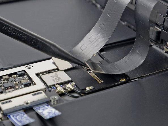

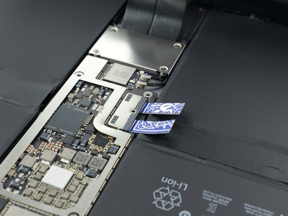

    25. iPad Pro 12.9" 2nd Gen Screen Replacement, Unfasten the logic board EMI shield screws: crwdns2935265:026crwdnd2935265:01crwdnd2935265:02crwdne2935265:0 iPad Pro 12.9" 2nd Gen Screen Replacement, Unfasten the logic board EMI shield screws: crwdns2935265:026crwdnd2935265:02crwdnd2935265:02crwdne2935265:0
      • It's important to disconnect the battery before you proceed further. Detaching or connecting the display cables with the battery plugged in can cause a short that will destroy touchscreen functionality.
      • Use a Phillips screwdriver to remove the six screws securing the logic board EMI shield:

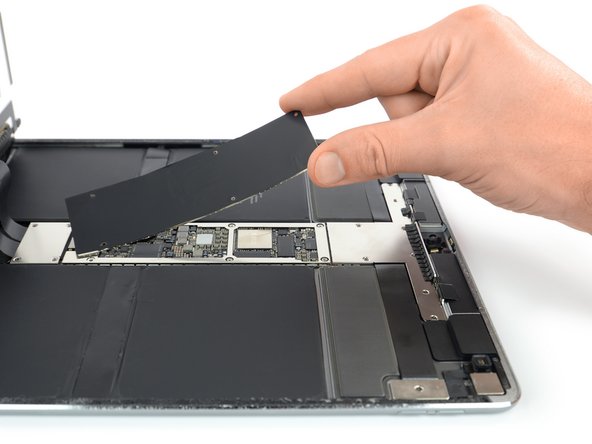

    26. iPad Pro 12.9" 2nd Gen Screen Replacement, Remove the logic board EMI shield: crwdns2935265:027crwdnd2935265:01crwdnd2935265:03crwdne2935265:0 iPad Pro 12.9" 2nd Gen Screen Replacement, Remove the logic board EMI shield: crwdns2935265:027crwdnd2935265:02crwdnd2935265:03crwdne2935265:0 iPad Pro 12.9" 2nd Gen Screen Replacement, Remove the logic board EMI shield: crwdns2935265:027crwdnd2935265:03crwdnd2935265:03crwdne2935265:0
      • Lift the logic board EMI shield from the edge nearest the top of the iPad.
      • Peel up the EMI shield from the logic board.
      • This takes a bit of force due to the many tiny clips securing the shield, and the shield may deform slightly. That's okay—try to keep the deformation to a minimum, and it will lay flat when you reinstall it and screw it down.
      • Remove the logic board EMI shield.

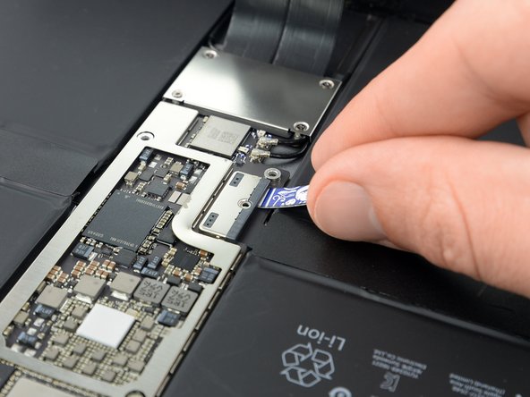

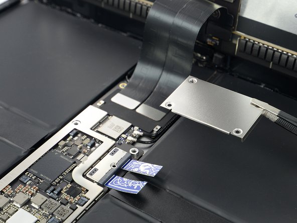

    29. iPad Pro 12.9" 2nd Gen Screen Replacement, Create a battery blocker: crwdns2935265:030crwdnd2935265:01crwdnd2935265:03crwdne2935265:0 iPad Pro 12.9" 2nd Gen Screen Replacement, Create a battery blocker: crwdns2935265:030crwdnd2935265:02crwdnd2935265:03crwdne2935265:0 iPad Pro 12.9" 2nd Gen Screen Replacement, Create a battery blocker: crwdns2935265:030crwdnd2935265:03crwdnd2935265:03crwdne2935265:0
      • Use a piar of scissors to cut two 6 mm x 20 mm strips of a playing card to use as a battery blocker.
    30. iPad Pro 12.9" 2nd Gen Screen Replacement, Insert the card strips: crwdns2935265:031crwdnd2935265:01crwdnd2935265:03crwdne2935265:0 iPad Pro 12.9" 2nd Gen Screen Replacement, Insert the card strips: crwdns2935265:031crwdnd2935265:02crwdnd2935265:03crwdne2935265:0 iPad Pro 12.9" 2nd Gen Screen Replacement, Insert the card strips: crwdns2935265:031crwdnd2935265:03crwdnd2935265:03crwdne2935265:0
      • Gently insert the card strips on each side of the battery connector as far as they will go.
      • You can also use an iFixit battery blocker. Be very careful and don't push the battery blocker underneath the connector with excessive force.

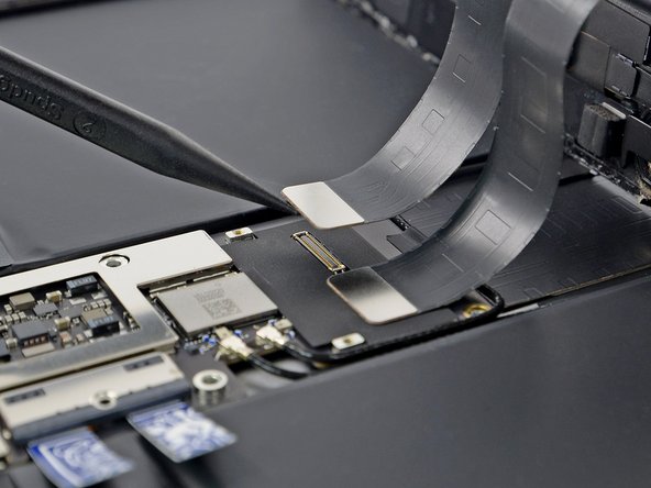

    33. iPad Pro 12.9" 2nd Gen Screen Replacement, Disconnect the display cables: crwdns2935265:034crwdnd2935265:01crwdnd2935265:03crwdne2935265:0 iPad Pro 12.9" 2nd Gen Screen Replacement, Disconnect the display cables: crwdns2935265:034crwdnd2935265:02crwdnd2935265:03crwdne2935265:0 iPad Pro 12.9" 2nd Gen Screen Replacement, Disconnect the display cables: crwdns2935265:034crwdnd2935265:03crwdnd2935265:03crwdne2935265:0
      • Use the pointed end of a spudger to pry up and disconnect the display and digitizer cables from their logic board sockets.
      • To re-attach press connectors like this one, carefully align and press down on one side until it clicks into place, then repeat on the other side. Do not press down on the middle. If the connector is misaligned, the pins can bend, causing permanent damage.
      • These cables are very delicate, and the connectors can damage easily if they're misaligned. When you reattach the cables to the logic board, try to have as much slack on the cables and gently press the connectors onto their sockets.
    34. iPad Pro 12.9" 2nd Gen Screen Replacement, Remove the screen assembly: crwdns2935265:035crwdnd2935265:01crwdnd2935265:01crwdne2935265:0
      • Remove the screen assembly.

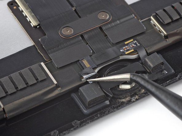

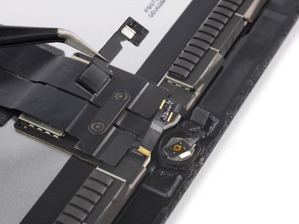

    1. iPad Pro 12.9" 2nd Gen Screen Replacement, Remove the tape: crwdns2935265:036crwdnd2935265:01crwdnd2935265:02crwdne2935265:0 iPad Pro 12.9" 2nd Gen Screen Replacement, Remove the tape: crwdns2935265:036crwdnd2935265:02crwdnd2935265:02crwdne2935265:0
      • Use tweezers to peel off the tape covering the ZIF connector above the home button.
    2. iPad Pro 12.9" 2nd Gen Screen Replacement, Release the ZIF connector: crwdns2935265:037crwdnd2935265:01crwdnd2935265:02crwdne2935265:0 iPad Pro 12.9" 2nd Gen Screen Replacement, Release the ZIF connector: crwdns2935265:037crwdnd2935265:02crwdnd2935265:02crwdne2935265:0
      • Use the point of a spudger to open the ZIF connector that secures the cable by bringing its flap in an upright position.
    3. iPad Pro 12.9" 2nd Gen Screen Replacement, Disconnect the home button: crwdns2935265:038crwdnd2935265:01crwdnd2935265:02crwdne2935265:0 iPad Pro 12.9" 2nd Gen Screen Replacement, Disconnect the home button: crwdns2935265:038crwdnd2935265:02crwdnd2935265:02crwdne2935265:0
      • Use tweezers to slide the cable out of the ZIF connector.

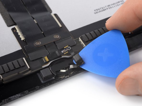

    4. iPad Pro 12.9" 2nd Gen Screen Replacement, Loosen the home button cable adhesive: crwdns2935265:039crwdnd2935265:01crwdnd2935265:01crwdne2935265:0
      • The home button's ribbon cable is very fragile. If it gets damaged, Touch ID will no longer function.
      • Apply a heated iOpener to the home button for 2 minutes to loosen the adhesive underneath its cable.
      • A hair dryer, heat gun, or hot plate may also be used, but be careful not to overheat the screen.
    5. iPad Pro 12.9" 2nd Gen Screen Replacement, Free the home button cable: crwdns2935265:040crwdnd2935265:01crwdnd2935265:02crwdne2935265:0 iPad Pro 12.9" 2nd Gen Screen Replacement, Free the home button cable: crwdns2935265:040crwdnd2935265:02crwdnd2935265:02crwdne2935265:0
      • Carefully slide an opening pick underneath the home button cable to separate it from the screen.

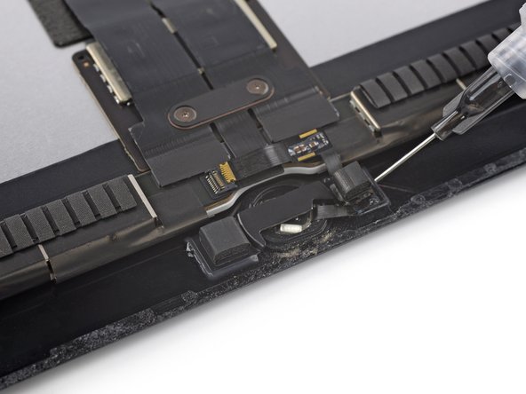

    6. iPad Pro 12.9" 2nd Gen Screen Replacement, Loosen the home button bracket adhesive.: crwdns2935265:041crwdnd2935265:01crwdnd2935265:03crwdne2935265:0 iPad Pro 12.9" 2nd Gen Screen Replacement, Loosen the home button bracket adhesive.: crwdns2935265:041crwdnd2935265:02crwdnd2935265:03crwdne2935265:0 iPad Pro 12.9" 2nd Gen Screen Replacement, Loosen the home button bracket adhesive.: crwdns2935265:041crwdnd2935265:03crwdnd2935265:03crwdne2935265:0
      • The home button bracket is held in place with strong adhesive.
      • Apply a few drops of high concentration (90% or higher) isopropyl alcohol to the base of the home button bracket to loosen its adhesive.
      • A heated iOpener, a hair dryer, heat gun, or hot plate may also be used, but be careful not to overheat the screen.

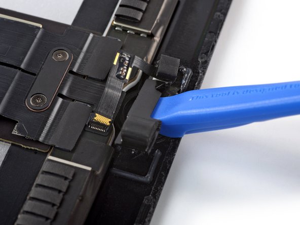

    7. iPad Pro 12.9" 2nd Gen Screen Replacement, Pry up the home button bracket: crwdns2935265:042crwdnd2935265:01crwdnd2935265:02crwdne2935265:0 iPad Pro 12.9" 2nd Gen Screen Replacement, Pry up the home button bracket: crwdns2935265:042crwdnd2935265:02crwdnd2935265:02crwdne2935265:0
      • Insert the edge of an opening tool under the home button bracket lip.
      • Carefully pry up with steady force to loosen the bracket.
      • If you want to transfer your home button to a new screen be especially careful not to damage the home button cable during this procedure.
      • The adhesive holding this bracket can be stubborn. Apply more isopropyl alcohol or heat if it doesn't budge.

    9. iPad Pro 12.9" 2nd Gen Screen Replacement, Remove the home button: crwdns2935265:044crwdnd2935265:01crwdnd2935265:03crwdne2935265:0 iPad Pro 12.9" 2nd Gen Screen Replacement, Remove the home button: crwdns2935265:044crwdnd2935265:02crwdnd2935265:03crwdne2935265:0 iPad Pro 12.9" 2nd Gen Screen Replacement, Remove the home button: crwdns2935265:044crwdnd2935265:03crwdnd2935265:03crwdne2935265:0
      • Gently push the home button from the front of the display inward using the tip of a finger.
      • Remove the home button.
      • The home button attaches to the screen with an adhesive gasket. When you transfer the home button to a new display, use some liquid adhesive to glue the button perimeter to the screen.
