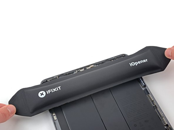

    13. iPad Pro 11" 3rd Gen Battery Replacement, Heat the bottom edge: crwdns2935265:014crwdnd2935265:01crwdnd2935265:01crwdne2935265:0
      • Apply a heated iOpener to the bottom edge of the screen for two minutes.

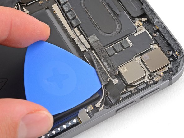

    16. iPad Pro 11" 3rd Gen Battery Replacement: crwdns2935265:017crwdnd2935265:01crwdnd2935265:02crwdne2935265:0 iPad Pro 11" 3rd Gen Battery Replacement: crwdns2935265:017crwdnd2935265:02crwdnd2935265:02crwdne2935265:0
      • Insert a new opening pick to the left of the USB-C port.
      • Separate the remaining bottom edge adhesive.
      • Don't insert the opening pick more than 5 mm when slicing the bottom edge adhesive.
      • Leave the pick in the bottom left corner to prevent the bottom edge adhesive from re-sealing.

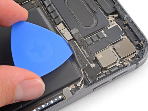

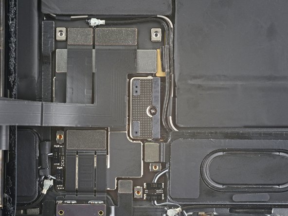

    22. iPad Pro 11" 3rd Gen Battery Replacement, Separate the screen from the frame: crwdns2935265:023crwdnd2935265:01crwdnd2935265:03crwdne2935265:0 iPad Pro 11" 3rd Gen Battery Replacement, Separate the screen from the frame: crwdns2935265:023crwdnd2935265:02crwdnd2935265:03crwdne2935265:0 iPad Pro 11" 3rd Gen Battery Replacement, Separate the screen from the frame: crwdns2935265:023crwdnd2935265:03crwdnd2935265:03crwdne2935265:0
      • At this point, you've separated most of the screen adhesive. Lift the edges of the screen up slightly to check if there is any remaining adhesive.
      • Use an opening pick to remove any remaining adhesive keeping the screen stuck to the frame.
      • Grab the top right and bottom left corners of the screen.
      • Slowly slide the screen towards the bottom right corner to separate it from the frame.
      • Don't fully remove the screen as it is held in place by several ribbon cables underneath.
      • Shift the screen towards the bottom right corner of the frame until the ambient light sensor ribbon cable near the top edge is uncovered.

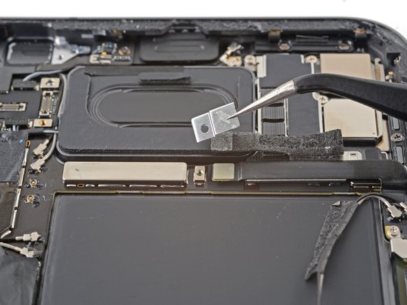

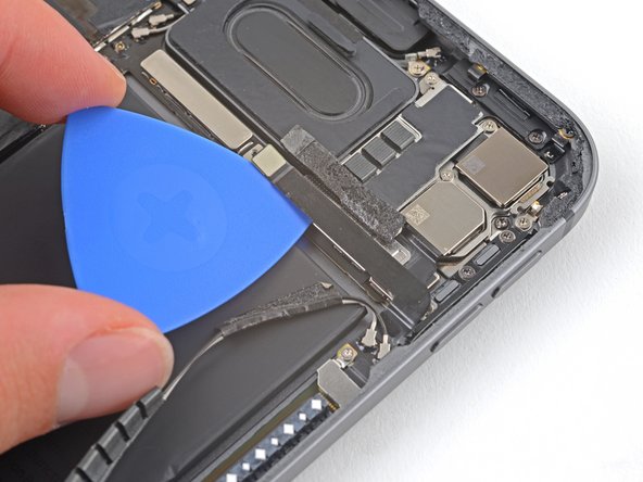

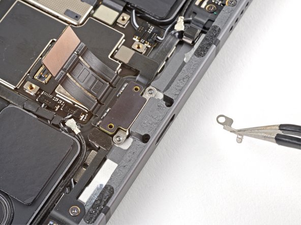

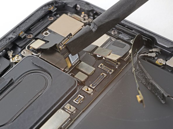

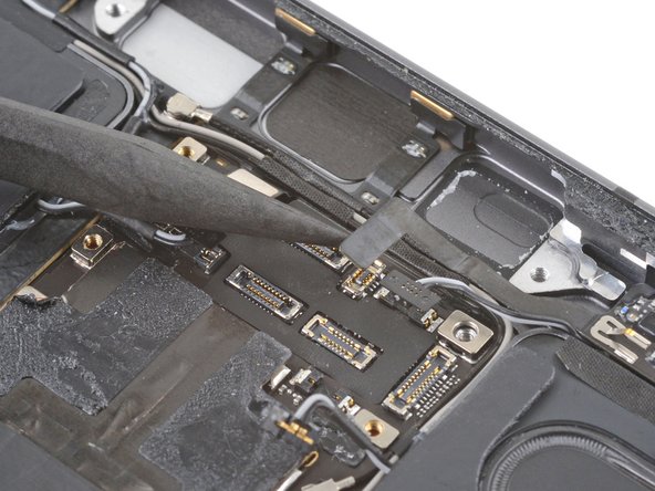

    23. iPad Pro 11" 3rd Gen Battery Replacement, Unscrew the ambient light sensor cable bracket: crwdns2935265:024crwdnd2935265:01crwdnd2935265:02crwdne2935265:0 iPad Pro 11" 3rd Gen Battery Replacement, Unscrew the ambient light sensor cable bracket: crwdns2935265:024crwdnd2935265:02crwdnd2935265:02crwdne2935265:0
      FixMat
      $36.95
      • Use a Phillips screwdriver to remove the two screws securing the ambient light sensor cable bracket to the logic board:
      • One 1.3 mm screw
      • One 2.0 mm screw
      • During reassembly, this is a good point to power on your iPad and test all functions before sealing it up. Be sure to power your iPad back down before you continue working.

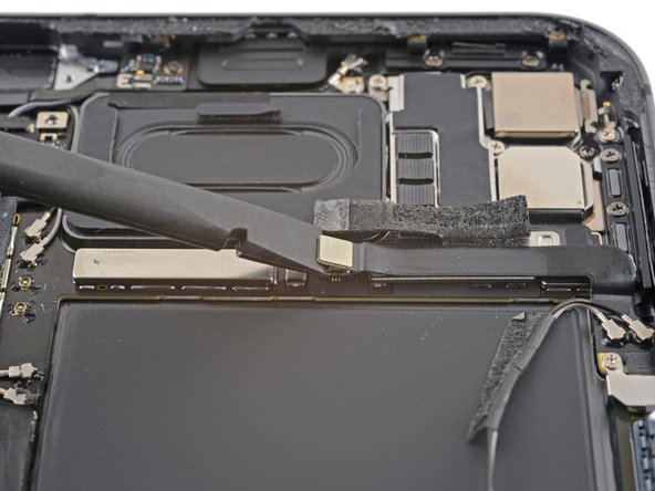

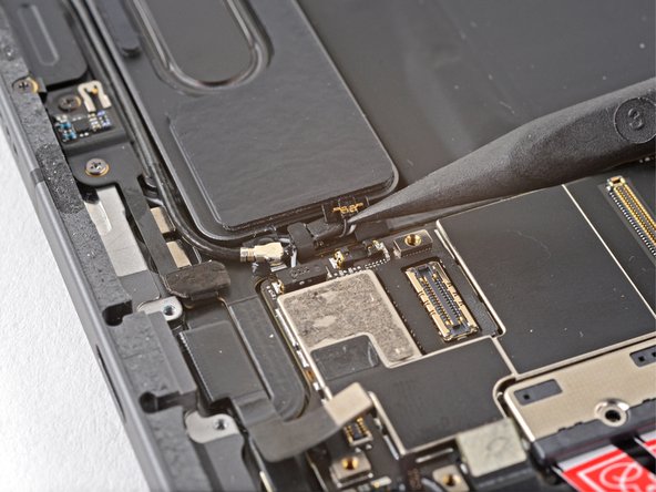

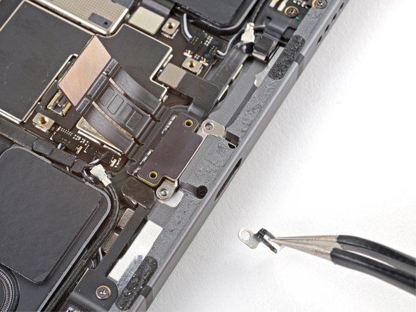

    24. iPad Pro 11" 3rd Gen Battery Replacement, Remove the ambient light sensor cable bracket: crwdns2935265:025crwdnd2935265:01crwdnd2935265:01crwdne2935265:0
      • Use a pair of tweezers or your fingers to remove the bracket.

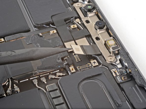

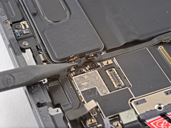

    25. iPad Pro 11" 3rd Gen Battery Replacement, Disconnect the ambient light sensor cable: crwdns2935265:026crwdnd2935265:01crwdnd2935265:02crwdne2935265:0 iPad Pro 11" 3rd Gen Battery Replacement, Disconnect the ambient light sensor cable: crwdns2935265:026crwdnd2935265:02crwdnd2935265:02crwdne2935265:0
      • Use the flat end of a spudger to disconnect the ambient light sensor cable by lifting straight up on the press connectors.
      • To re-attach press connectors like this one, carefully align and press down on one side until it clicks into place, then repeat on the other side. Do not press down on the middle. If the connector is misaligned, the pins can bend and cause permanent damage.

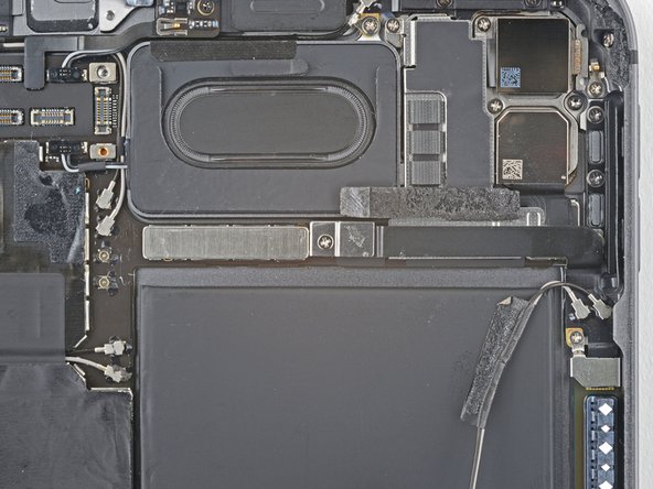

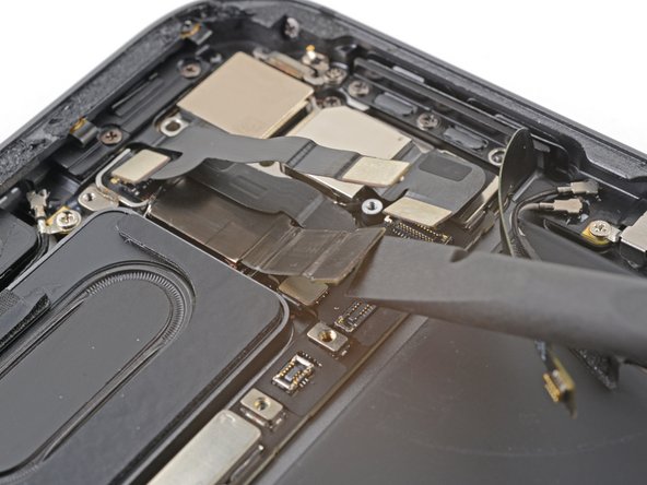

    26. iPad Pro 11" 3rd Gen Battery Replacement, Reposition the screen: crwdns2935265:027crwdnd2935265:01crwdnd2935265:03crwdne2935265:0 iPad Pro 11" 3rd Gen Battery Replacement, Reposition the screen: crwdns2935265:027crwdnd2935265:02crwdnd2935265:03crwdne2935265:0 iPad Pro 11" 3rd Gen Battery Replacement, Reposition the screen: crwdns2935265:027crwdnd2935265:03crwdnd2935265:03crwdne2935265:0
      • Don't try to remove the screen yet, as it's still attached by delicate ribbon cables.
      • Grip the right edge of the screen and fold it open like a book.
      • Lay the screen down over the left edge of the iPad.

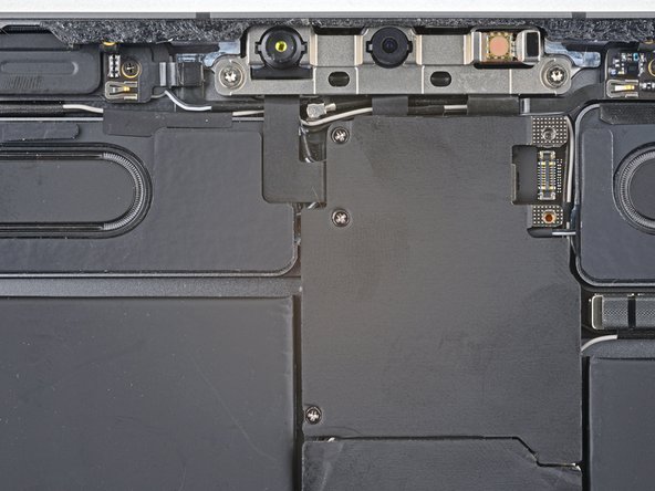

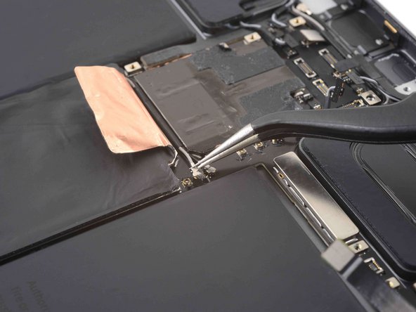

    1. iPad Pro 11" 3rd Gen Battery Replacement, Unfasten the lower cable shield: crwdns2935265:028crwdnd2935265:01crwdnd2935265:02crwdne2935265:0 iPad Pro 11" 3rd Gen Battery Replacement, Unfasten the lower cable shield: crwdns2935265:028crwdnd2935265:02crwdnd2935265:02crwdne2935265:0

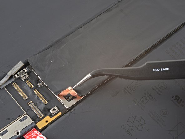

    3. iPad Pro 11" 3rd Gen Battery Replacement, Unfasten the battery connector: crwdns2935265:030crwdnd2935265:01crwdnd2935265:02crwdne2935265:0 iPad Pro 11" 3rd Gen Battery Replacement, Unfasten the battery connector: crwdns2935265:030crwdnd2935265:02crwdnd2935265:02crwdne2935265:0
      • Use a Phillips screwdriver to remove the 1.8 mm screw securing the battery connector to the logic board.

    1. iPad Pro 11" 3rd Gen Battery Replacement, Unfasten the top cable shield: crwdns2935265:039crwdnd2935265:01crwdnd2935265:02crwdne2935265:0 iPad Pro 11" 3rd Gen Battery Replacement, Unfasten the top cable shield: crwdns2935265:039crwdnd2935265:02crwdnd2935265:02crwdne2935265:0
      • Use a Phillips screwdriver to remove the three 1.2 mm screws securing the top cable shield.
    2. iPad Pro 11" 3rd Gen Battery Replacement, Heat the top cable shield: crwdns2935265:040crwdnd2935265:01crwdnd2935265:02crwdne2935265:0 iPad Pro 11" 3rd Gen Battery Replacement, Heat the top cable shield: crwdns2935265:040crwdnd2935265:02crwdnd2935265:02crwdne2935265:0
      • Apply a heated iOpener to the top cable shield for one minute to soften the adhesive securing it to the logic board.

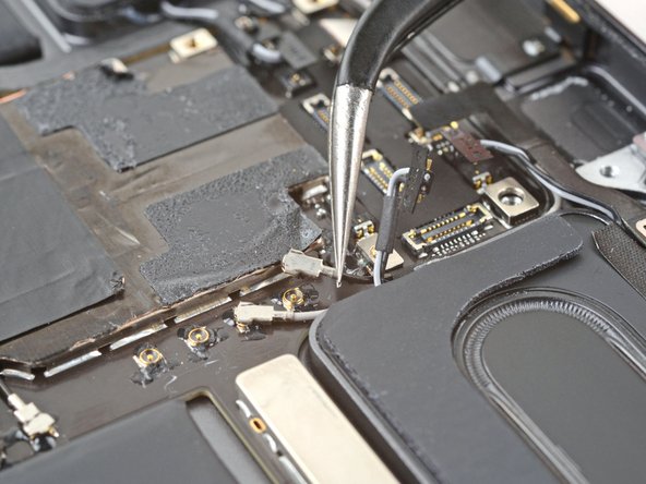

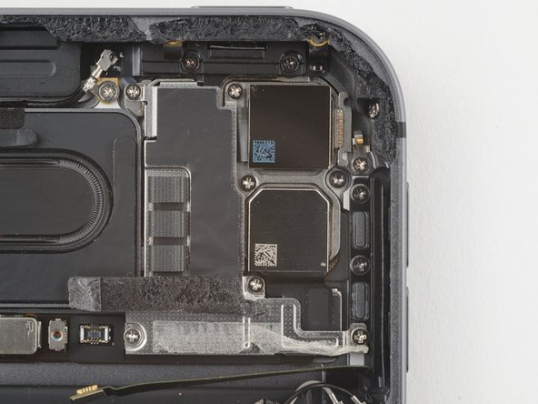

    1. iPad Pro 11" 3rd Gen Battery Replacement, Disconnect the two 5G mmWave antenna coaxial cables: crwdns2935265:047crwdnd2935265:01crwdnd2935265:03crwdne2935265:0 iPad Pro 11" 3rd Gen Battery Replacement, Disconnect the two 5G mmWave antenna coaxial cables: crwdns2935265:047crwdnd2935265:02crwdnd2935265:03crwdne2935265:0 iPad Pro 11" 3rd Gen Battery Replacement, Disconnect the two 5G mmWave antenna coaxial cables: crwdns2935265:047crwdnd2935265:03crwdnd2935265:03crwdne2935265:0
      • To disconnect antenna cables like this, use tweezers to grip the connector near the cable and lift it up.
      • Use tweezers to disconnect the two antenna cables.
      • Be careful using tweezers or other pointy metal tools near the battery—a punctured battery may leak dangerous chemicals or cause a fire.
      • To reinstall, hold the connector in place and gently press straight down. The connector will “snap” into its socket much like the metal snaps on a jacket.

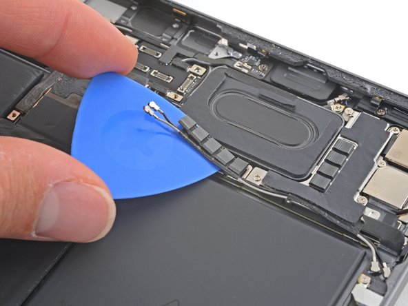

    2. iPad Pro 11" 3rd Gen Battery Replacement, Separate the 5G mmWave antenna cables: crwdns2935265:048crwdnd2935265:01crwdnd2935265:03crwdne2935265:0 iPad Pro 11" 3rd Gen Battery Replacement, Separate the 5G mmWave antenna cables: crwdns2935265:048crwdnd2935265:02crwdnd2935265:03crwdne2935265:0 iPad Pro 11" 3rd Gen Battery Replacement, Separate the 5G mmWave antenna cables: crwdns2935265:048crwdnd2935265:03crwdnd2935265:03crwdne2935265:0
      • The antenna cables are secured to the logic board with weak adhesive.
      • Slide an opening pick under the antenna cables to separate them from the logic board.

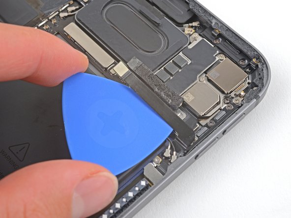

    3. iPad Pro 11" 3rd Gen Battery Replacement: crwdns2935265:049crwdnd2935265:01crwdnd2935265:03crwdne2935265:0 iPad Pro 11" 3rd Gen Battery Replacement: crwdns2935265:049crwdnd2935265:02crwdnd2935265:03crwdne2935265:0 iPad Pro 11" 3rd Gen Battery Replacement: crwdns2935265:049crwdnd2935265:03crwdnd2935265:03crwdne2935265:0
      • Use an opening pick to separate the thin foam covering the antenna cables.

      • The antenna cables are secured to the mmWave interconnect cable with weak adhesive.
      • Slide an opening pick between the antenna cables and the mmWave interconnect cable to separate them.
    5. iPad Pro 11" 3rd Gen Battery Replacement, Unfasten the antenna cable bracket: crwdns2935265:051crwdnd2935265:01crwdnd2935265:02crwdne2935265:0 iPad Pro 11" 3rd Gen Battery Replacement, Unfasten the antenna cable bracket: crwdns2935265:051crwdnd2935265:02crwdnd2935265:02crwdne2935265:0
      • Use a Phillips screwdriver to remove the 1.2 mm screw securing the press connector bracket to the logic board.
    6. iPad Pro 11" 3rd Gen Battery Replacement, Remove the antenna cable bracket: crwdns2935265:052crwdnd2935265:01crwdnd2935265:02crwdne2935265:0 iPad Pro 11" 3rd Gen Battery Replacement, Remove the antenna cable bracket: crwdns2935265:052crwdnd2935265:02crwdnd2935265:02crwdne2935265:0
      • Use tweezers or your fingers to remove the antenna cable bracket.

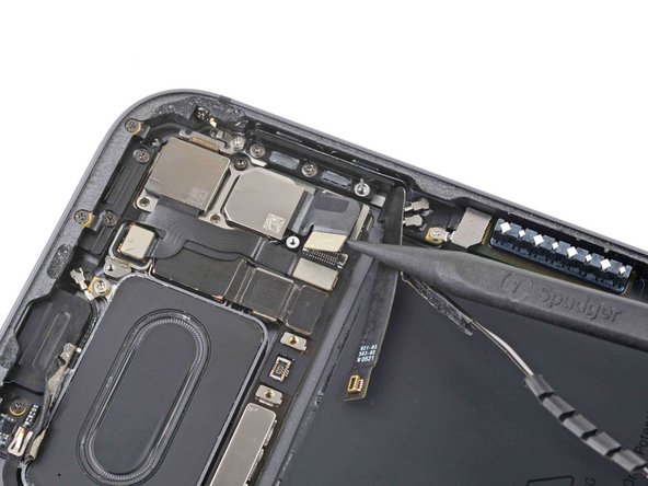

    7. iPad Pro 11" 3rd Gen Battery Replacement, Disconnect the mmWave flex cable: crwdns2935265:053crwdnd2935265:01crwdnd2935265:02crwdne2935265:0 iPad Pro 11" 3rd Gen Battery Replacement, Disconnect the mmWave flex cable: crwdns2935265:053crwdnd2935265:02crwdnd2935265:02crwdne2935265:0
      • Use the flat end of a spudger to disconnect the mmWave flex cable.
    8. iPad Pro 11" 3rd Gen Battery Replacement: crwdns2935265:054crwdnd2935265:01crwdnd2935265:03crwdne2935265:0 iPad Pro 11" 3rd Gen Battery Replacement: crwdns2935265:054crwdnd2935265:02crwdnd2935265:03crwdne2935265:0 iPad Pro 11" 3rd Gen Battery Replacement: crwdns2935265:054crwdnd2935265:03crwdnd2935265:03crwdne2935265:0
      • Slide an opening pick under the mmWave flex cable to separate it from the logic board.
    9. iPad Pro 11" 3rd Gen Battery Replacement, Unfasten the rear camera shield: crwdns2935265:055crwdnd2935265:01crwdnd2935265:02crwdne2935265:0 iPad Pro 11" 3rd Gen Battery Replacement, Unfasten the rear camera shield: crwdns2935265:055crwdnd2935265:02crwdnd2935265:02crwdne2935265:0
      • Some of these screws are the same length but have different thread sizes. Don't mix up the screws or you'll damage the threads in the frame.
      • Use your Phillips screwdriver to remove the six screws securing the rear camera shield to the frame:
      • Two 2.8 mm screws
      • One 1.9 mm screw
      • One 1.9 mm screw
      • One 1.2 mm screw
      • One 1.2 mm screw
    10. iPad Pro 11" 3rd Gen Battery Replacement, Remove the rear camera shield: crwdns2935265:056crwdnd2935265:01crwdnd2935265:03crwdne2935265:0 iPad Pro 11" 3rd Gen Battery Replacement, Remove the rear camera shield: crwdns2935265:056crwdnd2935265:02crwdnd2935265:03crwdne2935265:0 iPad Pro 11" 3rd Gen Battery Replacement, Remove the rear camera shield: crwdns2935265:056crwdnd2935265:03crwdnd2935265:03crwdne2935265:0
      • Use tweezers or your fingers to lift the right side of the camera shield up.
      • Slide the shield out horizontally.
      • During reassembly, lower the left side of the shield back into place and make sure the small protruding tab is slotted in, then hinge the shield closed.

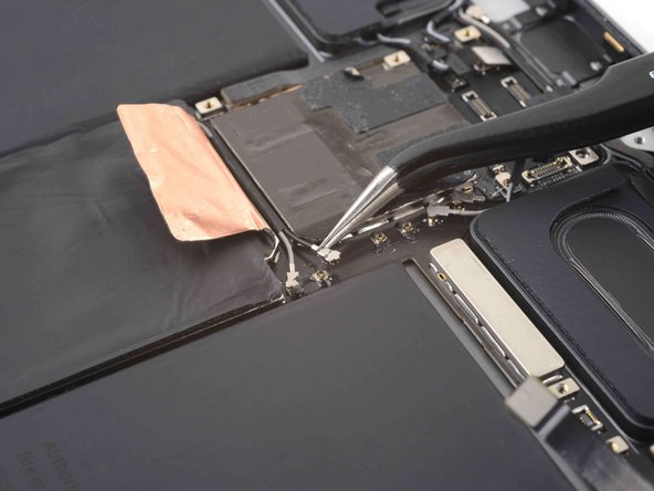

    8. iPad Pro 11" 3rd Gen Battery Replacement, Peel back the top logic board shielding: crwdns2935265:069crwdnd2935265:01crwdnd2935265:03crwdne2935265:0 iPad Pro 11" 3rd Gen Battery Replacement, Peel back the top logic board shielding: crwdns2935265:069crwdnd2935265:02crwdnd2935265:03crwdne2935265:0 iPad Pro 11" 3rd Gen Battery Replacement, Peel back the top logic board shielding: crwdns2935265:069crwdnd2935265:03crwdnd2935265:03crwdne2935265:0
      • Use tweezers to peel back the logic board shielding tape covering the two antenna cables.

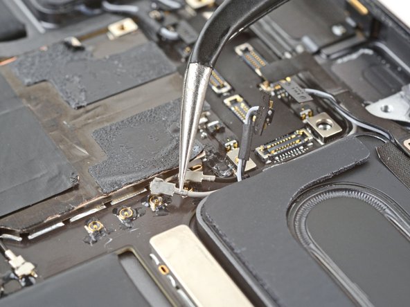

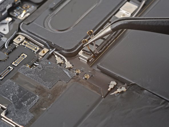

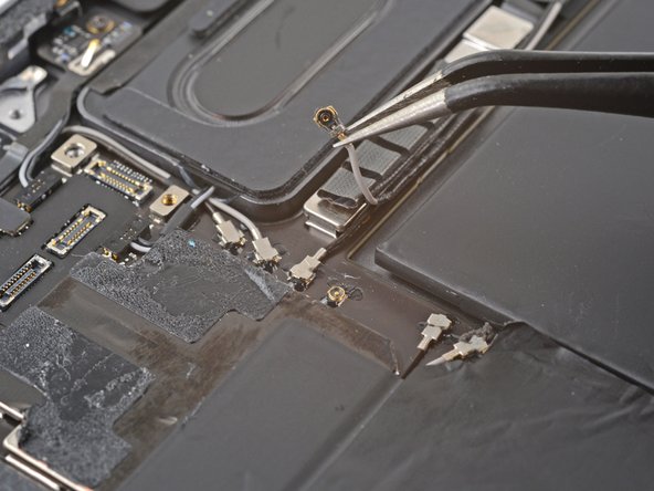

    9. iPad Pro 11" 3rd Gen Battery Replacement, Disconnect the bottom right antenna cables: crwdns2935265:070crwdnd2935265:01crwdnd2935265:03crwdne2935265:0 iPad Pro 11" 3rd Gen Battery Replacement, Disconnect the bottom right antenna cables: crwdns2935265:070crwdnd2935265:02crwdnd2935265:03crwdne2935265:0 iPad Pro 11" 3rd Gen Battery Replacement, Disconnect the bottom right antenna cables: crwdns2935265:070crwdnd2935265:03crwdnd2935265:03crwdne2935265:0
      • Use tweezers to disconnect the two bottom right antenna cables.

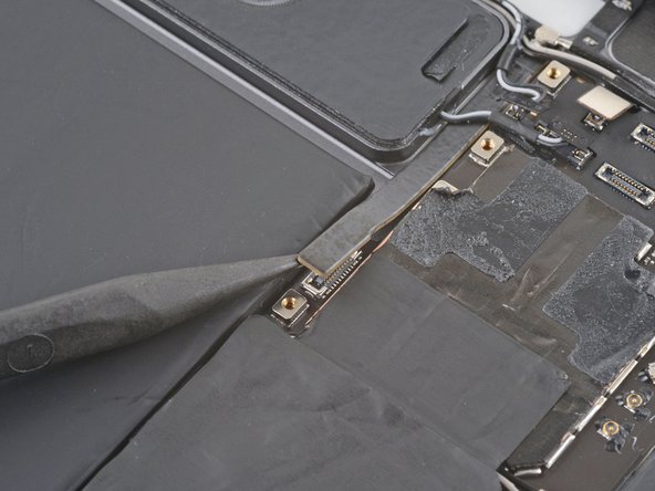

    10. iPad Pro 11" 3rd Gen Battery Replacement, Disconnect bottom interconnect board: crwdns2935265:071crwdnd2935265:01crwdnd2935265:02crwdne2935265:0 iPad Pro 11" 3rd Gen Battery Replacement, Disconnect bottom interconnect board: crwdns2935265:071crwdnd2935265:02crwdnd2935265:02crwdne2935265:0
      • Use the pointed edge of a spudger to disconnect the bottom interconnect board.
      • Don't bend or reposition the interconnect board. It's stiff and will break if overbent.

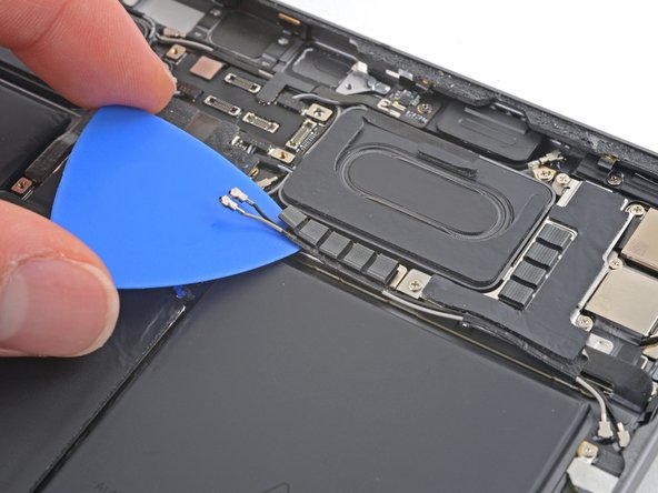

    15. iPad Pro 11" 3rd Gen Battery Replacement, Reposition the bottom right 5G mmWave antenna cables: crwdns2935265:076crwdnd2935265:01crwdnd2935265:03crwdne2935265:0 iPad Pro 11" 3rd Gen Battery Replacement, Reposition the bottom right 5G mmWave antenna cables: crwdns2935265:076crwdnd2935265:02crwdnd2935265:03crwdne2935265:0 iPad Pro 11" 3rd Gen Battery Replacement, Reposition the bottom right 5G mmWave antenna cables: crwdns2935265:076crwdnd2935265:03crwdnd2935265:03crwdne2935265:0
      • Gently pull the antenna cables away from the logic board.
    16. iPad Pro 11" 3rd Gen Battery Replacement: crwdns2935265:077crwdnd2935265:01crwdnd2935265:03crwdne2935265:0 iPad Pro 11" 3rd Gen Battery Replacement: crwdns2935265:077crwdnd2935265:02crwdnd2935265:03crwdne2935265:0 iPad Pro 11" 3rd Gen Battery Replacement: crwdns2935265:077crwdnd2935265:03crwdnd2935265:03crwdne2935265:0
      • Continue repositioning the antenna cables until they are clear from the bottom of the logic board.

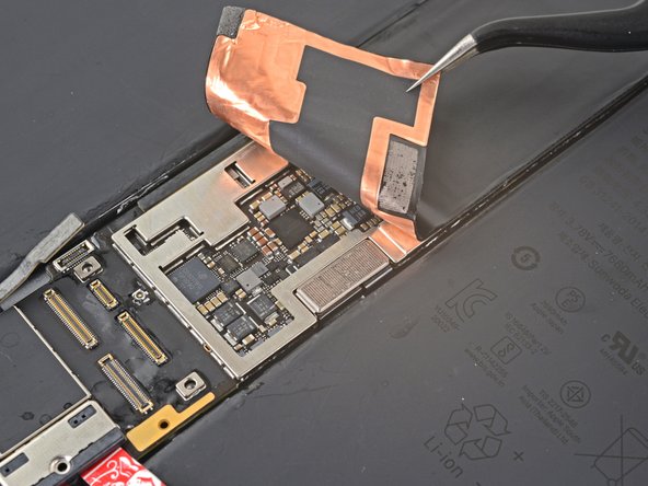

    17. iPad Pro 11" 3rd Gen Battery Replacement, Peel back the bottom logic board shielding: crwdns2935265:078crwdnd2935265:01crwdnd2935265:03crwdne2935265:0 iPad Pro 11" 3rd Gen Battery Replacement, Peel back the bottom logic board shielding: crwdns2935265:078crwdnd2935265:02crwdnd2935265:03crwdne2935265:0 iPad Pro 11" 3rd Gen Battery Replacement, Peel back the bottom logic board shielding: crwdns2935265:078crwdnd2935265:03crwdnd2935265:03crwdne2935265:0
      • Use tweezers or your fingers to peel back the logic board shielding to reveal the hidden press connectors.

    23. iPad Pro 11" 3rd Gen Battery Replacement, Pry up the bottom: crwdns2935265:084crwdnd2935265:01crwdnd2935265:03crwdne2935265:0 iPad Pro 11" 3rd Gen Battery Replacement, Pry up the bottom: crwdns2935265:084crwdnd2935265:02crwdnd2935265:03crwdne2935265:0 iPad Pro 11" 3rd Gen Battery Replacement, Pry up the bottom: crwdns2935265:084crwdnd2935265:03crwdnd2935265:03crwdne2935265:0
      • Insert the flat end of a spudger under the lower edge of the logic board.
      • Don't pry against the bottom interconnect board as this will damage it.
      • Slowly lift up the bottom of the logic board.
      • If the adhesive is still too strong to lift up the logic board, apply some additional isopropyl alcohol and wait one minute.
      • Lift up the logic board and replace the playing card battery blocker with an opening pick.

      • Slide the opening pick under the right edge of the logic board to loosen it.
      • Pry against the frame underneath the logic board to separate the adhesive.
      • Don't forcefully lever against the battery—a punctured or bent battery may leak dangerous chemicals or cause a fire.

      • Use the flat end of a spudger to lift the top edge of the logic board.
      • Grip the top and bottom edges of the logic board.
      • Remove the logic board.
    1. iPad Pro 11" 3rd Gen Battery Replacement, Battery adhesive removal information: crwdns2935265:089crwdnd2935265:01crwdnd2935265:02crwdne2935265:0 iPad Pro 11" 3rd Gen Battery Replacement, Battery adhesive removal information: crwdns2935265:089crwdnd2935265:02crwdnd2935265:02crwdne2935265:0
      • There are 11 stretch-release adhesives that secure the battery to the frame. Each adhesive strip has a black pull tab:
      • Six on the inside edge of the left battery
      • Five on the inside edge of the right battery
      • The remainder of the adhesive is located along the bottom edge of the battery.
      • Use your fingernail or tweezers to peel each pull tab from the edge of the battery without removing them.
      • Be careful not to deform or puncture the battery—especially if you're using tweezers.
    2. iPad Pro 11" 3rd Gen Battery Replacement, Remove the battery adhesive: crwdns2935265:090crwdnd2935265:01crwdnd2935265:03crwdne2935265:0 iPad Pro 11" 3rd Gen Battery Replacement, Remove the battery adhesive: crwdns2935265:090crwdnd2935265:02crwdnd2935265:03crwdne2935265:0 iPad Pro 11" 3rd Gen Battery Replacement, Remove the battery adhesive: crwdns2935265:090crwdnd2935265:03crwdnd2935265:03crwdne2935265:0
      • Pull the strip out slowly and steadily at a low angle. Give it plenty of time to stretch and un-stick from under the battery.
      • You can use a spudger to help keep the strip flat while pulling.
      • If the adhesive strip breaks off, try to retrieve it using your fingers or blunt tweezers, and continue pulling—but don't pry under the battery.
