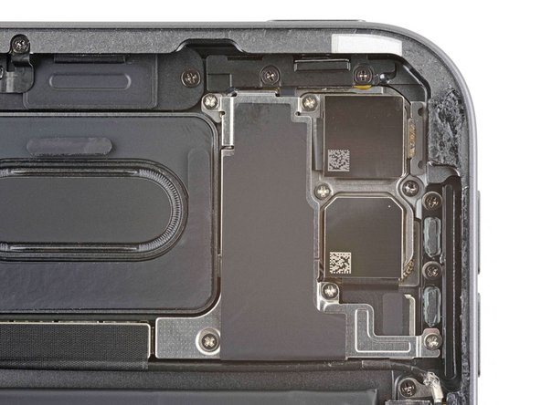

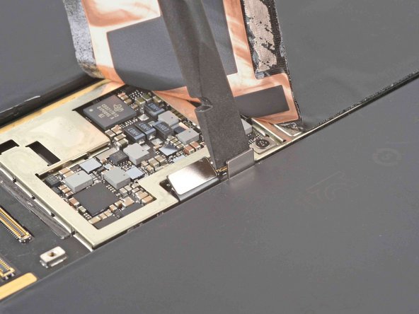

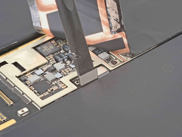

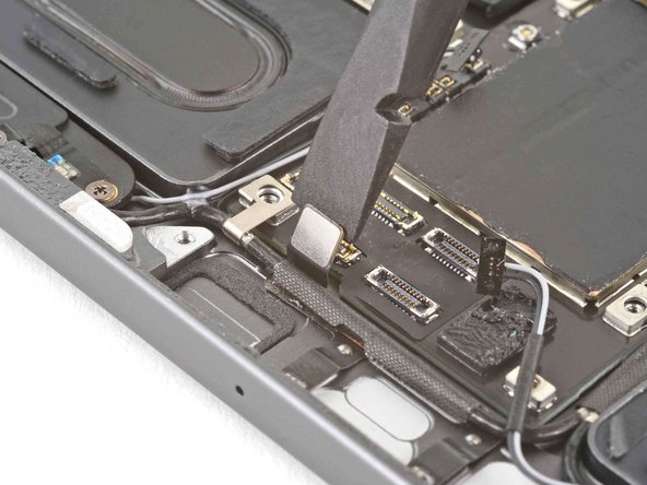

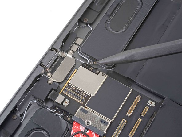

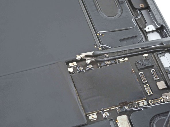

  24. iPad Pro 11" 2nd Gen Logic Board Replacement, Unscrew the ambient light sensor cable bracket: crwdns2935265:024crwdnd2935265:01crwdnd2935265:02crwdne2935265:0 iPad Pro 11" 2nd Gen Logic Board Replacement, Unscrew the ambient light sensor cable bracket: crwdns2935265:024crwdnd2935265:02crwdnd2935265:02crwdne2935265:0
    FixMat
    $36.95
    • Use a Phillips screwdriver to remove the two screws securing the ambient light sensor cable bracket to the logic board:
    • One 1.3 mm screw
    • One 2.0 mm screw
    • During reassembly, this is a good point to power on your iPad and test all functions before sealing it up. Be sure to power your iPad back down before you continue working.

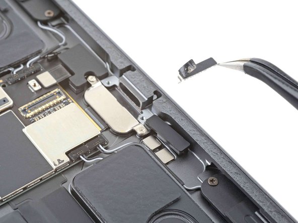

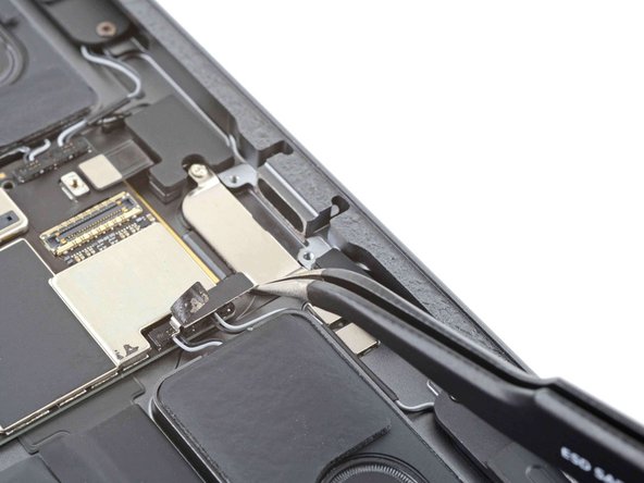

  25. iPad Pro 11" 2nd Gen Logic Board Replacement, Remove the ambient light sensor cable bracket: crwdns2935265:025crwdnd2935265:01crwdnd2935265:01crwdne2935265:0
    • Use a pair of tweezers or your fingers to remove the bracket.

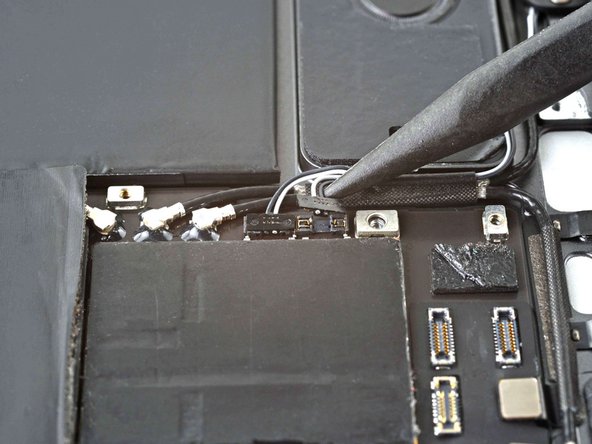

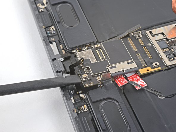

  26. iPad Pro 11" 2nd Gen Logic Board Replacement, Disconnect the ambient light sensor cable: crwdns2935265:026crwdnd2935265:01crwdnd2935265:02crwdne2935265:0 iPad Pro 11" 2nd Gen Logic Board Replacement, Disconnect the ambient light sensor cable: crwdns2935265:026crwdnd2935265:02crwdnd2935265:02crwdne2935265:0
    • Use the flat end of a spudger to disconnect the ambient light sensor cable by lifting straight up on the press connectors.
    • To re-attach press connectors like this one, carefully align and press down on one side until it clicks into place, then repeat on the other side. Do not press down on the middle. If the connector is misaligned, the pins can bend and cause permanent damage.

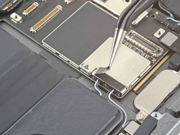

  28. iPad Pro 11" 2nd Gen Logic Board Replacement, Unfasten the lower cable shield: crwdns2935265:028crwdnd2935265:01crwdnd2935265:02crwdne2935265:0 iPad Pro 11" 2nd Gen Logic Board Replacement, Unfasten the lower cable shield: crwdns2935265:028crwdnd2935265:02crwdnd2935265:02crwdne2935265:0
    • Use a Phillips screwdriver to remove the three 1.2 mm screws securing the lower cable shield to the logic board.
  29. iPad Pro 11" 2nd Gen Logic Board Replacement, Remove the lower cable shield: crwdns2935265:029crwdnd2935265:01crwdnd2935265:03crwdne2935265:0 iPad Pro 11" 2nd Gen Logic Board Replacement, Remove the lower cable shield: crwdns2935265:029crwdnd2935265:02crwdnd2935265:03crwdne2935265:0 iPad Pro 11" 2nd Gen Logic Board Replacement, Remove the lower cable shield: crwdns2935265:029crwdnd2935265:03crwdnd2935265:03crwdne2935265:0
    • Use tweezers, or your fingers, to remove the lower cable shield.

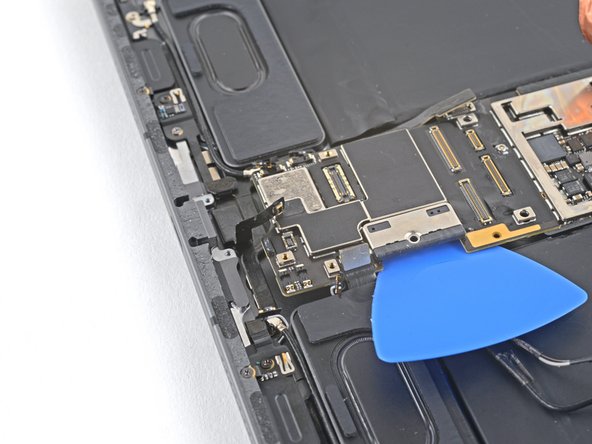

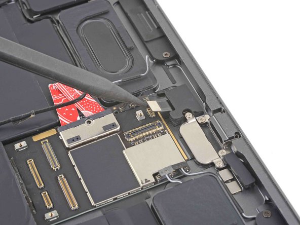

  30. iPad Pro 11" 2nd Gen Logic Board Replacement, Unfasten the battery connector: crwdns2935265:030crwdnd2935265:01crwdnd2935265:02crwdne2935265:0 iPad Pro 11" 2nd Gen Logic Board Replacement, Unfasten the battery connector: crwdns2935265:030crwdnd2935265:02crwdnd2935265:02crwdne2935265:0
    • Use a Phillips screwdriver to remove the 1.8 mm screw securing the battery connector to the logic board.
  31. iPad Pro 11" 2nd Gen Logic Board Replacement, Disconnect the display cables: crwdns2935265:031crwdnd2935265:01crwdnd2935265:03crwdne2935265:0 iPad Pro 11" 2nd Gen Logic Board Replacement, Disconnect the display cables: crwdns2935265:031crwdnd2935265:02crwdnd2935265:03crwdne2935265:0 iPad Pro 11" 2nd Gen Logic Board Replacement, Disconnect the display cables: crwdns2935265:031crwdnd2935265:03crwdnd2935265:03crwdne2935265:0
    • Use the pointed end of a spudger to pry up and disconnect the top two display cables.
  32. iPad Pro 11" 2nd Gen Logic Board Replacement, Disconnect the remaining display cables: crwdns2935265:032crwdnd2935265:01crwdnd2935265:03crwdne2935265:0 iPad Pro 11" 2nd Gen Logic Board Replacement, Disconnect the remaining display cables: crwdns2935265:032crwdnd2935265:02crwdnd2935265:03crwdne2935265:0 iPad Pro 11" 2nd Gen Logic Board Replacement, Disconnect the remaining display cables: crwdns2935265:032crwdnd2935265:03crwdnd2935265:03crwdne2935265:0
    • Disconnect the two remaining display cables.

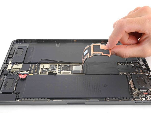

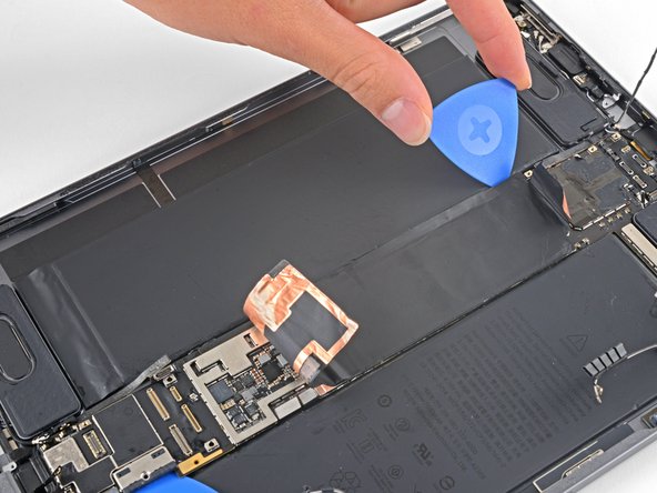

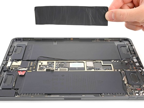

  33. iPad Pro 11" 2nd Gen Logic Board Replacement, Remove the screen: crwdns2935265:033crwdnd2935265:01crwdnd2935265:01crwdne2935265:0
    • Grip the right edge of the screen and lift it away.
    • During reassembly, before installing a screen, remove any remaining adhesive from the frame, and clean the glued areas with high-strength (>90%) isopropyl alcohol and a lint-free cloth. This helps prep the iPad for fresh adhesive and ensures that it will bond properly.
    • If you plan to reinstall your existing screen, remove any remaining adhesive from the back and clean the adhered areas with isopropyl alcohol.
    • Follow this guide to install pre-cut adhesive strips on your iPad before sealing it up.

  48. iPad Pro 11" 2nd Gen Logic Board Replacement, Unfasten the rear camera shield: crwdns2935265:048crwdnd2935265:01crwdnd2935265:02crwdne2935265:0 iPad Pro 11" 2nd Gen Logic Board Replacement, Unfasten the rear camera shield: crwdns2935265:048crwdnd2935265:02crwdnd2935265:02crwdne2935265:0
    • Some of these screws are the same length but have different thread sizes. Don't mix up the screws or you'll damage the threads in the frame.
    • Use a Phillips screwdriver to remove the five screws securing the camera bracket to the frame:
    • One 1.3 mm screw
    • One 2.8 mm screw
    • One 1.3 mm screw
    • One 1.8 mm screw
    • One 1.8 mm screw
  49. iPad Pro 11" 2nd Gen Logic Board Replacement, Remove the rear camera shield: crwdns2935265:049crwdnd2935265:01crwdnd2935265:03crwdne2935265:0 iPad Pro 11" 2nd Gen Logic Board Replacement, Remove the rear camera shield: crwdns2935265:049crwdnd2935265:02crwdnd2935265:03crwdne2935265:0 iPad Pro 11" 2nd Gen Logic Board Replacement, Remove the rear camera shield: crwdns2935265:049crwdnd2935265:03crwdnd2935265:03crwdne2935265:0
    • Use tweezers or your fingers to lift the right side of the camera shield up.
    • Slide the shield out horizontally.
    • During reassembly, lower the left side of the shield back into place and make sure the small protruding tab is slotted in, then hinge the shield closed.

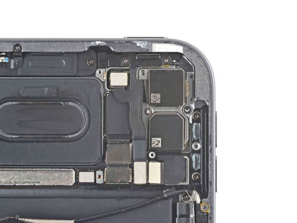

  50. iPad Pro 11" 2nd Gen Logic Board Replacement, Disconnect the wide angle camera cable: crwdns2935265:050crwdnd2935265:01crwdnd2935265:02crwdne2935265:0 iPad Pro 11" 2nd Gen Logic Board Replacement, Disconnect the wide angle camera cable: crwdns2935265:050crwdnd2935265:02crwdnd2935265:02crwdne2935265:0
    • Use the pointed end of a spudger to disconnect the wide angle camera cable.
  51. iPad Pro 11" 2nd Gen Logic Board Replacement, Disconnect the power button and LED cable: crwdns2935265:051crwdnd2935265:01crwdnd2935265:03crwdne2935265:0 iPad Pro 11" 2nd Gen Logic Board Replacement, Disconnect the power button and LED cable: crwdns2935265:051crwdnd2935265:02crwdnd2935265:03crwdne2935265:0 iPad Pro 11" 2nd Gen Logic Board Replacement, Disconnect the power button and LED cable: crwdns2935265:051crwdnd2935265:03crwdnd2935265:03crwdne2935265:0
    • Use the pointed end of a spudger to disconnect the power button and LED cable.
  52. iPad Pro 11" 2nd Gen Logic Board Replacement, Disconnect the LiDAR sensor cable: crwdns2935265:052crwdnd2935265:01crwdnd2935265:02crwdne2935265:0 iPad Pro 11" 2nd Gen Logic Board Replacement, Disconnect the LiDAR sensor cable: crwdns2935265:052crwdnd2935265:02crwdnd2935265:02crwdne2935265:0
    • Use the pointed end of a spudger to disconnect the LiDAR sensor cable.
  53. iPad Pro 11" 2nd Gen Logic Board Replacement, Disconnect the ultra wide camera cable: crwdns2935265:053crwdnd2935265:01crwdnd2935265:02crwdne2935265:0 iPad Pro 11" 2nd Gen Logic Board Replacement, Disconnect the ultra wide camera cable: crwdns2935265:053crwdnd2935265:02crwdnd2935265:02crwdne2935265:0
    • Use the pointed edge of a spudger to disconnect the ultra wide camera cable.
  54. iPad Pro 11" 2nd Gen Logic Board Replacement, Unfasten the rear camera: crwdns2935265:054crwdnd2935265:01crwdnd2935265:02crwdne2935265:0 iPad Pro 11" 2nd Gen Logic Board Replacement, Unfasten the rear camera: crwdns2935265:054crwdnd2935265:02crwdnd2935265:02crwdne2935265:0
    • Use a Phillips screwdriver to remove the 2.8 mm screw securing the rear camera to the frame.
  55. iPad Pro 11" 2nd Gen Logic Board Replacement, Remove the rear camera: crwdns2935265:055crwdnd2935265:01crwdnd2935265:03crwdne2935265:0 iPad Pro 11" 2nd Gen Logic Board Replacement, Remove the rear camera: crwdns2935265:055crwdnd2935265:02crwdnd2935265:03crwdne2935265:0 iPad Pro 11" 2nd Gen Logic Board Replacement, Remove the rear camera: crwdns2935265:055crwdnd2935265:03crwdnd2935265:03crwdne2935265:0
    • Use the flat end of a spudger to pry up and loosen the rear camera module.
    • Use tweezers or your fingers to grab and remove the rear camera module.

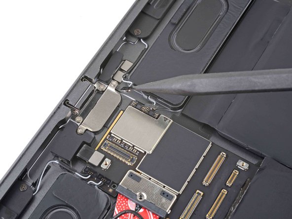

  57. iPad Pro 11" 2nd Gen Logic Board Replacement, Disconnect the top left speaker: crwdns2935265:057crwdnd2935265:01crwdnd2935265:03crwdne2935265:0 iPad Pro 11" 2nd Gen Logic Board Replacement, Disconnect the top left speaker: crwdns2935265:057crwdnd2935265:02crwdnd2935265:03crwdne2935265:0 iPad Pro 11" 2nd Gen Logic Board Replacement, Disconnect the top left speaker: crwdns2935265:057crwdnd2935265:03crwdnd2935265:03crwdne2935265:0
    • Use the pointed end of a spudger to disconnect the two cables for the top left speaker.
    • Avoid prying against the short sides of the connector. The socket on the logic board is delicate and may break off if pried against.
  58. iPad Pro 11" 2nd Gen Logic Board Replacement, Disconnect the top right speaker: crwdns2935265:058crwdnd2935265:01crwdnd2935265:03crwdne2935265:0 iPad Pro 11" 2nd Gen Logic Board Replacement, Disconnect the top right speaker: crwdns2935265:058crwdnd2935265:02crwdnd2935265:03crwdne2935265:0 iPad Pro 11" 2nd Gen Logic Board Replacement, Disconnect the top right speaker: crwdns2935265:058crwdnd2935265:03crwdnd2935265:03crwdne2935265:0
    • Repeat the previous step for the two top right speaker cables.

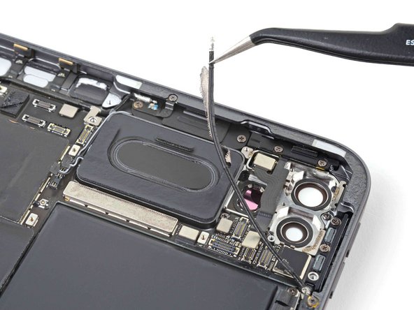

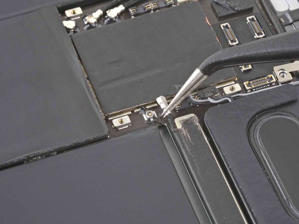

  59. iPad Pro 11" 2nd Gen Logic Board Replacement, Disconnect the top right Wi-Fi antenna cable: crwdns2935265:059crwdnd2935265:01crwdnd2935265:02crwdne2935265:0 iPad Pro 11" 2nd Gen Logic Board Replacement, Disconnect the top right Wi-Fi antenna cable: crwdns2935265:059crwdnd2935265:02crwdnd2935265:02crwdne2935265:0
    • To disconnect antenna cables like this, use tweezers to grip the connector near the cable and lift it up.
    • Use tweezers to disconnect the top right Wi-Fi antenna coaxial cable.
    • Be careful using tweezers or other pointy metal tools near the battery—a punctured battery may leak dangerous chemicals or cause a fire.
    • To reinstall, hold the connector in place and gently press straight down. The connector will “snap” into its socket much like the metal snaps on a jacket.

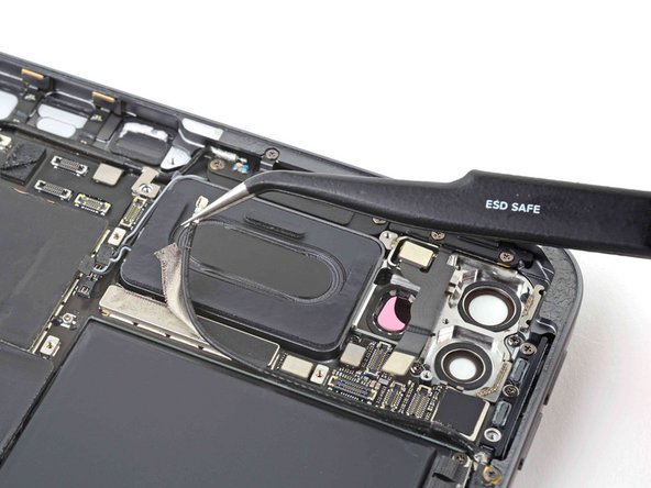

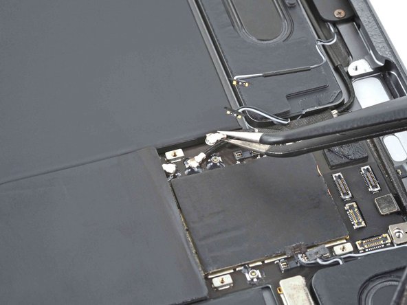

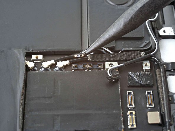

  60. iPad Pro 11" 2nd Gen Logic Board Replacement, Pull the Wi-Fi antenna cable away from the logic board: crwdns2935265:060crwdnd2935265:01crwdnd2935265:03crwdne2935265:0 iPad Pro 11" 2nd Gen Logic Board Replacement, Pull the Wi-Fi antenna cable away from the logic board: crwdns2935265:060crwdnd2935265:02crwdnd2935265:03crwdne2935265:0 iPad Pro 11" 2nd Gen Logic Board Replacement, Pull the Wi-Fi antenna cable away from the logic board: crwdns2935265:060crwdnd2935265:03crwdnd2935265:03crwdne2935265:0
    • Use tweezers or your fingers to pull the upper Wi-Fi antenna cable away from the logic board.
    • The tape securing the cable to the logic board should easily release. If it doesn't, use the tip of an opening pick to peel it off.

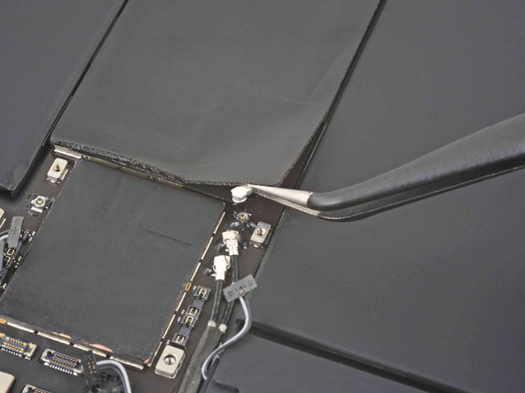

  61. iPad Pro 11" 2nd Gen Logic Board Replacement, Disconnect the upper Wi-Fi antenna cables: crwdns2935265:061crwdnd2935265:01crwdnd2935265:03crwdne2935265:0 iPad Pro 11" 2nd Gen Logic Board Replacement, Disconnect the upper Wi-Fi antenna cables: crwdns2935265:061crwdnd2935265:02crwdnd2935265:03crwdne2935265:0 iPad Pro 11" 2nd Gen Logic Board Replacement, Disconnect the upper Wi-Fi antenna cables: crwdns2935265:061crwdnd2935265:03crwdnd2935265:03crwdne2935265:0
    • Use tweezers to disconnect the upper Wi-Fi antenna coaxial cables.

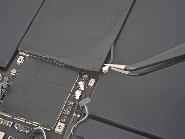

  64. iPad Pro 11" 2nd Gen Logic Board Replacement, Disconnect the bottom right Wi-Fi antenna cable: crwdns2935265:064crwdnd2935265:01crwdnd2935265:03crwdne2935265:0 iPad Pro 11" 2nd Gen Logic Board Replacement, Disconnect the bottom right Wi-Fi antenna cable: crwdns2935265:064crwdnd2935265:02crwdnd2935265:03crwdne2935265:0 iPad Pro 11" 2nd Gen Logic Board Replacement, Disconnect the bottom right Wi-Fi antenna cable: crwdns2935265:064crwdnd2935265:03crwdnd2935265:03crwdne2935265:0
    • Use tweezers to disconnect the bottom right Wi-Fi antenna coaxial cable.

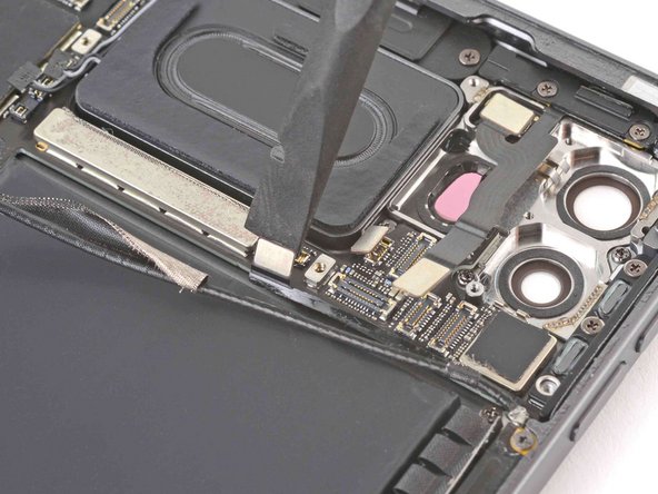

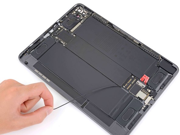

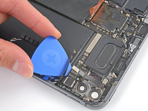

  65. iPad Pro 11" 2nd Gen Logic Board Replacement, Reposition the bottom right Wi-Fi antenna cable cable: crwdns2935265:065crwdnd2935265:01crwdnd2935265:03crwdne2935265:0 iPad Pro 11" 2nd Gen Logic Board Replacement, Reposition the bottom right Wi-Fi antenna cable cable: crwdns2935265:065crwdnd2935265:02crwdnd2935265:03crwdne2935265:0 iPad Pro 11" 2nd Gen Logic Board Replacement, Reposition the bottom right Wi-Fi antenna cable cable: crwdns2935265:065crwdnd2935265:03crwdnd2935265:03crwdne2935265:0
    • Pull the bottom right Wi-Fi cable away from the logic board.
  66. iPad Pro 11" 2nd Gen Logic Board Replacement: crwdns2935265:066crwdnd2935265:01crwdnd2935265:03crwdne2935265:0 iPad Pro 11" 2nd Gen Logic Board Replacement: crwdns2935265:066crwdnd2935265:02crwdnd2935265:03crwdne2935265:0 iPad Pro 11" 2nd Gen Logic Board Replacement: crwdns2935265:066crwdnd2935265:03crwdnd2935265:03crwdne2935265:0
    • Continue pulling the cable away until it is clear of the logic board.

  71. iPad Pro 11" 2nd Gen Logic Board Replacement, Disconnect the Smart Connector cable: crwdns2935265:071crwdnd2935265:01crwdnd2935265:02crwdne2935265:0 iPad Pro 11" 2nd Gen Logic Board Replacement, Disconnect the Smart Connector cable: crwdns2935265:071crwdnd2935265:02crwdnd2935265:02crwdne2935265:0
    • Use the pointed end of a spudger to disconnect the Smart Connector cable.

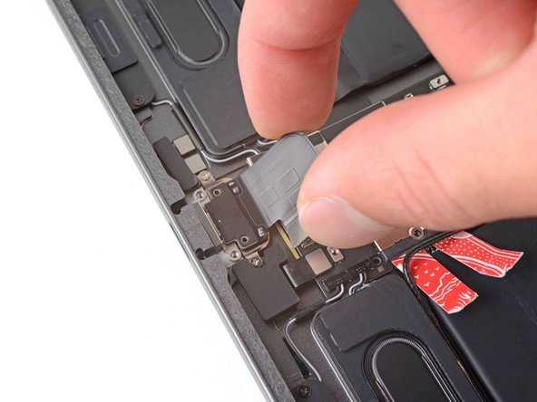

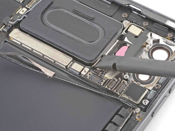

  72. iPad Pro 11" 2nd Gen Logic Board Replacement, Peel back the logic board shielding: crwdns2935265:072crwdnd2935265:01crwdnd2935265:03crwdne2935265:0 iPad Pro 11" 2nd Gen Logic Board Replacement, Peel back the logic board shielding: crwdns2935265:072crwdnd2935265:02crwdnd2935265:03crwdne2935265:0 iPad Pro 11" 2nd Gen Logic Board Replacement, Peel back the logic board shielding: crwdns2935265:072crwdnd2935265:03crwdnd2935265:03crwdne2935265:0
    • Use tweezers or your fingers to peel back the logic board shielding to reveal the left microphone and Apple Pencil charger cables.
  73. iPad Pro 11" 2nd Gen Logic Board Replacement, Remove the left microphone and Apple Pencil charger cable bracket: crwdns2935265:073crwdnd2935265:01crwdnd2935265:02crwdne2935265:0 iPad Pro 11" 2nd Gen Logic Board Replacement, Remove the left microphone and Apple Pencil charger cable bracket: crwdns2935265:073crwdnd2935265:02crwdnd2935265:02crwdne2935265:0
    • Use tweezers to grip the bracket and then pull to remove it.
  74. iPad Pro 11" 2nd Gen Logic Board Replacement, Disconnect the left microphone and Apple Pencil charger cables: crwdns2935265:074crwdnd2935265:01crwdnd2935265:03crwdne2935265:0 iPad Pro 11" 2nd Gen Logic Board Replacement, Disconnect the left microphone and Apple Pencil charger cables: crwdns2935265:074crwdnd2935265:02crwdnd2935265:03crwdne2935265:0 iPad Pro 11" 2nd Gen Logic Board Replacement, Disconnect the left microphone and Apple Pencil charger cables: crwdns2935265:074crwdnd2935265:03crwdnd2935265:03crwdne2935265:0
    • Use the flat end of a spudger to disconnect the left microphone and Apple Pencil charger cables.

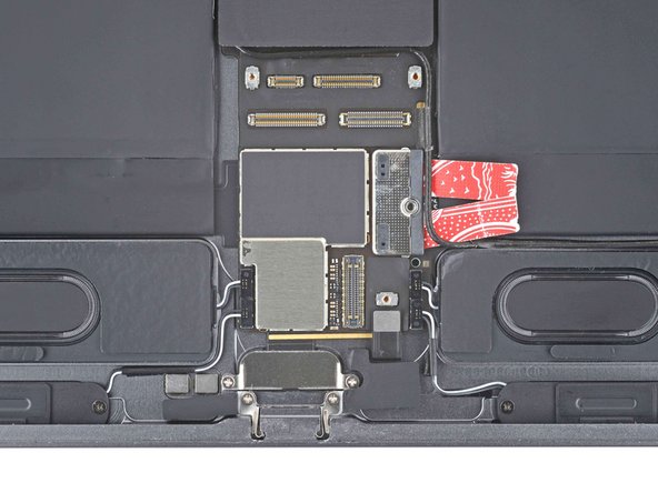

  75. iPad Pro 11" 2nd Gen Logic Board Replacement, Peel off the logic board shielding: crwdns2935265:075crwdnd2935265:01crwdnd2935265:03crwdne2935265:0 iPad Pro 11" 2nd Gen Logic Board Replacement, Peel off the logic board shielding: crwdns2935265:075crwdnd2935265:02crwdnd2935265:03crwdne2935265:0 iPad Pro 11" 2nd Gen Logic Board Replacement, Peel off the logic board shielding: crwdns2935265:075crwdnd2935265:03crwdnd2935265:03crwdne2935265:0
    Tesa 61395 Tape
    $5.99
    • Use tweezers or your fingers to peel off the logic board shielding.
    • You'll need to reapply thermal paste to the processor so your iPad doesn't overheat. Follow this guide to properly apply thermal paste to your iPad.
    • During reassembly, use Tesa Tape to secure the shield to the logic board.

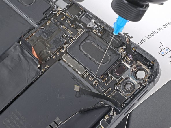

  77. iPad Pro 11" 2nd Gen Logic Board Replacement, Apply isopropyl alcohol to the left edge of the logic board: crwdns2935265:077crwdnd2935265:01crwdnd2935265:03crwdne2935265:0 iPad Pro 11" 2nd Gen Logic Board Replacement, Apply isopropyl alcohol to the left edge of the logic board: crwdns2935265:077crwdnd2935265:02crwdnd2935265:03crwdne2935265:0 iPad Pro 11" 2nd Gen Logic Board Replacement, Apply isopropyl alcohol to the left edge of the logic board: crwdns2935265:077crwdnd2935265:03crwdnd2935265:03crwdne2935265:0
    • The adhesive that secures the logic board to the frame is very strong. To remove the board, follow the next steps to weaken the adhesive using high-strength (>90%) isopropyl alcohol.
    • Prop the left side of the iPad up against an object so the isopropyl alcohol can flow under the logic board.
    • Apply a few drops of isopropyl alcohol along the left edge of the logic board.
    • Be careful if you're using a syringe with a needle or other sharp instrument to dispense isopropyl alcohol—a punctured or bent battery may leak dangerous chemicals or cause a fire.
    • Let the alcohol soak for one minute to soften the adhesive under the logic board.

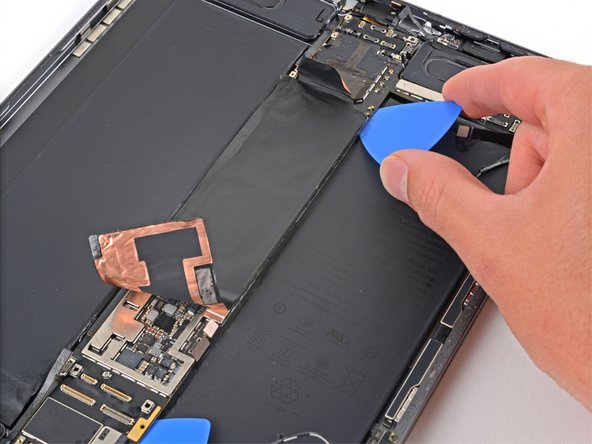

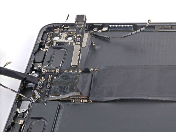

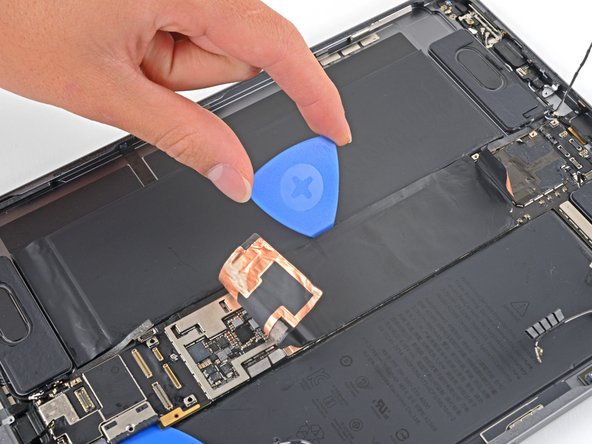

  80. iPad Pro 11" 2nd Gen Logic Board Replacement, Pry up the logic board: crwdns2935265:080crwdnd2935265:01crwdnd2935265:03crwdne2935265:0 iPad Pro 11" 2nd Gen Logic Board Replacement, Pry up the logic board: crwdns2935265:080crwdnd2935265:02crwdnd2935265:03crwdne2935265:0 iPad Pro 11" 2nd Gen Logic Board Replacement, Pry up the logic board: crwdns2935265:080crwdnd2935265:03crwdnd2935265:03crwdne2935265:0
    • Insert the flat end of a spudger under the lower edge of the logic board
    • Slowly lift up the bottom of the logic board.
    • Don't pry against the bottom interconnect board or you may damage it. Use a spudger to lift the logic board up.
    • If it is difficult to lift the logic board, apply additional isopropyl alcohol and wait one minute.
    • Replace the playing card strips with an opening pick to continue blocking the battery.

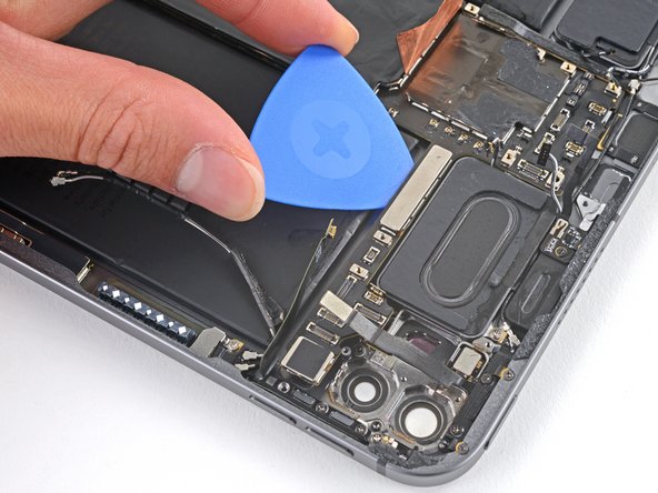

  82. iPad Pro 11" 2nd Gen Logic Board Replacement, Pry up the top right branch: crwdns2935265:082crwdnd2935265:01crwdnd2935265:03crwdne2935265:0 iPad Pro 11" 2nd Gen Logic Board Replacement, Pry up the top right branch: crwdns2935265:082crwdnd2935265:02crwdnd2935265:03crwdne2935265:0 iPad Pro 11" 2nd Gen Logic Board Replacement, Pry up the top right branch: crwdns2935265:082crwdnd2935265:03crwdnd2935265:03crwdne2935265:0
    • Use an opening pick to pry up the top right branch of the logic board near the rear camera lenses.
    • If it is difficult to lift the top right branch, apply additional isopropyl alcohol and wait one minute.
  83. iPad Pro 11" 2nd Gen Logic Board Replacement, Pry up the right edge: crwdns2935265:083crwdnd2935265:01crwdnd2935265:02crwdne2935265:0 iPad Pro 11" 2nd Gen Logic Board Replacement, Pry up the right edge: crwdns2935265:083crwdnd2935265:02crwdnd2935265:02crwdne2935265:0
    • Insert an opening pick under the right edge of the logic board above the left microphone and Apple Pencil charger cables.
    • Slide the opening pick under the right edge of the logic board to loosen it.
    • Pry against the frame underneath the logic board to separate the adhesive.
    • Don't forcefully lever against the battery—a punctured or bent battery may leak dangerous chemicals or cause a fire.
    • If the adhesive is still too strong to lift up the logic board, apply some additional isopropyl alcohol and wait one minute.

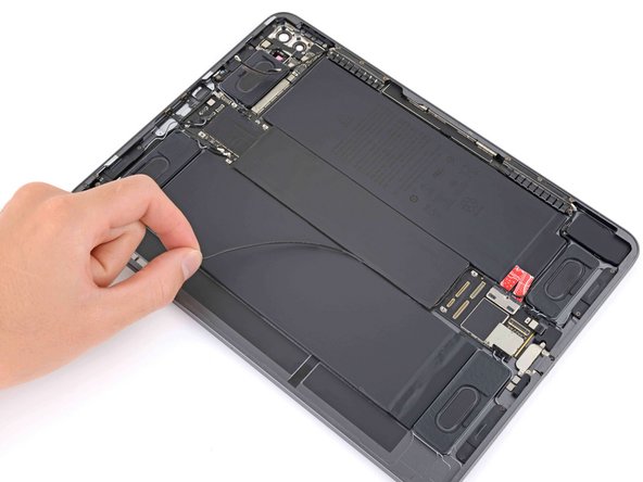

  84. iPad Pro 11" 2nd Gen Logic Board Replacement, Remove the logic board: crwdns2935265:084crwdnd2935265:01crwdnd2935265:03crwdne2935265:0 iPad Pro 11" 2nd Gen Logic Board Replacement, Remove the logic board: crwdns2935265:084crwdnd2935265:02crwdnd2935265:03crwdne2935265:0 iPad Pro 11" 2nd Gen Logic Board Replacement, Remove the logic board: crwdns2935265:084crwdnd2935265:03crwdnd2935265:03crwdne2935265:0
    Tesa 61395 Tape
    $5.99
    • Use the flat end of a spudger to lift the top edge of the logic board.
    • Grip the top and bottom edges of the logic board.
    • Remove the logic board.
    • Remove the old adhesive from the rear case and bottom of the logic board using tweezers and high concentration isopropyl alcohol with a lint-free cloth where needed.
    • During reassembly, apply strips of Tesa tape to the bottom of the logic board.
