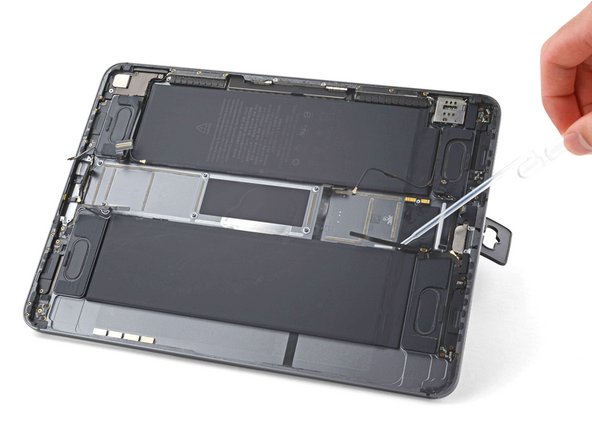

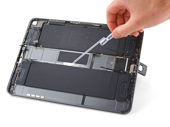

  30. iPad Pro 11" 2nd Gen Battery Replacement, Unfasten the battery connector: crwdns2935265:030crwdnd2935265:01crwdnd2935265:02crwdne2935265:0 iPad Pro 11" 2nd Gen Battery Replacement, Unfasten the battery connector: crwdns2935265:030crwdnd2935265:02crwdnd2935265:02crwdne2935265:0
    • Use a Phillips screwdriver to remove the 1.8 mm screw securing the battery connector to the logic board.
  31. iPad Pro 11" 2nd Gen Battery Replacement, Disconnect the display cables: crwdns2935265:031crwdnd2935265:01crwdnd2935265:03crwdne2935265:0 iPad Pro 11" 2nd Gen Battery Replacement, Disconnect the display cables: crwdns2935265:031crwdnd2935265:02crwdnd2935265:03crwdne2935265:0 iPad Pro 11" 2nd Gen Battery Replacement, Disconnect the display cables: crwdns2935265:031crwdnd2935265:03crwdnd2935265:03crwdne2935265:0
    • Use the pointed end of a spudger to pry up and disconnect the top two display cables.
  32. iPad Pro 11" 2nd Gen Battery Replacement, Disconnect the remaining display cables: crwdns2935265:032crwdnd2935265:01crwdnd2935265:03crwdne2935265:0 iPad Pro 11" 2nd Gen Battery Replacement, Disconnect the remaining display cables: crwdns2935265:032crwdnd2935265:02crwdnd2935265:03crwdne2935265:0 iPad Pro 11" 2nd Gen Battery Replacement, Disconnect the remaining display cables: crwdns2935265:032crwdnd2935265:03crwdnd2935265:03crwdne2935265:0
    • Disconnect the two remaining display cables.
  33. iPad Pro 11" 2nd Gen Battery Replacement, Remove the screen: crwdns2935265:033crwdnd2935265:01crwdnd2935265:01crwdne2935265:0
    • Grip the right edge of the screen and lift it away.
    • During reassembly, before installing a screen, remove any remaining adhesive from the frame, and clean the glued areas with high-strength (>90%) isopropyl alcohol and a lint-free cloth. This helps prep the iPad for fresh adhesive and ensures that it will bond properly.
    • If you plan to reinstall your existing screen, remove any remaining adhesive from the back and clean the adhered areas with isopropyl alcohol.
    • Follow this guide to install pre-cut adhesive strips on your iPad before sealing it up.

  87. iPad Pro 11" 2nd Gen Battery Replacement, Apply isopropyl alcohol: crwdns2935265:087crwdnd2935265:01crwdnd2935265:03crwdne2935265:0 iPad Pro 11" 2nd Gen Battery Replacement, Apply isopropyl alcohol: crwdns2935265:087crwdnd2935265:02crwdnd2935265:03crwdne2935265:0 iPad Pro 11" 2nd Gen Battery Replacement, Apply isopropyl alcohol: crwdns2935265:087crwdnd2935265:03crwdnd2935265:03crwdne2935265:0
    • If you removed all of the stretch-release adhesive, good job! You can skip the next four steps. If not, then follow the next four steps to apply isopropyl alcohol.
    • Prop the left side of the iPad up against an object so the isopropyl alcohol can flow under the right battery cell.
    • Apply high-strength (>90%) isopropyl alcohol along the inside edge of the right battery cell.
    • Be careful if you're using a syringe with a needle or other sharp instrument to dispense isopropyl alcohol—a punctured or bent battery may leak dangerous chemicals or cause a fire.
    • Let the alcohol soak for two minutes to soften the adhesive under the battery cell.
  88. iPad Pro 11" 2nd Gen Battery Replacement: crwdns2935265:088crwdnd2935265:01crwdnd2935265:03crwdne2935265:0 iPad Pro 11" 2nd Gen Battery Replacement: crwdns2935265:088crwdnd2935265:02crwdnd2935265:03crwdne2935265:0 iPad Pro 11" 2nd Gen Battery Replacement: crwdns2935265:088crwdnd2935265:03crwdnd2935265:03crwdne2935265:0
    • Rotate the iPad 180 degrees so the inner edge of the left battery is facing up.
    • Repeat the previous step on the left battery cell.
