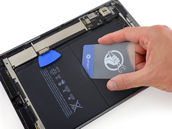

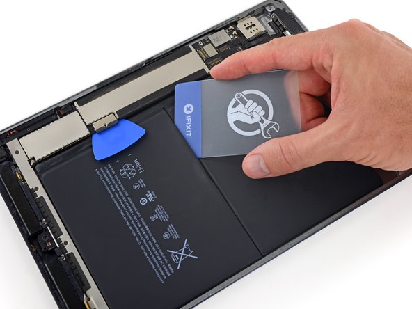

    • In the following steps, you'll use plastic cards to separate the battery, which is glued to the rear case.
    • Some minor warping or deformation of the battery is unavoidable, but be very careful not to puncture or delaminate it. Lithium-ion batteries contain dangerous chemicals and may catch fire if mishandled.
    • Starting from the middle of the iPad, insert one corner of a plastic card beneath the upper battery cell.

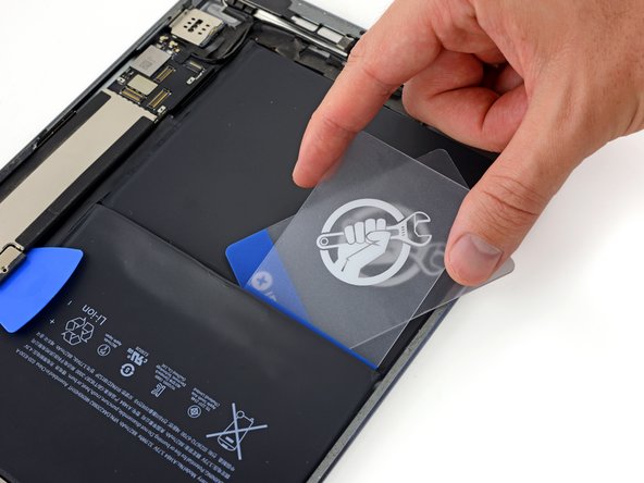

    • Slide the short edge of a second plastic card underneath the upper battery cell, on top of the first plastic card.

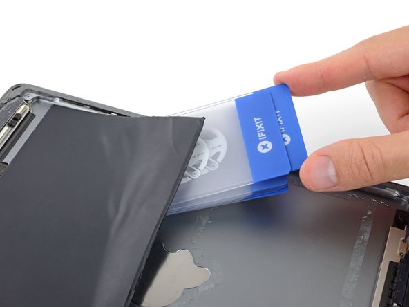

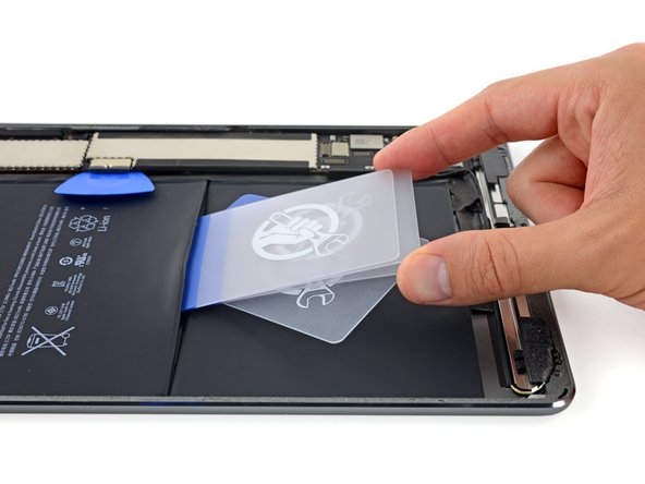

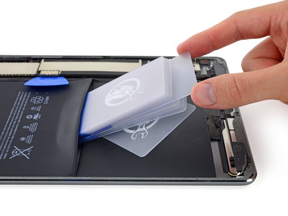

  50. iPad Air LTE Battery Replacement: crwdns2935265:050crwdnd2935265:01crwdnd2935265:03crwdne2935265:0 iPad Air LTE Battery Replacement: crwdns2935265:050crwdnd2935265:02crwdnd2935265:03crwdne2935265:0 iPad Air LTE Battery Replacement: crwdns2935265:050crwdnd2935265:03crwdnd2935265:03crwdne2935265:0

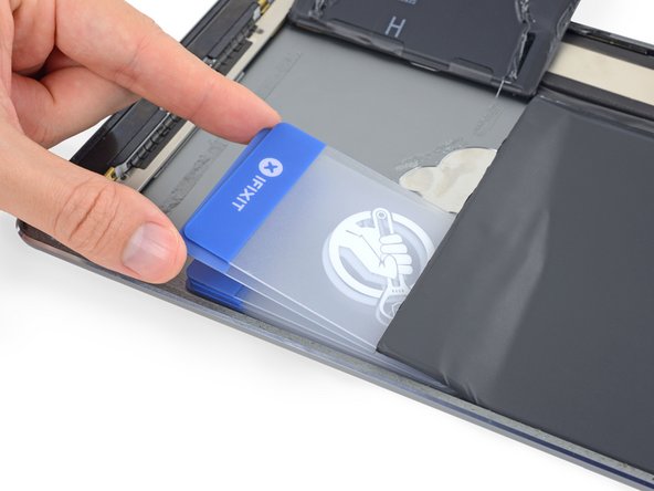

    • Insert multiple additional cards between the first and second card to create a wedge that will begin to lever the battery away from the rear case.
    • Don't insert your cards beneath or on top of the two starter cards, as the added pressure will increase the risk of puncturing the battery.
    • You can use additional plastic cards, old/expired credit cards, or even playing cards for this step.

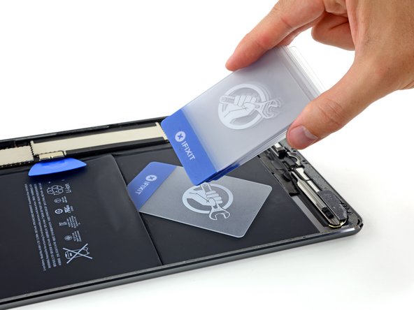

  51. iPad Air LTE Battery Replacement: crwdns2935265:051crwdnd2935265:01crwdnd2935265:02crwdne2935265:0 iPad Air LTE Battery Replacement: crwdns2935265:051crwdnd2935265:02crwdnd2935265:02crwdne2935265:0
    • Remove the cards.

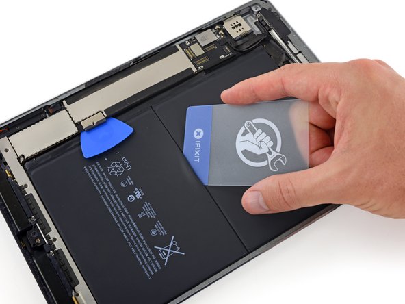

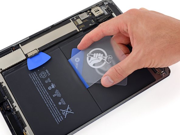

  52. iPad Air LTE Battery Replacement: crwdns2935265:052crwdnd2935265:01crwdnd2935265:02crwdne2935265:0 iPad Air LTE Battery Replacement: crwdns2935265:052crwdnd2935265:02crwdnd2935265:02crwdne2935265:0
    • Re-insert a corner of your plastic card under the upper battery cell, near the left edge of the iPad.

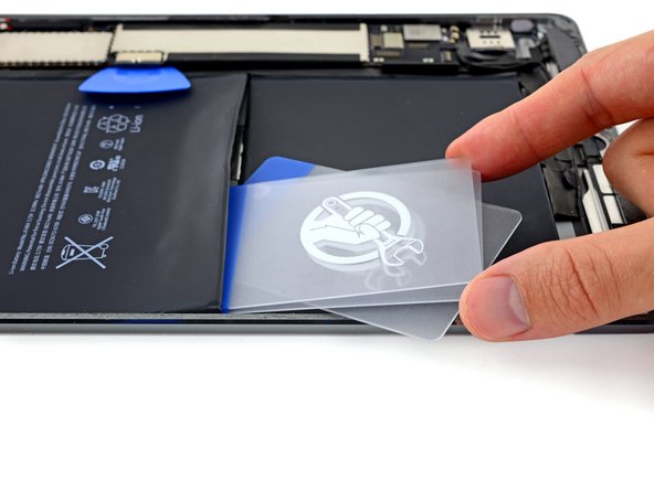

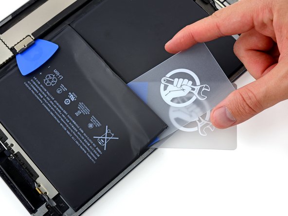

  53. iPad Air LTE Battery Replacement: crwdns2935265:053crwdnd2935265:01crwdnd2935265:02crwdne2935265:0 iPad Air LTE Battery Replacement: crwdns2935265:053crwdnd2935265:02crwdnd2935265:02crwdne2935265:0
    • Slide the short edge of a second plastic card underneath the battery cell and above the first plastic card.

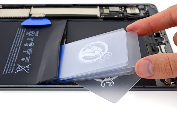

  54. iPad Air LTE Battery Replacement: crwdns2935265:054crwdnd2935265:01crwdnd2935265:03crwdne2935265:0 iPad Air LTE Battery Replacement: crwdns2935265:054crwdnd2935265:02crwdnd2935265:03crwdne2935265:0 iPad Air LTE Battery Replacement: crwdns2935265:054crwdnd2935265:03crwdnd2935265:03crwdne2935265:0

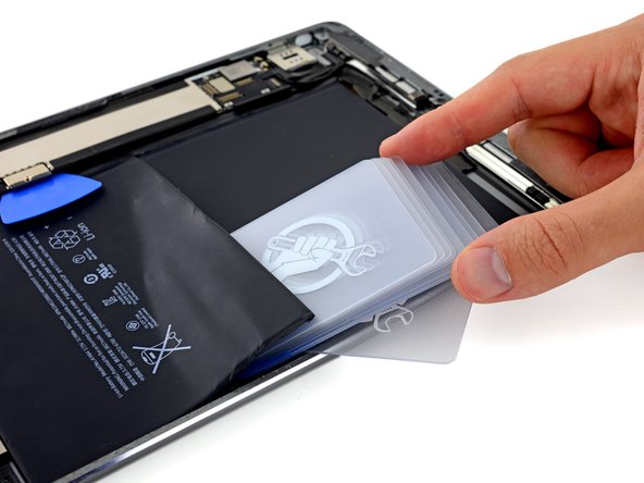

    • Insert multiple additional cards between the first and second card to create a wedge and lever this section of the battery away from the rear case.

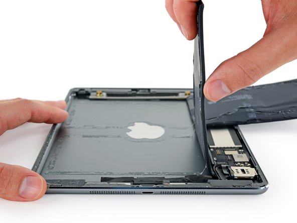

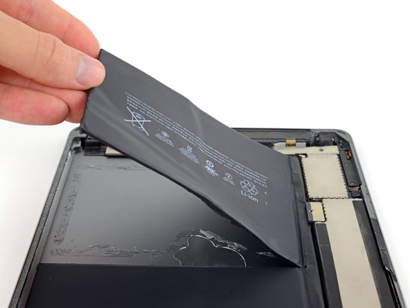

  59. iPad Air LTE Battery Replacement: crwdns2935265:059crwdnd2935265:01crwdnd2935265:03crwdne2935265:0 iPad Air LTE Battery Replacement: crwdns2935265:059crwdnd2935265:02crwdnd2935265:03crwdne2935265:0 iPad Air LTE Battery Replacement: crwdns2935265:059crwdnd2935265:03crwdnd2935265:03crwdne2935265:0
    • Gently lift the upper battery cell from the edge opposite the logic board, and swing it up to separate it from the rear case.

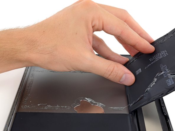

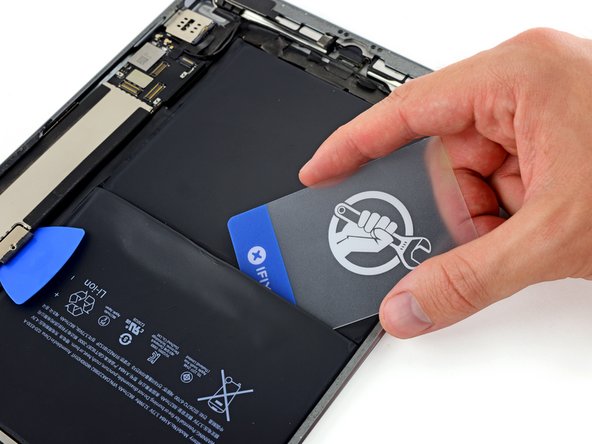

  60. iPad Air LTE Battery Replacement: crwdns2935265:060crwdnd2935265:01crwdnd2935265:03crwdne2935265:0 iPad Air LTE Battery Replacement: crwdns2935265:060crwdnd2935265:02crwdnd2935265:03crwdne2935265:0 iPad Air LTE Battery Replacement: crwdns2935265:060crwdnd2935265:03crwdnd2935265:03crwdne2935265:0
    • Repeat the above procedure to separate the second, lower battery cell from the rear case.
    • Insert your cards only from the top edge of the battery cell and from the side opposite the logic board. Don't use any cards to pry under the battery from the bottom edge of the iPad, or you may damage ribbon cables for the speakers, antennas, and Lightning connector.

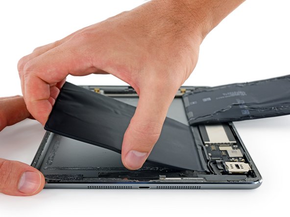

  61. iPad Air LTE Battery Replacement: crwdns2935265:061crwdnd2935265:01crwdnd2935265:03crwdne2935265:0 iPad Air LTE Battery Replacement: crwdns2935265:061crwdnd2935265:02crwdnd2935265:03crwdne2935265:0 iPad Air LTE Battery Replacement: crwdns2935265:061crwdnd2935265:03crwdnd2935265:03crwdne2935265:0
    • Gently lift the lower battery cell from the edge opposite the logic board, and swing it up to separate it from the rear case.
    • Don't try to fully remove the battery yet.

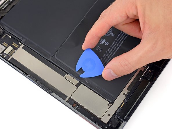

    • Use an opening pick to slice through the adhesive directly underneath the battery connector terminal.
    • There's a small standoff in the case that helps seat this connector. The pick may be obstructed by this. Simply work the pick around each side of the standoff to slice through the adhesive.

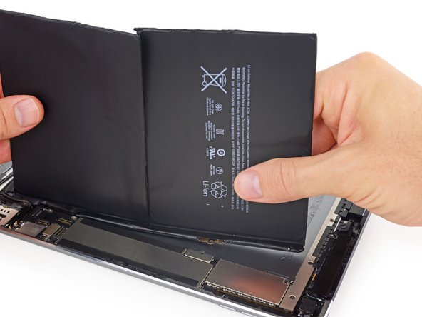

  63. iPad Air LTE Battery Replacement: crwdns2935265:063crwdnd2935265:01crwdnd2935265:03crwdne2935265:0 iPad Air LTE Battery Replacement: crwdns2935265:063crwdnd2935265:02crwdnd2935265:03crwdne2935265:0 iPad Air LTE Battery Replacement: crwdns2935265:063crwdnd2935265:03crwdnd2935265:03crwdne2935265:0

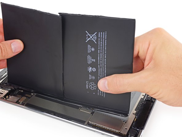

    • Stand both battery cells up perpendicular to the iPad.
    • Clear the standoff by gently rocking the upper cell slightly away from the rear case, and then pulling it to the side (away from the logic board).
    • You don't need to lift very far (2 or 3 mm). Work carefully and don't put any unnecessary pressure on the logic board. Do not attempt to simply pull the battery straight up, or you may damage the logic board.
  64. iPad Air LTE Battery Replacement: crwdns2935265:064crwdnd2935265:01crwdnd2935265:01crwdne2935265:0
    • Remove the battery.
