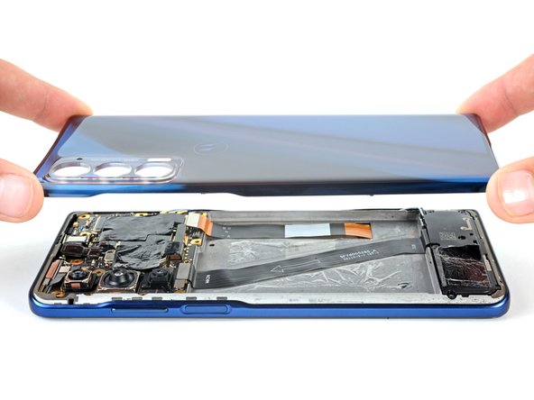

  15. Motorola Edge 5G UW (2022) Display Replacement, Remove the back cover: crwdns2935265:015crwdnd2935265:01crwdnd2935265:02crwdne2935265:0 Motorola Edge 5G UW (2022) Display Replacement, Remove the back cover: crwdns2935265:015crwdnd2935265:02crwdnd2935265:02crwdne2935265:0
    • Lift the back cover from the phone and remove it.
    • If the back cover is still stuck to the midframe, slide an opening pick around the edges of the phone until the cover separates completely.
    • During reassembly:
    • This is a good point to test your phone's functionality before sealing it up. Use this guide to run a hardware test. Be sure to power your phone back down completely before you continue working.
    • Follow this guide to replace the back cover adhesive.

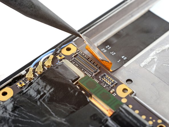

  19. Motorola Edge 5G UW (2022) Display Replacement, Disconnect the battery: crwdns2935265:019crwdnd2935265:01crwdnd2935265:02crwdne2935265:0 Motorola Edge 5G UW (2022) Display Replacement, Disconnect the battery: crwdns2935265:019crwdnd2935265:02crwdnd2935265:02crwdne2935265:0
    • Use the pointed end of a spudger to pry up and disconnect the battery's press connector.
    • To re-attach press connectors like this one, carefully align and press down on one side until it clicks into place, then repeat on the other side. Don't press down on the middle. If the connector is misaligned, the pins can bend, causing permanent damage.

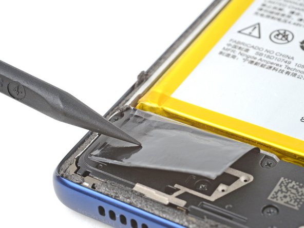

  20. Motorola Edge 5G UW (2022) Display Replacement, Detach the daughterboard heat spreader: crwdns2935265:020crwdnd2935265:01crwdnd2935265:02crwdne2935265:0 Motorola Edge 5G UW (2022) Display Replacement, Detach the daughterboard heat spreader: crwdns2935265:020crwdnd2935265:02crwdnd2935265:02crwdne2935265:0
    • Insert the pointed end of a spudger under the heat spreader between the battery and daughterboard.
    • Gently left up and towards the bottom of the phone to detach the heat spreader.

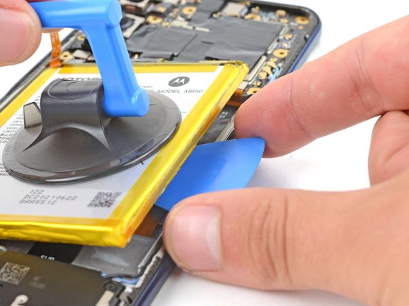

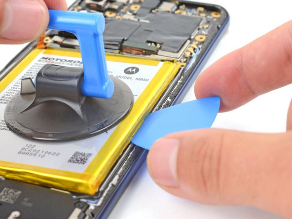

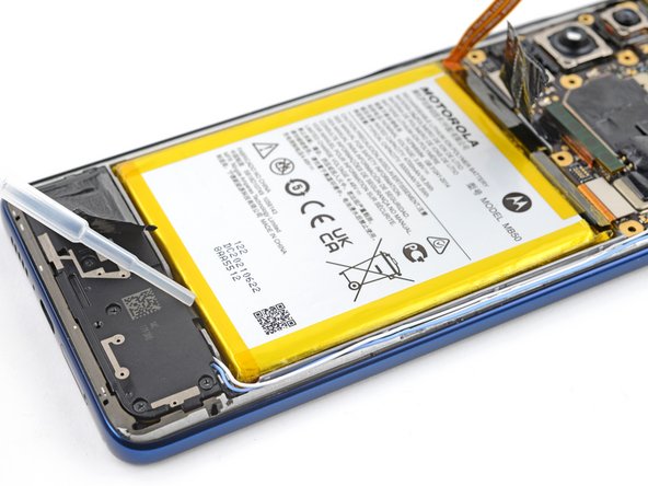

  21. Motorola Edge 5G UW (2022) Display Replacement, Apply isopropyl alcohol: crwdns2935265:021crwdnd2935265:01crwdnd2935265:02crwdne2935265:0 Motorola Edge 5G UW (2022) Display Replacement, Apply isopropyl alcohol: crwdns2935265:021crwdnd2935265:02crwdnd2935265:02crwdne2935265:0
    • Apply a few drops of high-concentration (90% or higher) isopropyl alcohol to the gaps along the battery's edges.
    • Tilt the device as you apply alcohol to help it flow under the battery.
    • Wait one minute to allow the isopropyl alcohol to penetrate the adhesive.
    • Only apply a few drops initially and apply more as necessary. If you apply too much alcohol, it may overflow onto the motherboard and daughterboard.
  22. Motorola Edge 5G UW (2022) Display Replacement, Separate the battery's adhesive: crwdns2935265:022crwdnd2935265:01crwdnd2935265:03crwdne2935265:0 Motorola Edge 5G UW (2022) Display Replacement, Separate the battery's adhesive: crwdns2935265:022crwdnd2935265:02crwdnd2935265:03crwdne2935265:0 Motorola Edge 5G UW (2022) Display Replacement, Separate the battery's adhesive: crwdns2935265:022crwdnd2935265:03crwdnd2935265:03crwdne2935265:0
    • Take care not to puncture or bend the battery during the removal process—a punctured or bent battery may leak dangerous chemicals or cause a fire.
    • Apply a suction cup to middle of the battery.
    • Pull up on the suction cup with strong, steady force to separate the battery from the frame.
    • If the battery doesn't budge, apply a few more drops of isopropyl alcohol, wait one minute, and try again.
    • Insert an opening pick into the gap between the battery and the frame.
    • Continue to pull up on the suction cup with a strong, steady force while sliding the opening pick back and forth to slice the adhesive.
    • Continue this process until the battery separates from the frame, applying a few drops of alcohol as necessary.

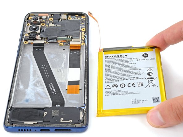

  23. Motorola Edge 5G UW (2022) Display Replacement, Remove the battery: crwdns2935265:023crwdnd2935265:01crwdnd2935265:02crwdne2935265:0 Motorola Edge 5G UW (2022) Display Replacement, Remove the battery: crwdns2935265:023crwdnd2935265:02crwdnd2935265:02crwdne2935265:0
    • Remove the battery from the midframe.
    • Do not reinstall a damaged or deformed battery, as doing so is a potential safety hazard.

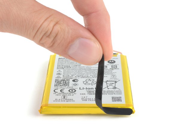

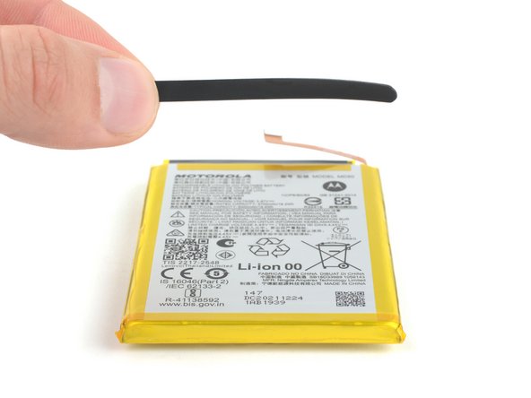

  24. Motorola Edge 5G UW (2022) Display Replacement, Transfer the battery's foam strip: crwdns2935265:024crwdnd2935265:01crwdnd2935265:03crwdne2935265:0 Motorola Edge 5G UW (2022) Display Replacement, Transfer the battery's foam strip: crwdns2935265:024crwdnd2935265:02crwdnd2935265:03crwdne2935265:0 Motorola Edge 5G UW (2022) Display Replacement, Transfer the battery's foam strip: crwdns2935265:024crwdnd2935265:03crwdnd2935265:03crwdne2935265:0
    • Use tweezers or your fingers to remove the foam strip from the battery's bottom edge.
    • Before installing your new battery, apply the foam strip to its bottom edge.

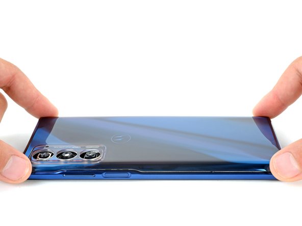

  25. Motorola Edge 5G UW (2022) Display Replacement, Place the back cover back on: crwdns2935265:025crwdnd2935265:01crwdnd2935265:02crwdne2935265:0 Motorola Edge 5G UW (2022) Display Replacement, Place the back cover back on: crwdns2935265:025crwdnd2935265:02crwdnd2935265:02crwdne2935265:0
    • Before continuing your repair, place the back cover back on the frame to protect the cameras and motherboard.

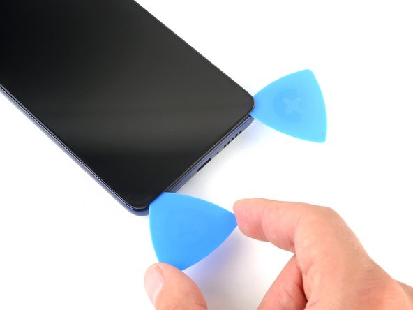

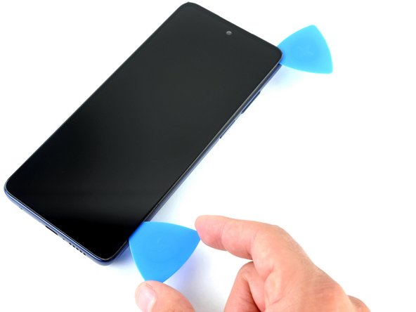

  26. Motorola Edge 5G UW (2022) Display Replacement, Loosen the display adhesive: crwdns2935265:026crwdnd2935265:01crwdnd2935265:01crwdne2935265:0
    • Flip your phone over to access the display.
    • Apply a heated iOpener to the display for at least five minutes to loosen the adhesive underneath.

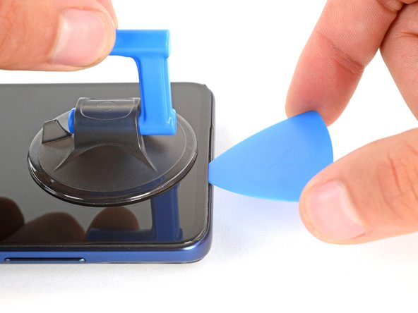

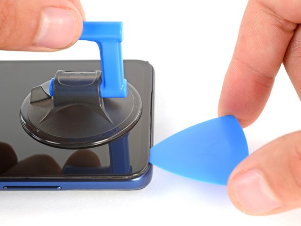

  27. Motorola Edge 5G UW (2022) Display Replacement, Insert an opening pick: crwdns2935265:027crwdnd2935265:01crwdnd2935265:03crwdne2935265:0 Motorola Edge 5G UW (2022) Display Replacement, Insert an opening pick: crwdns2935265:027crwdnd2935265:02crwdnd2935265:03crwdne2935265:0 Motorola Edge 5G UW (2022) Display Replacement, Insert an opening pick: crwdns2935265:027crwdnd2935265:03crwdnd2935265:03crwdne2935265:0
    • Once the display is hot to the touch, apply a suction handle to the top of the display, as close to the edge as possible.
    • If your display is badly cracked, covering it with a layer of clear packing tape may allow the suction cup to adhere. Alternatively, very strong tape may be used instead of the suction handle. If all else fails, you can superglue the suction cup to the display.
    • Insert an opening pick in the small gap between the display and the frame, near the front camera.
    • Pull up on the suction handle with a strong, steady force while pushing in and down on the pick until the pick slides under the display.
    • The display adhesive is very strong, so this may take multiple attempts. If you're having trouble, reheat the display and try again.
    • Slide the pick to the top right corner of the display and leave it inserted to prevent the adhesive from resealing.

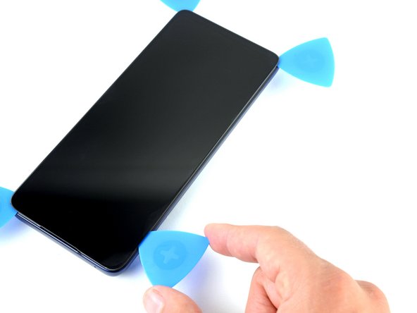

  28. Motorola Edge 5G UW (2022) Display Replacement, Slice the right adhesive: crwdns2935265:028crwdnd2935265:01crwdnd2935265:02crwdne2935265:0 Motorola Edge 5G UW (2022) Display Replacement, Slice the right adhesive: crwdns2935265:028crwdnd2935265:02crwdnd2935265:02crwdne2935265:0
    • When sliding the pick near the bottom third of the phone, don't insert the pick more than 6 mm to avoid damaging the heat spreader.
    • Insert a second opening pick near the top right corner and slide it along the right edge to slice the adhesive.
    • Leave the pick inserted in the bottom right corner to prevent the adhesive from resealing.
  29. Motorola Edge 5G UW (2022) Display Replacement: crwdns2935265:029crwdnd2935265:01crwdnd2935265:02crwdne2935265:0 Motorola Edge 5G UW (2022) Display Replacement: crwdns2935265:029crwdnd2935265:02crwdnd2935265:02crwdne2935265:0
    • Don't insert the pick more than 3 mm to avoid damaging the heat spreader.
    • Insert a third opening pick near the bottom right corner and slide it along the bottom edge to slice the adhesive.
    • Leave the pick inserted in the bottom left corner to prevent the adhesive from resealing.
  30. Motorola Edge 5G UW (2022) Display Replacement: crwdns2935265:030crwdnd2935265:01crwdnd2935265:02crwdne2935265:0 Motorola Edge 5G UW (2022) Display Replacement: crwdns2935265:030crwdnd2935265:02crwdnd2935265:02crwdne2935265:0
    • Don't insert the pick more than 2 mm to avoid damaging the heat spreader.
    • Insert a forth pick near the bottom left corner and slide it along the left edge to slice the adhesive.
    • The screen should be detached at this point.

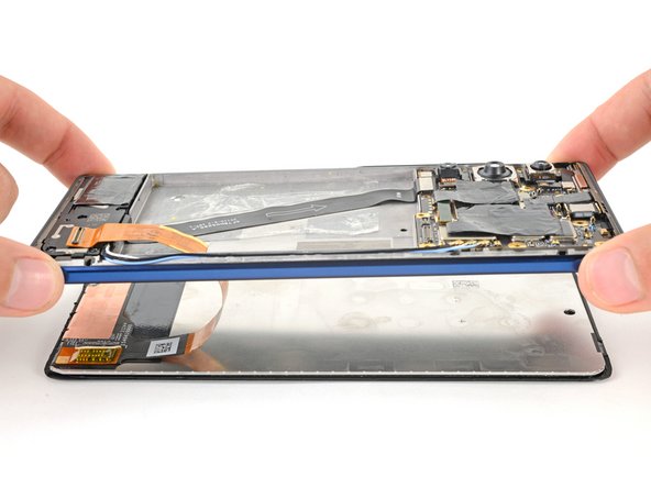

  31. Motorola Edge 5G UW (2022) Display Replacement: crwdns2935265:031crwdnd2935265:01crwdnd2935265:02crwdne2935265:0 Motorola Edge 5G UW (2022) Display Replacement: crwdns2935265:031crwdnd2935265:02crwdnd2935265:02crwdne2935265:0
    • Flip your phone over to access the back cover.
    • Remove the opening picks and back cover from the phone.

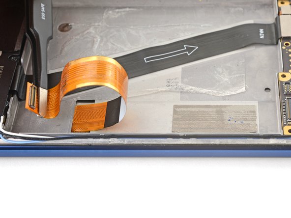

  32. Motorola Edge 5G UW (2022) Display Replacement: crwdns2935265:032crwdnd2935265:01crwdnd2935265:02crwdne2935265:0 Motorola Edge 5G UW (2022) Display Replacement: crwdns2935265:032crwdnd2935265:02crwdnd2935265:02crwdne2935265:0
    • Use the pointed end of a spudger to pry up and disconnect the display cable's press connector.
  33. Motorola Edge 5G UW (2022) Display Replacement: crwdns2935265:033crwdnd2935265:01crwdnd2935265:02crwdne2935265:0 Motorola Edge 5G UW (2022) Display Replacement: crwdns2935265:033crwdnd2935265:02crwdnd2935265:02crwdne2935265:0
    • Use tweezers to grip the display cable just below the press connector.
    • Gently pull the display cable towards the bottom of the phone to separate its adhesive.
  34. Motorola Edge 5G UW (2022) Display Replacement, Remove the display: crwdns2935265:034crwdnd2935265:01crwdnd2935265:03crwdne2935265:0 Motorola Edge 5G UW (2022) Display Replacement, Remove the display: crwdns2935265:034crwdnd2935265:02crwdnd2935265:03crwdne2935265:0 Motorola Edge 5G UW (2022) Display Replacement, Remove the display: crwdns2935265:034crwdnd2935265:03crwdnd2935265:03crwdne2935265:0
    • The display may have lightly readhered to the frame during the last few steps. If it has, use an opening pick to detach the display from the frame before continuing.
    • Before removing the display, make sure that the display's ribbon cable is completely detached from the adhesive on the midframe.
    • Gently pull up on the display and thread the ribbon cable through the hole in midframe to remove the display.
