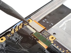

Use the pointed end of a spudger to pry up and disconnect the display cable's press connector.
