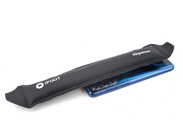

  2. Motorola Edge 5G UW (2022) Screen Replacement, Heat the left edge: crwdns2935265:02crwdnd2935265:01crwdnd2935265:01crwdne2935265:0
    • Completely power off your phone before you begin.
    • Heat an iOpener and apply it to the back cover's left edge for two minutes.
    • A hair dryer, heat gun, or hot plate may also be used, but be careful not to overheat the phone—the back cover and internal battery are both susceptible to heat damage.

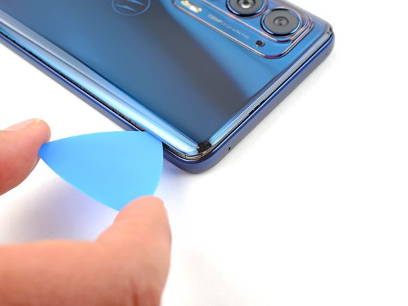

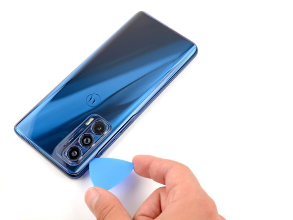

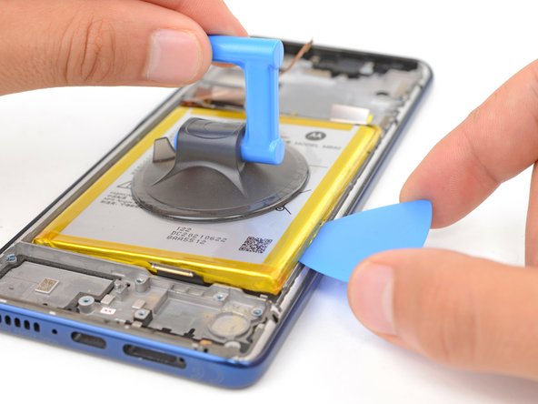

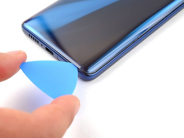

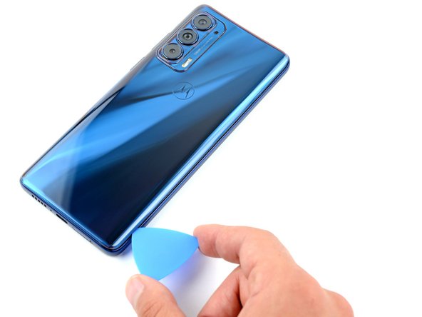

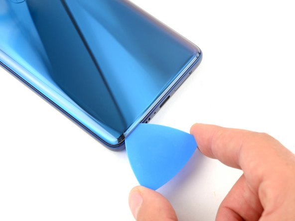

  3. Motorola Edge 5G UW (2022) Screen Replacement, Separate the left adhesive: crwdns2935265:03crwdnd2935265:01crwdnd2935265:03crwdne2935265:0 Motorola Edge 5G UW (2022) Screen Replacement, Separate the left adhesive: crwdns2935265:03crwdnd2935265:02crwdnd2935265:03crwdne2935265:0 Motorola Edge 5G UW (2022) Screen Replacement, Separate the left adhesive: crwdns2935265:03crwdnd2935265:03crwdnd2935265:03crwdne2935265:0
    • Apply a suction cup to the back of the phone, as close to the bottom left corner as possible.
    • Pull up on the suction cup with a strong, steady force to create a gap between the back cover and the midframe on the left edge.
    • Depending on the age of your phone, this may be difficult. If you're having trouble, apply more heat to the edge and try again.
    • Insert an opening pick into the gap.

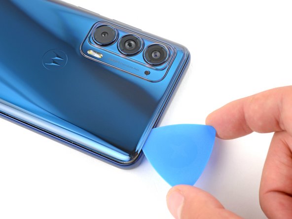

  4. Motorola Edge 5G UW (2022) Screen Replacement, Slice the left adhesive: crwdns2935265:04crwdnd2935265:01crwdnd2935265:02crwdne2935265:0 Motorola Edge 5G UW (2022) Screen Replacement, Slice the left adhesive: crwdns2935265:04crwdnd2935265:02crwdnd2935265:02crwdne2935265:0
    • Slide the pick along the left edge of the phone to slice the adhesive securing the back cover to the frame.
    • Leave the pick inserted in the top left corner to prevent the adhesive from resealing.

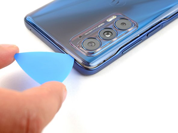

  11. Motorola Edge 5G UW (2022) Screen Replacement: crwdns2935265:011crwdnd2935265:01crwdnd2935265:01crwdne2935265:0
    • Apply a heated iOpener to the back cover's bottom edge for two minutes.
  12. Motorola Edge 5G UW (2022) Screen Replacement: crwdns2935265:012crwdnd2935265:01crwdnd2935265:02crwdne2935265:0 Motorola Edge 5G UW (2022) Screen Replacement: crwdns2935265:012crwdnd2935265:02crwdnd2935265:02crwdne2935265:0
    • Rotate the pick around the bottom right corner to slice the adhesive.
  13. Motorola Edge 5G UW (2022) Screen Replacement: crwdns2935265:013crwdnd2935265:01crwdnd2935265:02crwdne2935265:0 Motorola Edge 5G UW (2022) Screen Replacement: crwdns2935265:013crwdnd2935265:02crwdnd2935265:02crwdne2935265:0
    • Slide the pick along the bottom edge to slice the adhesive.

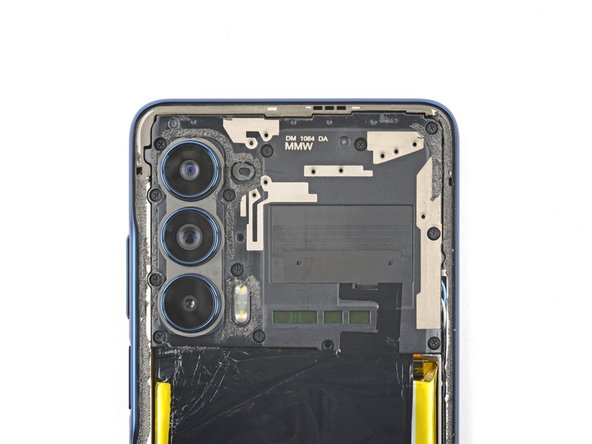

  14. Motorola Edge 5G UW (2022) Screen Replacement, Heat the camera adhesive: crwdns2935265:014crwdnd2935265:01crwdnd2935265:02crwdne2935265:0 Motorola Edge 5G UW (2022) Screen Replacement, Heat the camera adhesive: crwdns2935265:014crwdnd2935265:02crwdnd2935265:02crwdne2935265:0
    • There's a significant amount of adhesive to the right of the cameras that secures the back cover to the motherboard cover.
    • Apply a heated iOpener to the right of the cameras for two minutes.
  15. Motorola Edge 5G UW (2022) Screen Replacement, Slice the adhesive around the camera: crwdns2935265:015crwdnd2935265:01crwdnd2935265:02crwdne2935265:0 Motorola Edge 5G UW (2022) Screen Replacement, Slice the adhesive around the camera: crwdns2935265:015crwdnd2935265:02crwdnd2935265:02crwdne2935265:0
    • Insert an opening pick between the back cover and motherboard cover on the top right edge.
    • Gently pull up on the back cover while sliding the opening pick back and forth along the right side of the cameras to slice the adhesive.
    • The back cover should detach from the phone at this point.

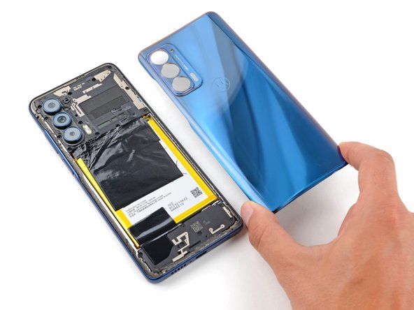

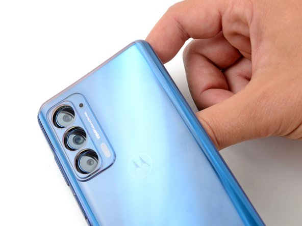

  16. Motorola Edge 5G UW (2022) Screen Replacement, Remove the back cover: crwdns2935265:016crwdnd2935265:01crwdnd2935265:02crwdne2935265:0 Motorola Edge 5G UW (2022) Screen Replacement, Remove the back cover: crwdns2935265:016crwdnd2935265:02crwdnd2935265:02crwdne2935265:0
    • Lift the back cover from the phone and remove it.
    • If the back cover is still stuck to the midframe, slide an opening pick around the edges of the phone until the cover separates completely.
    • During reassembly:
    • This is a good point to test your phone's functionality before sealing it up. Use this guide to run a hardware test. Be sure to power your phone back down completely before you continue working.
    • Follow this guide to replace the back cover adhesive.

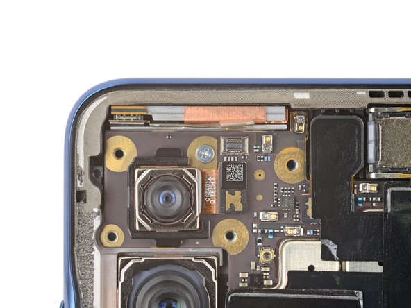

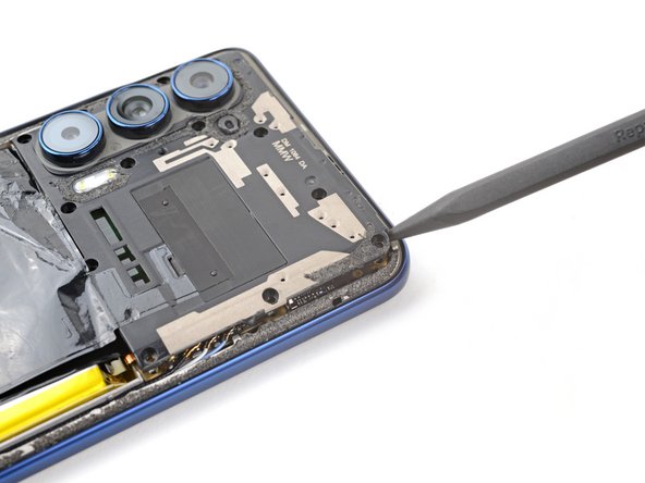

  17. Motorola Edge 5G UW (2022) Screen Replacement, Unfasten the motherboard cover: crwdns2935265:017crwdnd2935265:01crwdnd2935265:02crwdne2935265:0 Motorola Edge 5G UW (2022) Screen Replacement, Unfasten the motherboard cover: crwdns2935265:017crwdnd2935265:02crwdnd2935265:02crwdne2935265:0
    • Use a Phillips screwdriver to remove the 13 4 mm screws securing the motherboard cover.
  18. Motorola Edge 5G UW (2022) Screen Replacement, Release the motherboard cover clips: crwdns2935265:018crwdnd2935265:01crwdnd2935265:02crwdne2935265:0 Motorola Edge 5G UW (2022) Screen Replacement, Release the motherboard cover clips: crwdns2935265:018crwdnd2935265:02crwdnd2935265:02crwdne2935265:0
    • Insert a spudger between the motherboard cover and midframe on the top right edge of the phone.
    • Pry up with the spudger to release the clips securing the motherboard cover.
    • During reassembly, press down around the perimeter of the motherboard cover to engage the clips.

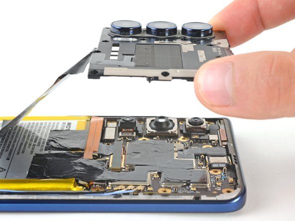

  19. Motorola Edge 5G UW (2022) Screen Replacement, Remove the motherboard cover: crwdns2935265:019crwdnd2935265:01crwdnd2935265:03crwdne2935265:0 Motorola Edge 5G UW (2022) Screen Replacement, Remove the motherboard cover: crwdns2935265:019crwdnd2935265:02crwdnd2935265:03crwdne2935265:0 Motorola Edge 5G UW (2022) Screen Replacement, Remove the motherboard cover: crwdns2935265:019crwdnd2935265:03crwdnd2935265:03crwdne2935265:0
    • Gently pull the motherboard cover up and away from the phone and remove it.
    • Don't pull quickly or forcefully, as the heat spreader very loosely secures the motherboard cover to the battery.

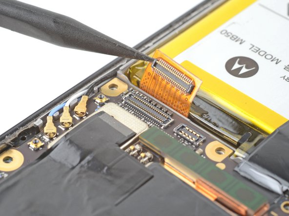

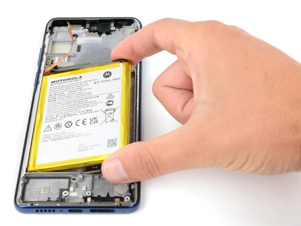

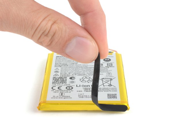

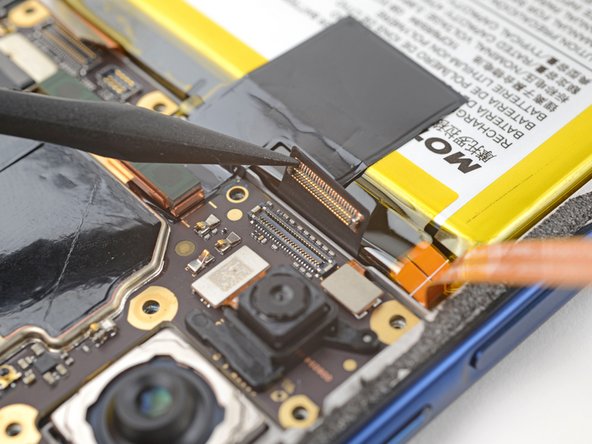

  20. Motorola Edge 5G UW (2022) Screen Replacement, Disconnect the battery: crwdns2935265:020crwdnd2935265:01crwdnd2935265:02crwdne2935265:0 Motorola Edge 5G UW (2022) Screen Replacement, Disconnect the battery: crwdns2935265:020crwdnd2935265:02crwdnd2935265:02crwdne2935265:0
    • Use the pointed end of a spudger to pry up and disconnect the battery's press connector.
    • To re-attach press connectors like this one, carefully align and press down on one side until it clicks into place, then repeat on the other side. Don't press down on the middle. If the connector is misaligned, the pins can bend, causing permanent damage.

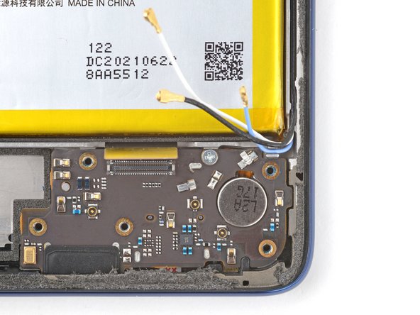

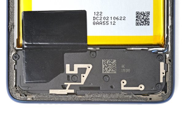

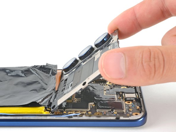

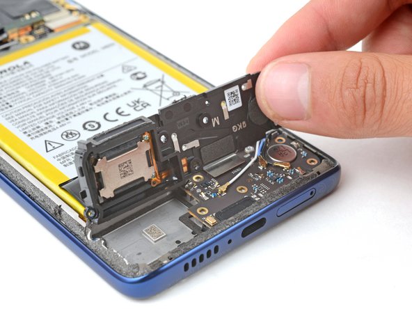

  21. Motorola Edge 5G UW (2022) Screen Replacement, Unfasten the daughterboard cover: crwdns2935265:021crwdnd2935265:01crwdnd2935265:02crwdne2935265:0 Motorola Edge 5G UW (2022) Screen Replacement, Unfasten the daughterboard cover: crwdns2935265:021crwdnd2935265:02crwdnd2935265:02crwdne2935265:0
    • Use a Phillips screwdriver to remove the six 4 mm screws that secure the daughterboard cover.

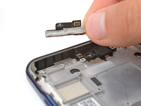

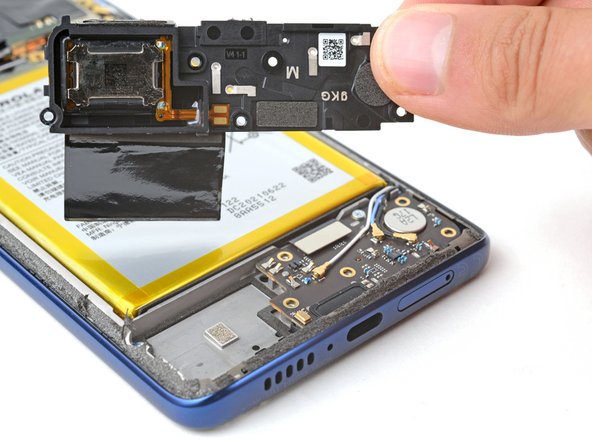

  22. Motorola Edge 5G UW (2022) Screen Replacement, Remove the daughterboard cover: crwdns2935265:022crwdnd2935265:01crwdnd2935265:03crwdne2935265:0 Motorola Edge 5G UW (2022) Screen Replacement, Remove the daughterboard cover: crwdns2935265:022crwdnd2935265:02crwdnd2935265:03crwdne2935265:0 Motorola Edge 5G UW (2022) Screen Replacement, Remove the daughterboard cover: crwdns2935265:022crwdnd2935265:03crwdnd2935265:03crwdne2935265:0
    • Use your fingers or tweezers to lift the daughterboard cover up and towards the top edge of the phone to remove it.
    • Be gentle when lifting, as a small heat spreader loosely connects the daughterboard cover to the battery.

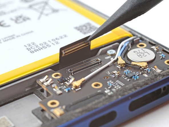

  23. Motorola Edge 5G UW (2022) Screen Replacement, Disconnect the interconnect cable: crwdns2935265:023crwdnd2935265:01crwdnd2935265:02crwdne2935265:0 Motorola Edge 5G UW (2022) Screen Replacement, Disconnect the interconnect cable: crwdns2935265:023crwdnd2935265:02crwdnd2935265:02crwdne2935265:0
    • Use the pointed end of a spudger to pry up and disconnect the interconnect cable's press connector from the daughterboard.

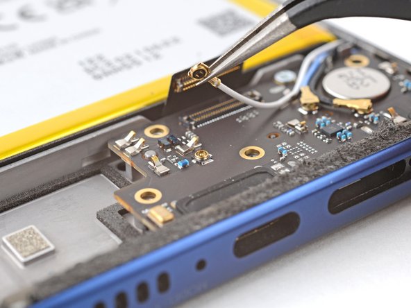

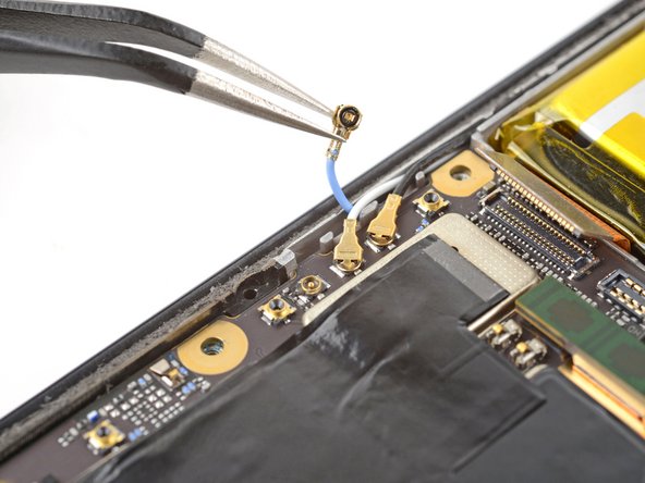

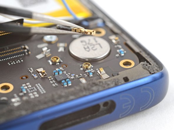

  24. Motorola Edge 5G UW (2022) Screen Replacement, Disconnect the antenna cable: crwdns2935265:024crwdnd2935265:01crwdnd2935265:02crwdne2935265:0 Motorola Edge 5G UW (2022) Screen Replacement, Disconnect the antenna cable: crwdns2935265:024crwdnd2935265:02crwdnd2935265:02crwdne2935265:0
    • Take care not to puncture the battery with your tweezers—a punctured battery may leak dangerous chemicals or cause a fire.
    • Use tweezers to grip the top and bottom of the white antenna's coaxial connector, as close to the connector head as possible.
    • Lift straight up to disconnect the cable.
    • Be gentle when disconnecting the cable, as it's very easy to tear the socket from the daughterboard.
    • To re-attach coaxial connectors like this one, hold the connectors in place and gently press them straight down with your finger or the pointed end of a spudger.

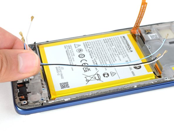

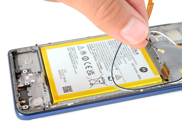

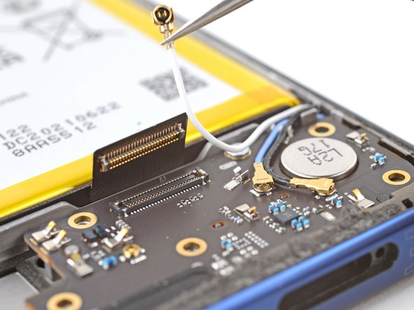

  25. Motorola Edge 5G UW (2022) Screen Replacement: crwdns2935265:025crwdnd2935265:01crwdnd2935265:02crwdne2935265:0 Motorola Edge 5G UW (2022) Screen Replacement: crwdns2935265:025crwdnd2935265:02crwdnd2935265:02crwdne2935265:0
    • Use tweezers or your fingers to gently pull the white antenna cable up and towards the right edge of the phone until it's freed from the clip securing it to the daughterboard.
    • During reassembly, make sure to put the cable back in its clip on the daughterboard.
  26. Motorola Edge 5G UW (2022) Screen Replacement: crwdns2935265:026crwdnd2935265:01crwdnd2935265:03crwdne2935265:0 Motorola Edge 5G UW (2022) Screen Replacement: crwdns2935265:026crwdnd2935265:02crwdnd2935265:03crwdne2935265:0 Motorola Edge 5G UW (2022) Screen Replacement: crwdns2935265:026crwdnd2935265:03crwdnd2935265:03crwdne2935265:0
    • Use the same technique to disconnect and loosen the blue and black antenna cables.
    • During reassembly, make sure to put the cables back in their clips on the daughterboard.

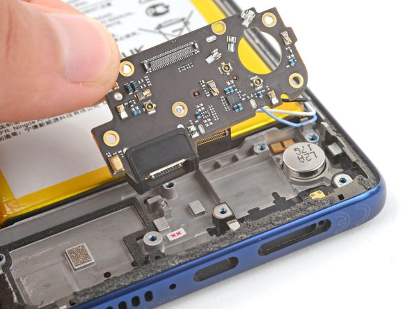

  27. Motorola Edge 5G UW (2022) Screen Replacement, Unfasten the daughterboard: crwdns2935265:027crwdnd2935265:01crwdnd2935265:02crwdne2935265:0 Motorola Edge 5G UW (2022) Screen Replacement, Unfasten the daughterboard: crwdns2935265:027crwdnd2935265:02crwdnd2935265:02crwdne2935265:0
    • Use a Phillips screwdriver to remove the 3 mm screw securing the daughterboard.
  28. Motorola Edge 5G UW (2022) Screen Replacement: crwdns2935265:028crwdnd2935265:01crwdnd2935265:02crwdne2935265:0 Motorola Edge 5G UW (2022) Screen Replacement: crwdns2935265:028crwdnd2935265:02crwdnd2935265:02crwdne2935265:0
    • Before you perform this step, be sure you’ve ejected the SIM tray.
    • Use your fingers or tweezers to pull the daughterboard up and towards the top edge to remove it.
    • During reassembly, make sure that all of the cables that connect to the daughterboard (interconnect and antennas) are out of they way so they don't get stuck under the daughterboard when it's reinserted.

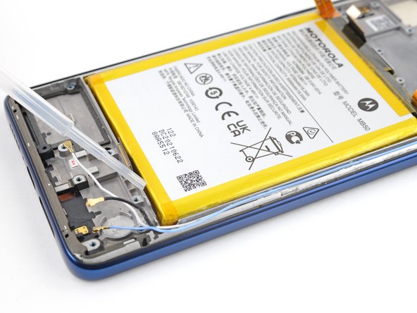

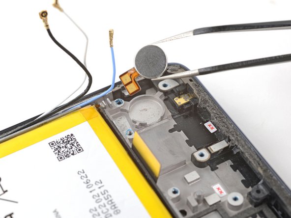

  29. Motorola Edge 5G UW (2022) Screen Replacement, Apply isopropoyl alcohol: crwdns2935265:029crwdnd2935265:01crwdnd2935265:01crwdne2935265:0
    • Apply a few drops of high-concentration (90% or higher) isopropyl alcohol under the vibration motor and its contact pad to loosen the adhesive securing them.
    • Let the isopropyl alcohol soak for one minute.

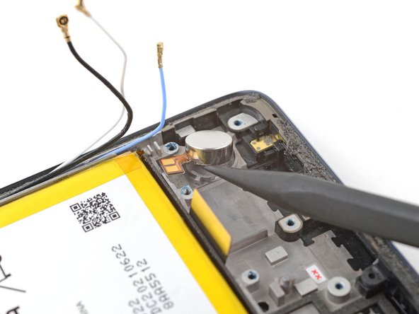

  30. Motorola Edge 5G UW (2022) Screen Replacement, Remove the vibration motor: crwdns2935265:030crwdnd2935265:01crwdnd2935265:03crwdne2935265:0 Motorola Edge 5G UW (2022) Screen Replacement, Remove the vibration motor: crwdns2935265:030crwdnd2935265:02crwdnd2935265:03crwdne2935265:0 Motorola Edge 5G UW (2022) Screen Replacement, Remove the vibration motor: crwdns2935265:030crwdnd2935265:03crwdnd2935265:03crwdne2935265:0
    • Insert the pointed end of a spudger in the gap between the vibration motor and frame.
    • Pry up with the spudger to dislodge the vibration motor.
    • The vibration motor's flex cable is very fragile. Work slowly to prevent tearing the cable.
    • Use tweezers or your fingers to remove the vibration motor.
    • If there's any alcohol remaining, use a lint-free cloth to wipe it up or allow the alcohol to dry off before installing a new vibration motor.
    • Apply new adhesive to your vibration motor before installing it in the frame.

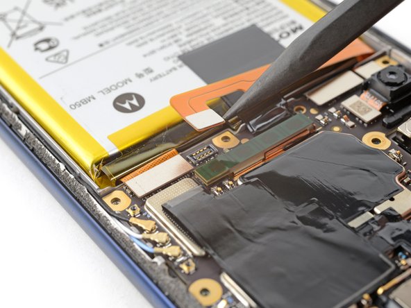

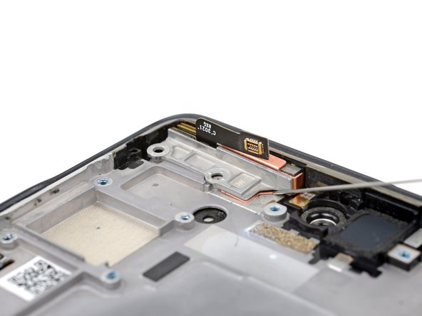

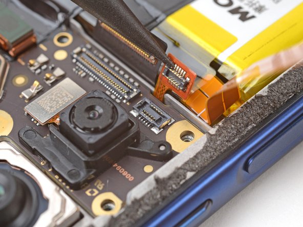

  31. Motorola Edge 5G UW (2022) Screen Replacement, Disconnect the display cable: crwdns2935265:031crwdnd2935265:01crwdnd2935265:02crwdne2935265:0 Motorola Edge 5G UW (2022) Screen Replacement, Disconnect the display cable: crwdns2935265:031crwdnd2935265:02crwdnd2935265:02crwdne2935265:0
    • Use the pointed end of a spudger to pry up and disconnect the display's press connector.

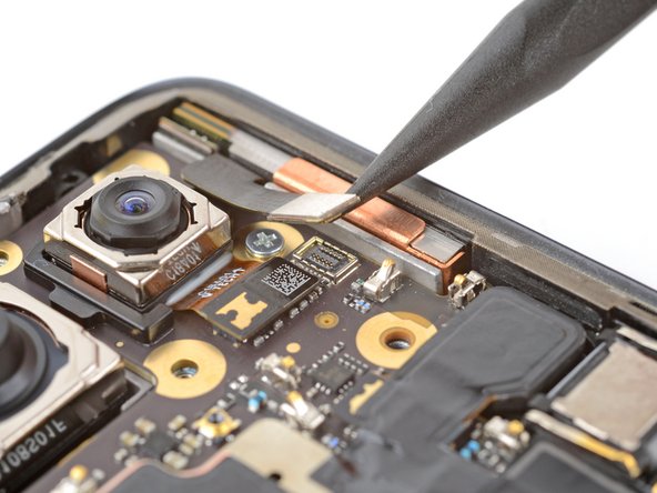

  32. Motorola Edge 5G UW (2022) Screen Replacement, Disconnect the 5G mmWave antenna cable: crwdns2935265:032crwdnd2935265:01crwdnd2935265:02crwdne2935265:0 Motorola Edge 5G UW (2022) Screen Replacement, Disconnect the 5G mmWave antenna cable: crwdns2935265:032crwdnd2935265:02crwdnd2935265:02crwdne2935265:0
    • Use the pointed end of a spudger to pry up and disconnect the 5G mmWave antenna's press connector.

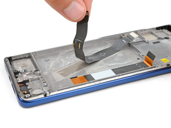

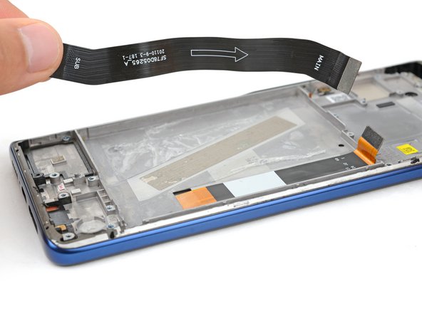

  33. Motorola Edge 5G UW (2022) Screen Replacement, Disconnect the interconnect cable: crwdns2935265:033crwdnd2935265:01crwdnd2935265:02crwdne2935265:0 Motorola Edge 5G UW (2022) Screen Replacement, Disconnect the interconnect cable: crwdns2935265:033crwdnd2935265:02crwdnd2935265:02crwdne2935265:0
    • Use the pointed end of a spudger to pry up and disconnect the interconnect cable's press connector from the motherboard.

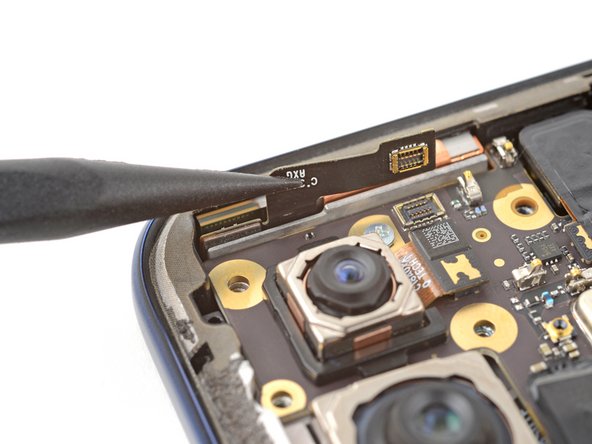

  34. Motorola Edge 5G UW (2022) Screen Replacement, Disconnect the button assembly cable: crwdns2935265:034crwdnd2935265:01crwdnd2935265:02crwdne2935265:0 Motorola Edge 5G UW (2022) Screen Replacement, Disconnect the button assembly cable: crwdns2935265:034crwdnd2935265:02crwdnd2935265:02crwdne2935265:0
    • Use the pointed end of a spudger to pry up and disconnect the button assembly cable's press connector.

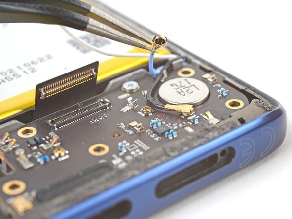

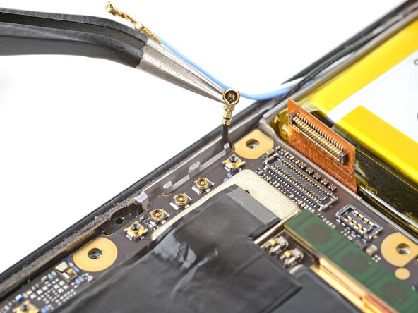

  35. Motorola Edge 5G UW (2022) Screen Replacement: crwdns2935265:035crwdnd2935265:01crwdnd2935265:02crwdne2935265:0 Motorola Edge 5G UW (2022) Screen Replacement: crwdns2935265:035crwdnd2935265:02crwdnd2935265:02crwdne2935265:0

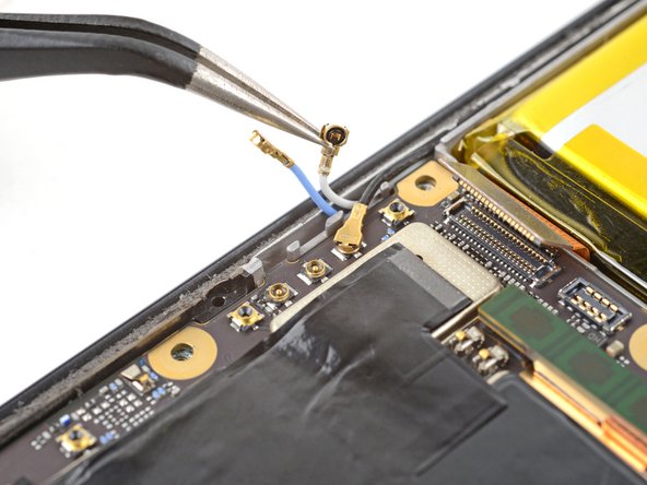

    • Use tweezers to grip the top and bottom of the blue antenna's coaxial connector, as close to the connector head as possible.
    • Be gentle when disconnecting the cable, as it's very easy to tear the socket from the motherboard.
    • During reassembly, make sure to put the cable back in its clip on the motherboard.
    • To re-attach coaxial connectors like this one hold the connectors in place and gently press them straight down with your finger or the pointed end of a spudger.
  36. Motorola Edge 5G UW (2022) Screen Replacement: crwdns2935265:036crwdnd2935265:01crwdnd2935265:03crwdne2935265:0 Motorola Edge 5G UW (2022) Screen Replacement: crwdns2935265:036crwdnd2935265:02crwdnd2935265:03crwdne2935265:0 Motorola Edge 5G UW (2022) Screen Replacement: crwdns2935265:036crwdnd2935265:03crwdnd2935265:03crwdne2935265:0
    • Use the same method from the previous antenna cable to disconnect the white and black antenna cables.
    • During reassembly, make sure to put the cables back in their clips on the motherboard.

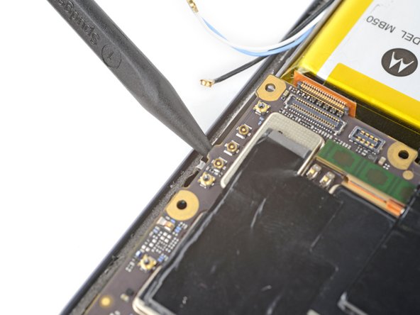

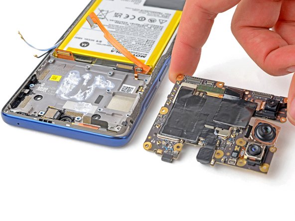

  37. Motorola Edge 5G UW (2022) Screen Replacement: crwdns2935265:037crwdnd2935265:01crwdnd2935265:02crwdne2935265:0 Motorola Edge 5G UW (2022) Screen Replacement: crwdns2935265:037crwdnd2935265:02crwdnd2935265:02crwdne2935265:0
    • Use the pointed end of a spudger to bend the 5G mmWave antenna cable out of the way to access the screw securing the motherboard.
  38. Motorola Edge 5G UW (2022) Screen Replacement: crwdns2935265:038crwdnd2935265:01crwdnd2935265:02crwdne2935265:0 Motorola Edge 5G UW (2022) Screen Replacement: crwdns2935265:038crwdnd2935265:02crwdnd2935265:02crwdne2935265:0
    • Use a Phillips screwdriver to remove the 3 mm screw securing the motherboard.
  39. Motorola Edge 5G UW (2022) Screen Replacement: crwdns2935265:039crwdnd2935265:01crwdnd2935265:02crwdne2935265:0 Motorola Edge 5G UW (2022) Screen Replacement: crwdns2935265:039crwdnd2935265:02crwdnd2935265:02crwdne2935265:0
    • Insert the pointed end of a spudger between the midframe and motherboard in the opening near the coaxial connectors.
    • Gently pry up with the spudger to release the motherboard from the midframe.
  40. Motorola Edge 5G UW (2022) Screen Replacement: crwdns2935265:040crwdnd2935265:01crwdnd2935265:02crwdne2935265:0 Motorola Edge 5G UW (2022) Screen Replacement: crwdns2935265:040crwdnd2935265:02crwdnd2935265:02crwdne2935265:0
    • Remove the motherboard from the phone.
    • During reassembly, make sure that all of the cables that connect to the motherboard (interconnect, battery, antennas, display, and button assembly) are out of they way so they don't get stuck under the motherboard when it's reinserted.

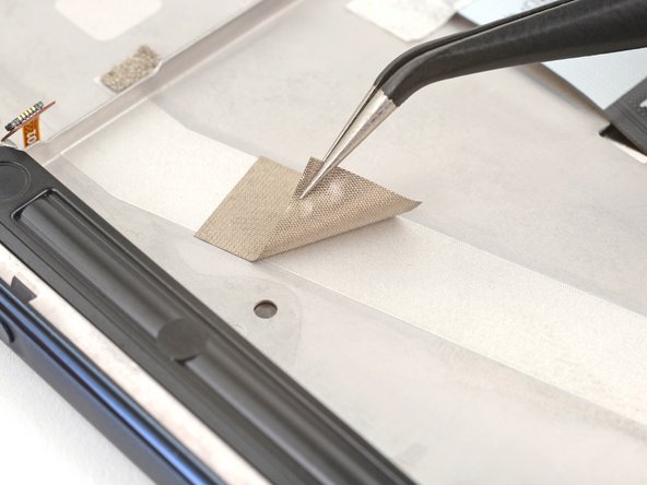

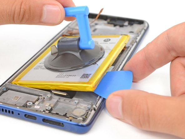

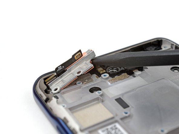

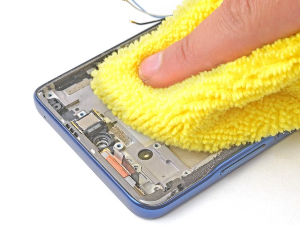

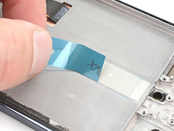

  41. Motorola Edge 5G UW (2022) Screen Replacement, Reassembly note: crwdns2935265:041crwdnd2935265:01crwdnd2935265:02crwdne2935265:0 Motorola Edge 5G UW (2022) Screen Replacement, Reassembly note: crwdns2935265:041crwdnd2935265:02crwdnd2935265:02crwdne2935265:0
    Microfiber Cleaning Cloths
    $3.99

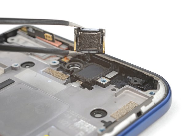

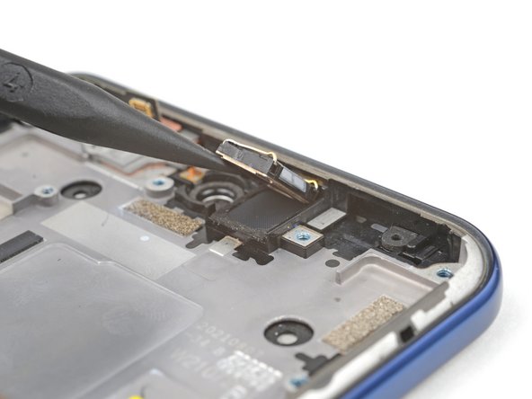

  42. Motorola Edge 5G UW (2022) Screen Replacement, Remove the earpiece speaker: crwdns2935265:042crwdnd2935265:01crwdnd2935265:03crwdne2935265:0 Motorola Edge 5G UW (2022) Screen Replacement, Remove the earpiece speaker: crwdns2935265:042crwdnd2935265:02crwdnd2935265:03crwdne2935265:0 Motorola Edge 5G UW (2022) Screen Replacement, Remove the earpiece speaker: crwdns2935265:042crwdnd2935265:03crwdnd2935265:03crwdne2935265:0
    • Note the orientation of the earpiece speaker. During reassembly it must be reinserted the same way or the speaker won't work.
    • Insert the pointed end of a spudger between the earpiece speaker and its housing
    • Pry up with the spudger to dislodge the speaker.
    • A small amount of adhesive secures the speaker.
    • Use your fingers or tweezers to remove the speaker.
    • Before reinstalling the speaker on the new screen assembly, ensure that the speaker has no mesh on the back of it.
    • Before reinserting the speaker, ensure that the raised ends of the speaker's contacts are on the right. If they aren't the speaker won't work.
  43. Motorola Edge 5G UW (2022) Screen Replacement, Apply isopropyl alcohol: crwdns2935265:043crwdnd2935265:01crwdnd2935265:02crwdne2935265:0 Motorola Edge 5G UW (2022) Screen Replacement, Apply isopropyl alcohol: crwdns2935265:043crwdnd2935265:02crwdnd2935265:02crwdne2935265:0
    • Apply a few drops of high-concentration (90% or higher) isopropyl alcohol under the 5G mmWave antenna.
    • Wait one minute for the isopropyl alcohol to penetrate the adhesive.
  44. Motorola Edge 5G UW (2022) Screen Replacement, Remove the top 5G mmWave antenna: crwdns2935265:044crwdnd2935265:01crwdnd2935265:03crwdne2935265:0 Motorola Edge 5G UW (2022) Screen Replacement, Remove the top 5G mmWave antenna: crwdns2935265:044crwdnd2935265:02crwdnd2935265:03crwdne2935265:0 Motorola Edge 5G UW (2022) Screen Replacement, Remove the top 5G mmWave antenna: crwdns2935265:044crwdnd2935265:03crwdnd2935265:03crwdne2935265:0
    • Insert the pointed end of a spudger under the 5G mmWave antenna on the side closest to the center of the phone.
    • Pry up with the spudger to detach the antenna.
    • It may take significant force to detach the antenna. If the antenna isn't moving, apply a few more drops of isopropyl alcohol and try again.
    • Remove the antenna.
    • During reassembly, remove the old adhesive from the bracket and frame, then apply new adhesive.
  45. Motorola Edge 5G UW (2022) Screen Replacement, Remove the antennas: crwdns2935265:045crwdnd2935265:01crwdnd2935265:03crwdne2935265:0 Motorola Edge 5G UW (2022) Screen Replacement, Remove the antennas: crwdns2935265:045crwdnd2935265:02crwdnd2935265:03crwdne2935265:0 Motorola Edge 5G UW (2022) Screen Replacement, Remove the antennas: crwdns2935265:045crwdnd2935265:03crwdnd2935265:03crwdne2935265:0
    • Pull the black, white, and blue antenna cables up and out of the phone.
    • During reassembly, be sure to put the antennas back in their groove on the right edge of the frame.

    • Apply a few drops of high-concentration (90% or higher) isopropyl alcohol to the gaps along the battery's edges.
    • Tilt the device as you apply alcohol to help it flow under the battery.
    • Wait one minute to allow the isopropyl alcohol to penetrate the adhesive.
    • Only apply a few drops initially and apply more as necessary.
  47. Motorola Edge 5G UW (2022) Screen Replacement: crwdns2935265:047crwdnd2935265:01crwdnd2935265:03crwdne2935265:0 Motorola Edge 5G UW (2022) Screen Replacement: crwdns2935265:047crwdnd2935265:02crwdnd2935265:03crwdne2935265:0 Motorola Edge 5G UW (2022) Screen Replacement: crwdns2935265:047crwdnd2935265:03crwdnd2935265:03crwdne2935265:0
    • Take care not to puncture or bend the battery during the removal process—a punctured or bent battery may leak dangerous chemicals or cause a fire.
    • Apply a suction cup to the battery.
    • Pull up on the suction cup with strong, steady force to separate the battery from the frame.
    • If the battery doesn't budge, apply a few more drops of isopropyl alcohol, wait one minute, and try again.
    • Continue to pull up on the suction cup with a strong, steady force while sliding the opening pick back and forth to slice the adhesive.
    • Continue this process until the battery separates from the midframe.
  48. Motorola Edge 5G UW (2022) Screen Replacement, Remove the battery: crwdns2935265:048crwdnd2935265:01crwdnd2935265:02crwdne2935265:0 Motorola Edge 5G UW (2022) Screen Replacement, Remove the battery: crwdns2935265:048crwdnd2935265:02crwdnd2935265:02crwdne2935265:0
    • Remove the battery from the midframe.
    • Don't reuse the battery if it has been deformed or damaged, as doing so is a potential safety hazard. Replace it with a new battery.
    • Follow this guide to replace the battery adhesive.
  49. Motorola Edge 5G UW (2022) Screen Replacement: crwdns2935265:049crwdnd2935265:01crwdnd2935265:03crwdne2935265:0 Motorola Edge 5G UW (2022) Screen Replacement: crwdns2935265:049crwdnd2935265:02crwdnd2935265:03crwdne2935265:0 Motorola Edge 5G UW (2022) Screen Replacement: crwdns2935265:049crwdnd2935265:03crwdnd2935265:03crwdne2935265:0
    • Use your fingers to peel the board ribbon cable from the midframe.
    • If you're having trouble separating the adhesive, use an iOpener or hair dryer to heat the cable.
  50. Motorola Edge 5G UW (2022) Screen Replacement, Reassembly information: crwdns2935265:050crwdnd2935265:01crwdnd2935265:03crwdne2935265:0 Motorola Edge 5G UW (2022) Screen Replacement, Reassembly information: crwdns2935265:050crwdnd2935265:02crwdnd2935265:03crwdne2935265:0 Motorola Edge 5G UW (2022) Screen Replacement, Reassembly information: crwdns2935265:050crwdnd2935265:03crwdnd2935265:03crwdne2935265:0
    • This step shows how to replace the conductive adhesive for the board cable during reassembly. If your frame has this adhesive preinstalled, skip this step.
    • If necessary, cut the adhesive blocks to fit into contours of the cable channel. The adhesive doesn't need fit the contours perfectly.
    • Peel the adhesive blocks from the adhesive sheet.
    • Place the adhesives in the board cable channel. Space them evenly through the channel.
    • Peel any remaining plastic liners to expose the adhesive.
  51. Motorola Edge 5G UW (2022) Screen Replacement: crwdns2935265:051crwdnd2935265:01crwdnd2935265:01crwdne2935265:0

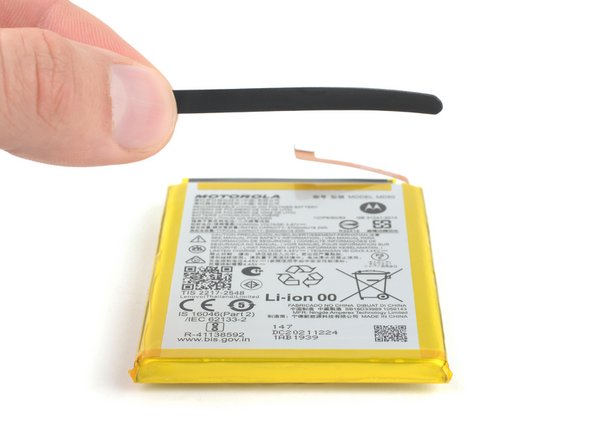

  52. Motorola Edge 5G UW (2022) Screen Replacement, Transfer the battery's foam strip: crwdns2935265:052crwdnd2935265:01crwdnd2935265:03crwdne2935265:0 Motorola Edge 5G UW (2022) Screen Replacement, Transfer the battery's foam strip: crwdns2935265:052crwdnd2935265:02crwdnd2935265:03crwdne2935265:0 Motorola Edge 5G UW (2022) Screen Replacement, Transfer the battery's foam strip: crwdns2935265:052crwdnd2935265:03crwdnd2935265:03crwdne2935265:0
    • If you're reusing your old battery, skip this step.
    • Use tweezers or your fingers to remove the foam strip from the battery's bottom edge.
    • Before installing your new battery, apply the foam strip to it.
