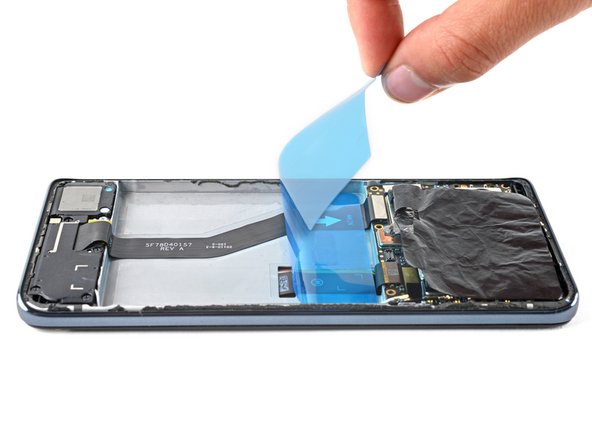

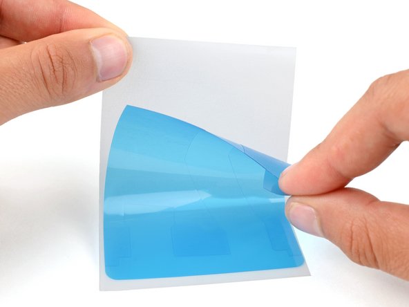

  3. How to Replace the Battery Adhesive for Your Motorola Phone, Expose the adhesive: crwdns2935265:03crwdnd2935265:01crwdnd2935265:02crwdne2935265:0 How to Replace the Battery Adhesive for Your Motorola Phone, Expose the adhesive: crwdns2935265:03crwdnd2935265:02crwdnd2935265:02crwdne2935265:0
    • Use the pull tab on the blue liner to separate the adhesive from the white liner.

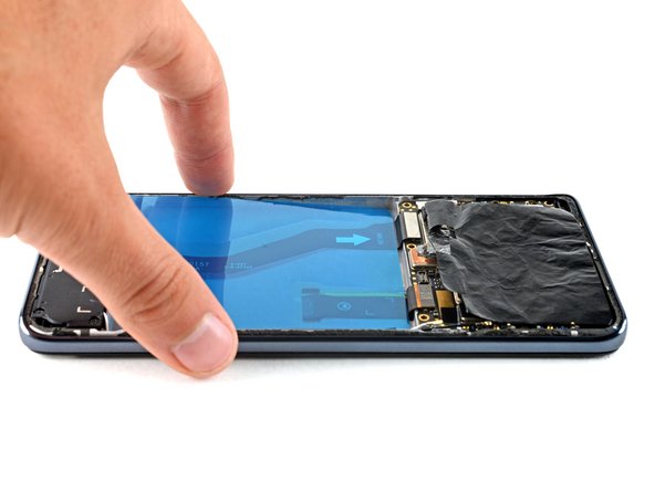

  4. How to Replace the Battery Adhesive for Your Motorola Phone, Apply the new adhesive: crwdns2935265:04crwdnd2935265:01crwdnd2935265:03crwdne2935265:0 How to Replace the Battery Adhesive for Your Motorola Phone, Apply the new adhesive: crwdns2935265:04crwdnd2935265:02crwdnd2935265:03crwdne2935265:0 How to Replace the Battery Adhesive for Your Motorola Phone, Apply the new adhesive: crwdns2935265:04crwdnd2935265:03crwdnd2935265:03crwdne2935265:0
    • Be very careful during this step! The adhesive is very sticky, and can't be repositioned once it sticks.
    • With the adhesive in its proper orientation, lay it sticky side down in the battery recess.
    • Use a spudger or your fingers to firmly press down on the blue liner to secure the new adhesive to the frame.

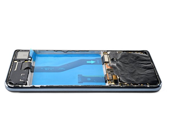

  5. How to Replace the Battery Adhesive for Your Motorola Phone: crwdns2935265:05crwdnd2935265:01crwdnd2935265:02crwdne2935265:0 How to Replace the Battery Adhesive for Your Motorola Phone: crwdns2935265:05crwdnd2935265:02crwdnd2935265:02crwdne2935265:0
    • Use the pull tab to peel the blue liner from the adhesive.
    • Make sure the adhesive is sticking to the frame and isn't being pulled up with the blue liner.
    • If the adhesive is being pulled up, lay it back down, press down firmly on it with a spudger or your fingers, and try again.

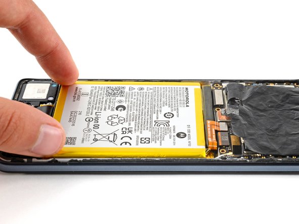

  6. How to Replace the Battery Adhesive for Your Motorola Phone: crwdns2935265:06crwdnd2935265:01crwdnd2935265:03crwdne2935265:0 How to Replace the Battery Adhesive for Your Motorola Phone: crwdns2935265:06crwdnd2935265:02crwdnd2935265:03crwdne2935265:0 How to Replace the Battery Adhesive for Your Motorola Phone: crwdns2935265:06crwdnd2935265:03crwdnd2935265:03crwdne2935265:0

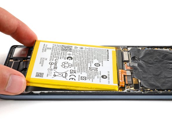

    • Before laying the battery in its recess, temporarily reconnect the battery's press connector to the motherboard socket. This ensures that the battery is properly aligned in its recess.
    • Lay the battery in its recess.
    • Firmly press down on the perimeter and center of the battery to adhere it to the frame.

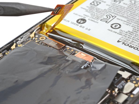

  7. How to Replace the Battery Adhesive for Your Motorola Phone: crwdns2935265:07crwdnd2935265:01crwdnd2935265:02crwdne2935265:0 How to Replace the Battery Adhesive for Your Motorola Phone: crwdns2935265:07crwdnd2935265:02crwdnd2935265:02crwdne2935265:0
    • Use the pointed end of a spudger to pry up and disconnect the battery's press connector.
