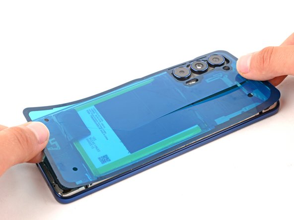

  3. How to Replace the Adhesive for Your Motorola Phone, Remove the protective film: crwdns2935265:03crwdnd2935265:01crwdnd2935265:01crwdne2935265:0
    • Remove the clear protective film from the new adhesive.
  4. How to Replace the Adhesive for Your Motorola Phone, Apply the adhesive: crwdns2935265:04crwdnd2935265:01crwdnd2935265:02crwdne2935265:0 How to Replace the Adhesive for Your Motorola Phone, Apply the adhesive: crwdns2935265:04crwdnd2935265:02crwdnd2935265:02crwdne2935265:0
    • Be very careful during this step! The adhesive is very sticky, and can't be repositioned once it sticks. Misaligned adhesive can lead to an improper seal.
    • Before placing the adhesive on the frame, use the cameras to ensure the adhesive's proper alignment.
    • Lay the adhesive on the frame.
    • Press down firmly on the adhesive along the perimeter of the midframe to secure it to the phone.

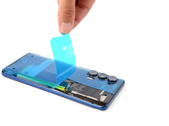

  5. How to Replace the Adhesive for Your Motorola Phone: crwdns2935265:05crwdnd2935265:01crwdnd2935265:02crwdne2935265:0 How to Replace the Adhesive for Your Motorola Phone: crwdns2935265:05crwdnd2935265:02crwdnd2935265:02crwdne2935265:0
    • Grab the blue protective film's pull tab on the top of the phone and pull towards the bottom of the phone.
    • Pull carefully so the adhesive does not separate from the phone.
  6. How to Replace the Adhesive for Your Motorola Phone, Put the back cover on: crwdns2935265:06crwdnd2935265:01crwdnd2935265:01crwdne2935265:0
    • If your phone has a rear fingerprint sensor, make sure to secure it in its cutout on the back cover before proceeding.
    • Align the back cover over the back of the phone.
    • Press down firmly for one minute along the perimeter of the back cover and camera bezel to secure it with the new adhesive.
