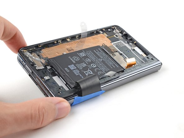

  28. Google Pixel Fold Base Battery Replacement, Disconnect the base battery: crwdns2935265:028crwdnd2935265:01crwdnd2935265:02crwdne2935265:0 Google Pixel Fold Base Battery Replacement, Disconnect the base battery: crwdns2935265:028crwdnd2935265:02crwdnd2935265:02crwdne2935265:0
    • There are two batteries you need to disconnect, one for each half of the phone.
    • Use the point of a spudger to pry up and disconnect the base battery cable press connector.

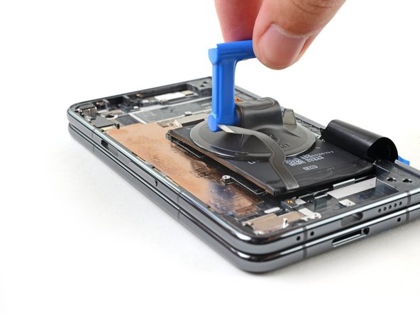

  29. Google Pixel Fold Base Battery Replacement, Remove the tape: crwdns2935265:029crwdnd2935265:01crwdnd2935265:02crwdne2935265:0 Google Pixel Fold Base Battery Replacement, Remove the tape: crwdns2935265:029crwdnd2935265:02crwdnd2935265:02crwdne2935265:0
    • Peel the grey conductive tape off the bottom interconnect cable.
  30. Google Pixel Fold Base Battery Replacement, Disconnect the flip battery: crwdns2935265:030crwdnd2935265:01crwdnd2935265:03crwdne2935265:0 Google Pixel Fold Base Battery Replacement, Disconnect the flip battery: crwdns2935265:030crwdnd2935265:02crwdnd2935265:03crwdne2935265:0 Google Pixel Fold Base Battery Replacement, Disconnect the flip battery: crwdns2935265:030crwdnd2935265:03crwdnd2935265:03crwdne2935265:0
    • Use a point of a spudger to pry up and disconnect the flip battery and bottom interconnect press connectors.
    • You have to disconnect both cables to keep the battery connector from accidentally touching the logic board.

  65. Google Pixel Fold Base Battery Replacement, Apply isopropyl alcohol: crwdns2935265:065crwdnd2935265:01crwdnd2935265:03crwdne2935265:0 Google Pixel Fold Base Battery Replacement, Apply isopropyl alcohol: crwdns2935265:065crwdnd2935265:02crwdnd2935265:03crwdne2935265:0 Google Pixel Fold Base Battery Replacement, Apply isopropyl alcohol: crwdns2935265:065crwdnd2935265:03crwdnd2935265:03crwdne2935265:0
    • Take care not to puncture or bend the battery with your tool—a punctured or bent battery may leak dangerous chemicals or cause a fire. In case you're struggling to pull up the battery, apply more isopropyl alcohol and try again.
    • Apply a few drops of high concentration (>90%) isopropyl alcohol in the gap between the frame and the left edge of the battery.
  66. Google Pixel Fold Base Battery Replacement, Tilt the phone: crwdns2935265:066crwdnd2935265:01crwdnd2935265:02crwdne2935265:0 Google Pixel Fold Base Battery Replacement, Tilt the phone: crwdns2935265:066crwdnd2935265:02crwdnd2935265:02crwdne2935265:0
    • Tilt the left side of the phone up to let the isopropyl alcohol flow under the battery.
    • Wait one minute for the alcohol to soften the adhesive.
  67. Google Pixel Fold Base Battery Replacement, Insert an opening pick: crwdns2935265:067crwdnd2935265:01crwdnd2935265:03crwdne2935265:0 Google Pixel Fold Base Battery Replacement, Insert an opening pick: crwdns2935265:067crwdnd2935265:02crwdnd2935265:03crwdne2935265:0 Google Pixel Fold Base Battery Replacement, Insert an opening pick: crwdns2935265:067crwdnd2935265:03crwdnd2935265:03crwdne2935265:0
    • Take care not to puncture or bend the battery—it can leak dangerous chemicals and/or catch fire.
    • Apply a suction cup to the battery, as close to the center of the left edge as possible.
    • Pull up on the suction cup with strong, steady force to create a gap between the battery and the frame.
    • Insert an opening pick into the gap.
  68. Google Pixel Fold Base Battery Replacement, Rotate the pick: crwdns2935265:068crwdnd2935265:01crwdnd2935265:02crwdne2935265:0 Google Pixel Fold Base Battery Replacement, Rotate the pick: crwdns2935265:068crwdnd2935265:02crwdnd2935265:02crwdne2935265:0
    • Rotate the opening pick so its long edge sits in the gap.
  69. Google Pixel Fold Base Battery Replacement, Pry up the battery: crwdns2935265:069crwdnd2935265:01crwdnd2935265:02crwdne2935265:0 Google Pixel Fold Base Battery Replacement, Pry up the battery: crwdns2935265:069crwdnd2935265:02crwdnd2935265:02crwdne2935265:0
    • Pull up on the suction cup with strong, steady force while also prying up with the opening pick to separate the battery from the frame.
    • If you're feeling a lot of resistance, apply a few more drops of isopropyl alcohol and try again.
    • Depending on the condition of your adhesive, you might need to repeat the alcohol and prying cycle a few times before the battery adhesive yields.
  70. Google Pixel Fold Base Battery Replacement, Remove the battery: crwdns2935265:070crwdnd2935265:01crwdnd2935265:01crwdne2935265:0
    Tesa 61395 Tape
    $5.99
    • Lift the battery out its recess and remove it.
    • During reassembly, if your adhesive is still intact and sticky, then you can reuse it. Otherwise, follow this guide to replace the adhesive with custom cut strips.
    • If you don't have custom cut adhesive strips, use double-sided tape, like Tesa Tape, to secure the battery to the frame.
