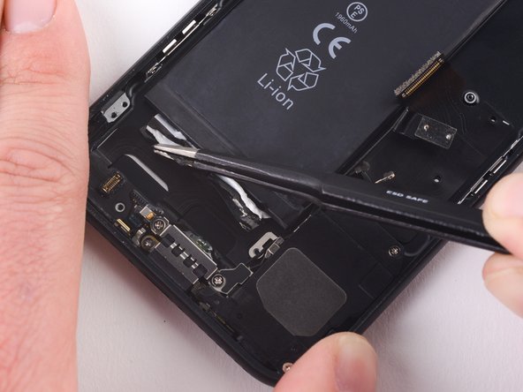

    13. iPhone 7 Power and Volume Control Cable Replacement: crwdns2935265:036crwdnd2935265:01crwdnd2935265:02crwdne2935265:0 iPhone 7 Power and Volume Control Cable Replacement: crwdns2935265:036crwdnd2935265:02crwdnd2935265:02crwdne2935265:0
      • Use tweezers to gently bend the logic board grounding bracket out of the way.

    5. iPhone 7 Power and Volume Control Cable Replacement: crwdns2935265:050crwdnd2935265:01crwdnd2935265:02crwdne2935265:0 iPhone 7 Power and Volume Control Cable Replacement: crwdns2935265:050crwdnd2935265:02crwdnd2935265:02crwdne2935265:0
      • Use a pair of tweezers with blunt tips to peel back the other adhesive strip on the lower edge of the battery.
    6. iPhone 7 Power and Volume Control Cable Replacement: crwdns2935265:051crwdnd2935265:01crwdnd2935265:03crwdne2935265:0 iPhone 7 Power and Volume Control Cable Replacement: crwdns2935265:051crwdnd2935265:02crwdnd2935265:03crwdne2935265:0 iPhone 7 Power and Volume Control Cable Replacement: crwdns2935265:051crwdnd2935265:03crwdnd2935265:03crwdne2935265:0
      • Try to keep the strips flat and unwrinkled during this procedure; wrinkled strips will stick together and break instead of pulling out cleanly.
      • Slowly pull one battery adhesive tab away from the battery, toward the bottom of the iPhone.
      • Pull steadily, maintaining constant tension on the strip until it slips out from between the battery and the rear case. For best results, pull the strip at a 60º angle or less.
      • The strip will stretch to many times its original length. Continue pulling and re-grab the strip near the battery if necessary.
