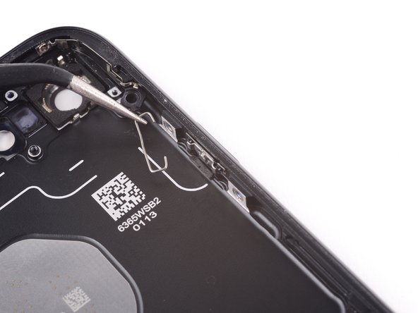

    1. iPhone 7 Power Button Replacement, Power Button: crwdns2935265:060crwdnd2935265:01crwdnd2935265:02crwdne2935265:0 iPhone 7 Power Button Replacement, Power Button: crwdns2935265:060crwdnd2935265:02crwdnd2935265:02crwdne2935265:0
      • Pull the clip towards the bottom of the phone and lift up to free it from the bracket.

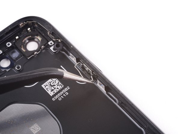

    2. iPhone 7 Power Button Replacement: crwdns2935265:061crwdnd2935265:01crwdnd2935265:02crwdne2935265:0 iPhone 7 Power Button Replacement: crwdns2935265:061crwdnd2935265:02crwdnd2935265:02crwdne2935265:0
      • Remove the clip from the rear case.

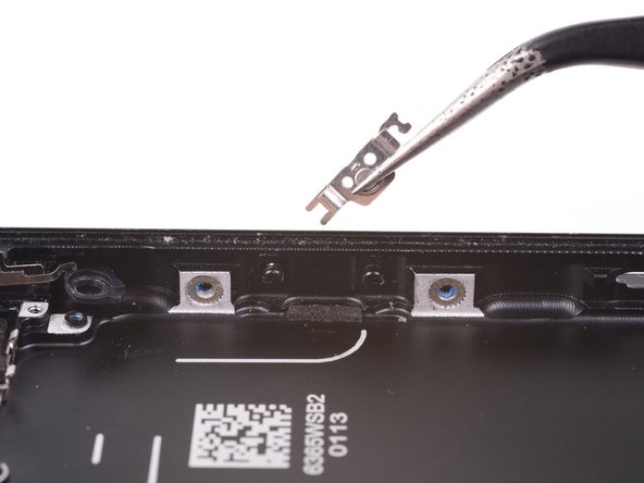

    3. iPhone 7 Power Button Replacement: crwdns2935265:062crwdnd2935265:01crwdnd2935265:02crwdne2935265:0 iPhone 7 Power Button Replacement: crwdns2935265:062crwdnd2935265:02crwdnd2935265:02crwdne2935265:0
      • Push the lower end of the power button bracket up off of peg securing it.
    4. iPhone 7 Power Button Replacement: crwdns2935265:063crwdnd2935265:01crwdnd2935265:02crwdne2935265:0 iPhone 7 Power Button Replacement: crwdns2935265:063crwdnd2935265:02crwdnd2935265:02crwdne2935265:0
      • Pull the bracket from the rear case.

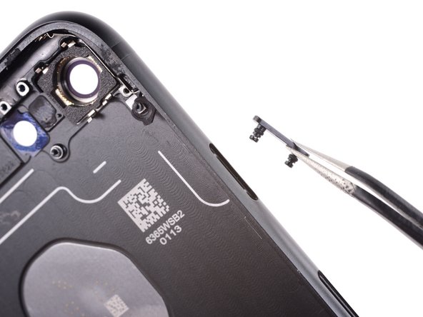

    5. iPhone 7 Power Button Replacement: crwdns2935265:064crwdnd2935265:01crwdnd2935265:02crwdne2935265:0 iPhone 7 Power Button Replacement: crwdns2935265:064crwdnd2935265:02crwdnd2935265:02crwdne2935265:0
      • Use the pointed end of a spudger to push the power button cover out of the rear case.
      • Remove the power button cover.

Alright so quick question…….
the clip shown in step 57 the one that resembles a staple,is this necessary?
Im doing a housing swap for myself and I cannot get these back on going on an hour now my hands are huge so im wondering if everything will be okay if I don’t replace these.(normally if it were another person’s device I would never take a shortcut,Never have and Never will in fact I despise this,but it’s my phone so it’s cool).
thanks
Vegeta Barrett - crwdns2934203:0crwdne2934203:0 crwdns2950251:0crwdne2950251:0
I can't see a response. Are the clips necessary?
Martha Brewer - crwdns2934203:0crwdne2934203:0 crwdns2950251:0crwdne2950251:0
It is probably to keep it in place, so I think it’s not necessary but recommended
