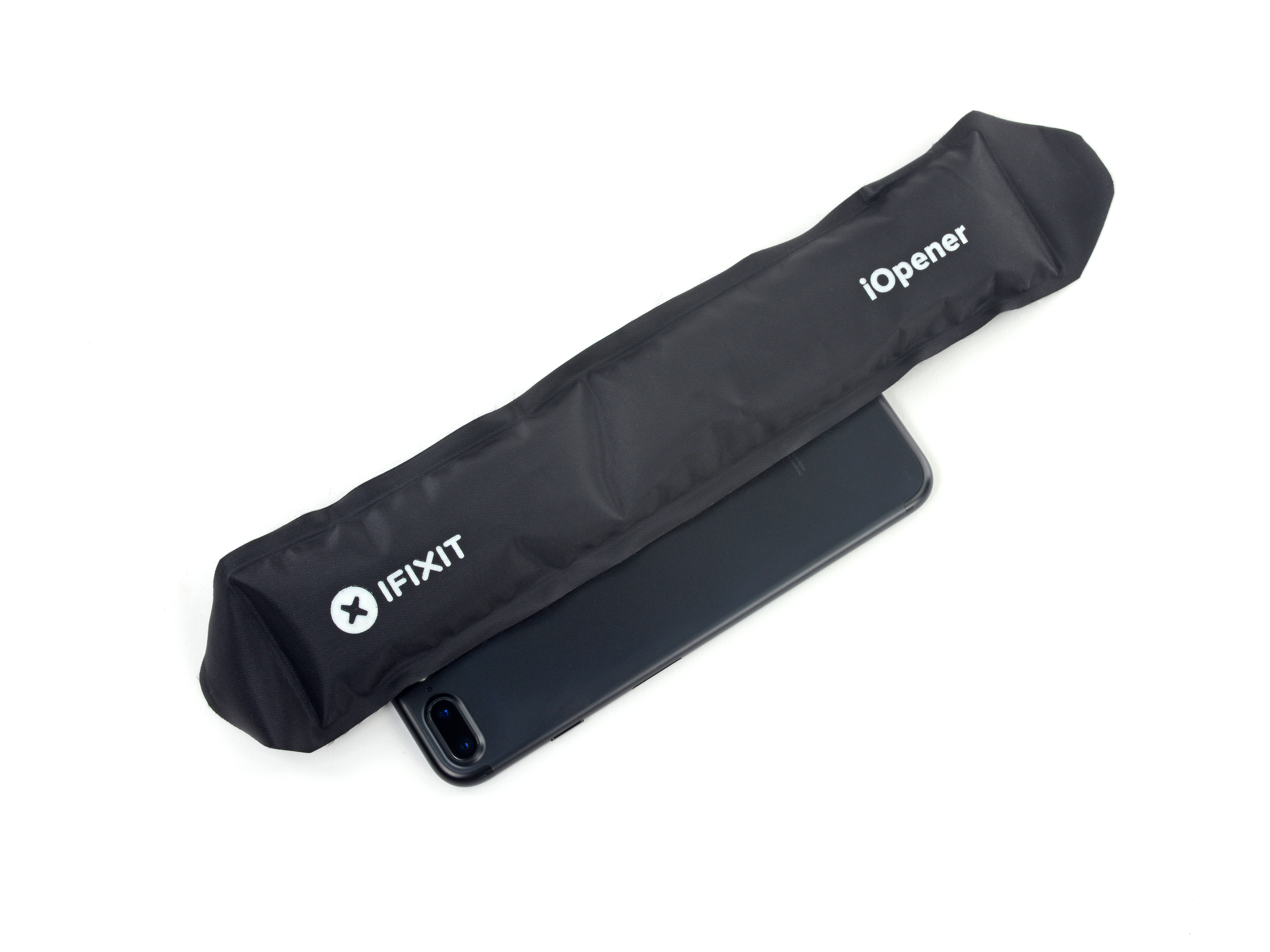

      • Heat an iOpener and thread it through the arms of the Anti-Clamp.
      • You can also use a hair dryer, heat gun, or hot plate—but extreme heat can damage the display and/or internal battery, so proceed with care.
      • Fold the iOpener so it lays on the bottom edge of the iPhone.
      • Wait one minute to give the adhesive a chance to release and present an opening gap.
      • Insert an opening pick into the gap.
      • If the Anti-Clamp doesn't create a sufficient gap, apply more heat to the area and rotate the handle a quarter turn.
      • Don't crank more than a quarter turn at a time, and wait one minute between turns. Let the Anti-Clamp and time do the work for you.
      • Skip the next three steps.

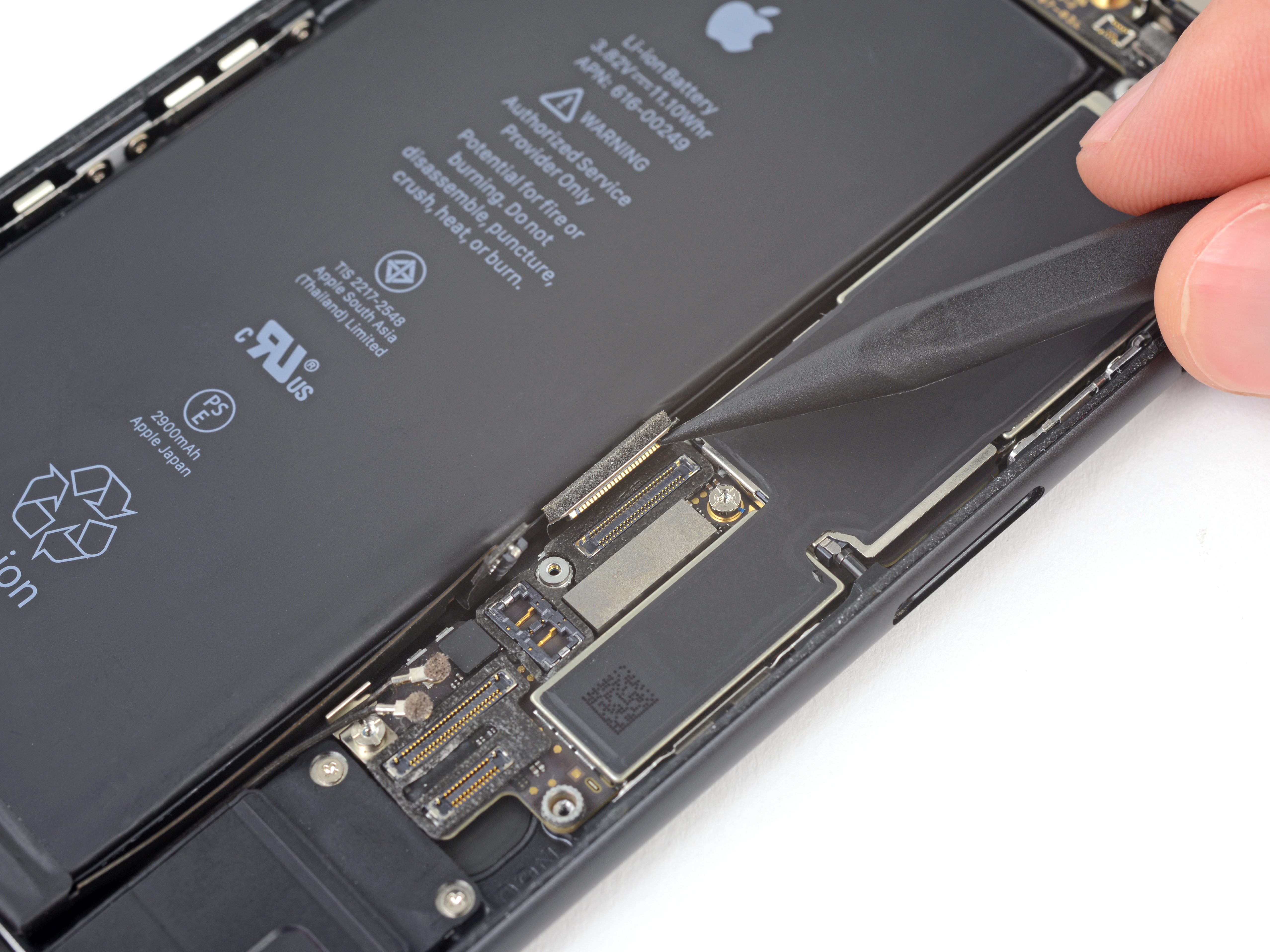

    1. iPhone 7 Plus Lightning Connector Assembly Replacement, Battery Disconnection: crwdns2935265:016crwdnd2935265:01crwdnd2935265:01crwdne2935265:0
      • Remove the following four tri-point Y000 screws securing the lower display cable bracket to the logic board:
      • Three 1.2 mm screws
      • One 2.6 mm screw
    2. iPhone 7 Plus Lightning Connector Assembly Replacement: crwdns2935265:017crwdnd2935265:01crwdnd2935265:02crwdne2935265:0 iPhone 7 Plus Lightning Connector Assembly Replacement: crwdns2935265:017crwdnd2935265:02crwdnd2935265:02crwdne2935265:0
      • Remove the lower display cable bracket.
    3. iPhone 7 Plus Lightning Connector Assembly Replacement: crwdns2935265:018crwdnd2935265:01crwdnd2935265:03crwdne2935265:0 iPhone 7 Plus Lightning Connector Assembly Replacement: crwdns2935265:018crwdnd2935265:02crwdnd2935265:03crwdne2935265:0 iPhone 7 Plus Lightning Connector Assembly Replacement: crwdns2935265:018crwdnd2935265:03crwdnd2935265:03crwdne2935265:0
      • Use the point of a spudger to lift the battery connector out of its socket on the logic board.
      • Bend the connector cable up slightly to prevent it from making contact with the socket and providing power to the phone.

      • Slide the flat edge of a spudger underneath the antenna flex cable to separate the adhesive holding it in place.
    11. iPhone 7 Plus Lightning Connector Assembly Replacement: crwdns2935265:039crwdnd2935265:01crwdnd2935265:03crwdne2935265:0 iPhone 7 Plus Lightning Connector Assembly Replacement: crwdns2935265:039crwdnd2935265:02crwdnd2935265:03crwdne2935265:0 iPhone 7 Plus Lightning Connector Assembly Replacement: crwdns2935265:039crwdnd2935265:03crwdnd2935265:03crwdne2935265:0
      • The screw boss at the top of the antenna flex cable is tucked into a small recess in the top edge of the iPhone.
      • Tilt the antenna flex cable up toward the top of the iPhone.
      • Slide the screw boss down and out of its recess.
