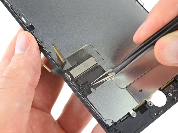

  33. iPhone 7 Plus LCD and Digitizer Replacement: crwdns2935265:033crwdnd2935265:01crwdnd2935265:01crwdne2935265:0
    • Continue using your spudger to carefully separate the last of the flex cable from the back of the display.
  34. iPhone 7 Plus LCD and Digitizer Replacement: crwdns2935265:034crwdnd2935265:01crwdnd2935265:03crwdne2935265:0 iPhone 7 Plus LCD and Digitizer Replacement: crwdns2935265:034crwdnd2935265:02crwdnd2935265:03crwdne2935265:0 iPhone 7 Plus LCD and Digitizer Replacement: crwdns2935265:034crwdnd2935265:03crwdnd2935265:03crwdne2935265:0
    • Remove the front camera and sensor cable assembly.
    • A piece of black double-sided insulating tape lies between the display and three rows of copper contacts on the back of the camera/sensor cable. It may remain stuck to the display, or it may come off with the cable.
    • When reassembling, verify the tape is in place, or else cover the contacts on the back of the cable with an appropriate tape, such as Kapton tape.
    Is there instruction on how to bend the cable?
    Steven Martinez - crwdns2934203:0crwdne2934203:0
    You really need that tape, If still no sound after placing the tape in place, then you might have damaged the flex cable. Worthy to mention, that some replacement screens come without the ambient light filter (white film seem on the screen) and without the plastic brackets for the camera and proximity sensor, which in those cases, you would have to transfer those parts to the new screen. Also in some screens, the holes for the proximity sensor are not properly done and you might end up with a non-working proximity sensor. In those cases, just remove the pain with the spugger where the proximity sensor locates (removes the black paint) and then add some black permanent marker over it to make it black. That way, it will look pristine form the outside but just thin enough for the proximity sensor to work.
    H. Alves - crwdns2934203:0crwdne2934203:0
    I had issues regarding sound after reassembling the iPhone. I initially used kapton tape. I could hear the caller but they could hear me. I checked every avenue I thought of, I recorded myself speaking which was fine so there was nothing wrong with the mic. I ended up heating the black insulator and transferring it and reseating the earpiece and flex assembly. After a couple attempts the mic was restored to normal operation.
    Paul Wilson - crwdns2934203:0crwdne2934203:0
    yeah the mic and the earpiece not working , what is the solution for this problem ?
    يوسف الريمي - crwdns2934203:0crwdne2934203:0
    Do not pull on the cable an be gentle with the heat. There is a potential that the cable, which is soldered together on this part.
    I had an issue with a costumers flex cable an the ear speaker stopped working bit the cable looked okay and I did not pull on it. So I used an soldering iron with a small tip, put some flux tape where the doubled-sided tape sits on the pads and soldered the cable back together at about 390 degrees celsius. It now works perfectly again.
    Raphael - crwdns2934203:0crwdne2934203:0
    After replacing screen, front camera doesn’t work. Replaced camera cable cable with a new cable; still no front camera. Rear camera works fine. Also, have a software “Home” button showing up. Finger Touch ID works and works as the Home button should as far as I can tell, How do I get rid of it?
    Kevin Reilly - crwdns2934203:0crwdne2934203:0
    So i had the same problem that the erapiece only is not working after replacement..
    my soulotion was to reassmble all the flat out the there is a black double sided tape that need to put exactly on the back of the golden points behind the flat.
    once the tape back on those golden tips it should work properly
    aviel3019 - crwdns2934203:0crwdne2934203:0
    Another thing to be careful of is the area where the black tape sits is actually two pieces of cable that are glued together and are connected by about 15 tiny contacts.
    I must have heated the cable too much and ended up separating these two layers when prying… I put them back together but it must have not been lined up correctly as the proximity sensor and earpiece speaker did not work (the parts on the layer that came off), whereas the front camera did as that is on the same layer as the camera and was therefore intact.
    I may attempt to re align the connectors again but I feel as though a replacement flex assembly may be the more appropriate solution!
    I admit that this is my fault for overheating the component and not taking enough care, but what a weird design! Why couldn’t it have been one whole cable?
    Ed Beckett - crwdns2934203:0crwdne2934203:0
    Did the replacement flex fix this issue?
    Danielle Lewis -
    is it okay to use electric tape in that case to cover the copper pieces? i installed everthing and the front camera works and the speaker works just when i make a call it turns off.. any recommendations?
    3dvapeandsmoke - crwdns2934203:0crwdne2934203:0
    why wouldnt it come with the tape on already? Im about to put electric tape because i dont have anything else.
    Anthony Fieno - crwdns2934203:0crwdne2934203:0
    なぜiPhone7Plusのフロントカメラフレックスケーブルには裏面に金属端子のような部分があるのでしょうか?
    iPhone7やiPhone8にはこの部分がありませんが必要な役割がありますか?
    bakkas-3.30 - crwdns2934203:0crwdne2934203:0
    After replacing iPhone 7+ screen I can’t call out or answer calls everything else works cleaned contacts with alcohol wipes put it back together and same thing the time is right I even updated the os since installing the new screen but phone reboots every time a call comes in or I dial out any suggestions
    wachteldane69 - crwdns2934203:0crwdne2934203:0

  42. iPhone 7 Plus LCD and Digitizer Replacement, LCD and Digitizer: crwdns2935265:042crwdnd2935265:01crwdnd2935265:03crwdne2935265:0 iPhone 7 Plus LCD and Digitizer Replacement, LCD and Digitizer: crwdns2935265:042crwdnd2935265:02crwdnd2935265:03crwdne2935265:0 iPhone 7 Plus LCD and Digitizer Replacement, LCD and Digitizer: crwdns2935265:042crwdnd2935265:03crwdnd2935265:03crwdne2935265:0
    • Peel back the upper, rectangular portion of the LCD shield plate sticker to separate it from the flex cable underneath.
    • You don't need to remove the sticker completely unless you intend to replace it.
