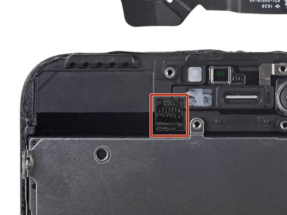

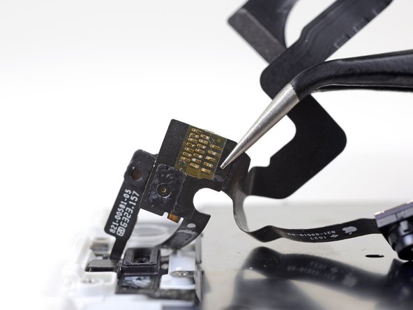

    7. iPhone 7 Plus Front Camera and Sensor Cable Replacement: crwdns2935265:033crwdnd2935265:01crwdnd2935265:03crwdne2935265:0 iPhone 7 Plus Front Camera and Sensor Cable Replacement: crwdns2935265:033crwdnd2935265:02crwdnd2935265:03crwdne2935265:0 iPhone 7 Plus Front Camera and Sensor Cable Replacement: crwdns2935265:033crwdnd2935265:03crwdnd2935265:03crwdne2935265:0
      • Remove the front camera and sensor cable assembly.
      • A piece of black double-sided insulating tape lies between the display and three rows of copper contacts on the back of the camera/sensor cable. It may remain stuck to the display, or it may come off with the cable.
      • When reassembling, verify the tape is in place, or else cover the contacts on the back of the cable with an appropriate tape, such as Kapton tape.
