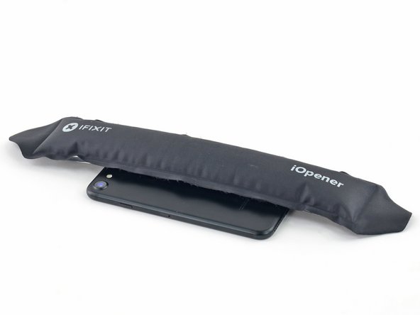

      • Heat an iOpener and thread it through the arms of the Anti-Clamp.
      • You can also use a hair dryer, heat gun, or hot plate—but extreme heat can damage the display and/or internal battery, so proceed with care.
      • Fold the iOpener so it lays on the bottom edge of the iPhone.
      • Wait one minute to give the adhesive a chance to release and present an opening gap.
      • Insert an opening pick into the gap.
      • If the Anti-Clamp doesn't create a sufficient gap, apply more heat to the area and rotate the handle a quarter turn.
      • Don't crank more than a quarter turn at a time, and wait one minute between turns. Let the Anti-Clamp and time do the work for you.
      • Skip the next three steps.

      • Apply a heated iOpener to the bottom edge of the screen for two minutes. This softens the adhesive securing it.
      • Alternatively, you can use a hair dryer or heat gun to heat the bottom half of the screen until it’s slightly too hot to touch
