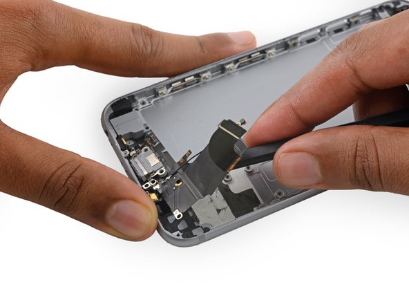

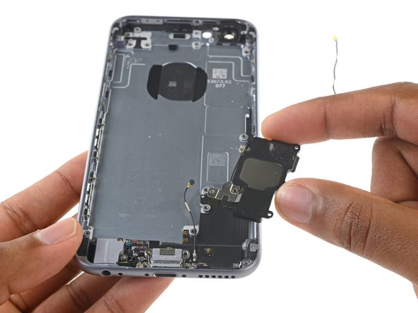

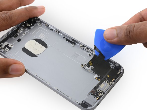

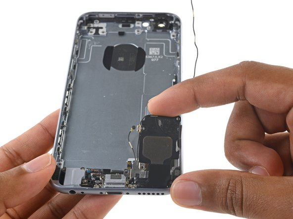

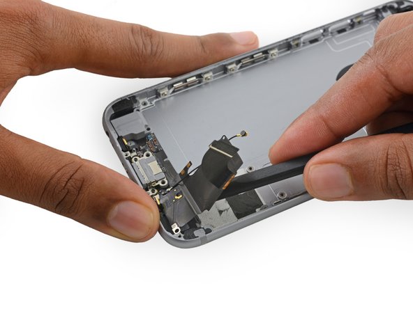

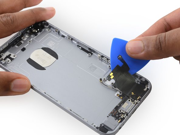

      • Use the flat end of a spudger to disconnect the audio control cable from its socket on the logic board.
    6. iPhone 6s Rear Case Replacement: crwdns2935265:037crwdnd2935265:01crwdnd2935265:02crwdne2935265:0 iPhone 6s Rear Case Replacement: crwdns2935265:037crwdnd2935265:02crwdnd2935265:02crwdne2935265:0

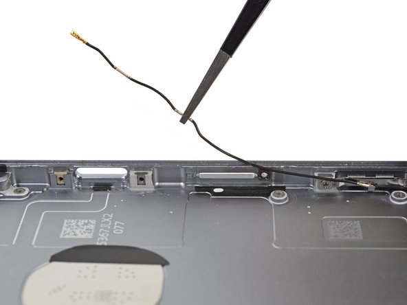

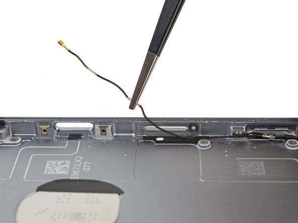

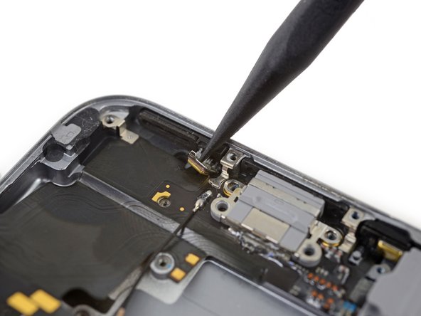

      • Use the pointed tip of a spudger to disconnect the antenna cable from its socket on the upper right corner of the logic board.
    7. iPhone 6s Rear Case Replacement: crwdns2935265:038crwdnd2935265:01crwdnd2935265:02crwdne2935265:0 iPhone 6s Rear Case Replacement: crwdns2935265:038crwdnd2935265:02crwdnd2935265:02crwdne2935265:0
      • Use the pointed tip of a spudger to disconnect the antenna cable from its socket on the lower left corner of the logic board.

      • Remove the 1.3 mm Phillips screw securing the NFC bracket to the logic board.
    11. iPhone 6s Rear Case Replacement: crwdns2935265:042crwdnd2935265:01crwdnd2935265:02crwdne2935265:0 iPhone 6s Rear Case Replacement: crwdns2935265:042crwdnd2935265:02crwdnd2935265:02crwdne2935265:0
      • Remove the NFC bracket.

    11. iPhone 6s Rear Case Replacement: crwdns2935265:057crwdnd2935265:01crwdnd2935265:02crwdne2935265:0 iPhone 6s Rear Case Replacement: crwdns2935265:057crwdnd2935265:02crwdnd2935265:02crwdne2935265:0
      • Slide an opening pick between the upper component cable and the rear case.
      • Gently separate the cable from the rear case.
    12. iPhone 6s Rear Case Replacement: crwdns2935265:058crwdnd2935265:01crwdnd2935265:02crwdne2935265:0 iPhone 6s Rear Case Replacement: crwdns2935265:058crwdnd2935265:02crwdnd2935265:02crwdne2935265:0
      • Continue pushing the opening pick under the cable until it fully separates from the rear case.

    1. iPhone 6s Rear Case Replacement, Rear Case: crwdns2935265:063crwdnd2935265:01crwdnd2935265:03crwdne2935265:0 iPhone 6s Rear Case Replacement, Rear Case: crwdns2935265:063crwdnd2935265:02crwdnd2935265:03crwdne2935265:0 iPhone 6s Rear Case Replacement, Rear Case: crwdns2935265:063crwdnd2935265:03crwdnd2935265:03crwdne2935265:0
      • Deroute the antenna cable from its rubber sleeve on the right edge of the rear case.
    2. iPhone 6s Rear Case Replacement: crwdns2935265:064crwdnd2935265:01crwdnd2935265:01crwdne2935265:0
      • Remove the antenna cable from the metal clip on the right edge of the rear case.

    4. iPhone 6s Rear Case Replacement: crwdns2935265:066crwdnd2935265:01crwdnd2935265:03crwdne2935265:0 iPhone 6s Rear Case Replacement: crwdns2935265:066crwdnd2935265:02crwdnd2935265:03crwdne2935265:0 iPhone 6s Rear Case Replacement: crwdns2935265:066crwdnd2935265:03crwdnd2935265:03crwdne2935265:0
      • Use your fingers to lift the speaker out of its housing in the rear case.
      • Remove the speaker assembly.

    7. iPhone 6s Rear Case Replacement: crwdns2935265:069crwdnd2935265:01crwdnd2935265:03crwdne2935265:0 iPhone 6s Rear Case Replacement: crwdns2935265:069crwdnd2935265:02crwdnd2935265:03crwdne2935265:0 iPhone 6s Rear Case Replacement: crwdns2935265:069crwdnd2935265:03crwdnd2935265:03crwdne2935265:0
      • Insert an opening pick between the Lightning connector assembly and the rear case to begin breaking up the adhesive holding the flex cable in place.
    8. iPhone 6s Rear Case Replacement: crwdns2935265:070crwdnd2935265:01crwdnd2935265:03crwdne2935265:0 iPhone 6s Rear Case Replacement: crwdns2935265:070crwdnd2935265:02crwdnd2935265:03crwdne2935265:0 iPhone 6s Rear Case Replacement: crwdns2935265:070crwdnd2935265:03crwdnd2935265:03crwdne2935265:0
      • Use the flat end of a spudger to continue separating the Lightning connector assembly from the rear case.
