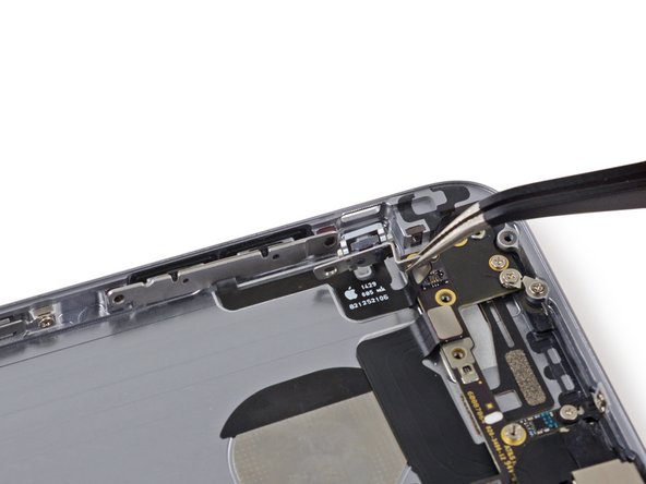

    • Remove the following four Phillips #00 screws from the contact bracket:
    • One 1.5 mm screw
    • One 1.4 mm screw
    • Two 2.1 mm screws
  27. iPhone 6 Volume Control Cable Replacement: crwdns2935265:027crwdnd2935265:01crwdnd2935265:02crwdne2935265:0 iPhone 6 Volume Control Cable Replacement: crwdns2935265:027crwdnd2935265:02crwdnd2935265:02crwdne2935265:0
    • Remove the contact bracket from the iPhone.

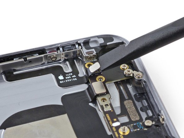

  28. iPhone 6 Volume Control Cable Replacement: crwdns2935265:028crwdnd2935265:01crwdnd2935265:02crwdne2935265:0 iPhone 6 Volume Control Cable Replacement: crwdns2935265:028crwdnd2935265:02crwdnd2935265:02crwdne2935265:0
    • Use the flat end of a spudger to lift the volume control cable connector up off of its socket.
    • Only pry up on the connector, not the socket on the logic board or you risk permanent damage.
    I wished I removed the Orange Screw from the next step, BEFORE, I removed this connector, as I used a screwdriver without being careful enough and accidentally crushed the socket below this connector. At least I would have had half a chance. Managed to get the new connector on and amazingly the mute works but no more vol up or down :-(
