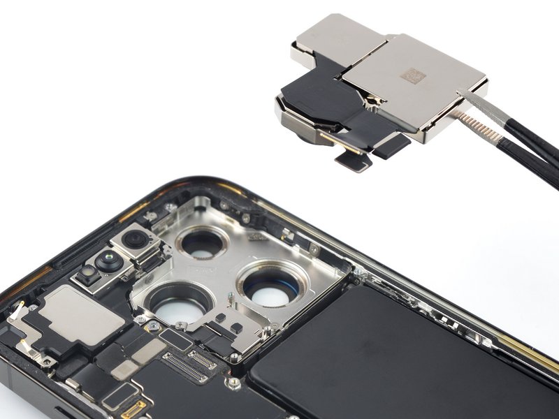

Use this guide to replace the rear camera assembly in an iPhone 14 Pro.
This guide was created using the A2890 (international) model. If you're fixing a different iPhone 14 Pro model, there may be some visual discrepancies, but the procedure should be the same.
Note: On iOS 18 and newer, you can calibrate new, genuine camera modules using Apple's Repair Assistant.
You’ll need replacement adhesive to safely secure the screen when reassembling your iPhone. Retaining water resistance after the repair will depend on how well you reapply the screen adhesive, but note that your device will lose its official IP (Ingress Protection) rating.

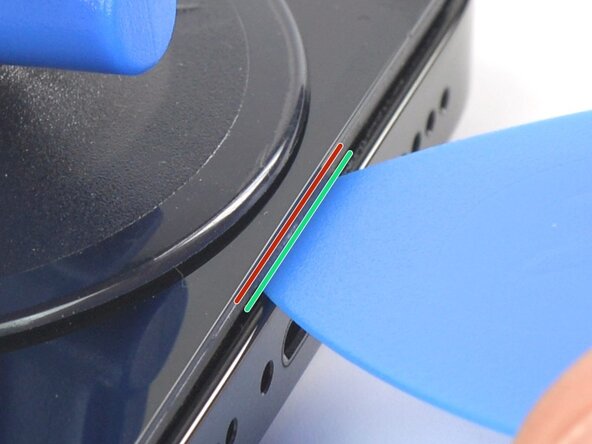

    2. iPhone 14 Pro Rear Camera Assembly Replacement, Screen damage warning: crwdns2935265:04crwdnd2935265:01crwdnd2935265:03crwdne2935265:0 iPhone 14 Pro Rear Camera Assembly Replacement, Screen damage warning: crwdns2935265:04crwdnd2935265:02crwdnd2935265:03crwdne2935265:0 iPhone 14 Pro Rear Camera Assembly Replacement, Screen damage warning: crwdns2935265:04crwdnd2935265:03crwdnd2935265:03crwdne2935265:0
      • To avoid damaging your screen in the next steps, note the following:
      • There's a plastic bezel on the underside of the screen. Your opening pick will go underneath this bezel.
      • There's a seam between the plastic bezel and the display panel. Don't insert your pick here or you'll damage the screen.
      • Sometimes the display panel separates from the bezel before you even get a chance to insert a pick. This may be unavoidable depending on the condition of the adhesive. In this case, you’ll most likely need to replace your entire screen.

    7. iPhone 14 Pro Rear Camera Assembly Replacement, Insert an opening pick: crwdns2935265:09crwdnd2935265:01crwdnd2935265:03crwdne2935265:0 iPhone 14 Pro Rear Camera Assembly Replacement, Insert an opening pick: crwdns2935265:09crwdnd2935265:02crwdnd2935265:03crwdne2935265:0 iPhone 14 Pro Rear Camera Assembly Replacement, Insert an opening pick: crwdns2935265:09crwdnd2935265:03crwdnd2935265:03crwdne2935265:0
      • Apply a suction handle to the bottom edge of the screen, while avoiding the very edge of the glass.
      • Pull up on the suction cup with firm, constant pressure to create a slight gap between the screen and the frame.
      • Insert an opening pick into the gap under the screen's plastic bezel.
      • The watertight adhesive holding the screen in place is very strong; creating this initial gap takes a significant amount of force. If you're having a hard time opening a gap, apply more heat, and gently rock the screen up and down to weaken the adhesive until you create enough of a gap to insert your tool.

    1. iPhone 14 Pro Rear Camera Assembly Replacement, Remove the rear camera assembly cover screws: crwdns2935265:023crwdnd2935265:01crwdnd2935265:01crwdne2935265:0
      • Use a tri‑point Y000 driver to remove the five screws securing the rear camera assembly cover:
      • Four 1.5 mm‑long Y000 screws
      • One 1.3 mm‑long Y000 screw
      • Use a Phillips screwdriver to remove one 1.7mm‑long screw.
    2. iPhone 14 Pro Rear Camera Assembly Replacement, Remove the rear camera assembly cover: crwdns2935265:024crwdnd2935265:01crwdnd2935265:03crwdne2935265:0 iPhone 14 Pro Rear Camera Assembly Replacement, Remove the rear camera assembly cover: crwdns2935265:024crwdnd2935265:02crwdnd2935265:03crwdne2935265:0 iPhone 14 Pro Rear Camera Assembly Replacement, Remove the rear camera assembly cover: crwdns2935265:024crwdnd2935265:03crwdnd2935265:03crwdne2935265:0
      • There's a small metal edge in the top right corner of the rear camera assembly cover that is secured by the phone frame.
      • Grab the rear camera assembly cover with a pair of tweezers.
      • Move the rear camera assembly cover toward the volume buttons to free its small metal edge from the frame.
      • Remove the rear camera assembly cover.
      • During reassembly, make sure to align the rear camera assembly cover correctly and push the small metal edge back into its recess in the frame.
    3. iPhone 14 Pro Rear Camera Assembly Replacement, Disconnect the ultra wide and telephoto camera cable: crwdns2935265:025crwdnd2935265:01crwdnd2935265:02crwdne2935265:0 iPhone 14 Pro Rear Camera Assembly Replacement, Disconnect the ultra wide and telephoto camera cable: crwdns2935265:025crwdnd2935265:02crwdnd2935265:02crwdne2935265:0
      • Use a spudger to disconnect the ultra wide and telephoto lens cable by prying the connector straight up from its socket.
    4. iPhone 14 Pro Rear Camera Assembly Replacement, Disconnect the wide lens camera cable: crwdns2935265:026crwdnd2935265:01crwdnd2935265:02crwdne2935265:0 iPhone 14 Pro Rear Camera Assembly Replacement, Disconnect the wide lens camera cable: crwdns2935265:026crwdnd2935265:02crwdnd2935265:02crwdne2935265:0
      • Use a spudger to disconnect the wide lens cable by prying the connector straight up from its socket.
    5. iPhone 14 Pro Rear Camera Assembly Replacement, Pry up the rear camera assembly: crwdns2935265:027crwdnd2935265:01crwdnd2935265:02crwdne2935265:0 iPhone 14 Pro Rear Camera Assembly Replacement, Pry up the rear camera assembly: crwdns2935265:027crwdnd2935265:02crwdnd2935265:02crwdne2935265:0
      • Insert the pointed end of a spudger underneath the bottom edge of the rear camera assembly.
      • Pry up with the spudger to loosen the rear camera assembly.
    6. iPhone 14 Pro Rear Camera Assembly Replacement, Remove the rear camera assembly: crwdns2935265:028crwdnd2935265:01crwdnd2935265:02crwdne2935265:0 iPhone 14 Pro Rear Camera Assembly Replacement, Remove the rear camera assembly: crwdns2935265:028crwdnd2935265:02crwdnd2935265:02crwdne2935265:0
      • Use a pair of tweezers or your fingers to remove the rear camera assembly.
