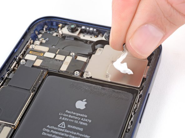

    18. iPhone 12 Battery Replacement, Unscrew the battery and display connector cover: crwdns2935265:022crwdnd2935265:01crwdnd2935265:01crwdne2935265:0
      Magnetic Project Mat
      $19.95
      • Remove two 1.1 mm long Y000 screws securing the battery and display connector cover.
      • Throughout this repair, keep track of each screw and make sure it goes back exactly where it came from to avoid damaging your iPhone.
      • During reassembly, this is a good point to power on your iPhone and test all functions before you seal the display in place. Be sure to power your iPhone back down completely before you continue working.

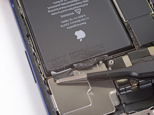

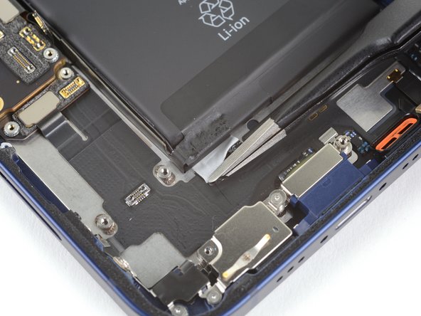

    20. iPhone 12 Battery Replacement, Disconnect the battery: crwdns2935265:024crwdnd2935265:01crwdnd2935265:02crwdne2935265:0 iPhone 12 Battery Replacement, Disconnect the battery: crwdns2935265:024crwdnd2935265:02crwdnd2935265:02crwdne2935265:0
      • Use a spudger or a clean fingernail to pry the battery connector up from its socket on the logic board.
      • Try not to damage the black silicone seal surrounding this and other board connections. These seals provide extra protection against water and dust intrusion.
      • Bend the connector slightly away from the logic board to prevent it from accidentally making contact with the socket and providing power to the phone during your repair.

    24. iPhone 12 Battery Replacement, Remove the front sensor connector cover: crwdns2935265:028crwdnd2935265:01crwdnd2935265:03crwdne2935265:0 iPhone 12 Battery Replacement, Remove the front sensor connector cover: crwdns2935265:028crwdnd2935265:02crwdnd2935265:03crwdne2935265:0 iPhone 12 Battery Replacement, Remove the front sensor connector cover: crwdns2935265:028crwdnd2935265:03crwdnd2935265:03crwdne2935265:0
      • Swing the cover up from the left until the small clip on the right unhooks.
      • Remove the cover.
      • During reassembly, insert the clip on the right edge into its slot first, then hinge the rest of the cover into place.

    1. iPhone 12 Battery Replacement, Locate the adhesive pull-tabs: crwdns2935265:043crwdnd2935265:01crwdnd2935265:03crwdne2935265:0 iPhone 12 Battery Replacement, Locate the adhesive pull-tabs: crwdns2935265:043crwdnd2935265:02crwdnd2935265:03crwdne2935265:0 iPhone 12 Battery Replacement, Locate the adhesive pull-tabs: crwdns2935265:043crwdnd2935265:03crwdnd2935265:03crwdne2935265:0
      • The battery is secured to the rear case with four pieces of stretch-release adhesive—two on the bottom edge of the battery, and two on the top edge.
      • Each piece of adhesive has a black pull-tab at the end, which is lightly adhered to the edge of the battery.
      • In the following steps, you'll pull each tab to slowly stretch out the adhesive underneath the battery. These "command-strip" style adhesives lose their stick when stretched, so you can remove the battery with ease.
      • If the strips break, don't panic! They don't always work as intended. Keep reading for tips on removing broken strips.
    2. iPhone 12 Battery Replacement, Remove the stretch-release adhesive: crwdns2935265:044crwdnd2935265:01crwdnd2935265:02crwdne2935265:0 iPhone 12 Battery Replacement, Remove the stretch-release adhesive: crwdns2935265:044crwdnd2935265:02crwdnd2935265:02crwdne2935265:0
      • Peel down the first battery adhesive pull-tab to un-stick it from the bottom edge of the battery.
      • Caution: Don't jab the battery with any sharp tools. A punctured battery may leak dangerous chemicals or catch fire.

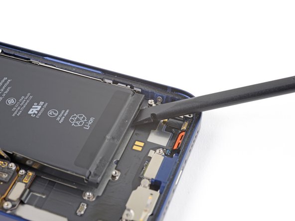

    3. iPhone 12 Battery Replacement: crwdns2935265:045crwdnd2935265:01crwdnd2935265:02crwdne2935265:0 iPhone 12 Battery Replacement: crwdns2935265:045crwdnd2935265:02crwdnd2935265:02crwdne2935265:0
      • Peel down the second battery adhesive pull-tab to un-stick it from the bottom edge of the battery.

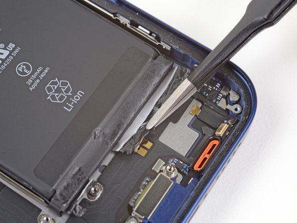

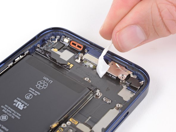

    4. iPhone 12 Battery Replacement: crwdns2935265:046crwdnd2935265:01crwdnd2935265:03crwdne2935265:0 iPhone 12 Battery Replacement: crwdns2935265:046crwdnd2935265:02crwdnd2935265:03crwdne2935265:0 iPhone 12 Battery Replacement: crwdns2935265:046crwdnd2935265:03crwdnd2935265:03crwdne2935265:0
      • Grab the first pull-tab with your fingers and slowly pull it away from the battery, toward the bottom of the iPhone.
      • Pull hard enough to maintain tension on the strip, but don't force it. Give it plenty of time to stretch and un-stick from under the battery.
      • Don't press down on the battery. Hold the iPhone firmly by its sides.
      • Keep the strip flat and unwrinkled. Try to pull evenly on the whole strip, rather than pulling mainly in the middle or on one side.
      • Pull at a low angle so the strip doesn't snag on the edge of the battery.
      • If the adhesive strip breaks off, try to retrieve it using your fingers or blunt tweezers, and continue pulling—but do not pry under the battery.
      • If any of the adhesive strips break off underneath the battery and can't be retrieved, try to remove the other strips, and then proceed as instructed below.

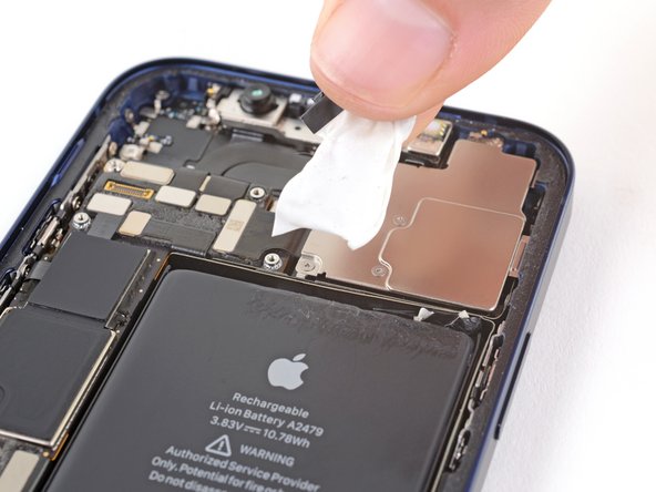

    5. iPhone 12 Battery Replacement: crwdns2935265:047crwdnd2935265:01crwdnd2935265:03crwdne2935265:0 iPhone 12 Battery Replacement: crwdns2935265:047crwdnd2935265:02crwdnd2935265:03crwdne2935265:0 iPhone 12 Battery Replacement: crwdns2935265:047crwdnd2935265:03crwdnd2935265:03crwdne2935265:0
      • Grab the second pull-tab with your fingers and pull it away from the battery, toward the bottom of the iPhone.
      • Follow the same procedure as with the previous strip: don't press down on the battery, keep the strip flat and unwrinkled, and pull at a low angle.
      • If the adhesive breaks off underneath the battery and can't be retrieved, continue with the next step.
    6. iPhone 12 Battery Replacement: crwdns2935265:048crwdnd2935265:01crwdnd2935265:03crwdne2935265:0 iPhone 12 Battery Replacement: crwdns2935265:048crwdnd2935265:02crwdnd2935265:03crwdne2935265:0 iPhone 12 Battery Replacement: crwdns2935265:048crwdnd2935265:03crwdnd2935265:03crwdne2935265:0

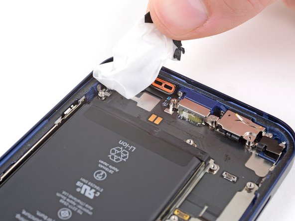

      • Peel up the two remaining battery adhesive pull-tabs to un-stick them from the top edge of the battery.
    7. iPhone 12 Battery Replacement: crwdns2935265:049crwdnd2935265:01crwdnd2935265:03crwdne2935265:0 iPhone 12 Battery Replacement: crwdns2935265:049crwdnd2935265:02crwdnd2935265:03crwdne2935265:0 iPhone 12 Battery Replacement: crwdns2935265:049crwdnd2935265:03crwdnd2935265:03crwdne2935265:0
      • Using the same procedure as before, pull the remaining two tabs, one at a time, to stretch and remove the remaining adhesive strip holding the battery in place. Try not to snag the adhesive on anything.
      • Be careful not to fling the battery from the iPhone as the final adhesive strip comes out.
      • If you removed all the adhesive strips successfully, skip the next step.
      • Otherwise, continue with the next step below.
    8. iPhone 12 Battery Replacement, How to remove a stuck battery: crwdns2935265:050crwdnd2935265:01crwdnd2935265:02crwdne2935265:0 iPhone 12 Battery Replacement, How to remove a stuck battery: crwdns2935265:050crwdnd2935265:02crwdnd2935265:02crwdne2935265:0
      • If you're still having trouble removing the battery, apply a few drops of high concentration (over 90%) isopropyl alcohol under the edge of the battery in the area of the broken adhesive strip(s).
      • Wait about one minute for the alcohol solution to weaken the adhesive.
      • Use an opening pick or the flat end of a spudger to gently lift the battery.
      • Don't try to forcefully lever the battery out. If needed, apply a few more drops of alcohol to further weaken the adhesive. Never deform or puncture the battery with your pry tool.
    9. iPhone 12 Battery Replacement, Remove the battery: crwdns2935265:051crwdnd2935265:01crwdnd2935265:01crwdne2935265:0
      • Remove the battery.
      • If there's any alcohol solution remaining in the phone, carefully wipe it off or allow it to air dry before installing your new battery.
      • If your new battery didn't come with adhesive preinstalled, refer to this guide for help replacing the adhesive strips.
      • Perform a force restart after reassembly. This can prevent several issues and simplify troubleshooting.
