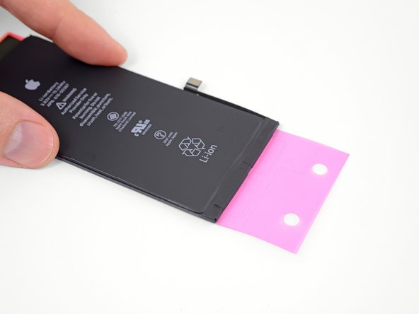

      • If your new battery came with adhesive strips already installed, skip to Step 8.
      • Otherwise, peel off the large blue plastic liner from your new set of adhesive strips, and discard it.
      • Once the adhesive is exposed, be careful not to touch it.
    2. iPhone Battery Adhesive Strips Replacement: crwdns2935265:02crwdnd2935265:01crwdnd2935265:02crwdne2935265:0 iPhone Battery Adhesive Strips Replacement: crwdns2935265:02crwdnd2935265:02crwdnd2935265:02crwdne2935265:0
      • Once the adhesive sticks to the battery, you can't peel it off or reposition it—if you make a mistake, you'll have to start over with fresh adhesive strips.
      • Double-check the orientation of the adhesive strips, and then stick them to the back side of your new battery.
      • Make sure the two shorter strips are nearest the battery cable connector.
      • Center the strips so that the two pairs of black tabs protrude evenly from each side of the battery.

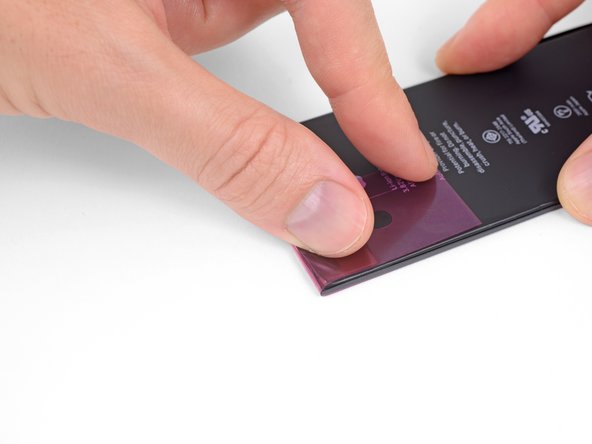

      • Flip the battery over, then peel away and discard the two blue plastic liners covering the ends of the adhesive strips.
    5. iPhone Battery Adhesive Strips Replacement: crwdns2935265:05crwdnd2935265:01crwdnd2935265:03crwdne2935265:0 iPhone Battery Adhesive Strips Replacement: crwdns2935265:05crwdnd2935265:02crwdnd2935265:03crwdne2935265:0 iPhone Battery Adhesive Strips Replacement: crwdns2935265:05crwdnd2935265:03crwdnd2935265:03crwdne2935265:0

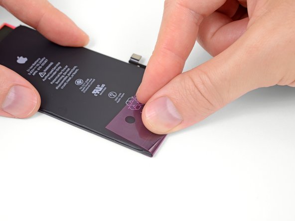

      • Grab the pink plastic liner at the bottom edge of the battery, and gently pull it taut.
      • Fold the liner over onto the battery and press down.
      • Let go of the liner, and the two black ends of the adhesive strips should remain stuck to the bottom edge of the battery.
    6. iPhone Battery Adhesive Strips Replacement: crwdns2935265:06crwdnd2935265:01crwdnd2935265:03crwdne2935265:0 iPhone Battery Adhesive Strips Replacement: crwdns2935265:06crwdnd2935265:02crwdnd2935265:03crwdne2935265:0 iPhone Battery Adhesive Strips Replacement: crwdns2935265:06crwdnd2935265:03crwdnd2935265:03crwdne2935265:0
      • Repeat the previous step to adhere the ends of the two remaining strips at the top edge of the battery.
    7. iPhone Battery Adhesive Strips Replacement: crwdns2935265:07crwdnd2935265:01crwdnd2935265:02crwdne2935265:0 iPhone Battery Adhesive Strips Replacement: crwdns2935265:07crwdnd2935265:02crwdnd2935265:02crwdne2935265:0
      • Peel away and discard the small orange release liner covering the ends of the adhesive strips at the top of the battery.

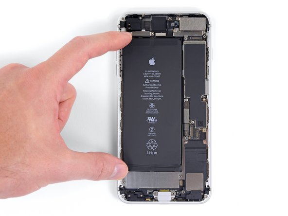

      • With the large pink release liner still in place, set the battery into your iPhone.
    9. iPhone Battery Adhesive Strips Replacement: crwdns2935265:09crwdnd2935265:01crwdnd2935265:03crwdne2935265:0 iPhone Battery Adhesive Strips Replacement: crwdns2935265:09crwdnd2935265:02crwdnd2935265:03crwdne2935265:0 iPhone Battery Adhesive Strips Replacement: crwdns2935265:09crwdnd2935265:03crwdnd2935265:03crwdne2935265:0
      • Line up the battery connector and press it into place.

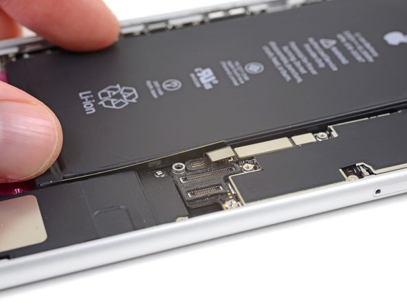

      • Lifting from the outside edge, tilt the battery onto its side so you can access the final release liner.
      • Leave the battery connected to the logic board to help keep it positioned correctly.
    11. iPhone Battery Adhesive Strips Replacement: crwdns2935265:011crwdnd2935265:01crwdnd2935265:03crwdne2935265:0 iPhone Battery Adhesive Strips Replacement: crwdns2935265:011crwdnd2935265:02crwdnd2935265:03crwdne2935265:0 iPhone Battery Adhesive Strips Replacement: crwdns2935265:011crwdnd2935265:03crwdnd2935265:03crwdne2935265:0
      • Peel away the final, large, pink release liner and discard it.
    12. iPhone Battery Adhesive Strips Replacement: crwdns2935265:012crwdnd2935265:01crwdnd2935265:02crwdne2935265:0 iPhone Battery Adhesive Strips Replacement: crwdns2935265:012crwdnd2935265:02crwdnd2935265:02crwdne2935265:0
      • Carefully position the battery and set it into the iPhone.
    13. iPhone Battery Adhesive Strips Replacement: crwdns2935265:013crwdnd2935265:01crwdnd2935265:02crwdne2935265:0 iPhone Battery Adhesive Strips Replacement: crwdns2935265:013crwdnd2935265:02crwdnd2935265:02crwdne2935265:0
      • Press the top and bottom areas of the battery firmly into place, allowing the adhesive strips to stick to the rear case.
