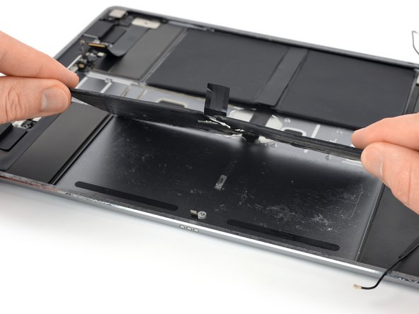

    23. iPad Pro 12.9" 2nd Gen Battery Replacement, Lift the display: crwdns2935265:024crwdnd2935265:01crwdnd2935265:03crwdne2935265:0 iPad Pro 12.9" 2nd Gen Battery Replacement, Lift the display: crwdns2935265:024crwdnd2935265:02crwdnd2935265:03crwdne2935265:0 iPad Pro 12.9" 2nd Gen Battery Replacement, Lift the display: crwdns2935265:024crwdnd2935265:03crwdnd2935265:03crwdne2935265:0
      • The iPad shown in the following two steps is the iPad Pro 12.9" 1st Generation. The internals look slightly different but the taping procedure is the same.
      • The display cables in this iPad are very short. Read the next two steps before you proceed.
      • Do not pivot the screen about the lower edge. The display cables don't have enough slack to allow for this and will tear if you do not slide the screen towards the front-facing camera as you lift.
      • The display cables will tear if you raise the screen more than 90º.
      • Lift up the upper edge of the screen and slide the entire screen towards the front-facing camera to access the iPad's internal components.
      • Use masking tape to tape the lower edge of the screen to the frame to prevent the screen from slipping.
    24. iPad Pro 12.9" 2nd Gen Battery Replacement, Prop up the screen: crwdns2935265:025crwdnd2935265:01crwdnd2935265:03crwdne2935265:0 iPad Pro 12.9" 2nd Gen Battery Replacement, Prop up the screen: crwdns2935265:025crwdnd2935265:02crwdnd2935265:03crwdne2935265:0 iPad Pro 12.9" 2nd Gen Battery Replacement, Prop up the screen: crwdns2935265:025crwdnd2935265:03crwdnd2935265:03crwdne2935265:0
      • This step shows one way to support the screen using masking tape. You can also turn the iPad sideways. Make sure not to strain the display cables with whatever method you choose.
      • Attach a long strip of masking tape to the top edge of the screen. Fold the tape over the edge and make sure that the tape is attached securely.
      • Attach the other end of the strip to the bottom edge of the iPad frame to hold the screen at an angle. Make sure the tape attaches securely to the frame.

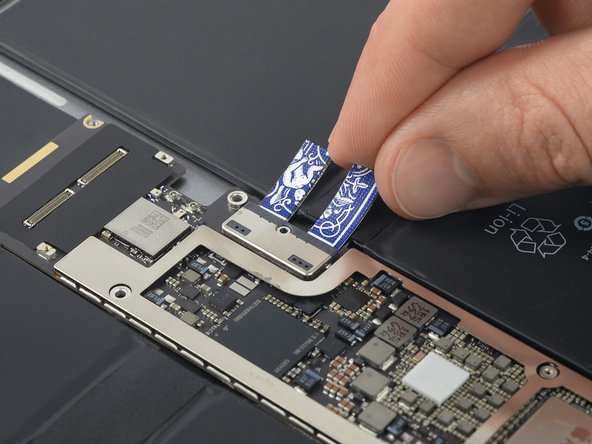

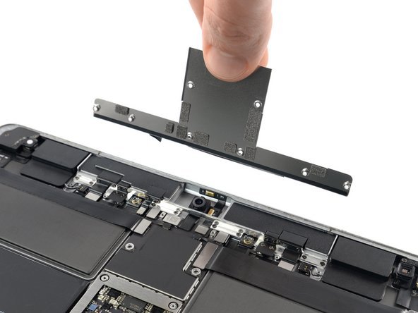

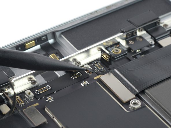

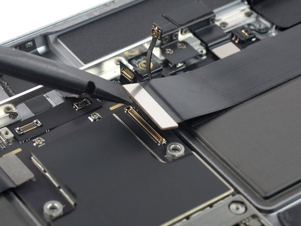

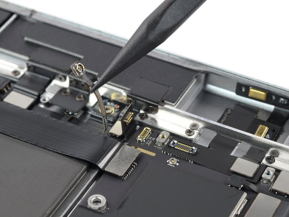

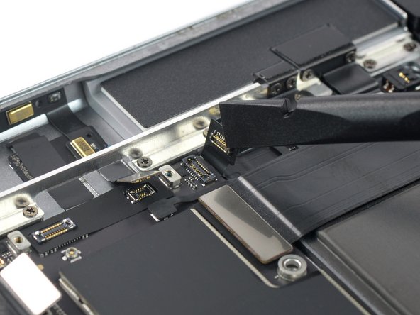

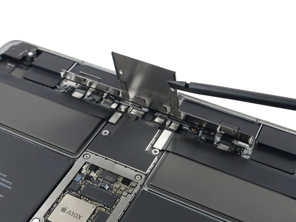

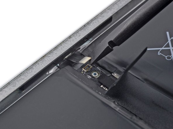

    25. iPad Pro 12.9" 2nd Gen Battery Replacement, Unfasten the logic board EMI shield screws: crwdns2935265:026crwdnd2935265:01crwdnd2935265:02crwdne2935265:0 iPad Pro 12.9" 2nd Gen Battery Replacement, Unfasten the logic board EMI shield screws: crwdns2935265:026crwdnd2935265:02crwdnd2935265:02crwdne2935265:0
      • It's important to disconnect the battery before you proceed further. Detaching or connecting the display cables with the battery plugged in can cause a short that will destroy touchscreen functionality.
      • Use a Phillips screwdriver to remove the six screws securing the logic board EMI shield:
      • Two 2.4 mm-long screws
      • Four 1.2 mm-long screws

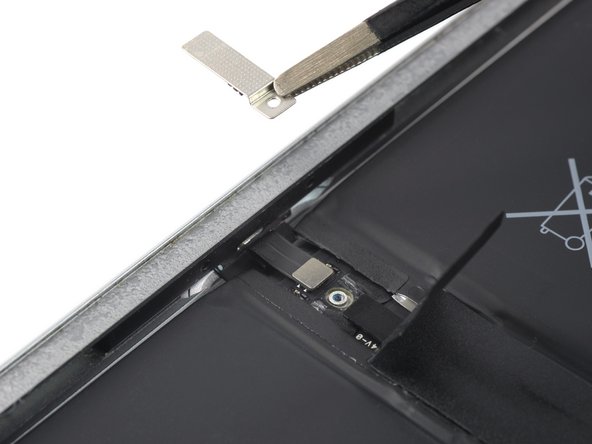

    26. iPad Pro 12.9" 2nd Gen Battery Replacement, Remove the logic board EMI shield: crwdns2935265:027crwdnd2935265:01crwdnd2935265:03crwdne2935265:0 iPad Pro 12.9" 2nd Gen Battery Replacement, Remove the logic board EMI shield: crwdns2935265:027crwdnd2935265:02crwdnd2935265:03crwdne2935265:0 iPad Pro 12.9" 2nd Gen Battery Replacement, Remove the logic board EMI shield: crwdns2935265:027crwdnd2935265:03crwdnd2935265:03crwdne2935265:0
      • Lift the logic board EMI shield from the edge nearest the top of the iPad.
      • Peel up the EMI shield from the logic board.
      • This takes a bit of force due to the many tiny clips securing the shield, and the shield may deform slightly. That's okay—try to keep the deformation to a minimum, and it will lay flat when you reinstall it and screw it down.
      • Remove the logic board EMI shield.

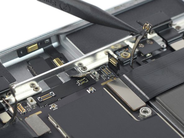

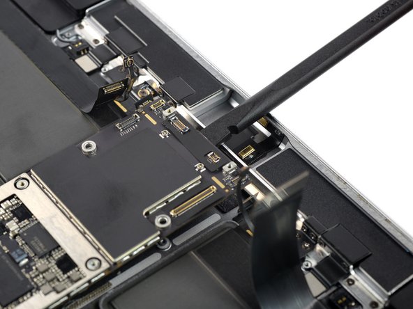

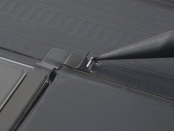

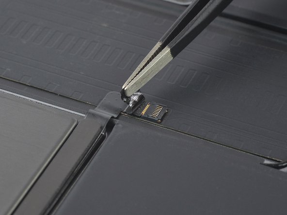

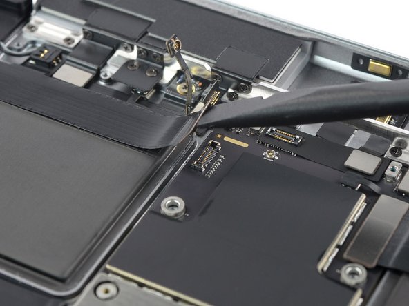

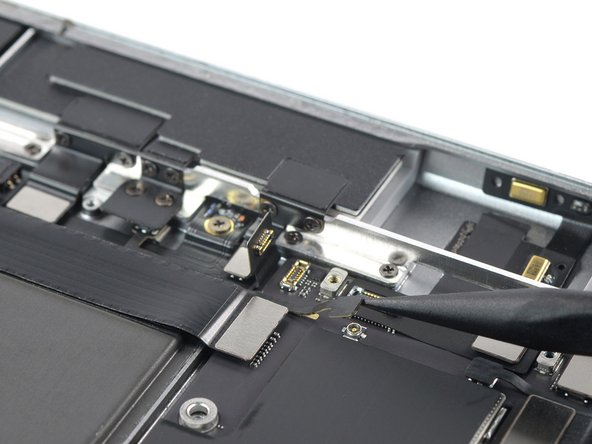

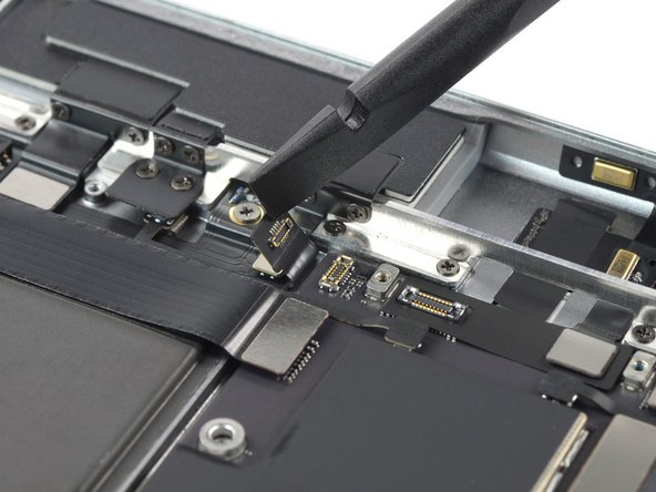

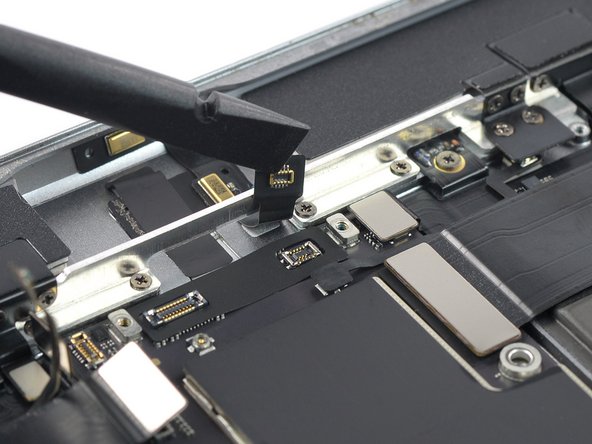

    27. iPad Pro 12.9" 2nd Gen Battery Replacement, Unfasten the battery connector screw: crwdns2935265:028crwdnd2935265:01crwdnd2935265:02crwdne2935265:0 iPad Pro 12.9" 2nd Gen Battery Replacement, Unfasten the battery connector screw: crwdns2935265:028crwdnd2935265:02crwdnd2935265:02crwdne2935265:0
      • Use a Phillips screwdriver to remove the 1.6 mm-long screw securing the battery connector.

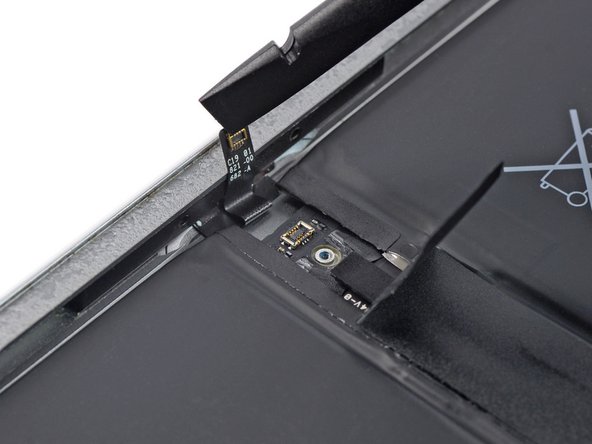

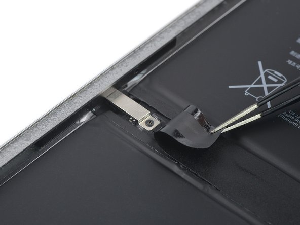

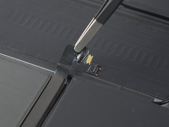

    28. iPad Pro 12.9" 2nd Gen Battery Replacement, Battery connector information: crwdns2935265:029crwdnd2935265:01crwdnd2935265:03crwdne2935265:0 iPad Pro 12.9" 2nd Gen Battery Replacement, Battery connector information: crwdns2935265:029crwdnd2935265:02crwdnd2935265:03crwdne2935265:0 iPad Pro 12.9" 2nd Gen Battery Replacement, Battery connector information: crwdns2935265:029crwdnd2935265:03crwdnd2935265:03crwdne2935265:0
      • These photos show what the battery connector looks like underneath the logic board. Use these photos as a reference while you safely disconnect the battery.
      • Notice that the battery connector has springs on the logic board that press down against the battery contact pads. You'll need to slide something thin and flexible between the contact points to disconnect the battery.
    29. iPad Pro 12.9" 2nd Gen Battery Replacement, Create a battery blocker: crwdns2935265:030crwdnd2935265:01crwdnd2935265:03crwdne2935265:0 iPad Pro 12.9" 2nd Gen Battery Replacement, Create a battery blocker: crwdns2935265:030crwdnd2935265:02crwdnd2935265:03crwdne2935265:0 iPad Pro 12.9" 2nd Gen Battery Replacement, Create a battery blocker: crwdns2935265:030crwdnd2935265:03crwdnd2935265:03crwdne2935265:0

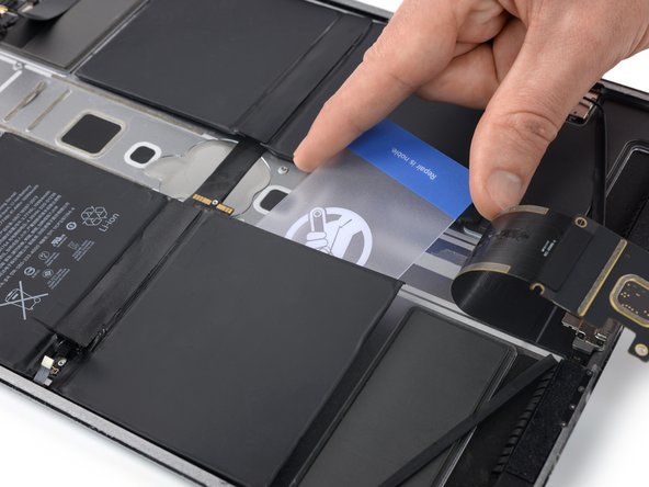

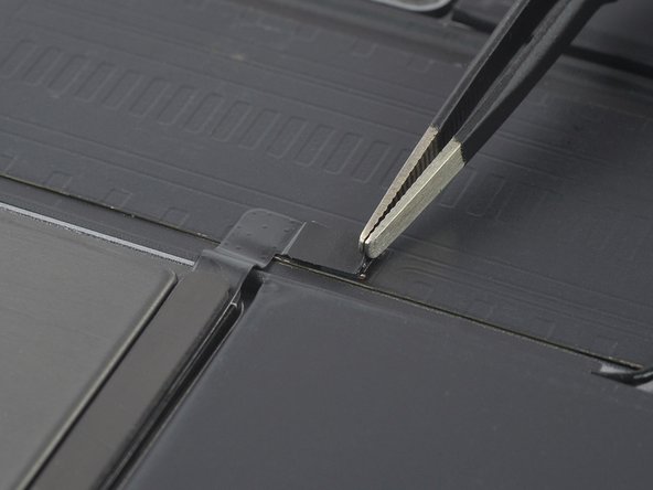

      • Use a piar of scissors to cut two 6 mm x 20 mm strips of a playing card to use as a battery blocker.
    30. iPad Pro 12.9" 2nd Gen Battery Replacement, Insert the card strips: crwdns2935265:031crwdnd2935265:01crwdnd2935265:03crwdne2935265:0 iPad Pro 12.9" 2nd Gen Battery Replacement, Insert the card strips: crwdns2935265:031crwdnd2935265:02crwdnd2935265:03crwdne2935265:0 iPad Pro 12.9" 2nd Gen Battery Replacement, Insert the card strips: crwdns2935265:031crwdnd2935265:03crwdnd2935265:03crwdne2935265:0
      • Gently insert the card strips on each side of the battery connector as far as they will go.
      • You can also use an iFixit battery blocker. Be very careful and don't push the battery blocker underneath the connector with excessive force.
    31. iPad Pro 12.9" 2nd Gen Battery Replacement, Unfasten the display connector bracket screws: crwdns2935265:032crwdnd2935265:01crwdnd2935265:02crwdne2935265:0 iPad Pro 12.9" 2nd Gen Battery Replacement, Unfasten the display connector bracket screws: crwdns2935265:032crwdnd2935265:02crwdnd2935265:02crwdne2935265:0
      • Use a Phillips screwdriver to remove the four screws securing the display connector bracket:
      • Two 1.2 mm-long screws
    32. iPad Pro 12.9" 2nd Gen Battery Replacement, Remove the display connector bracket: crwdns2935265:033crwdnd2935265:01crwdnd2935265:02crwdne2935265:0 iPad Pro 12.9" 2nd Gen Battery Replacement, Remove the display connector bracket: crwdns2935265:033crwdnd2935265:02crwdnd2935265:02crwdne2935265:0
      • Remove the display connector bracket.
    33. iPad Pro 12.9" 2nd Gen Battery Replacement, Disconnect the display cables: crwdns2935265:034crwdnd2935265:01crwdnd2935265:03crwdne2935265:0 iPad Pro 12.9" 2nd Gen Battery Replacement, Disconnect the display cables: crwdns2935265:034crwdnd2935265:02crwdnd2935265:03crwdne2935265:0 iPad Pro 12.9" 2nd Gen Battery Replacement, Disconnect the display cables: crwdns2935265:034crwdnd2935265:03crwdnd2935265:03crwdne2935265:0
      • Use the pointed end of a spudger to pry up and disconnect the display and digitizer cables from their logic board sockets.
      • To re-attach press connectors like this one, carefully align and press down on one side until it clicks into place, then repeat on the other side. Do not press down on the middle. If the connector is misaligned, the pins can bend, causing permanent damage.
      • These cables are very delicate, and the connectors can damage easily if they're misaligned. When you reattach the cables to the logic board, try to have as much slack on the cables and gently press the connectors onto their sockets.
    34. iPad Pro 12.9" 2nd Gen Battery Replacement, Remove the screen assembly: crwdns2935265:035crwdnd2935265:01crwdnd2935265:01crwdne2935265:0
      • Remove the screen assembly.
    1. iPad Pro 12.9" 2nd Gen Battery Replacement, Unfasten the top bracket screws: crwdns2935265:036crwdnd2935265:01crwdnd2935265:01crwdne2935265:0
      • Use a Phillips screwdriver to remove the eight screws securing the top bracket:
      • Four 2.2 mm-long screws
    2. iPad Pro 12.9" 2nd Gen Battery Replacement, Loosen the adhesive: crwdns2935265:037crwdnd2935265:01crwdnd2935265:01crwdne2935265:0
      • The top bracket is still held in place by the two black tapes securing it to the frame.
      • Apply a heated iOpener to the top bracket for 1 minute to loosen the adhesive.
    3. iPad Pro 12.9" 2nd Gen Battery Replacement, Lift the top bracket: crwdns2935265:038crwdnd2935265:01crwdnd2935265:02crwdne2935265:0 iPad Pro 12.9" 2nd Gen Battery Replacement, Lift the top bracket: crwdns2935265:038crwdnd2935265:02crwdnd2935265:02crwdne2935265:0
      • Slide the flat end of a spudger underneath the top bracket and lift it up until you can grab it with your fingers.
    4. iPad Pro 12.9" 2nd Gen Battery Replacement, Remove the top bracket: crwdns2935265:039crwdnd2935265:01crwdnd2935265:02crwdne2935265:0 iPad Pro 12.9" 2nd Gen Battery Replacement, Remove the top bracket: crwdns2935265:039crwdnd2935265:02crwdnd2935265:02crwdne2935265:0
      • Remove the top bracket.

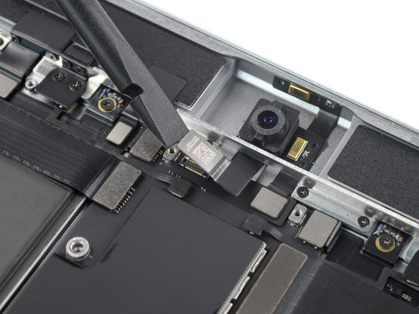

    5. iPad Pro 12.9" 2nd Gen Battery Replacement, Disconnect the front facing camera: crwdns2935265:040crwdnd2935265:01crwdnd2935265:02crwdne2935265:0 iPad Pro 12.9" 2nd Gen Battery Replacement, Disconnect the front facing camera: crwdns2935265:040crwdnd2935265:02crwdnd2935265:02crwdne2935265:0
      • Use a spudger to disconnect the front facing camera flex cable by prying the connector straight up from its socket.

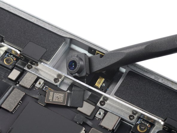

    6. iPad Pro 12.9" 2nd Gen Battery Replacement, Free the front facing camera: crwdns2935265:041crwdnd2935265:01crwdnd2935265:02crwdne2935265:0 iPad Pro 12.9" 2nd Gen Battery Replacement, Free the front facing camera: crwdns2935265:041crwdnd2935265:02crwdnd2935265:02crwdne2935265:0
      • The front facing camera is held in place by mild adhesive.
      • Use the flat end of a spudger to carefully pry up the front camera and to separate it from the frame.
    7. iPad Pro 12.9" 2nd Gen Battery Replacement, Remove the front facing camera: crwdns2935265:042crwdnd2935265:01crwdnd2935265:03crwdne2935265:0 iPad Pro 12.9" 2nd Gen Battery Replacement, Remove the front facing camera: crwdns2935265:042crwdnd2935265:02crwdnd2935265:03crwdne2935265:0 iPad Pro 12.9" 2nd Gen Battery Replacement, Remove the front facing camera: crwdns2935265:042crwdnd2935265:03crwdnd2935265:03crwdne2935265:0
      • The front camera cable is threaded underneath the frame.
      • Use a pair of tweezers to pull the front facing camera from underneath the frame and remove it.
    1. iPad Pro 12.9" 2nd Gen Battery Replacement, Disconnect the top left interconnect cable: crwdns2935265:043crwdnd2935265:01crwdnd2935265:02crwdne2935265:0 iPad Pro 12.9" 2nd Gen Battery Replacement, Disconnect the top left interconnect cable: crwdns2935265:043crwdnd2935265:02crwdnd2935265:02crwdne2935265:0
      • Use a spudger to disconnect the top left interconnect cable by prying the connector straight up from its socket.
    2. iPad Pro 12.9" 2nd Gen Battery Replacement, Disconnect the top left coxial cable: crwdns2935265:044crwdnd2935265:01crwdnd2935265:03crwdne2935265:0 iPad Pro 12.9" 2nd Gen Battery Replacement, Disconnect the top left coxial cable: crwdns2935265:044crwdnd2935265:02crwdnd2935265:03crwdne2935265:0 iPad Pro 12.9" 2nd Gen Battery Replacement, Disconnect the top left coxial cable: crwdns2935265:044crwdnd2935265:03crwdnd2935265:03crwdne2935265:0
      • Slide the point of a spudger under the top left coxial connector.
      • Pry straight up to disconnect the top left coxial cable.
      • Carefully bend the coxial cable upwards to free the logic board.
      • Do not fold the cable sharply and only bend it to avoid cable damage.
    3. iPad Pro 12.9" 2nd Gen Battery Replacement, Disconnect the speaker and headphone jack cable: crwdns2935265:045crwdnd2935265:01crwdnd2935265:02crwdne2935265:0 iPad Pro 12.9" 2nd Gen Battery Replacement, Disconnect the speaker and headphone jack cable: crwdns2935265:045crwdnd2935265:02crwdnd2935265:02crwdne2935265:0
      • Use a spudger to disconnect the speaker and headphone jack cable by prying the connector straight up from its socket.
      • Carefully bend the cable upwards to free the logic board.
    4. iPad Pro 12.9" 2nd Gen Battery Replacement, Disconnect the microphone cable: crwdns2935265:046crwdnd2935265:01crwdnd2935265:02crwdne2935265:0 iPad Pro 12.9" 2nd Gen Battery Replacement, Disconnect the microphone cable: crwdns2935265:046crwdnd2935265:02crwdnd2935265:02crwdne2935265:0
      • Use a spudger to disconnect the microphone cable by prying the connector straight up from its socket.
    5. iPad Pro 12.9" 2nd Gen Battery Replacement, Disconnect the top right interconnect cable: crwdns2935265:047crwdnd2935265:01crwdnd2935265:02crwdne2935265:0 iPad Pro 12.9" 2nd Gen Battery Replacement, Disconnect the top right interconnect cable: crwdns2935265:047crwdnd2935265:02crwdnd2935265:02crwdne2935265:0
      • Use a spudger to disconnect the top right interconnect cable by prying the connector straight up from its socket.
    6. iPad Pro 12.9" 2nd Gen Battery Replacement, Disconnect the top right coxial cable: crwdns2935265:048crwdnd2935265:01crwdnd2935265:03crwdne2935265:0 iPad Pro 12.9" 2nd Gen Battery Replacement, Disconnect the top right coxial cable: crwdns2935265:048crwdnd2935265:02crwdnd2935265:03crwdne2935265:0 iPad Pro 12.9" 2nd Gen Battery Replacement, Disconnect the top right coxial cable: crwdns2935265:048crwdnd2935265:03crwdnd2935265:03crwdne2935265:0
      • Slide the point of a spudger under the top right coxial connector.
      • Pry straight up to disconnect the top right coxial cable.
    7. iPad Pro 12.9" 2nd Gen Battery Replacement, Disconnect the sensor and volume button cable: crwdns2935265:049crwdnd2935265:01crwdnd2935265:02crwdne2935265:0 iPad Pro 12.9" 2nd Gen Battery Replacement, Disconnect the sensor and volume button cable: crwdns2935265:049crwdnd2935265:02crwdnd2935265:02crwdne2935265:0
      • Use a spudger to disconnect the sensor and volume button cable by prying the connector straight up from its socket.

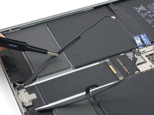

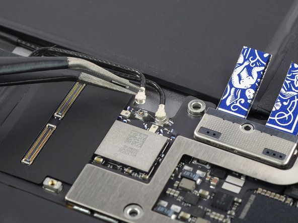

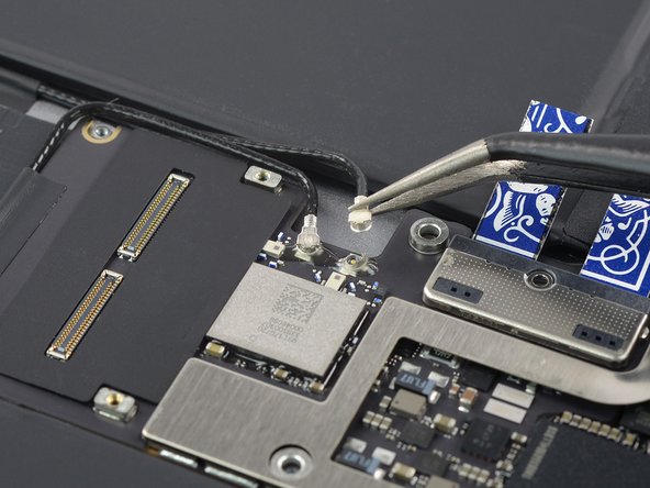

    12. iPad Pro 12.9" 2nd Gen Battery Replacement, Disconnect the antenna cables: crwdns2935265:054crwdnd2935265:01crwdnd2935265:03crwdne2935265:0 iPad Pro 12.9" 2nd Gen Battery Replacement, Disconnect the antenna cables: crwdns2935265:054crwdnd2935265:02crwdnd2935265:03crwdne2935265:0 iPad Pro 12.9" 2nd Gen Battery Replacement, Disconnect the antenna cables: crwdns2935265:054crwdnd2935265:03crwdnd2935265:03crwdne2935265:0
      • Slide a pair of tweezers under the upper antenna cable at the bottom edge of the logic board until they're snug against the metal connector.
      • Disconnect the upper antenna cable by prying it straight up from the logic board.
      • Repeat the procedure with the lower antenna cable.

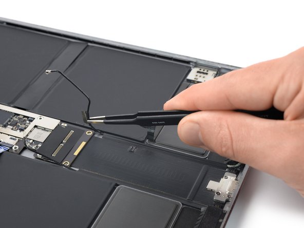

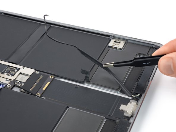

    14. iPad Pro 12.9" 2nd Gen Battery Replacement, Free the right antenna cable: crwdns2935265:056crwdnd2935265:01crwdnd2935265:03crwdne2935265:0 iPad Pro 12.9" 2nd Gen Battery Replacement, Free the right antenna cable: crwdns2935265:056crwdnd2935265:02crwdnd2935265:03crwdne2935265:0 iPad Pro 12.9" 2nd Gen Battery Replacement, Free the right antenna cable: crwdns2935265:056crwdnd2935265:03crwdnd2935265:03crwdne2935265:0
      • Use tweezers to gently lift the right antenna cable connector away from the frame.
      • Take care not to puncture the battery—a punctured battery may leak dangerous chemicals or cause a thermal event.
      • Use your fingers or tweezers to lift and peel up the the right antenna cable from the iPad frame.
      • Don't pull the cable forcefully. If the cable feels stuck, reapply a heated iOpener to further soften the adhesive.
    15. iPad Pro 12.9" 2nd Gen Battery Replacement, Free the left antenna cable: crwdns2935265:057crwdnd2935265:01crwdnd2935265:02crwdne2935265:0 iPad Pro 12.9" 2nd Gen Battery Replacement, Free the left antenna cable: crwdns2935265:057crwdnd2935265:02crwdnd2935265:02crwdne2935265:0
      • Repeat the previous step and use your fingers or tweezers to lift and peel up the the left antenna cable from the iPad frame.
      • Don't pull the cable forcefully. If the cable feels stuck, apply a heated iOpener to further soften the adhesive.

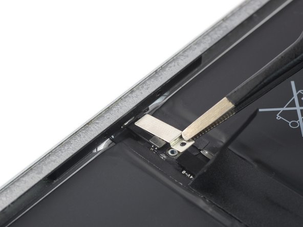

    16. iPad Pro 12.9" 2nd Gen Battery Replacement, Fold over the smart connector tape: crwdns2935265:058crwdnd2935265:01crwdnd2935265:02crwdne2935265:0 iPad Pro 12.9" 2nd Gen Battery Replacement, Fold over the smart connector tape: crwdns2935265:058crwdnd2935265:02crwdnd2935265:02crwdne2935265:0
      • Use a pair of tweezers to fold the smart connector tape to the side to get free access to the smart connector bracket.
    17. iPad Pro 12.9" 2nd Gen Battery Replacement, Unfasten the smart connector bracket screw: crwdns2935265:059crwdnd2935265:01crwdnd2935265:01crwdne2935265:0
      • Use a Phillips screwdriver to remove the single 1.3 mm-long screw securing the smart connector bracket.
    18. iPad Pro 12.9" 2nd Gen Battery Replacement, Remove the smart connector bracket: crwdns2935265:060crwdnd2935265:01crwdnd2935265:03crwdne2935265:0 iPad Pro 12.9" 2nd Gen Battery Replacement, Remove the smart connector bracket: crwdns2935265:060crwdnd2935265:02crwdnd2935265:03crwdne2935265:0 iPad Pro 12.9" 2nd Gen Battery Replacement, Remove the smart connector bracket: crwdns2935265:060crwdnd2935265:03crwdnd2935265:03crwdne2935265:0
      • Use a pair of tweezers to pull the smart connector bracket from underneath the frame and remove it.

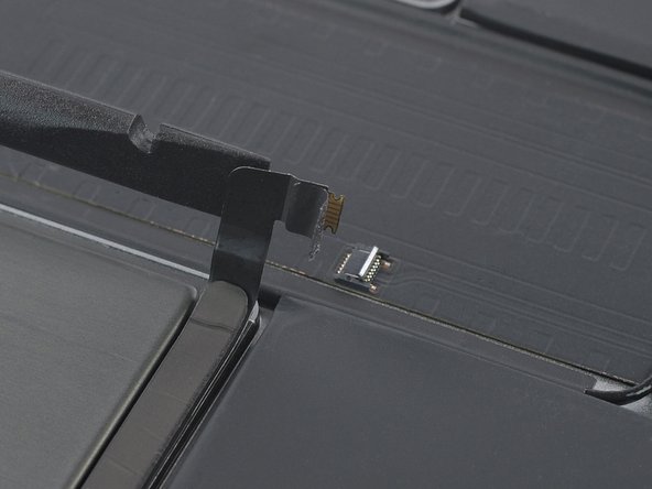

    19. iPad Pro 12.9" 2nd Gen Battery Replacement, Disconnect the smart connector: crwdns2935265:061crwdnd2935265:01crwdnd2935265:03crwdne2935265:0 iPad Pro 12.9" 2nd Gen Battery Replacement, Disconnect the smart connector: crwdns2935265:061crwdnd2935265:02crwdnd2935265:03crwdne2935265:0 iPad Pro 12.9" 2nd Gen Battery Replacement, Disconnect the smart connector: crwdns2935265:061crwdnd2935265:03crwdnd2935265:03crwdne2935265:0
      • Use a spudger to disconnect the smart connector cable by prying the connector straight up from its socket.
      • Carefully bend the smart connector cable upwards to free the battery.

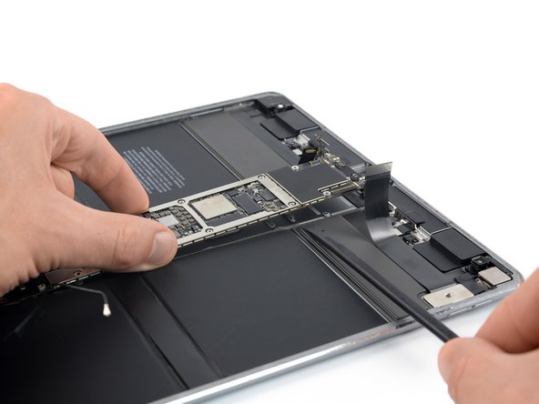

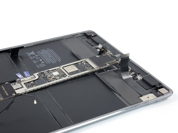

    22. iPad Pro 12.9" 2nd Gen Battery Replacement, Loosen the logic board: crwdns2935265:064crwdnd2935265:01crwdnd2935265:02crwdne2935265:0 iPad Pro 12.9" 2nd Gen Battery Replacement, Loosen the logic board: crwdns2935265:064crwdnd2935265:02crwdnd2935265:02crwdne2935265:0
      • The next four steps show how to move the logic board out of the way for battery removal. Read the steps first before you attempt it.
      • Insert the flat end of a spudger underneath the top edge of the logic board.
      • Carefully lift the logic board by levering the spudger downwards.
      • Make sure no cables are tangled or interfere with the motherboard during this procedure to avoid cable damage.
      • Don't try to completely remove the logic board. It's attached to a flex cable that's glued to the iPad frame.

    25. iPad Pro 12.9" 2nd Gen Battery Replacement, Loosen the logic board cable adhesive: crwdns2935265:067crwdnd2935265:01crwdnd2935265:01crwdne2935265:0
      • Reapply a heated iOpener to the logic board cable for 2 minutes to loosen the adhesive underneath.

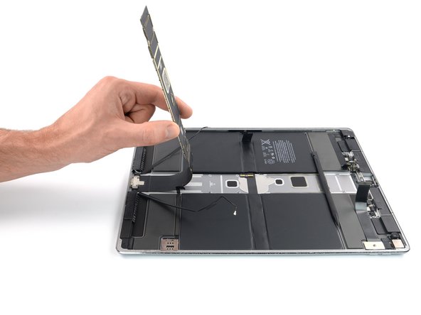

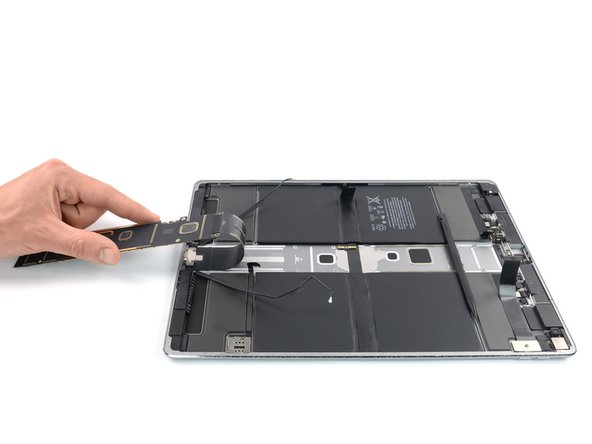

    26. iPad Pro 12.9" 2nd Gen Battery Replacement, Fold over the logic board: crwdns2935265:068crwdnd2935265:01crwdnd2935265:03crwdne2935265:0 iPad Pro 12.9" 2nd Gen Battery Replacement, Fold over the logic board: crwdns2935265:068crwdnd2935265:02crwdnd2935265:03crwdne2935265:0 iPad Pro 12.9" 2nd Gen Battery Replacement, Fold over the logic board: crwdns2935265:068crwdnd2935265:03crwdnd2935265:03crwdne2935265:0
      • Lift the logic board slightly and swing it over its flex cable.
      • Do not force this action. If there isn't enough slack, apply more heat to the flex cable to loosen the adhesive.
      • During reassembly, apply some Tesa tape or double-sided tape to the flex cable to secure it to the iPad frame.
      • Once you swing the logic board completely over its flex cable, you can use a piece of tape to secure the logic board out of the way of the battery.

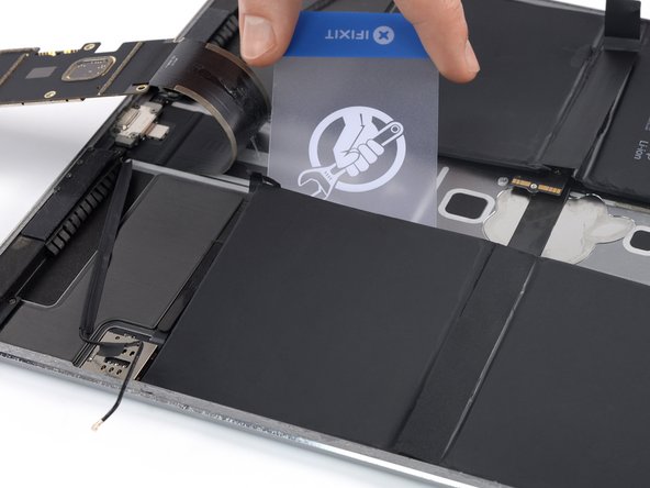

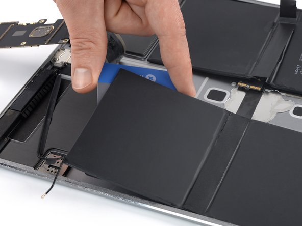

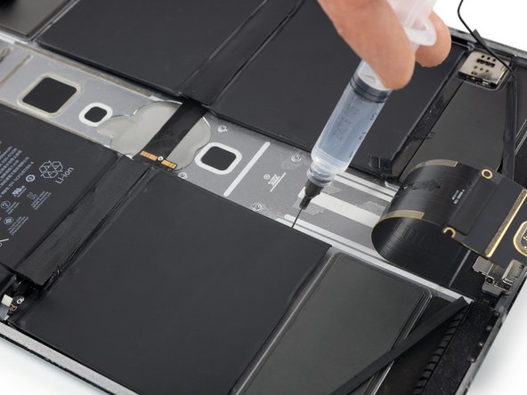

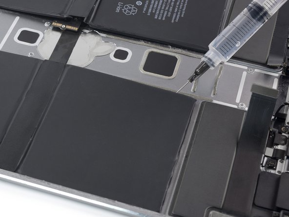

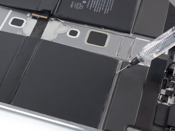

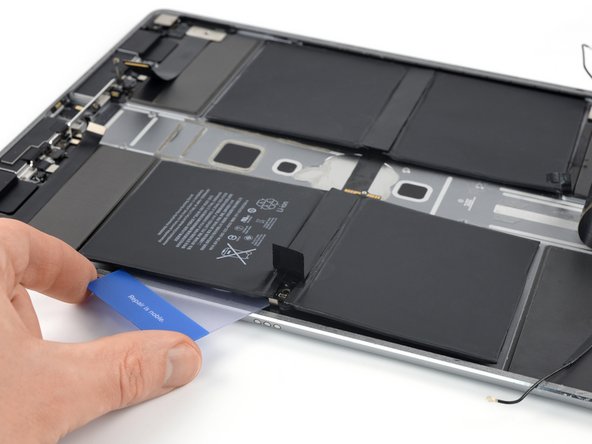

    28. iPad Pro 12.9" 2nd Gen Battery Replacement, Loosen the bottom left battery cell: crwdns2935265:070crwdnd2935265:01crwdnd2935265:03crwdne2935265:0 iPad Pro 12.9" 2nd Gen Battery Replacement, Loosen the bottom left battery cell: crwdns2935265:070crwdnd2935265:02crwdnd2935265:03crwdne2935265:0 iPad Pro 12.9" 2nd Gen Battery Replacement, Loosen the bottom left battery cell: crwdns2935265:070crwdnd2935265:03crwdnd2935265:03crwdne2935265:0
      • Tilt the iPad and apply a few drops of high concentration (>90%) isopropyl alcohol to the inside and bottom edge of the bottom left battery cell.
      • Wait about two minutes for the alcohol solution to weaken the adhesive.

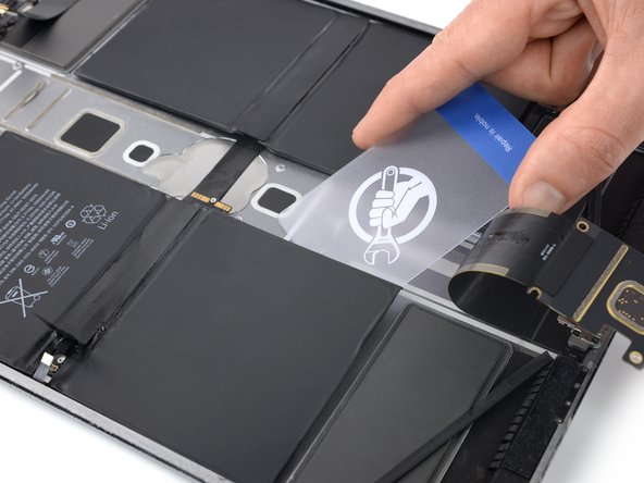

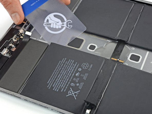

    29. iPad Pro 12.9" 2nd Gen Battery Replacement: crwdns2935265:071crwdnd2935265:01crwdnd2935265:03crwdne2935265:0 iPad Pro 12.9" 2nd Gen Battery Replacement: crwdns2935265:071crwdnd2935265:02crwdnd2935265:03crwdne2935265:0 iPad Pro 12.9" 2nd Gen Battery Replacement: crwdns2935265:071crwdnd2935265:03crwdnd2935265:03crwdne2935265:0
      Plastic Cards
      $2.99

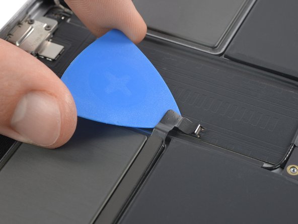

      • Slowly slide an plastic card under the bottom left battery cell to separate it from the frame.
      • Take care not to puncture or bend the battery with your tool—a punctured or bent battery may leak dangerous chemicals or cause a fire.
      • If you're having difficulty separating the adhesive, apply more high concentration (>90%) isopropyl alcohol and wait for the adhesive to loosen.
      • Alternatively, you can use dental floss to slice through the adhesive. Wrap the floss around a bit driver handle or your fingers and thread it back and forth under the battery.

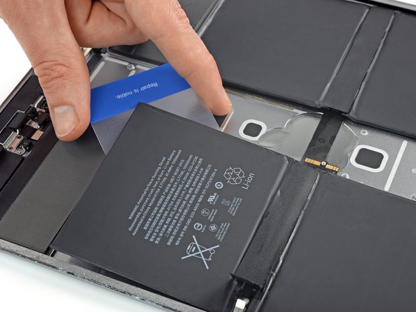

    30. iPad Pro 12.9" 2nd Gen Battery Replacement, Loosen the top left battery cell: crwdns2935265:072crwdnd2935265:01crwdnd2935265:03crwdne2935265:0 iPad Pro 12.9" 2nd Gen Battery Replacement, Loosen the top left battery cell: crwdns2935265:072crwdnd2935265:02crwdnd2935265:03crwdne2935265:0 iPad Pro 12.9" 2nd Gen Battery Replacement, Loosen the top left battery cell: crwdns2935265:072crwdnd2935265:03crwdnd2935265:03crwdne2935265:0
      • Repeat the previous procedure to separate the top left battery cell from the frame:
      • Apply a few drops of high concentration (>90%) isopropyl alcohol to loosen the battery adhesive.
      • Slide a plastic card underneath the top left battery cell to separate it from the frame.

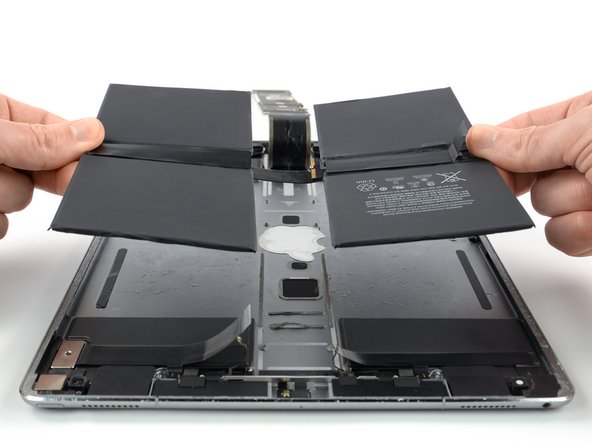

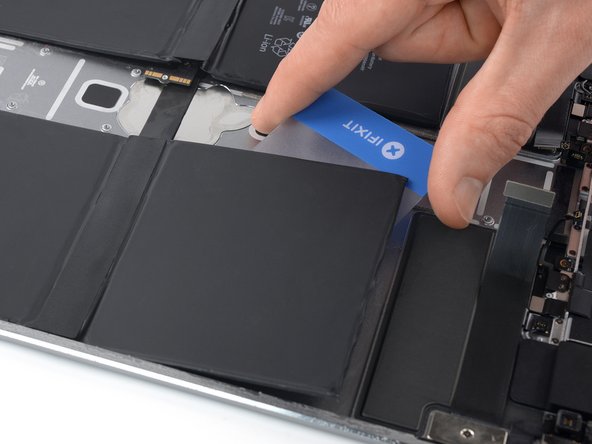

    31. iPad Pro 12.9" 2nd Gen Battery Replacement, Lift the left half of the battery: crwdns2935265:073crwdnd2935265:01crwdnd2935265:03crwdne2935265:0 iPad Pro 12.9" 2nd Gen Battery Replacement, Lift the left half of the battery: crwdns2935265:073crwdnd2935265:02crwdnd2935265:03crwdne2935265:0 iPad Pro 12.9" 2nd Gen Battery Replacement, Lift the left half of the battery: crwdns2935265:073crwdnd2935265:03crwdnd2935265:03crwdne2935265:0
      • Make sure the left half of the battery is fully separated from the frame by grabbing it on both ends and carefully lift it upwards.
      • If the battery is sticking to the frame use your plastic card to slice through the remaining adhesive to completely separate the left half of the battery from the frame.
      • Place a plastic card underneath the center of the left half of the battery to prevent the adhesive from resealing.

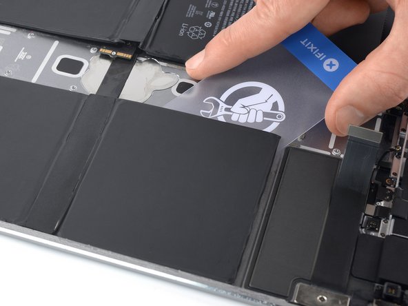

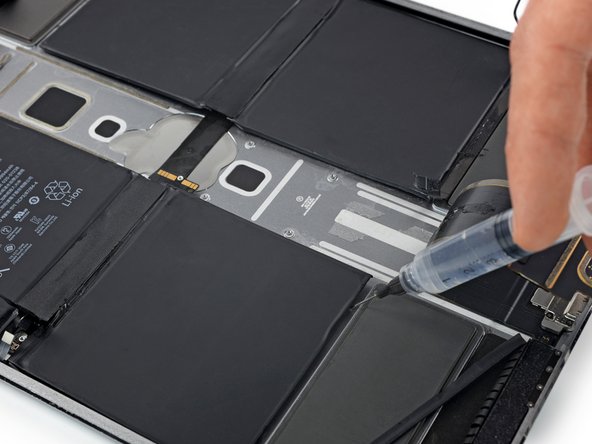

    32. iPad Pro 12.9" 2nd Gen Battery Replacement, Loosen the top right battery cell: crwdns2935265:074crwdnd2935265:01crwdnd2935265:03crwdne2935265:0 iPad Pro 12.9" 2nd Gen Battery Replacement, Loosen the top right battery cell: crwdns2935265:074crwdnd2935265:02crwdnd2935265:03crwdne2935265:0 iPad Pro 12.9" 2nd Gen Battery Replacement, Loosen the top right battery cell: crwdns2935265:074crwdnd2935265:03crwdnd2935265:03crwdne2935265:0
      • Tilt the iPad and apply a few drops of high concentration (>90%) isopropyl alcohol to the inside and bottom edge of the top right battery cell.
    33. iPad Pro 12.9" 2nd Gen Battery Replacement: crwdns2935265:075crwdnd2935265:01crwdnd2935265:03crwdne2935265:0 iPad Pro 12.9" 2nd Gen Battery Replacement: crwdns2935265:075crwdnd2935265:02crwdnd2935265:03crwdne2935265:0 iPad Pro 12.9" 2nd Gen Battery Replacement: crwdns2935265:075crwdnd2935265:03crwdnd2935265:03crwdne2935265:0
      • Slowly slide an plastic card under the top right battery cell to separate it from the frame.
    34. iPad Pro 12.9" 2nd Gen Battery Replacement, Loosen the bottom right battery cell: crwdns2935265:076crwdnd2935265:01crwdnd2935265:03crwdne2935265:0 iPad Pro 12.9" 2nd Gen Battery Replacement, Loosen the bottom right battery cell: crwdns2935265:076crwdnd2935265:02crwdnd2935265:03crwdne2935265:0 iPad Pro 12.9" 2nd Gen Battery Replacement, Loosen the bottom right battery cell: crwdns2935265:076crwdnd2935265:03crwdnd2935265:03crwdne2935265:0
      • Repeat the previous procedure to separate the bottom right battery cell from the frame:
      • Slide a plastic card underneath the bottom right battery cell to separate it from the frame.

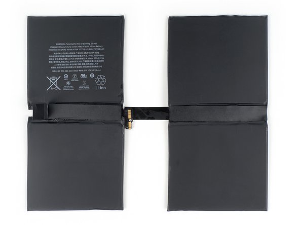

    35. iPad Pro 12.9" 2nd Gen Battery Replacement, Remove the battery: crwdns2935265:077crwdnd2935265:01crwdnd2935265:03crwdne2935265:0 iPad Pro 12.9" 2nd Gen Battery Replacement, Remove the battery: crwdns2935265:077crwdnd2935265:02crwdnd2935265:03crwdne2935265:0 iPad Pro 12.9" 2nd Gen Battery Replacement, Remove the battery: crwdns2935265:077crwdnd2935265:03crwdnd2935265:03crwdne2935265:0
      • Lift up the battery and remove it from the iPad.
      • Do not reuse the battery if it has been deformed or damaged, as doing so is a potential safety hazard. Replace it with a new battery.

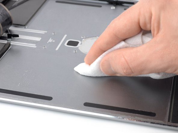

    36. iPad Pro 12.9" 2nd Gen Battery Replacement, Remove the adhesive residue: crwdns2935265:078crwdnd2935265:01crwdnd2935265:02crwdne2935265:0 iPad Pro 12.9" 2nd Gen Battery Replacement, Remove the adhesive residue: crwdns2935265:078crwdnd2935265:02crwdnd2935265:02crwdne2935265:0
      • Before you install a new battery:
      • Remove all adhesive residue from the iPad frame. Use isopropyl alcohol and a spudger to scrape off any adhesive chunks. Wipe away the adhesive residue with a lint-free cloth.
      • If there's any alcohol solution remaining in the iPad, carefully wipe it off or allow it to air dry.
      • Be sure that the iPad frame surface is completely clean and free of debris. An uneven surface can press into the replacement battery, resulting in premature battery failure.
